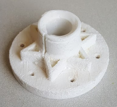

    Im going to print at .2 and use 100% infill. So shouldn't have any honeycomb. It will be a solid chunk of plastic. abs specifically.

    Flashforge Dreamer 3d and a CTC 3D Printer, Didnt turn out perfect but I forgot to level the bed....I dont like the way it looks at all but it fits perfect and the build is tight.[​IMG]

    +598 / 5 / -0
    OK so the main shaft doesn't fit. Shaft is 22mm and your file appears to print at less for me. Do toy remember specs? I edited the stl and I'm reprinting now

    Weird... it should be only a little tight: use of sand paper should let you to have the exact adjusment you wish

    you woudl go through a stack of sandpaper to remove what happened wtih me. I even tried using a hammer and the part where it is split was so v'd out that I thoght it would snap so I took it back off. I made another adjustment to 23mm but forgot to go down and check it this morning on the printer. Getting some weird stuff going on when just these prints. Not sure if its the non-smooth model or what.

    So the print at 23mm fits nice and snug which is great since I wont be removing it. Attached is what I was talking about yesterday.

    So I tried this out with my new OpenSimWheel - Big Mige (30Nm) running off the Ioni Pro HC (so hits the full 30Nm peak).. This was the outcome for my 3D printed hub ($20AUD + $10 collar)
    I must say, it was extremely fun getting this to happen :) However, I will be now ordering a Q1R system.

    Was worth it - even with hindsight.
    For the smaller mige running with the normal Ioni/Pro to hit 10Nm continuous, this should do the job. It only started to crack at 14-15Nm - hence why im just going straight to metal now.
    Having said that, the feel of the OSW is odd. Doesnt feel natural to me, but that could be the cracking of the hub or tweaking of forces.
    It hit a very hard barrier at about 60deg left/right of center when turning - almost forcing the car to turn-in without my intervention. (steering ratio was set in MMoS to 400 -> 900 which didnt make a difference.)

    This particular part of the QR where it broke is a bit hollowed, maybe if it was printed 100% solid it would last better?

    When printed, the thing was honeycombed completely? I assumed this was the design in the .stl file.
    Agreed that solid would provide better rigidity. I imagine cost would inflate by at least 100%. = ~$40-60AUD which is still a fair bit cheaper then the Q1R system.
    Having said that, once the hub is on the shaft, its not the easiest thing to remove from the shaft. Great for one wheel. Just a cheap alternative if utilising >1 wheel.

    Sorry to see this one broken... @ALMO
    3D printing is ruled by many parameters... and from one to another the result may vary very much
    STL files describe only the surface geometry of a three-dimensional object (hence the volume but not the inside!)
    the 3D printer uses a software to convert it and honeycomb it along to some parameters
    Yes, hollowed like this, it's too weak and definitely for 30N.m...
