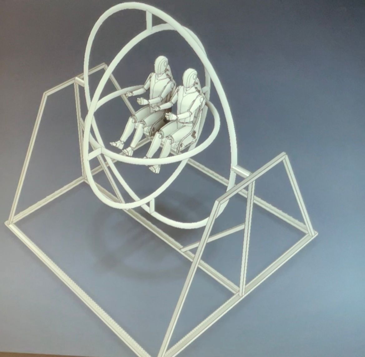

    Hello everyone, I'm new to the forum after searching for projects related to building a flight simulator. Therefore I am working on a 3-axis aerobatic flight simulator with 360 degrees of freedom. The problem I'm facing is that I don't know if the telemetry from simtools can provide me with the information needed to create infinite loops or rolls. Many thanks already for the valuable information found here.
    21,592
    151,215Coins
    @yobuddy can explain further as to rotation and SimTools.
    But can you please provide an example or drawing of what you would like to create and why.
    While continuous rotation may seem a good idea there are technical/cost complexities for questionable motion outcomes in terms of exploiting weaknesses in psychological and physiological processing.

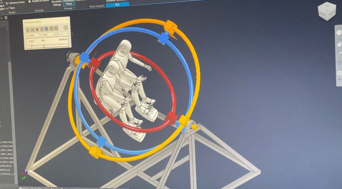

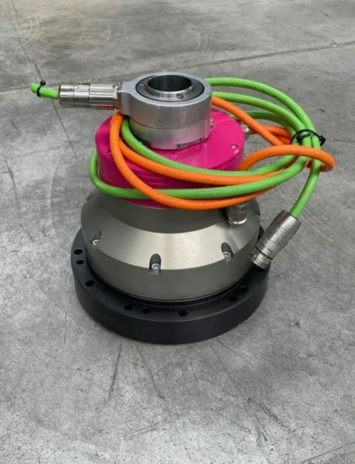

    Thanks noorbeast for creating the new theard, I didn't know where to ask at first. Regarding the simulator, I will use 3 three-phase motors with harmonicdrive reducers, therefore I had to modify the smc3 code and implement the protocol for brushless motors. For feedback I implemented reading directly from the motor driver, but in the future on the simulator I will use the encoder with which the motor is equipped. Initially, I use 3 miniature CNC motors with the related drivers for the test. For complete 360 degree rotations, I will use rotary contacts without stroke limit. At the moment I have a problem related to the interpretation of simtools data. In Xplane 11 or 12, if I perform an aerobatic loop when reaching the value 90 (ie vertical), if I continue the looping, this value starts to decrease back to the minimum, which reverses the direction of my engine, when it should have continued in the initial direction. My question is, if simtools can provide information for the correct execution of the looping, if yes, it means that I have to find a protocol to implement in the smc3 code that uses this information correctly. I am attaching a few more pictures of the project and the engines I will use.

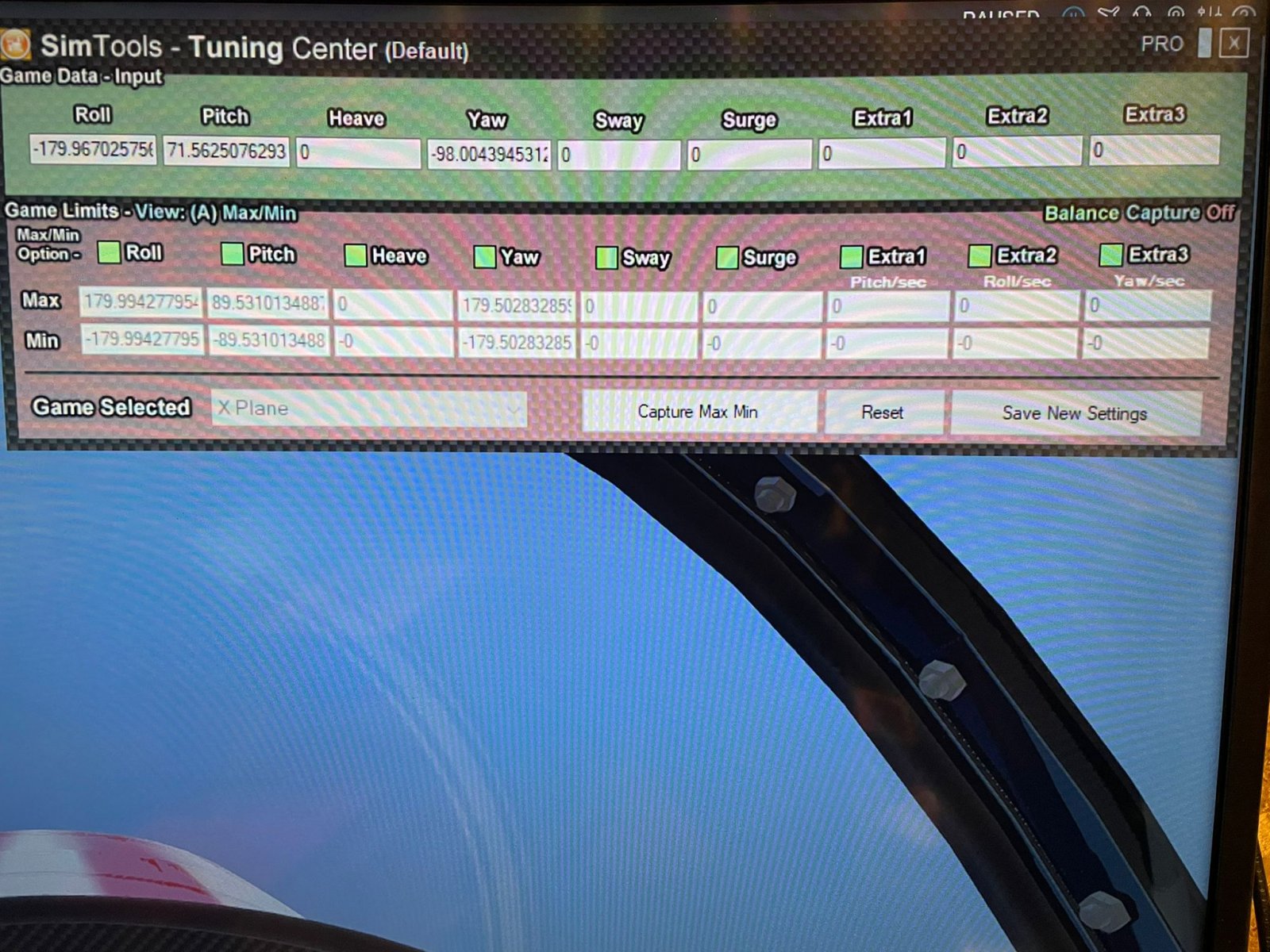

    I think it depends on the plugin. Like the DCS one you can specify if you want angular rates or Euler angles. On the YawVR I only have 360° available on the Yaw axis. But I imagine the same issues and workarounds we use would translate to pitch and roll too. Most rigs don't have 360° on any axis so most plugins seem to use angular rates so they don't run into the rollover problem. When we convert yaw axis angular rates to fake heading angle data when we need to, if we don't keep 1:1 with the sim you don't notice like you would with pitch and roll. An IMU is no good for a yaw axis because of drift, but I bet it'd work good for keeping track of your pitch and roll orientation accurately. Good luck to you.
  5. yobuddy
    5,408
    50,691Coins
    +5,166 / 19 / -0
    Whats needed here is a hardware interface that knows how to roll over is all.
    Usually when you are all the way left say -180 and you get a 180 it will roll the sim all the way right.
    You need a interface that will roll over is all.

    I understand, thank you very much for the information, I will document myself about this. I have another question, in the tuning center on the pitch domain in xplane 11 and 12 I cannot capture more than +-89.53, I am attaching a picture.
