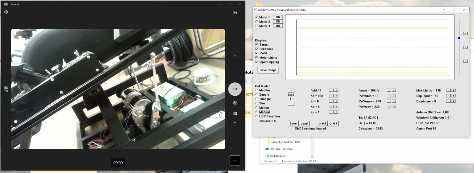

    I searched everywhere in the forum, but I must not be smart, I can't find the answer to the following question:
    I have hall effect potentiometers at 360, but under SMC3 when my potentiometer reaches its highest level it switches to low (I understand that it is in fact a voltage tap +- 5 volt or 2 ,5...), I would like to make SMC3 understand that I have a 360° potentiometer and not 180!
    Is there a parameter in the arduino code (pot scaling????) that allows me to manage this problem.
    The chair itself works well, but when I stop the power my chair gets up and puts my potentiometers at the maximum height travel, I therefore exceed the limit value in SMC3, and if I restart the power, suddenly my motor goes in the opposite direction to what it should operate.
    I therefore always have to help my wheelchair when starting to lower it while it starts, and I would therefore like to avoid this by having potentiometers that operate at 360°...

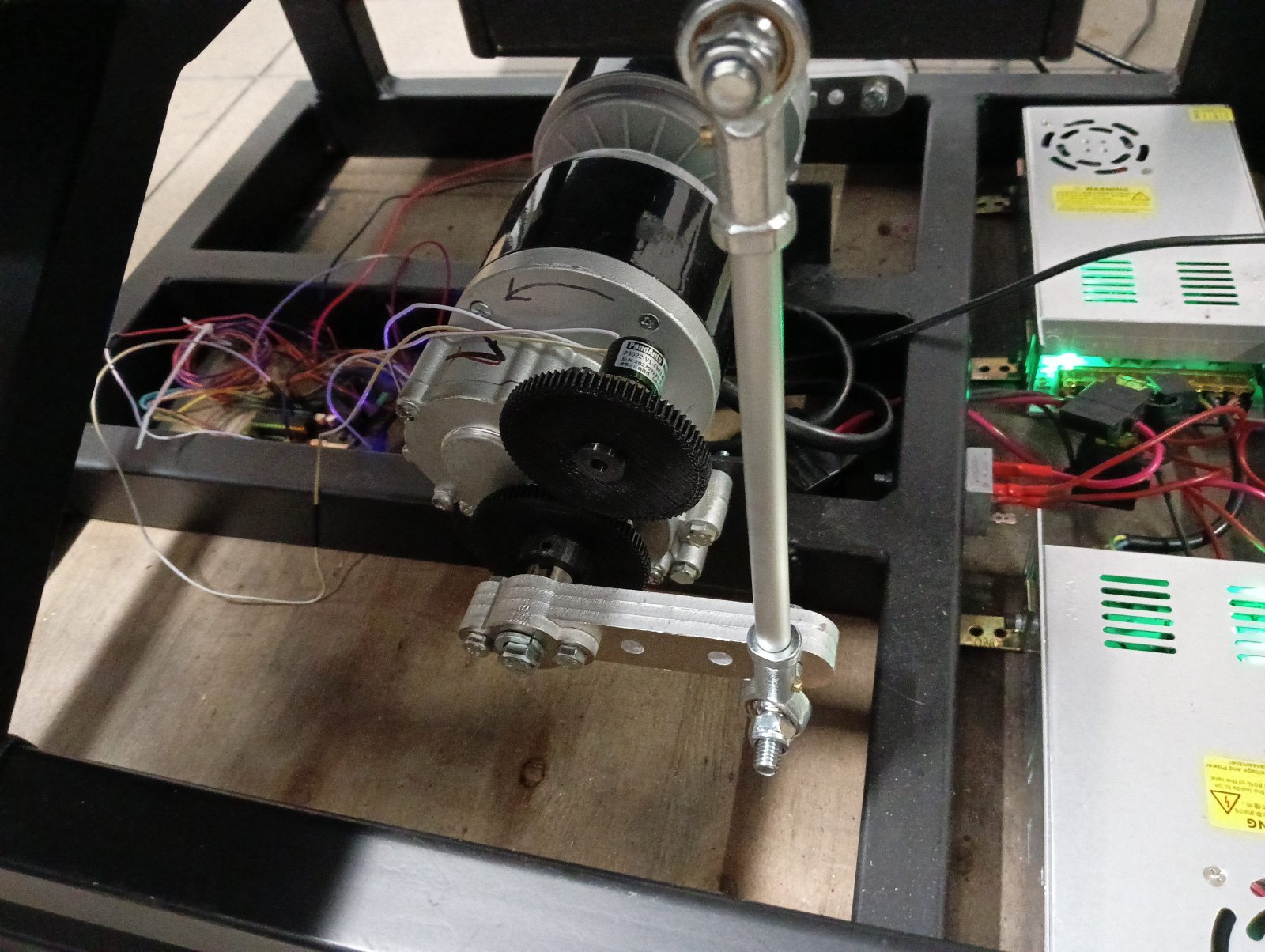

    <a href="https://zupimages.net/viewer.php?id=24/48/wnke.jpg"><img src="https://zupimages.net/up/24/48/wnke.jpg" alt="" /></a>
    When the chair is stationary (angle of more than 180°...)
    and when he works, normal angle...
    As soon as I start, as it can't find the right data from the potentiometers it tilts the arm to the left when it should go to the right... that's mainly my problem, I have to lower it with the arm on the right side before starting the arduino card........

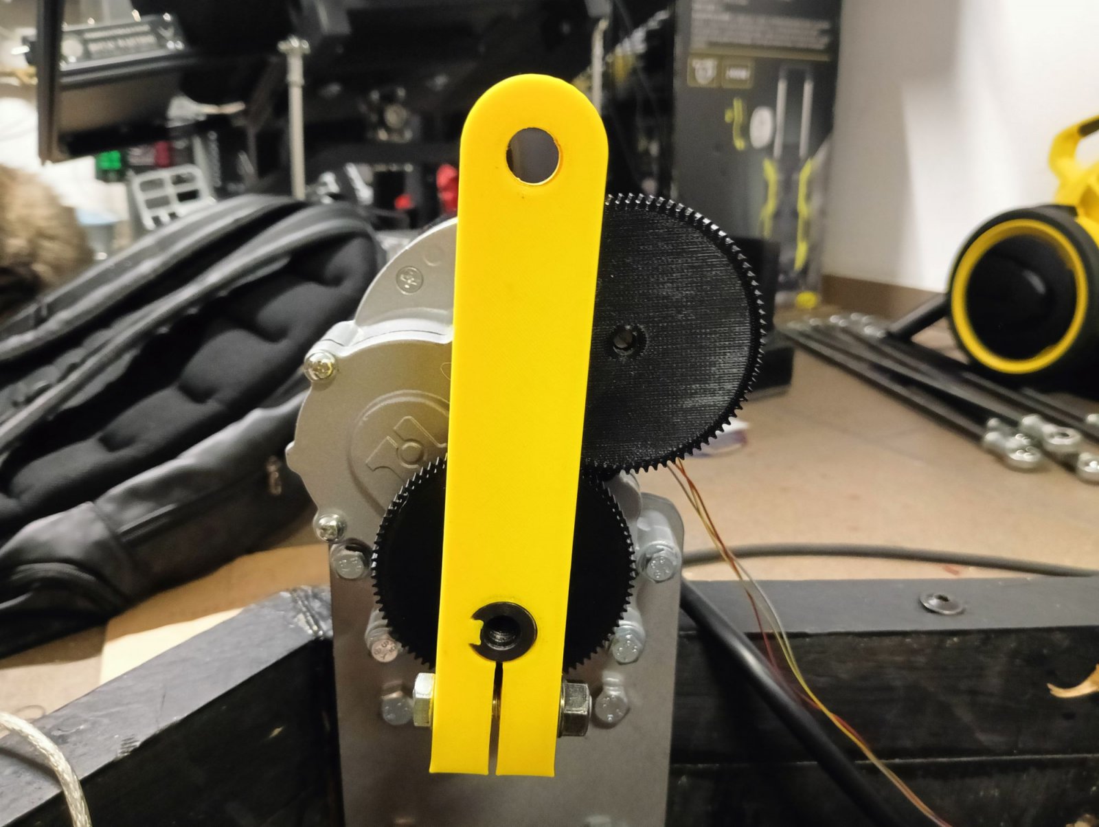

    Below are pictures of a properly set motor arm, in addition, in your case you have more teeth in the pinion on the motor than on the potentiometer which has already been described on the forum that sometimes causes errors , you need to limit the swing of the motor arm max to +45 degrees / -45 degrees from the initial position ( motor arm horizontal to the base ). I printed myself the 86 tooth gears for the motor shaft and the hall sensor shaft so I have a ratio of 1:1. I can provide you with .stl files to print.

    The gears fit quite tightly, they may require some gentle filing to push them onto the axle properly

    I can't see all the pictures but from the one in post #5 my guess is that the gear ratio from the motor aoutput shaft to the hall sensor/potentiometer is more than 2:1. So when your actuator arm rotates 180° the sensor rotates >360° which causes the roll over in the false direction.
    As @Attyla.pl already said, you need to limit your range to less than 180°.

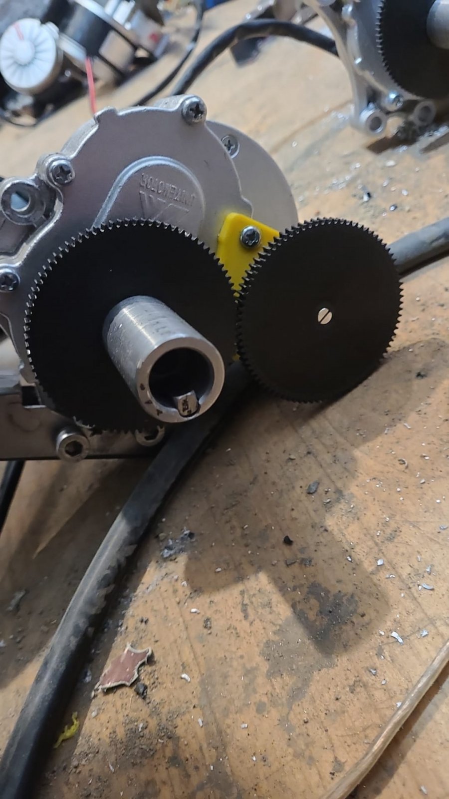

    Thank you all for the advice, it worked but I knew I had missed something... (the relationship between the gears!).
    Thanks again for the files (I'm waiting for my 3D printer for Christmas...), I found while waiting a pair of gears which should already allow me to wait for printing (no more teeth on the potentiometer side with necessarily a larger belt).

    I just received the gear and the belt, it's great my chair remains in range for SMC3!
    Now at each start no more problems, apart from the abrupt start, I tried the SMC3 soft start 1.7a, but the data in SMC3 concerning the maximum power is not recorded? So I'm still in original SMC3, if anyone has a version other than 1.7a fixed for this bug???

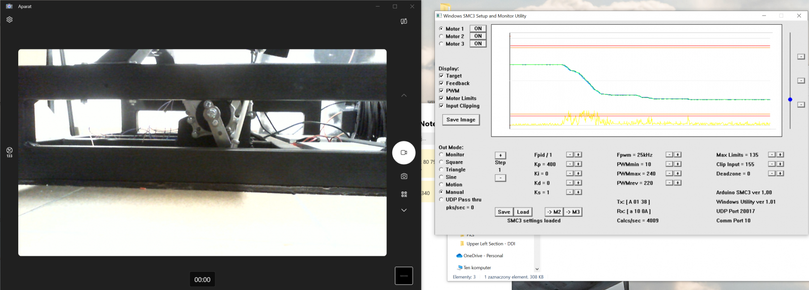

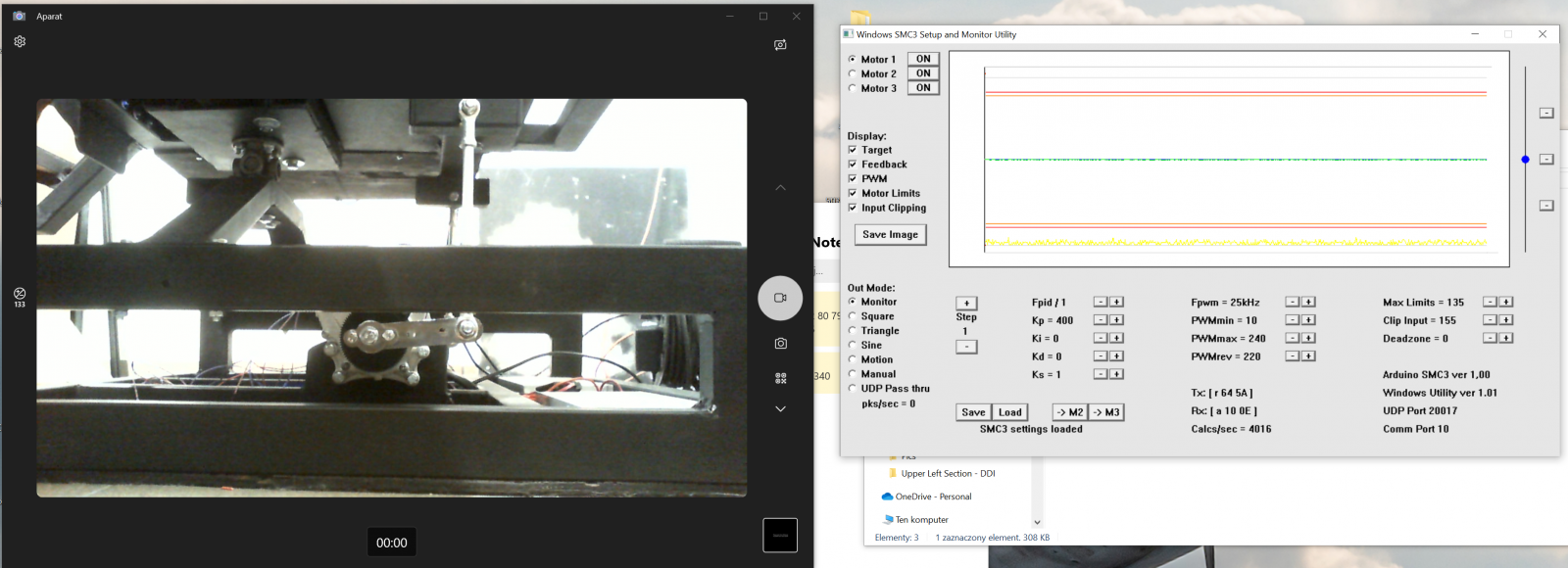

    I'm not a great computer expert, it must play at a level certainly but at the moment I was wrong.
    My problem came from the size of my gears, and I have not completely resolved this problem.
    I printed gears at a 1:1 ratio, but I still exceed the limits under SMC3, what seems to be a good diameter for me is gears of 4 cm in diameter (I am therefore forced to use a belt because I cannot fix my potentiometer closer to the motor axis in my assembly...).
    I will take photos to show better during the day.
