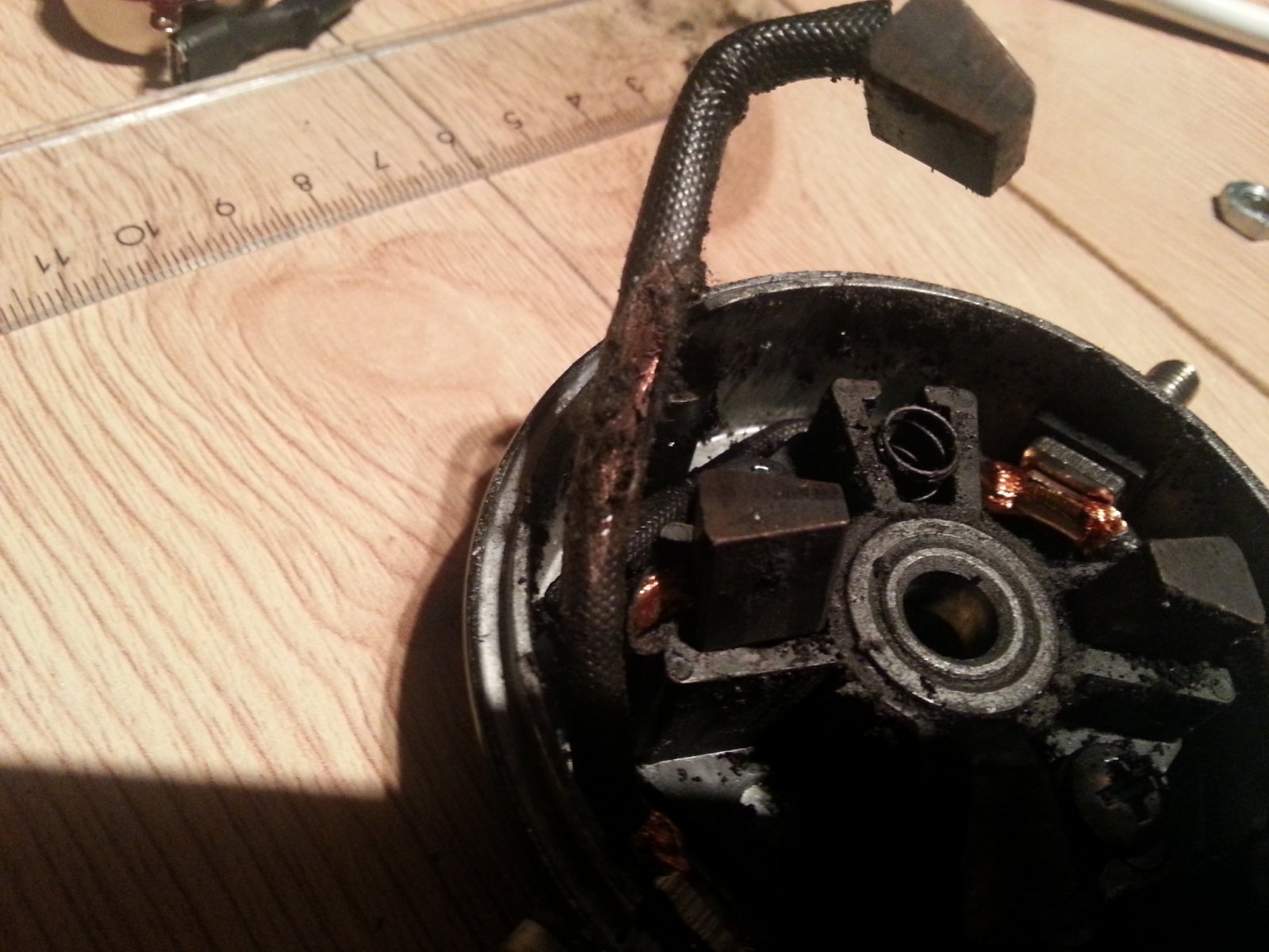

    Update: after playing around using different values of the Ki term (while reducing the Kp term) I could raise up the speed of the winches. They are working now rather stable on the road, only if I enter the gravel tab sometimes the winches stops but only just a few seconds in the most cases.
    At the moment I am happy but dissatisfied :p. I am looking for more options so I found at popolu.com an interesting motor driver which can deliver more current as the moto monster or the jrks: Pololu High-Power Motor Driver 18v25.
    This driver enables bidirectional control and can deliver a continuous 25 A without a heat sink, with a heat sink up to about 35 A of continuous current. Furthermore the driver can tolerate peak currents in excess of 200 A. The winches need a high peak current when turning on so that would be really a great help to avoid the stops...

    After a really heavy testing day going to the limit one axle of one winches has been broken *lol*. That is reality as I like :)

    Update: I must reduce the very fast turns to simulate the vibrations. Those vibrations are responsible for the stops and the very heavy load onto the axles. So I decided to buy a Buttkicker Gamer 2 adding to my rig.

    Update: today I got the other Monster Moto from AliExpress (Sparkfun samples! ). I wired all and all seems to be right in place. First testing connected to the PSU was successful. Tomorrow I will power on the winches and I hope the seat will beat the daylights out of me. :)
  20. Pit
    3,007
    30,498Coins
    +3,097 / 31 / -0
    Winches connected and successfully tested!!!!:D :cheers
    After starting AC the first time using the old values of the tuning center the server PSU (69A) was shutting down at the very first start (surge), WOW :) In addition to it I controlled the 6 voltages rails of each plug if they are all connected. I optimized them for the better fitting and started again (before I will attach a second PSU...). Each winches has 750W if I would use them to the full they need min. 62.5 A. The Monster Motos are now working in "Single Parallel Mode" and can resist the high demand of current. Furthermore the heat development is negligible, too. Finally if we are talking about the cost (Power <=> $), the two Monster Motos Sparkfun samples cost each 17$ (Aliexpress), the Arduino is equally expensive. The final costs are about $50 of the electrical parts without PSU. This is insane! :thumbs
