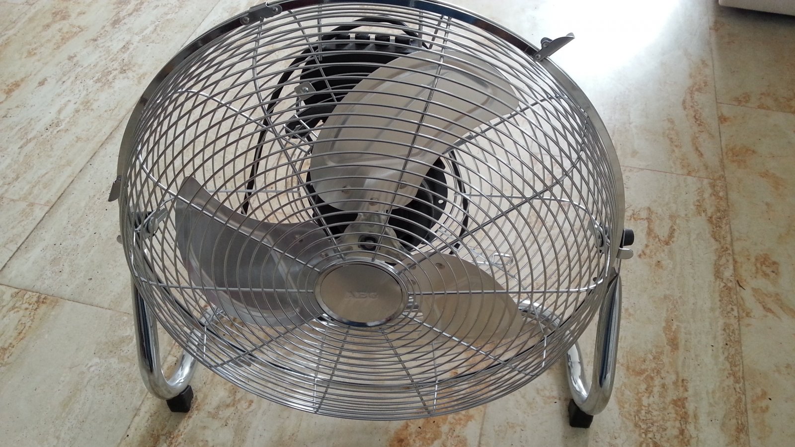

    next project is on the way:
    Finish to be expected end of April.
  4. RacingMat
    2,233
    21,056Coins
    +2,092 / 21 / -2
    just before summer: perfect timing!
    i'm pretty sure, you will stack several of them as per your favorite method :cool:
    ventilo pit.png it will blow our minds!

    loool... unfortunately there is only one nuclear power plant close to me ;)
