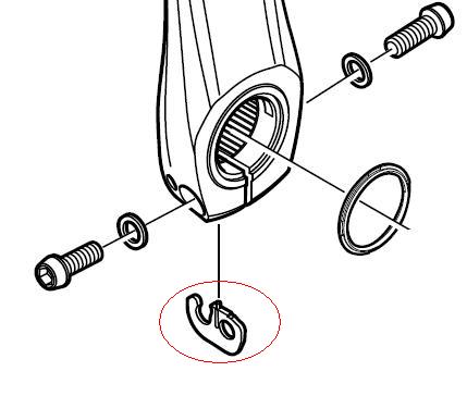

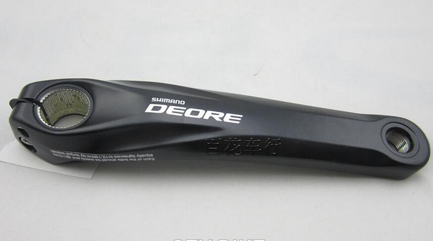

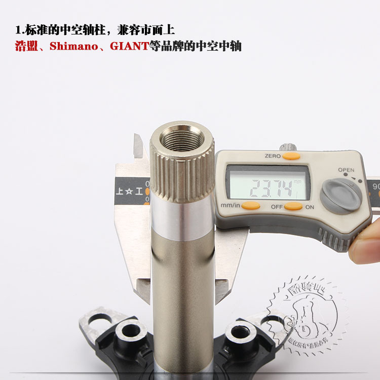

    @Pit: could you please tell us how to source the bicycle part you're using as a lever? keyword or URL link? as cannot find it
    I like it and I'd like to do the same for a 20mm diameter shaft :)
