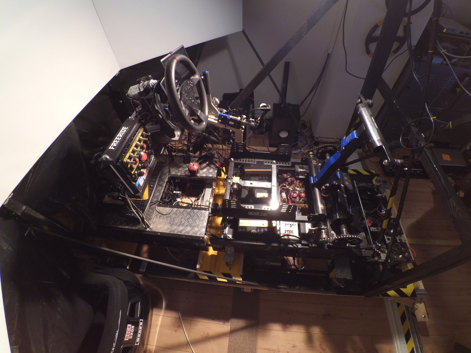

    What happend today so far: while the T500RS is running like a beast (yippiiee), the battery of my car was empty, after starting the car (waiting for dedicated power) the fan's of the car heater didn't work anymore, it became fu*ç"%ç*g cold in the car!!
    Since today there is no more washout filter working (SimTools 2 Alpha), one if these new MMs died 2 seconds after the first test, then the brake pedal (load cell) was beginning to dropout like hell, I am off today and only here to repair something...at the moment I have no separate heave and no working surge and sway tables. If YOU plan to build a BIG simulator, you need more TIME for repairing it than for driving it...lol

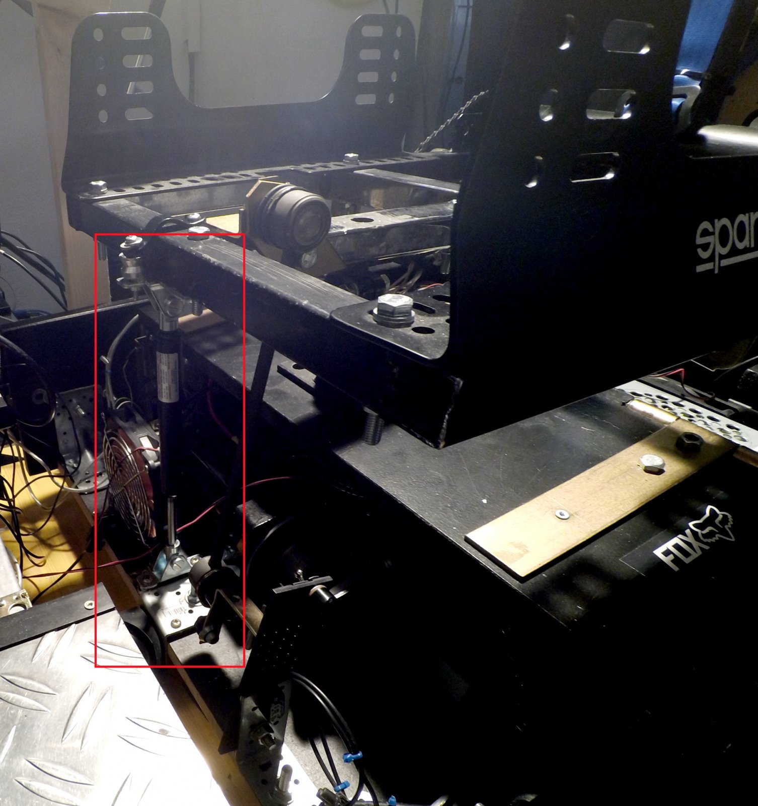

    Small Updates: gas spring installed to avoid high current peaks and overheating of the motor (500N).
    INstalled two pivot heads instead the old and heavy universal joint (10mm):
    Other things to do: replacing the IBM PUs under the seat with a HP ATSN-7000956-Y000) server PSU due to it's interference and much more things to do (fine tuning and optimization):

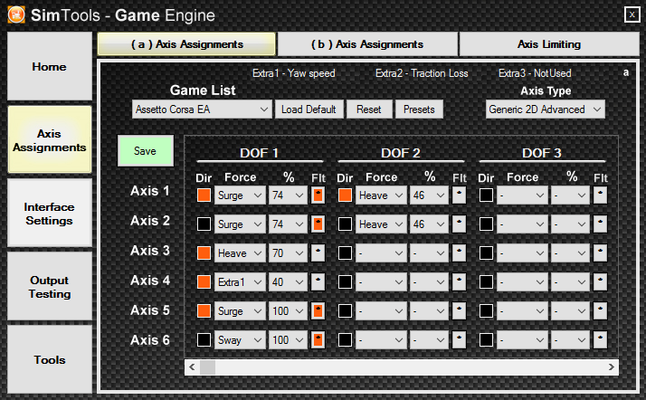

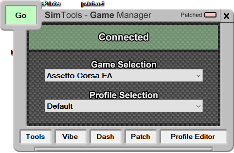

    Testing SimTools 2 Beta 1, already very promising. At the moment we are testing the washout filter, because this option has been not really functional and I can promise already, this new filter is now working as it should. There are some details which are not yet perfect but @yobuddy is keep working hard. Now SimTools 2 supports two Axis Assignments:
    Game manager now with vibe support and a off/on button, from now you have not tho shut down the game manager anymore when you change any values in the game manager while the game is still running. Many more things, if time is ready yobuddy will present all the new details which will happen the next weeks.
