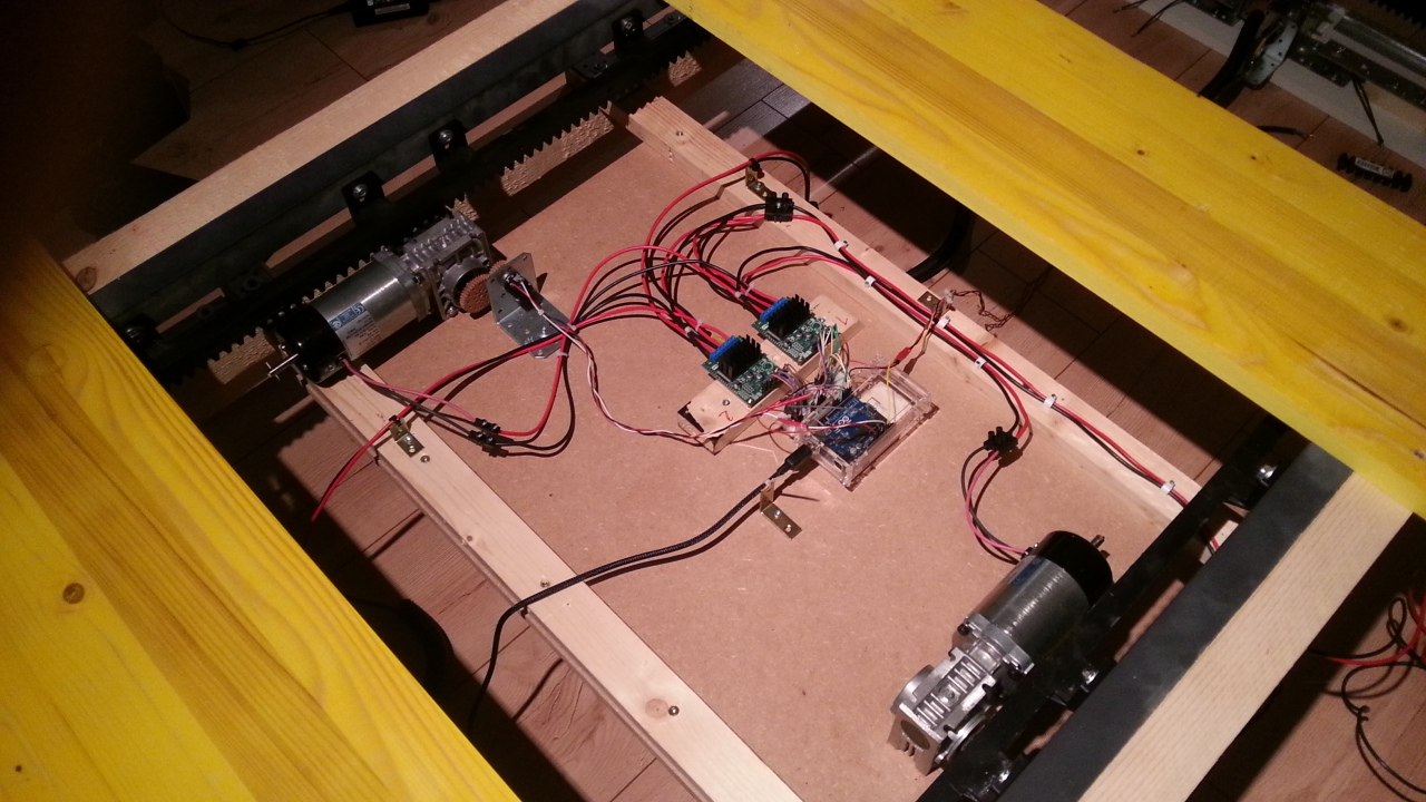

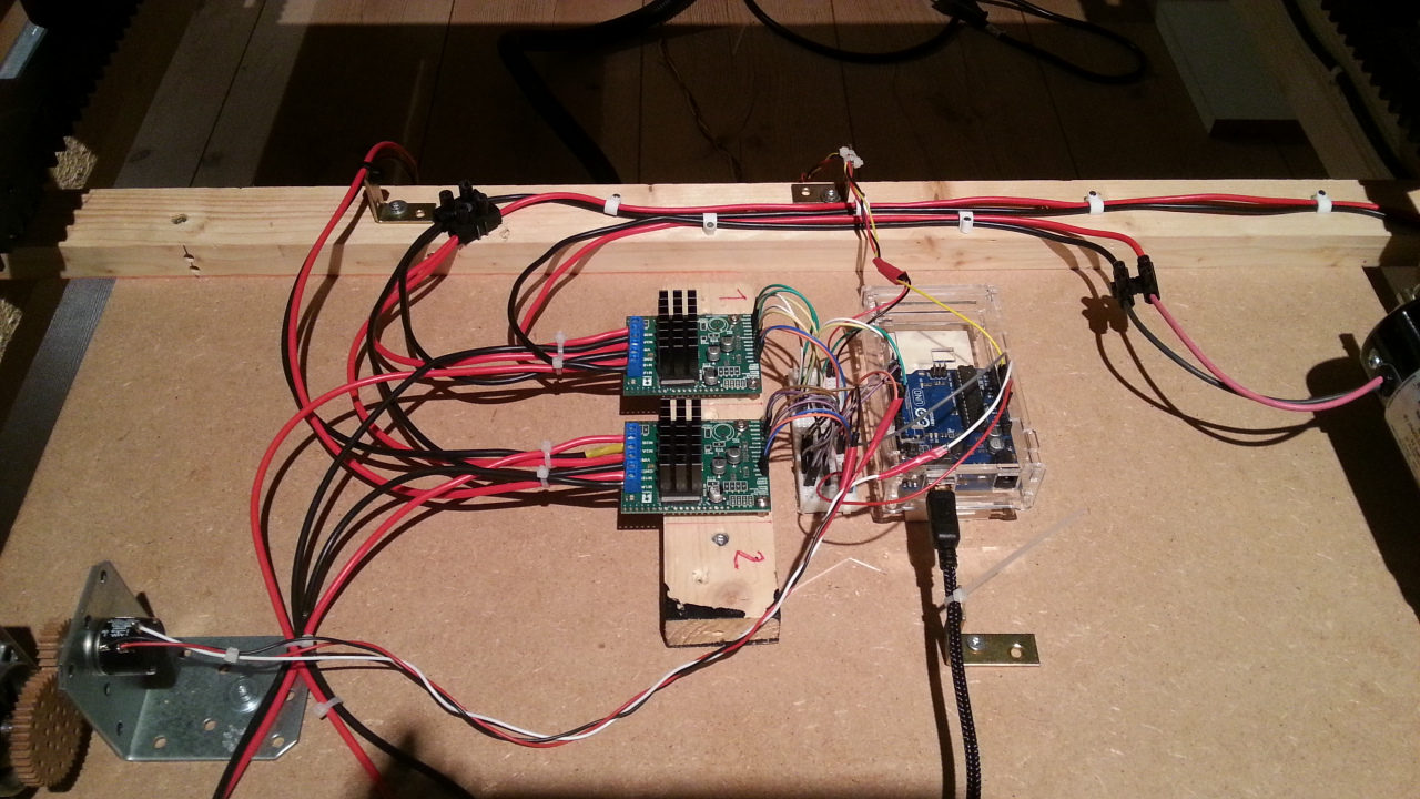

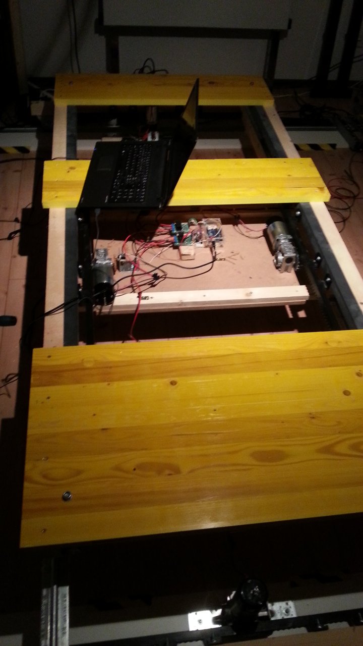

    the second layer is finished. Better photos will be taken later.

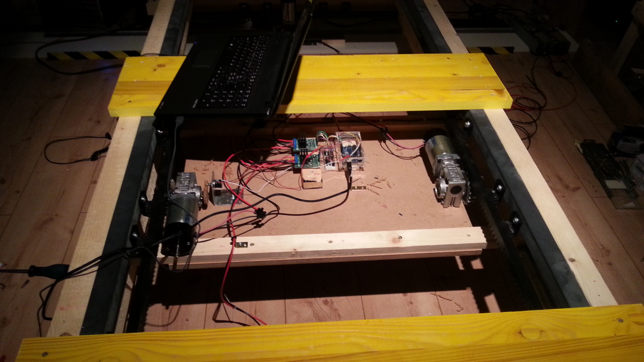

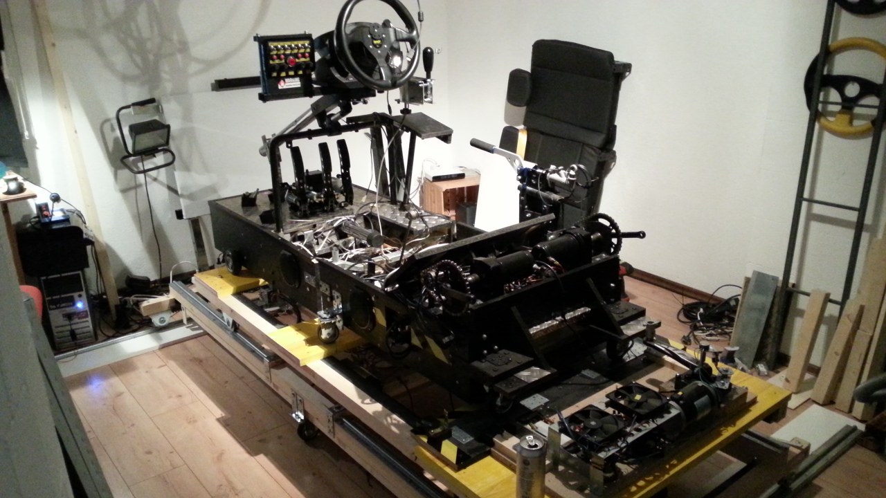

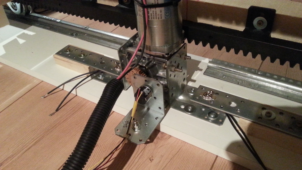

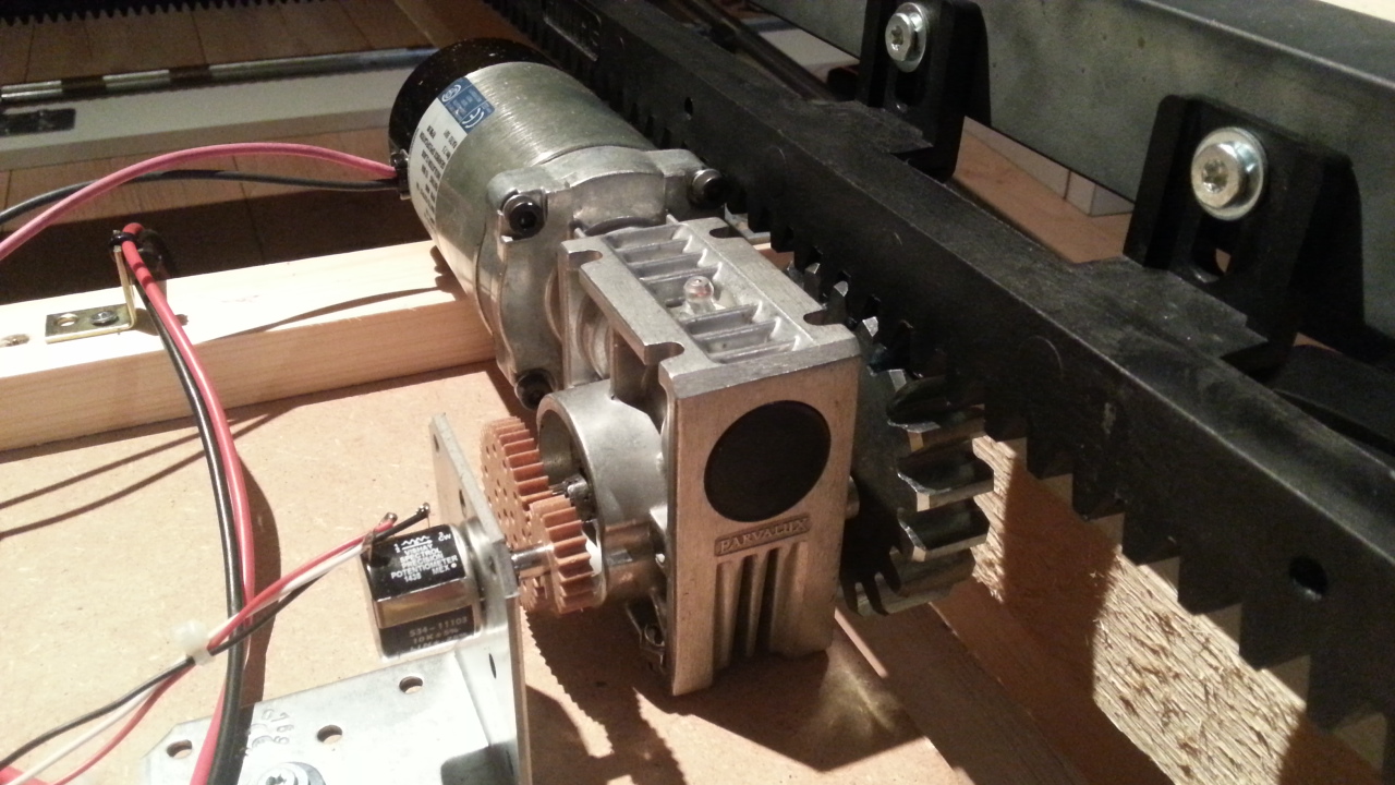

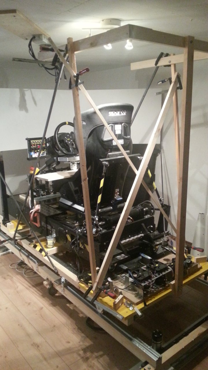

    BTW surge and sway has been already tested, the concept of using rails and gear racks was a success. Now I will assemble all the parts and - the trickiest part - to fix the projectors on the tables. Meanwhile I am optimizing the moves and when all is finished and assembled (and not until then) I will upload a video. But I do not make empty promises if I say the effort was worth the trouble.

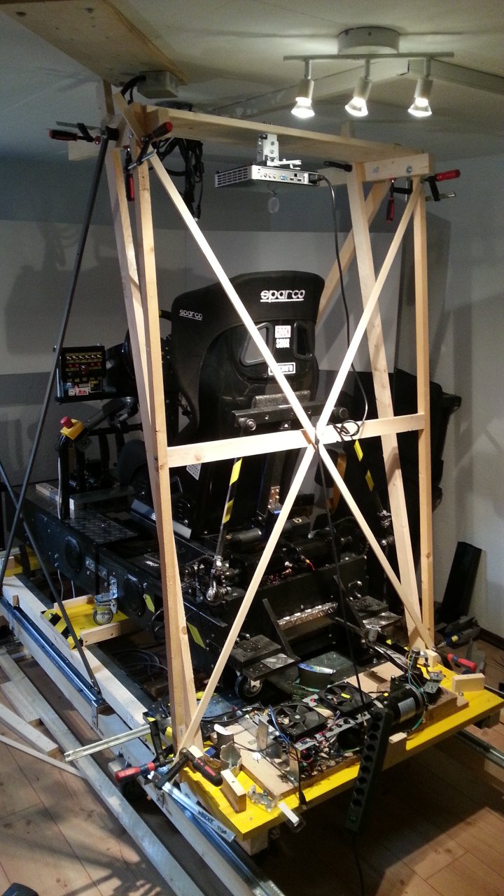

    I am struggling with the projector stand, I have to save weight but at the same time I have to avoid any "mini vibrations", I did already a projector stand which failed due to too much vibrations. The model taken in the picture shows you a test unit (build 2.1 ;) ) The final is expected somewhere around build 18 or so...*sigh*

    It may be easier to build a moving motion system for the cameras and mount it seperate on the roof than it would be to try and eliminate vibration with the sort of motion you run @Pit.

    Thank you both for the suggestions. Unfortunately the projectors have to be placed over the seat and between the seat and the ceiling I have only a few centimeter left. I am experimenting and already build 2 is promising a good result. Today the stand will be reinforced, the evening I will report how it works (or not).

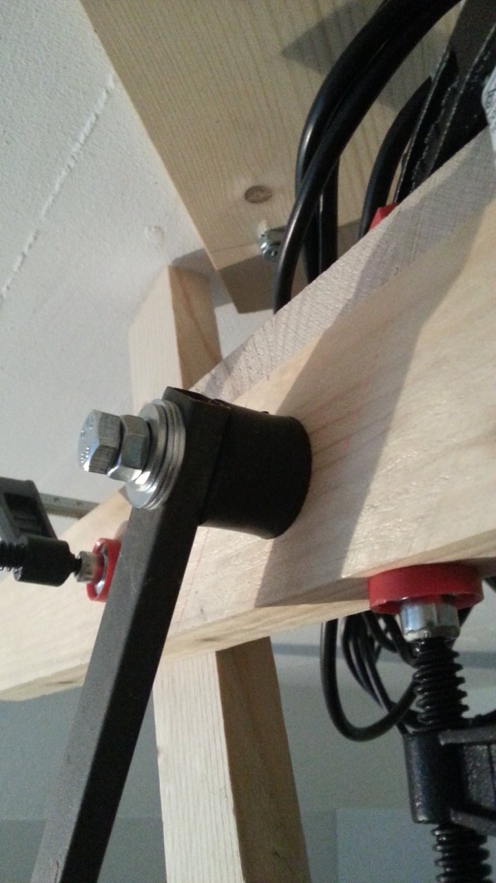

    Build 4 - and it works. I have only very small interferences, and only if I push hard against the rig. I am using rubber buffer.

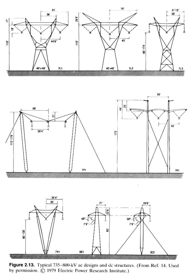

    Hi @Pit ...
    Regarding this video how you used the projector before ...
    So, you may use a slightly over head shelf " crew nest" that hosts the projector ...
    Then mount it to a main mast long enough above your head like the pirate ships :) that use log robes for support ...
    Lightweight firmly stand still and easy to achieve concept ...
    Or ... use the high tension transmission lines tower triangles design to achieve such concept ... plus maybe using some PVC pipes .

    @speedy thanks so much for your thoughts. It sounds crazy but I have (had) to find a mix between stability and flexing - meaning an "antiflex" stand. The layers are build by using wood - a material which likes to flex. While the big forces are no problem, when I was releasing the clutch pedal in a very fast and aggressive way or shifting very hard the small vibrations (jitter) which have occurred have been very annoying. I think I tinkered a reasonable solution now, probably could be better but my hands are demolished by bashing the rig all the time doing the vibration check ;)
