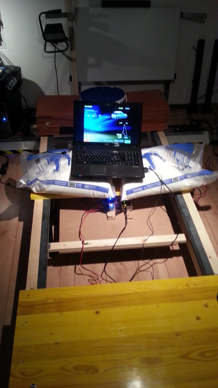

  13. Pit
    3,007
    30,510Coins
    +3,098 / 31 / -0
    tested today an additional load of 200kg including me (the tables are each more than 20KG, so at least 250kg weight) - the table speed is the same, nothing stops and I was afraid that the slabs would falling down. The issue of the motor stalling is only under max Kp and max PWMpower power when abrupt reversing, so I am very pleased about the test from today. Only worrying about the gears they hopefully do not break sometime...
    • Like Like x 5

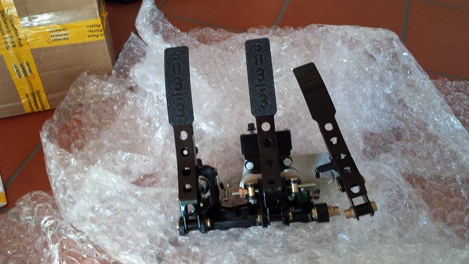

  15. Pit
    3,007
    30,510Coins
    +3,098 / 31 / -0
    :eek::oops::confused::mad:

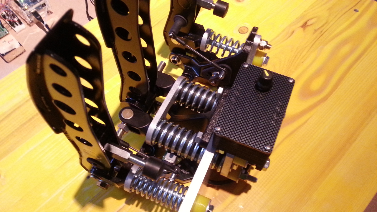

    PS: Derek added a heel-and-toe adapter which I use for the broken part. Derek is not responsible for the damaged parts, but I complained the scratches on the pedals and the craftsmanship finish (not tighten screws firmly)

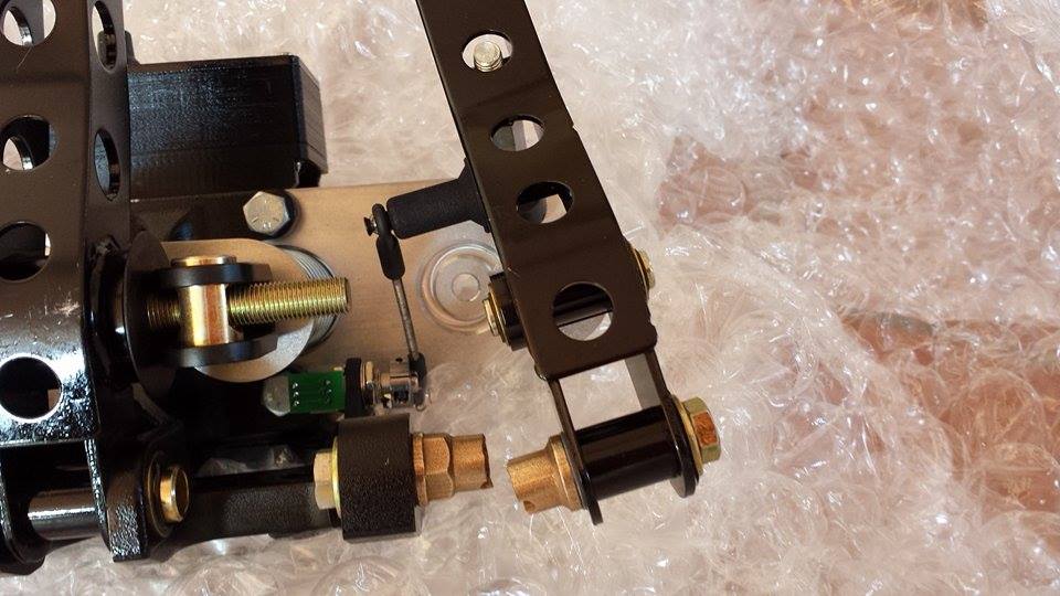

  16. noorbeast
    22,048
    153,884Coins
    +11,154 / 57 / -2
    Ouch!!
    How did that happen, I would have thought the shaft would withstand almost anything.
  17. Pit
    3,007
    30,510Coins
    +3,098 / 31 / -0
    There is a drilled hole in the shaft, IMO a big and fast hit has broken the shaft (like a bone...). Nothing else is damaged, Derek added a heel-and-toe adapter which I can use to repair the pedals (anyway at the moment I prefer heel-and-toe)

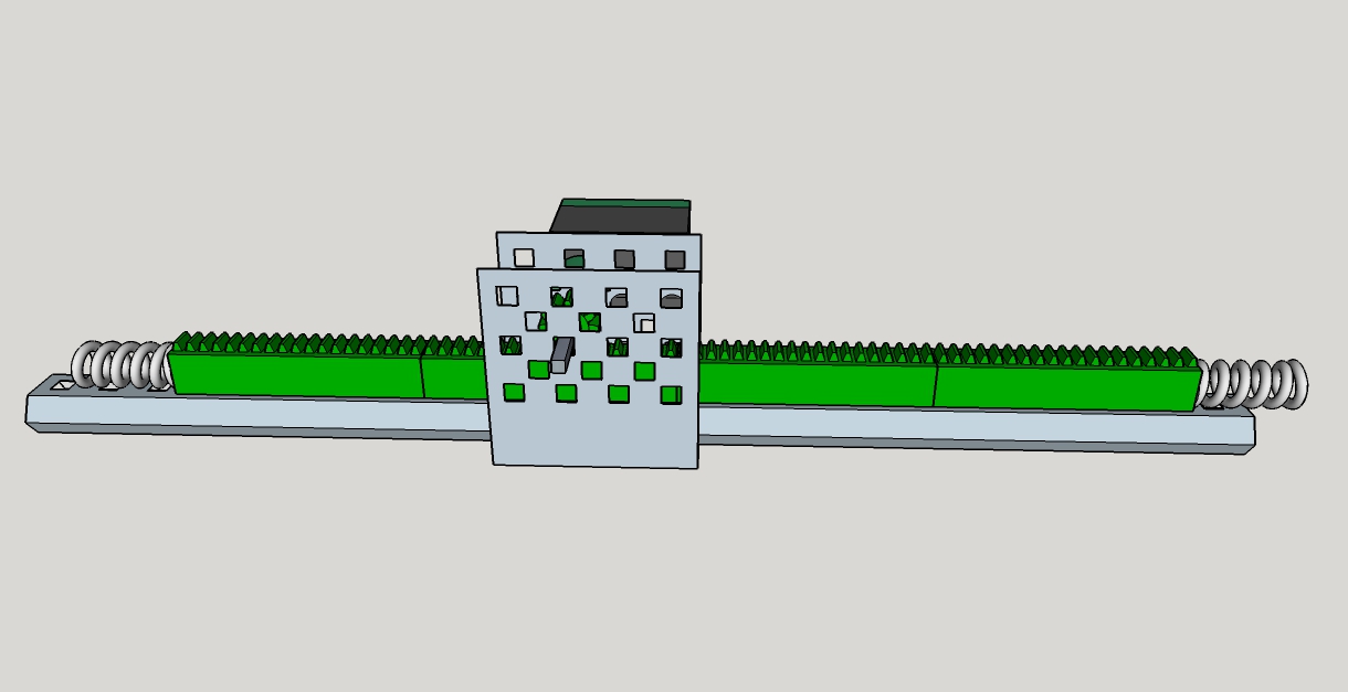

  18. speedy
    speedy Well-Known Member
    Feb 1, 2012
    1,193
    Alexandria , Egypt
    7,948Coins
    +1,287 / 10 / -0
    Exactly :thumbs ...
    plus I have an Idea for the sudden abrupt motion stalles the motors at the beginning ... :nerd
    Add side springs to the rack ...
    like the springs in the clutch disk of the car ... absorbs/push/smoothen the sudden changes in the motor rpm .
    this will need to make the rack lateral moving a little bit as the spring length .
    • Creative Creative x 2

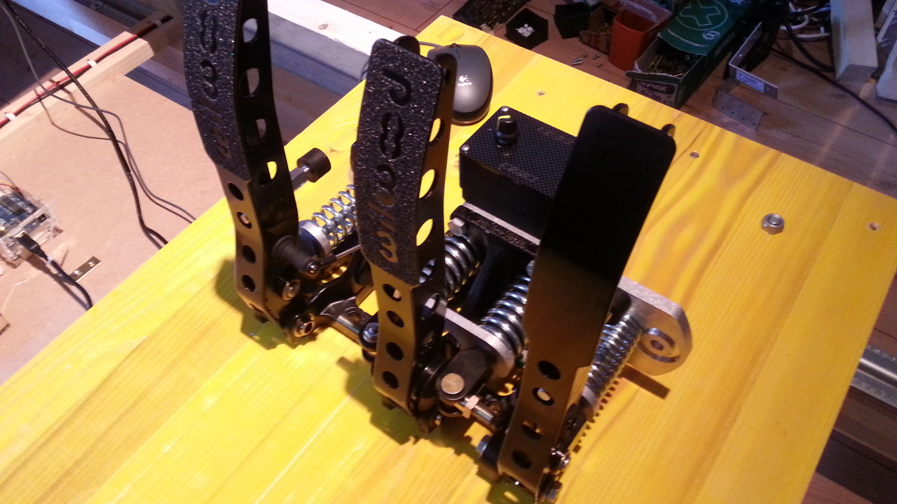

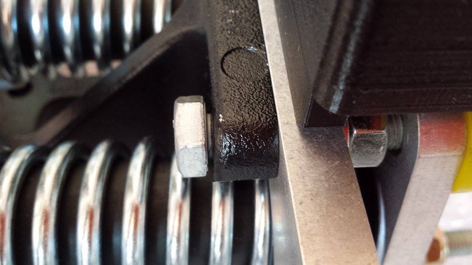

  19. Pit
    3,007
    30,510Coins
    +3,098 / 31 / -0
    Many parts disassembled (the springs of the brake have not been very well adjusted, quasi oblique-angled) and assembled even in a different and wanted way, some screws have not been tightened before and I shorted the mini shaft of the clutch potentiometer for a wider angle. Now the pedals looks nice and I hope it will do the job :)
  20. Pit
    3,007
    30,510Coins
    +3,098 / 31 / -0
    lol, indeed, you are the master of engineering - if my concept will fail I will be happy to implement your great idea
    :cheers
