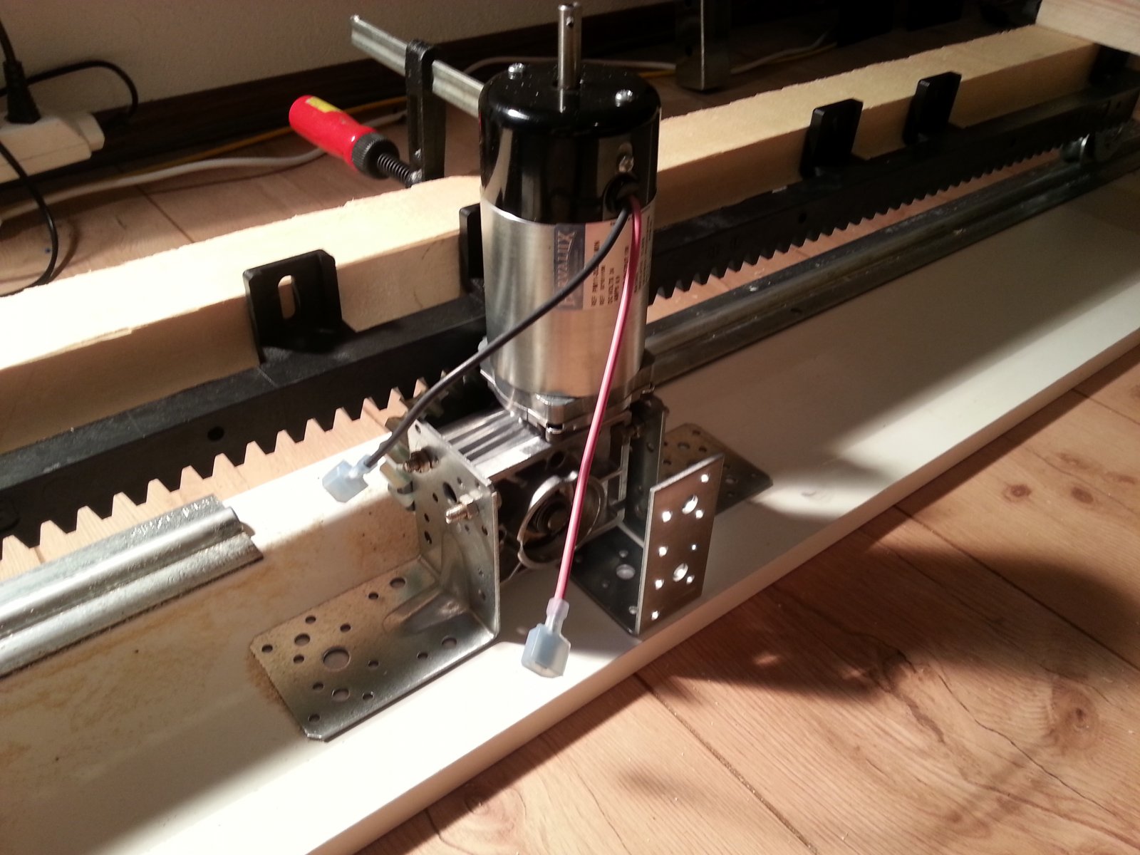

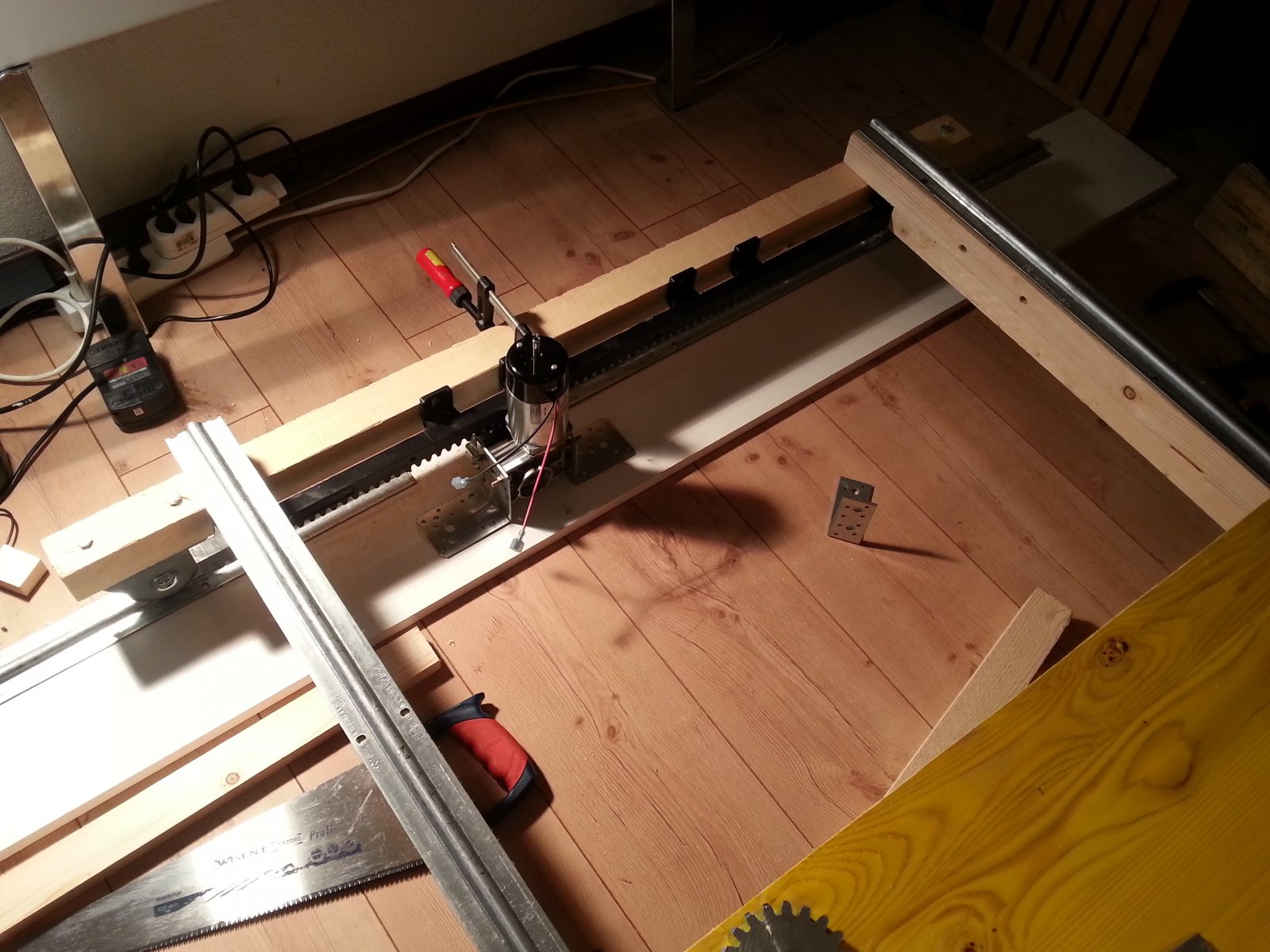

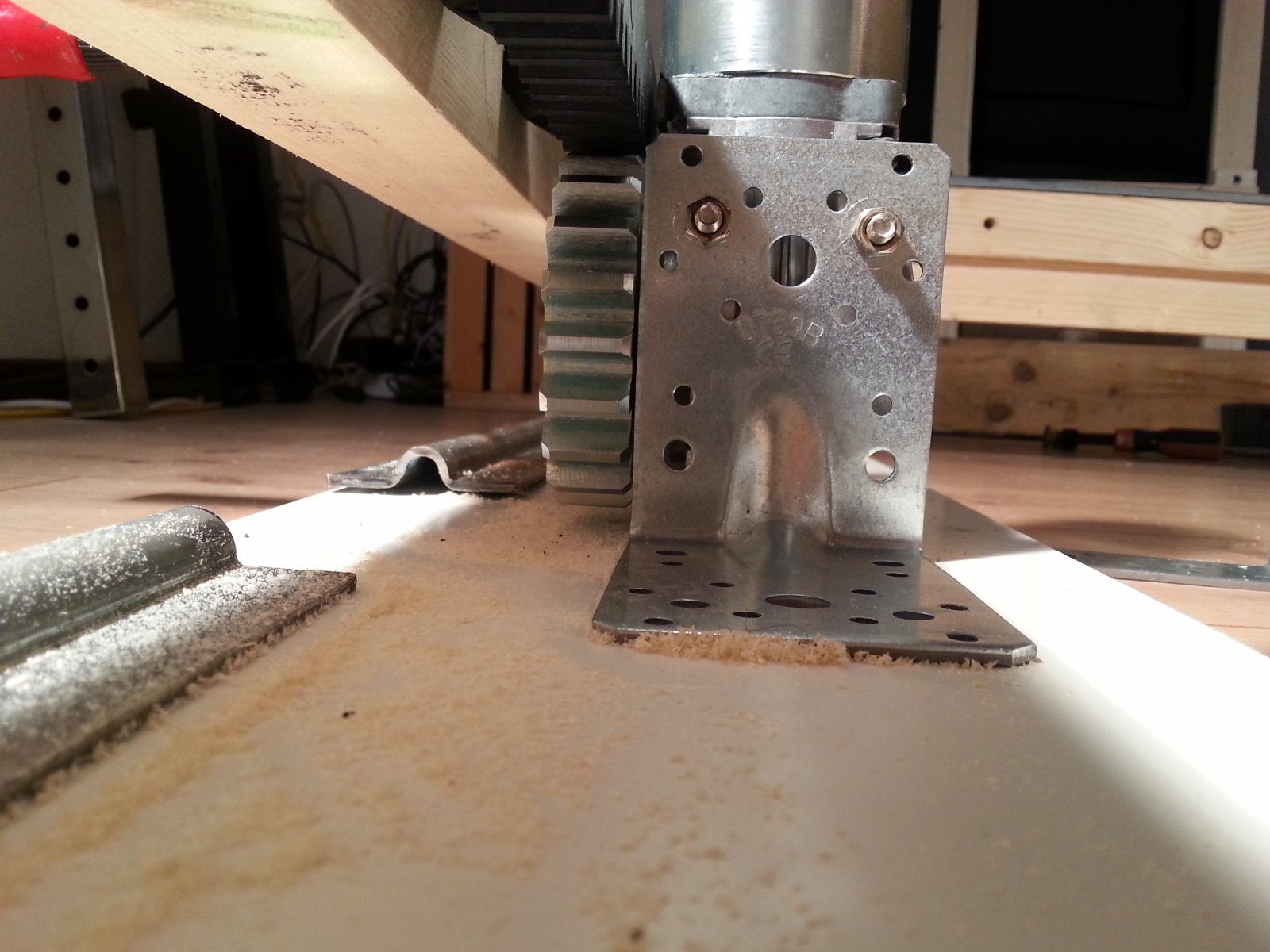

    Progress today: after 1 million not working ideas and tinkering I think I got it - the way how the motors will drive the sway table (one motor at the front and one at the back):

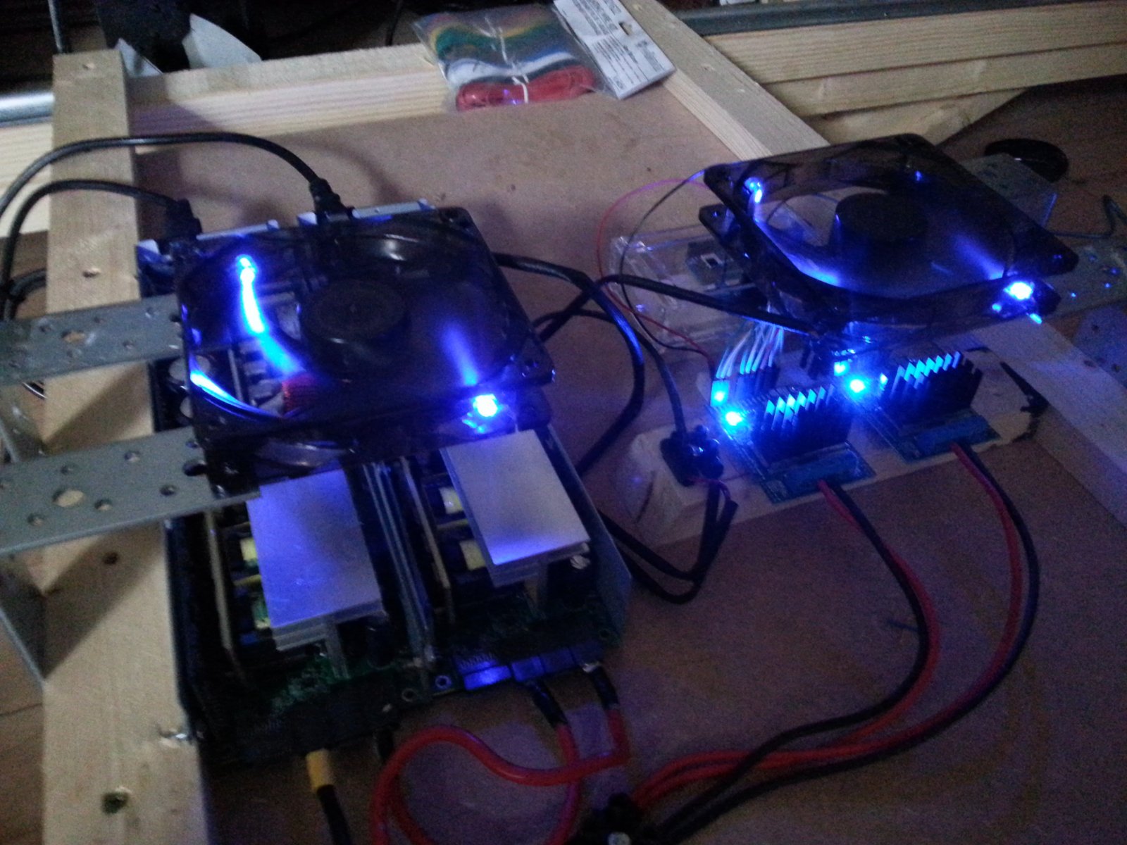

    Electronic parts are up and running, all successfully tested. The Pololu VNH5019 are high quality samples, the chips are totally flush to each other, nothing to compare to all MMs I ever had.

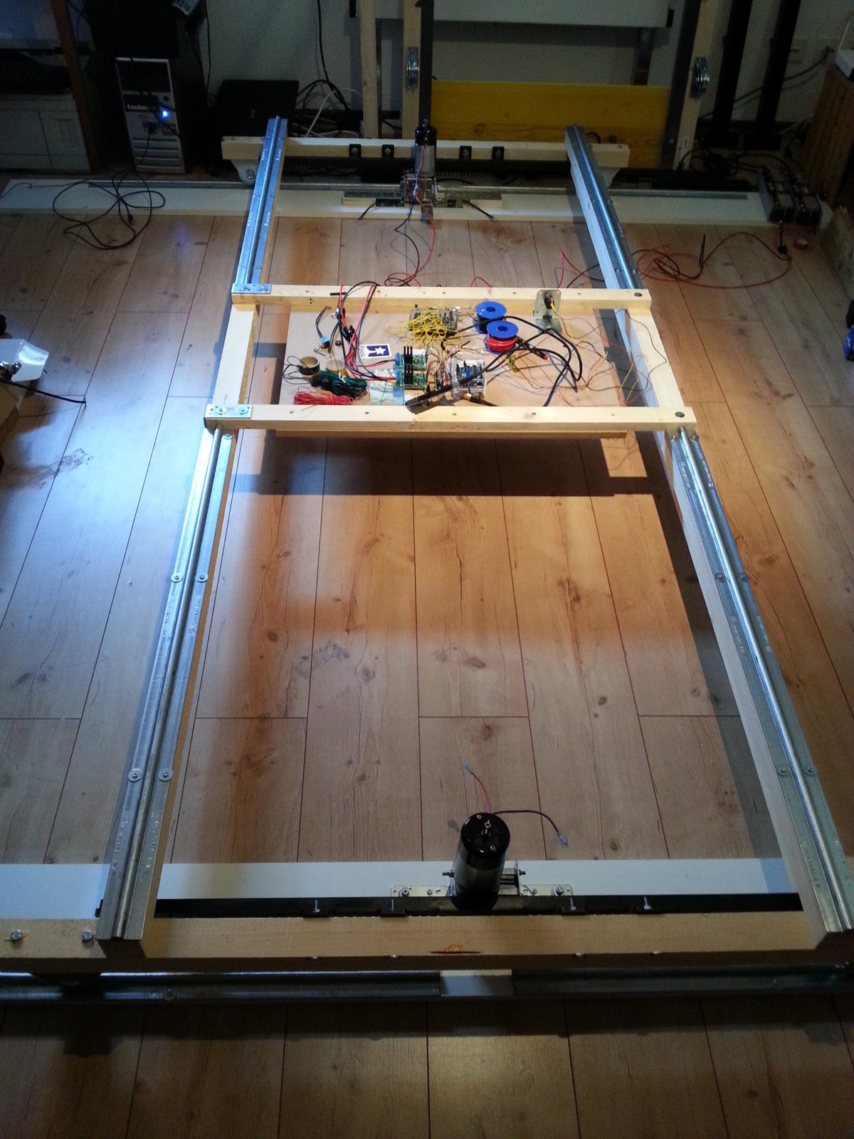

    The first layer is "ready", only the PSUs have to be reconnected on the layer and the second motor, too (to be functional), so be patient this evening I will present you the first moves :p -
