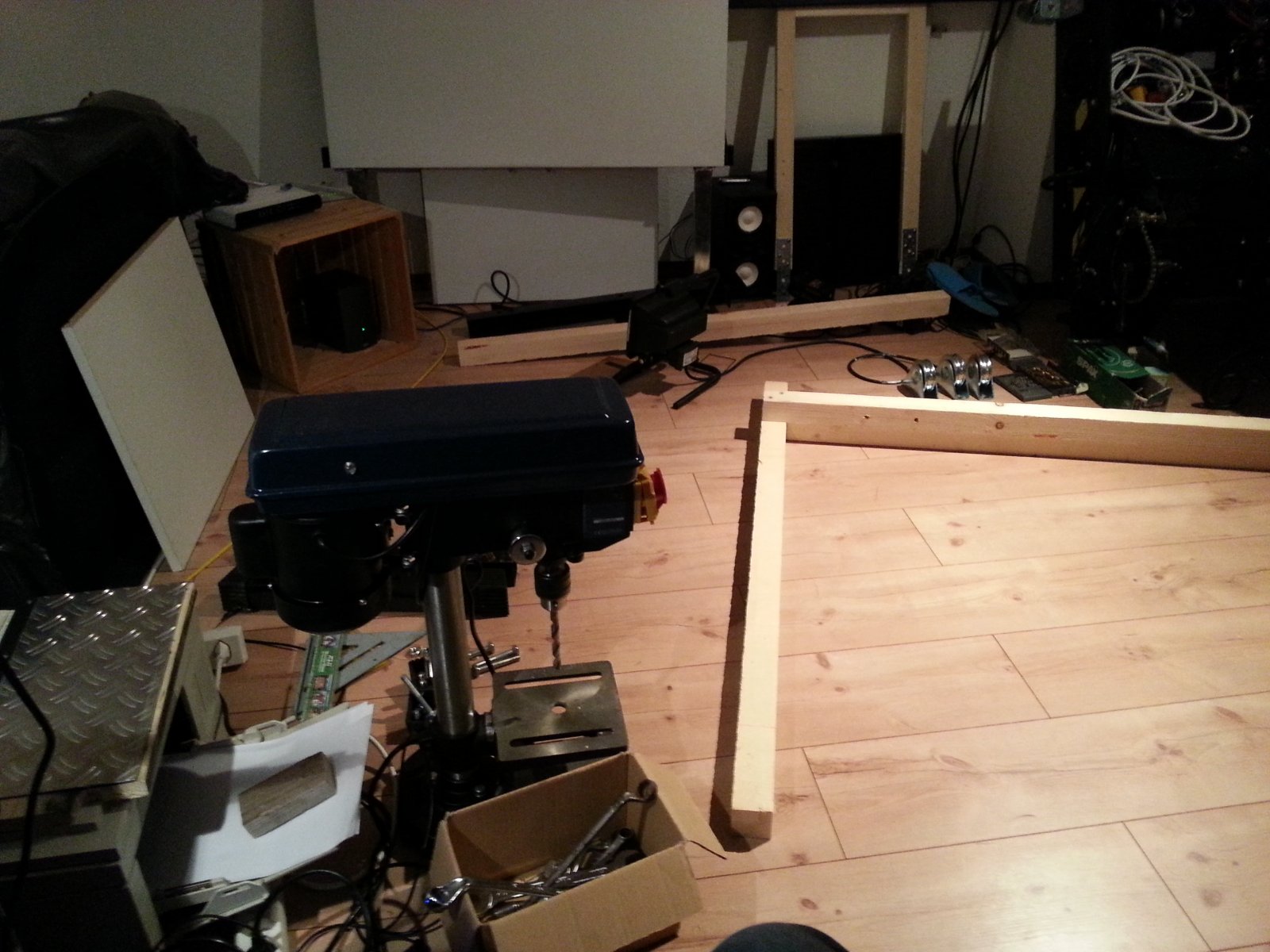

    Hi Mat, the concept is yet in my brain only, but I have my ideas how to implement all parts together.

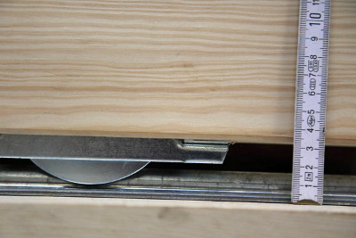

    Imaging two independent tables, each have 4 pulleys rolling on rails like on the photo below:

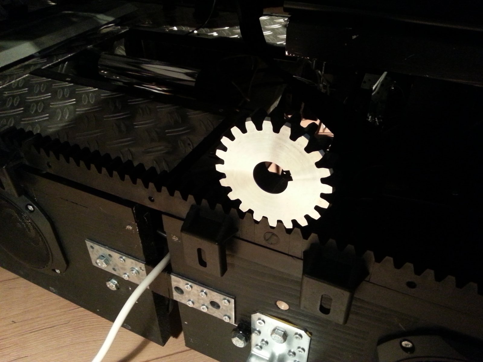

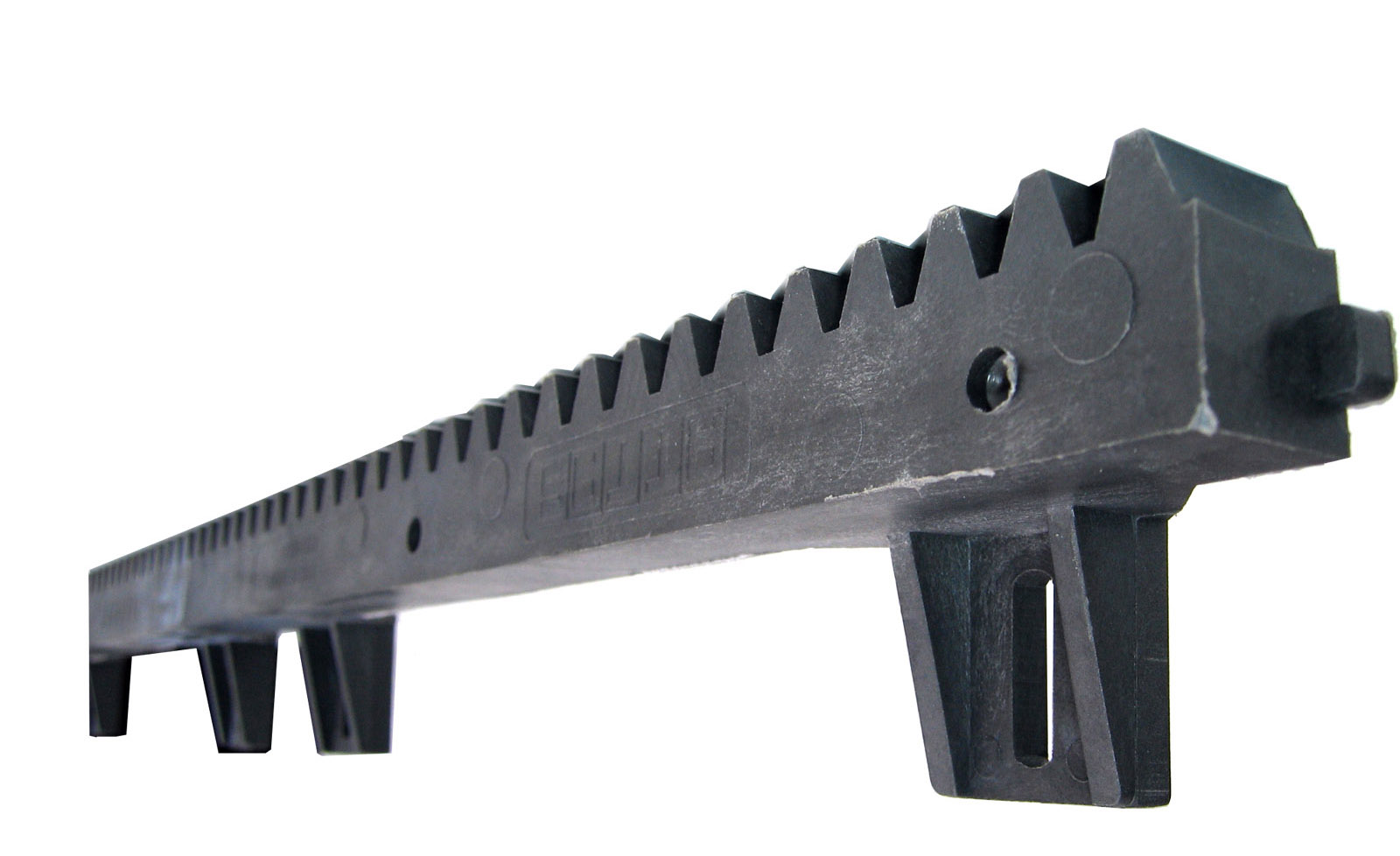

    The 20t gear
    will be welded onto the drive shaft of the motor. The gear is rolling on the rack respectively driving the rack
    which is 1m long. That means, my concept allows to have 50cm for sway (left and right movement), and probably 60cm for surge acceleration and 40% braking (if this is practical), due to the washout function the table should move backwards to the start position after an acceleration (f.eg. while shifting the gear)
    The details follow later because I have to size the room and then I have to sketch the detailed concept.
    The biggest problem is now to bring the displays and the projectors on the surge table and most important for me the projectors have not not to wobble at all. This results in a big effort and a very massy platform. Due to the weight constrains I have to use the slide door pulleys and rails which can resist of that without to be too noisy.

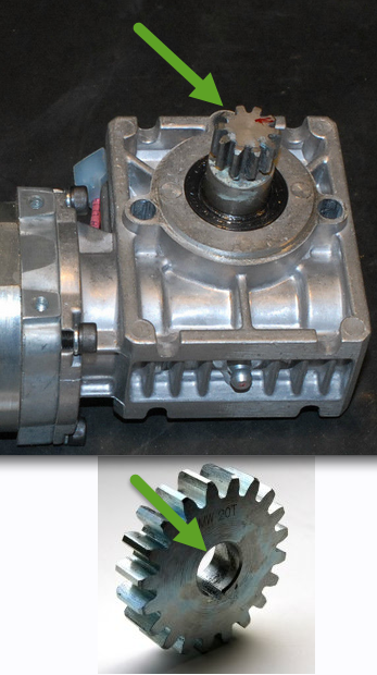

    My point was about the mating of these two pieces:
    About your tables, the trick is to insure that both tables keep parallel! I'm sure you will figure out a good solution

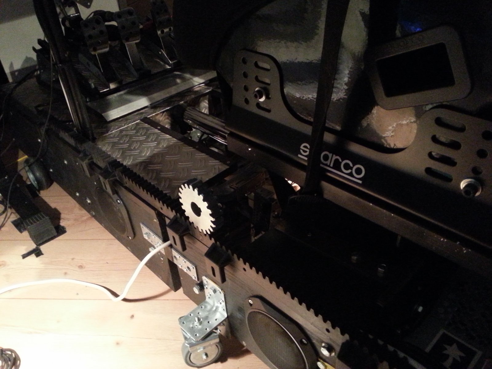

    Probably it is not clear what I mean, the 4 pulleys are sticked to the surge table. The table will be driven by the motors using the gears and gear rack which is sticked to the table, of course. Do you understand what I try to explain?

    Good Idea ... just put the motors in the fixed base-table 1 and the rack on the upper moving table 2 with rubber rollers .
    But, How about the torque calculation ? ...
    Pushing the moving table back and forth will need a very powerful mechanism ...
    A small gear attached to the motor output shaft will provide you with the enough force but with a slow linear speed .
    What are the motors rated output torque ?
    What are the 20t gears diameter ?

  11. Pit
    3,007
    30,501Coins
    +3,098 / 31 / -0

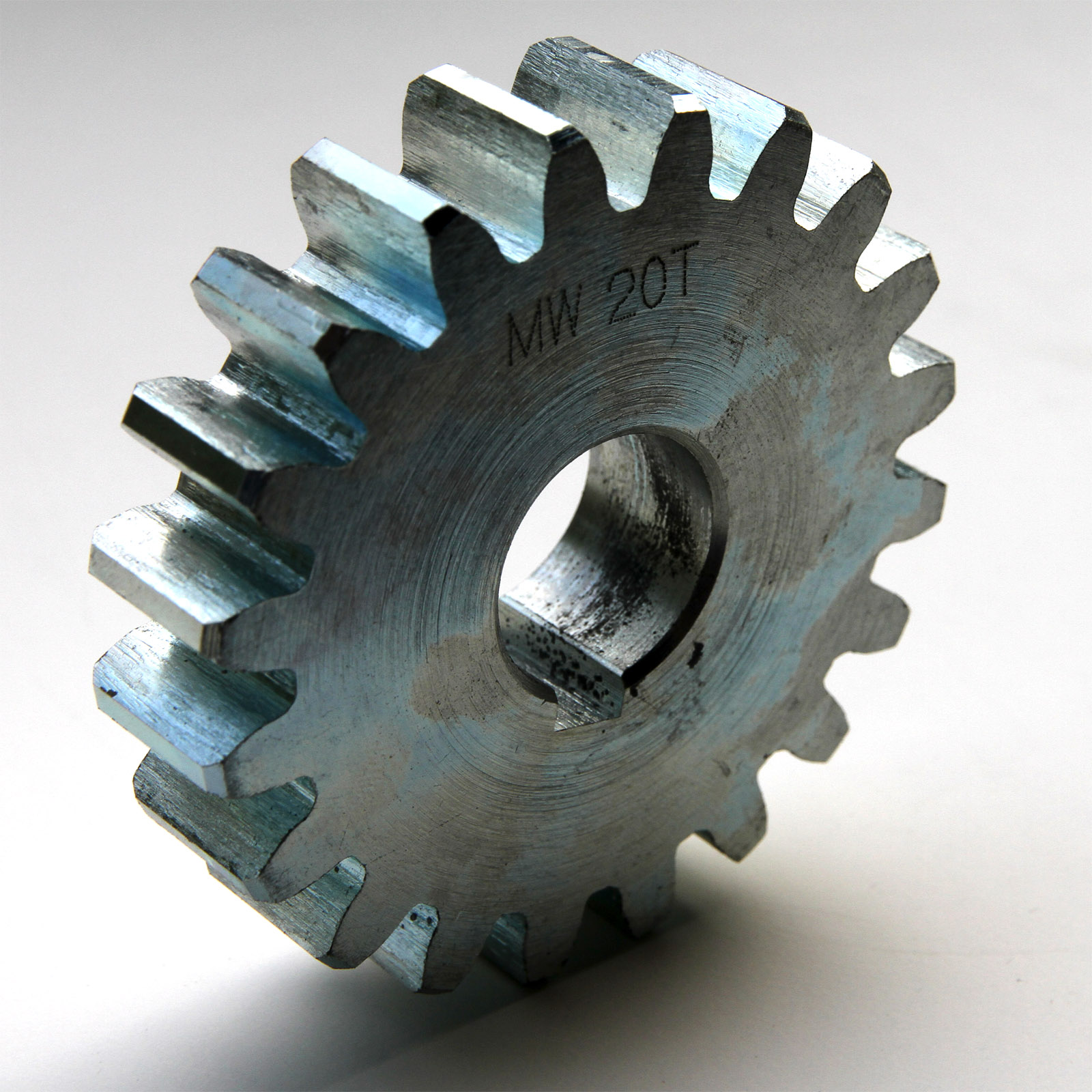

    one gear rack and one 20t gear 2KG together :eek: :D
    The place where they are is only for viewing purposes.

    Wow ... That is huge gear :) .

    +1,287 / 10 / -0
    If the small gear is big enough . So I guess he might use the grinder to shape the small gear to fit inside the big one with the male key-way .
    Then making a center hole to it and thread it to accept a fastening screw .

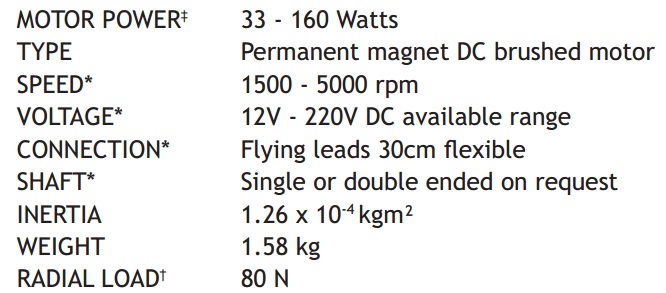

    I just need to know the output axial torque of that 300W motor ? If available please .
  17. Pit
    3,007
    30,501Coins
    +3,098 / 31 / -0
    Not 300W, max. 160W each motor, my configuration allows 2 x 130W (each 24V =7A ≙ 12V= 14A = summa summarum 14A / 24V)

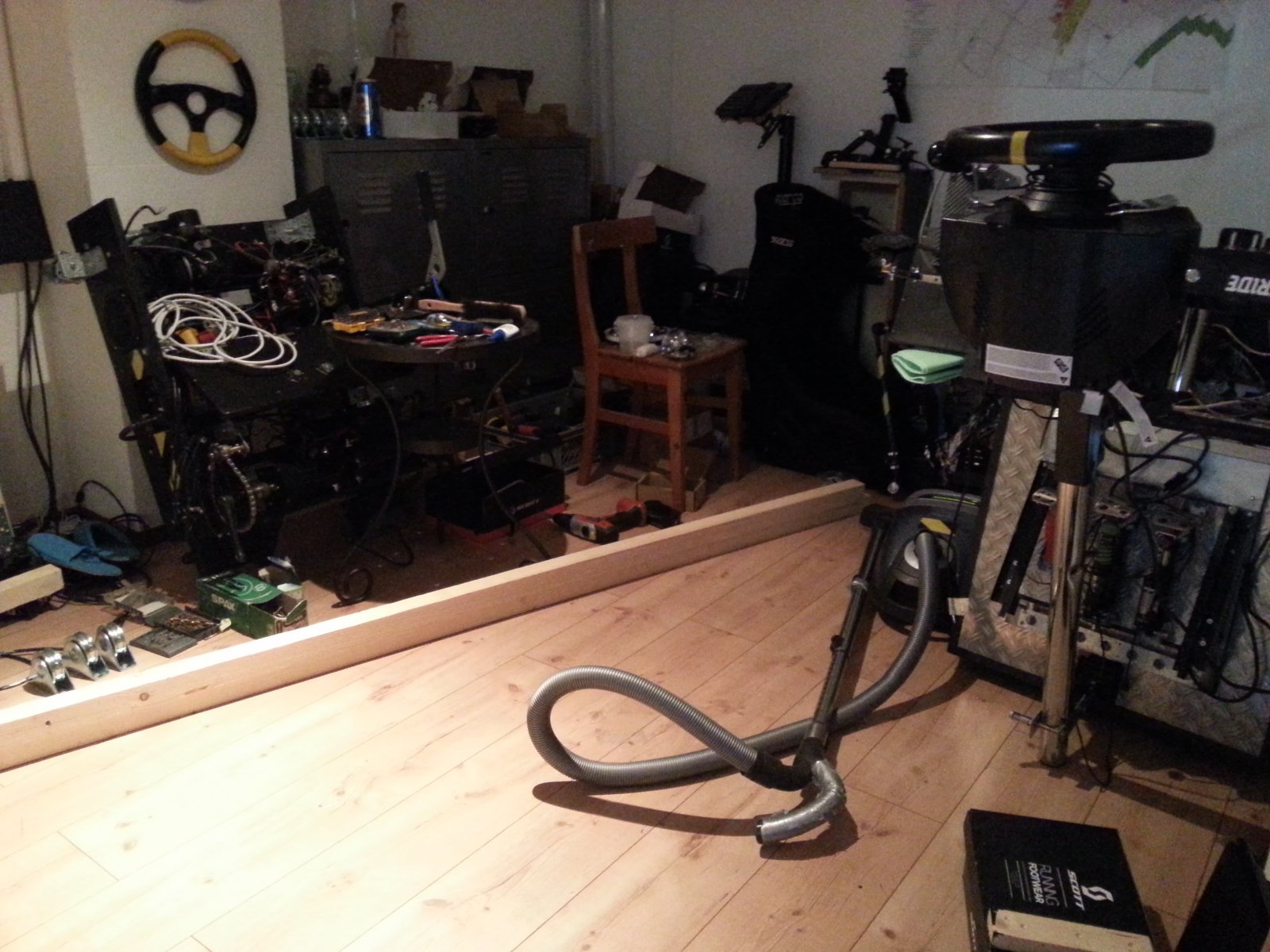

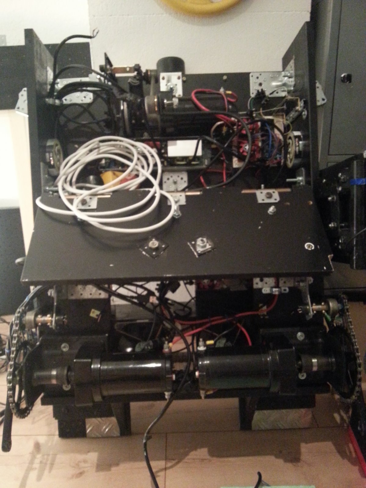

    the beginning, all parts are now available.
    The back of the rig for now on a vertical position:
