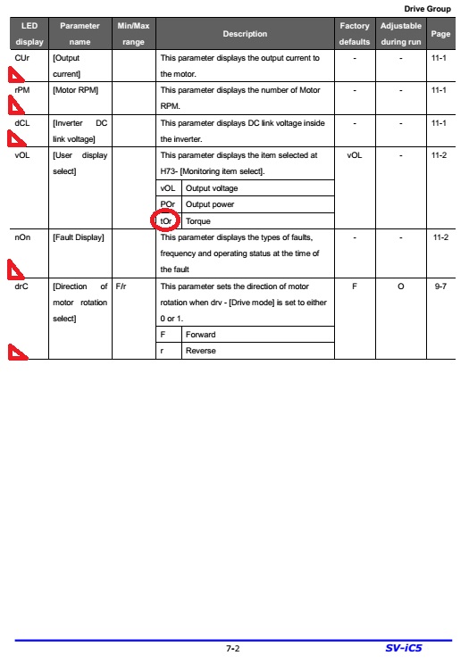

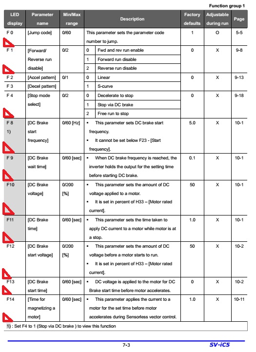

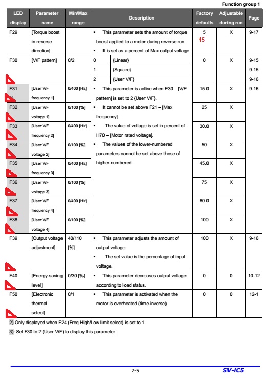

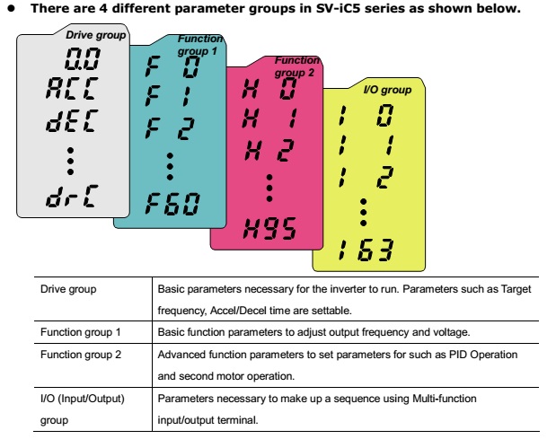

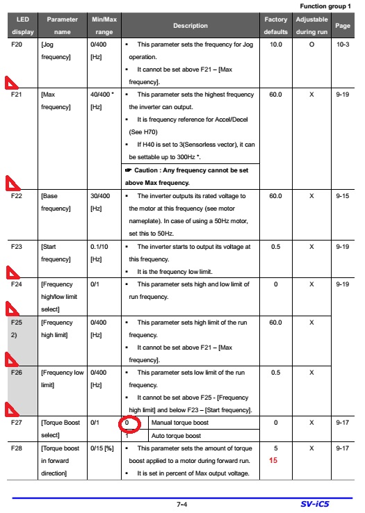

    I want to share my VFD settings and I'll start with the LS-IC5 which it's full manual can be downloaded from here ...
    I'll state the page No. and edit a photo for it with the chosen parameters accordingly ...
  5. speedy
    speedy Well-Known Member
    Feb 1, 2012
    1,193
    Alexandria , Egypt
    7,943Coins
    +1,287 / 10 / -0

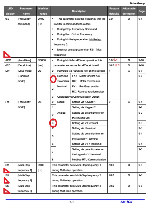

    Starting with the Drive group ...
    the Red triangle = factory default .
    the Red circle / values = selections .
  6. speedy
    Feb 1, 2012
    1,193
    Alexandria , Egypt
    7,943Coins
    +1,287 / 10 / -0

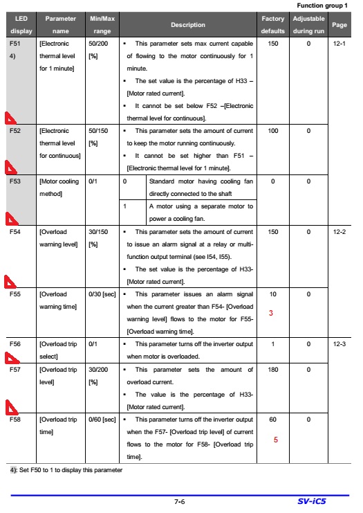

    The Function group 1 :

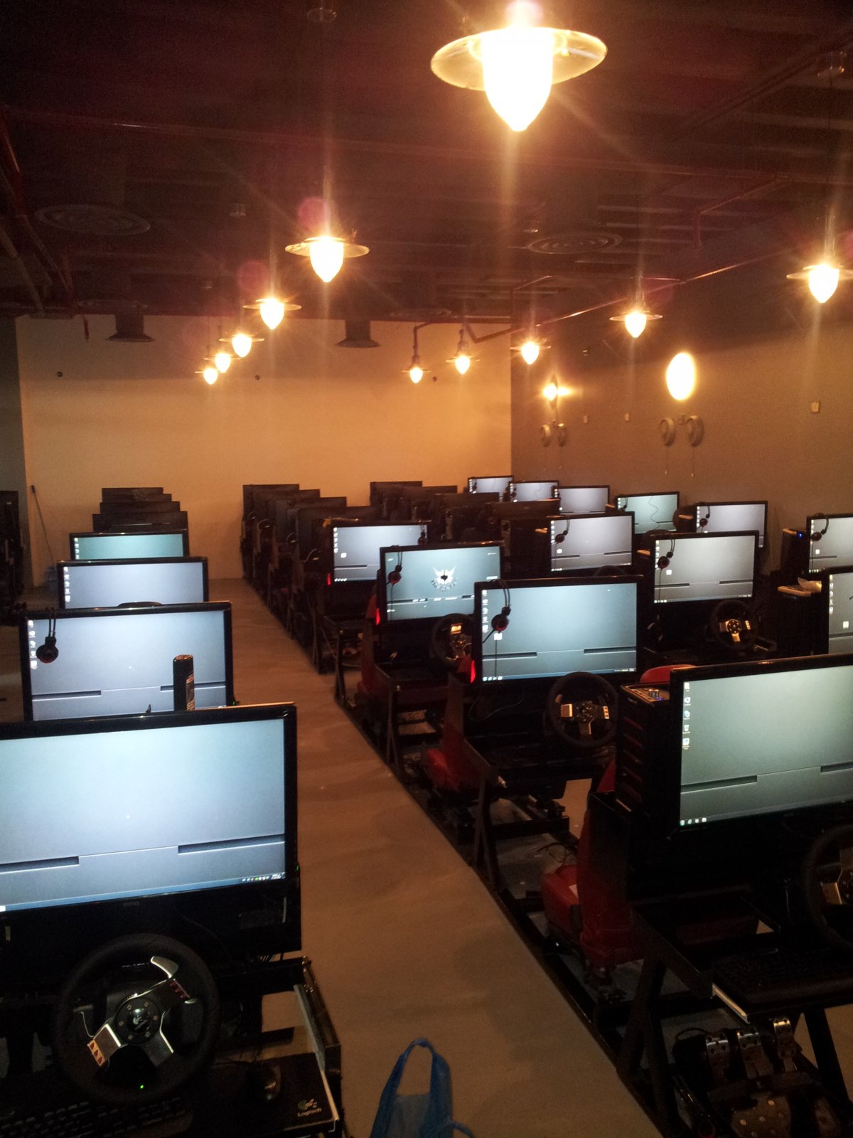

    nice men, googy make every thing easy.
    i'm happy that you reply me speedy. sorry for being late was very busy in my internet cafe.
    look man. here in kuwait they are interesting in car drifting and they call it TAFHEET in arabic تفحيط
    i make a fixed base and it succeeded. they like it very much.
    now i develop it to as i mentioned before to 2 dof .
    i like your project and interest in it if we can make it here in kuwait.
    i thing it is heavy duty. i can bring you any parts if not avaliable in egypt for example if you can convert it using jrk or as you like.
    need to build or decrease the space as i see it's big.
    i can't come egypt right now cos my sons in schools and my work too. i'll be in touch with you.

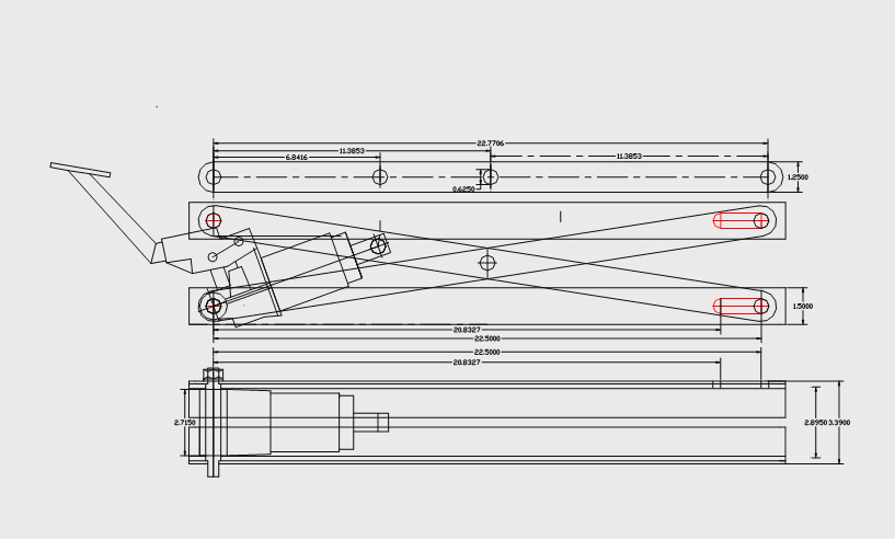

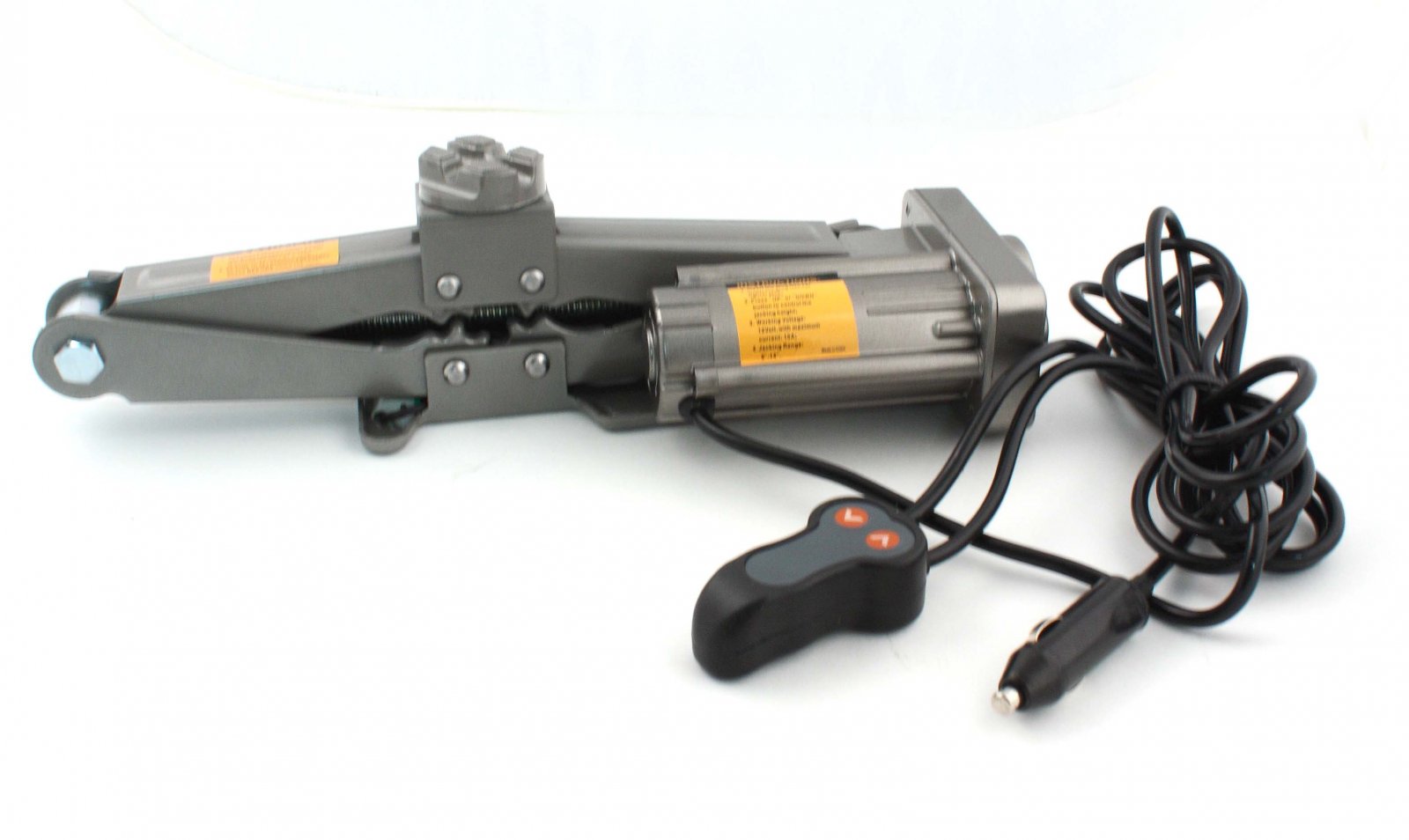

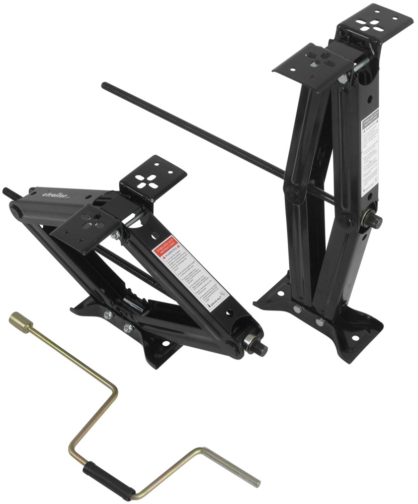

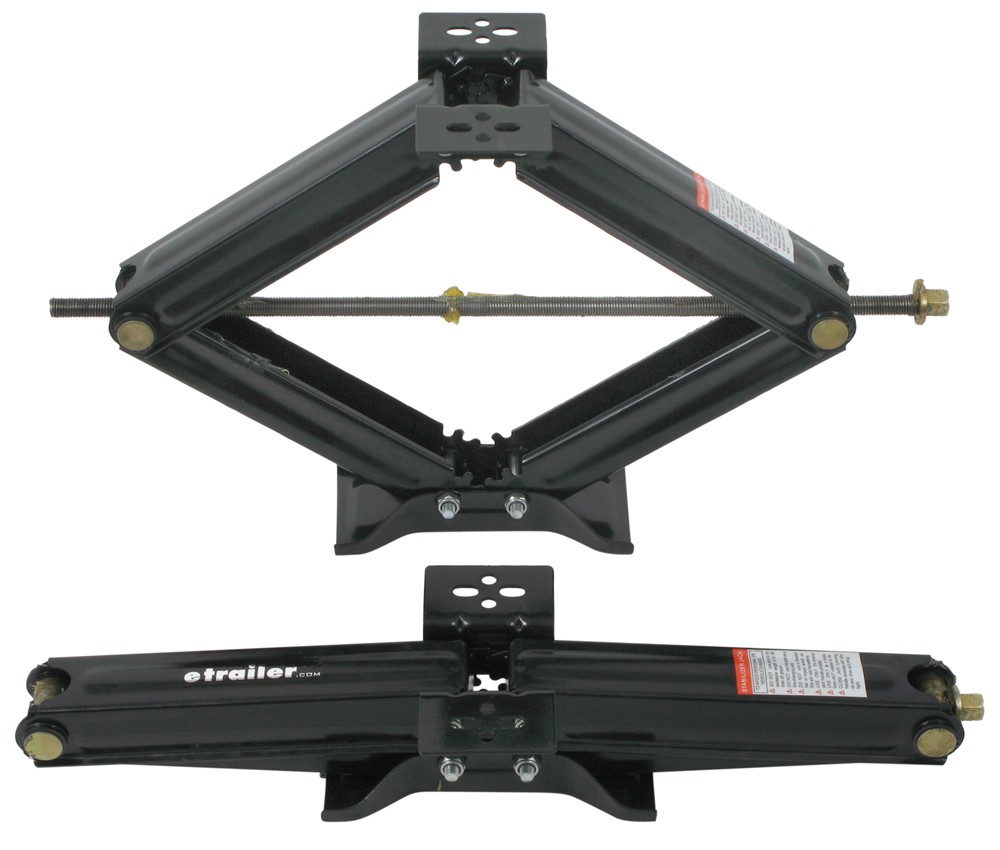

    Actually that could be a problem ... But :nerd
    I have an Idea for heavy weight and to save space too with a little effort >>>>
    - Just use three of these car scissors jack ...
    or custom build them ...
    http://www.soaridaho.com/Schreder/Construction/Scissor_Jack/Scissor_Jack.html
    - Modify them with high speed motors not like this but faster ... use motorcycle starter motors :thumbs ...
    here is a link of such motors ...
    http://www.pplmotorhomes.com/parts/rv-jacks/scissor-jack-motor-kit.htm

  19. bsft
    starter motors may be fast but are not designed for long use like we do for simulators, expect them to burn out fast.
