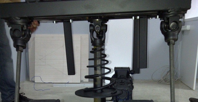

    Can you tell me what you use to slide under the platform, with the spring.

  9. pathetic
    pathetic Member
    Jul 5, 2009
    62
    - 38Coins
    Thank you,
    I use this only.
  10. vulbas
    vulbas Active Member
    Jul 28, 2009
    208
    france
    1,103Coins
    +216 / 0 / -0
    AC motor, 6DOF
    thank you for the picture, what is it exactly ?
    merci pour la photo, qu'est ce que c'est exactement ?
  11. pathetic
    pathetic Member
    Jul 5, 2009
    62
    - 38Coins
    Sorry,
    They are two triangle shaped metal tube only and the bigger size used for the other to move inside.
    The round metal plate is used for holding the spring.
    I wish this help
  12. vulbas
    Jul 28, 2009
    208
    france
    1,103Coins
    +216 / 0 / -0
    AC motor, 6DOF
    thank you for your help.
    I use the same system but with square tubes. but I have too much play, movement (not sure of the word in English) I'll test with the anti-rotation bar.
    j'utilise le meme systeme mais avec des tubes carré. mais j'ai trop de jeu (pas sure du mot en anglais) je vais tester avec la barre antirotation.
