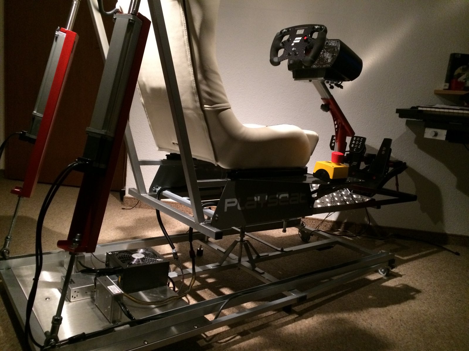

    3DOF, SCN6, Motion platform

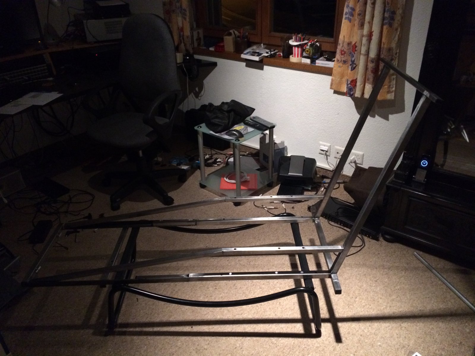

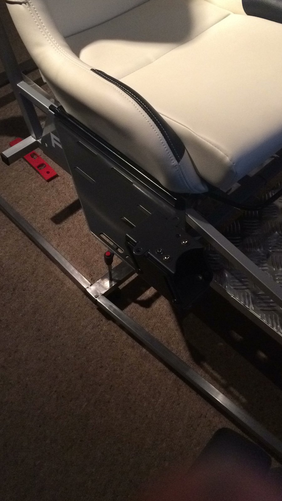

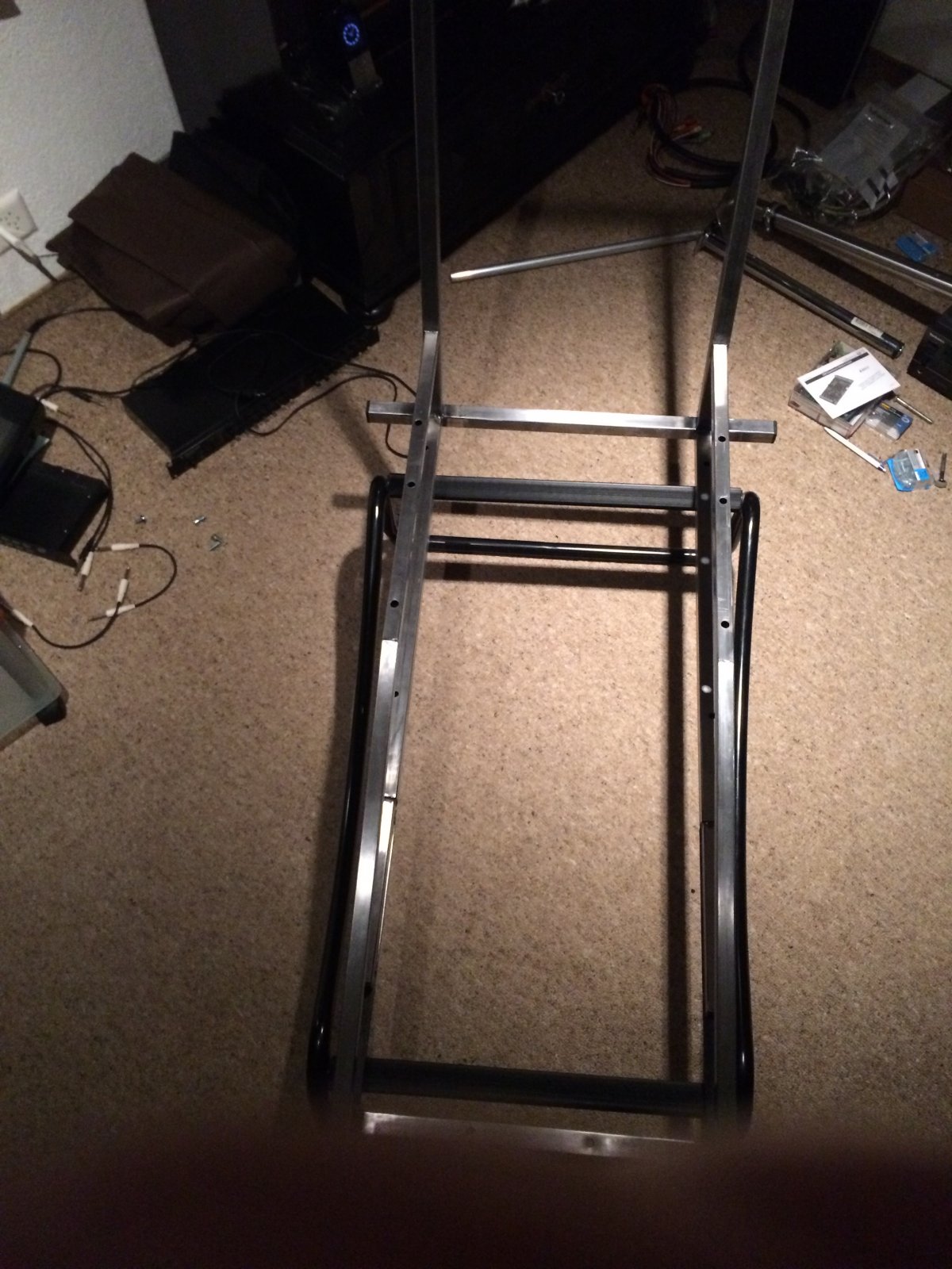

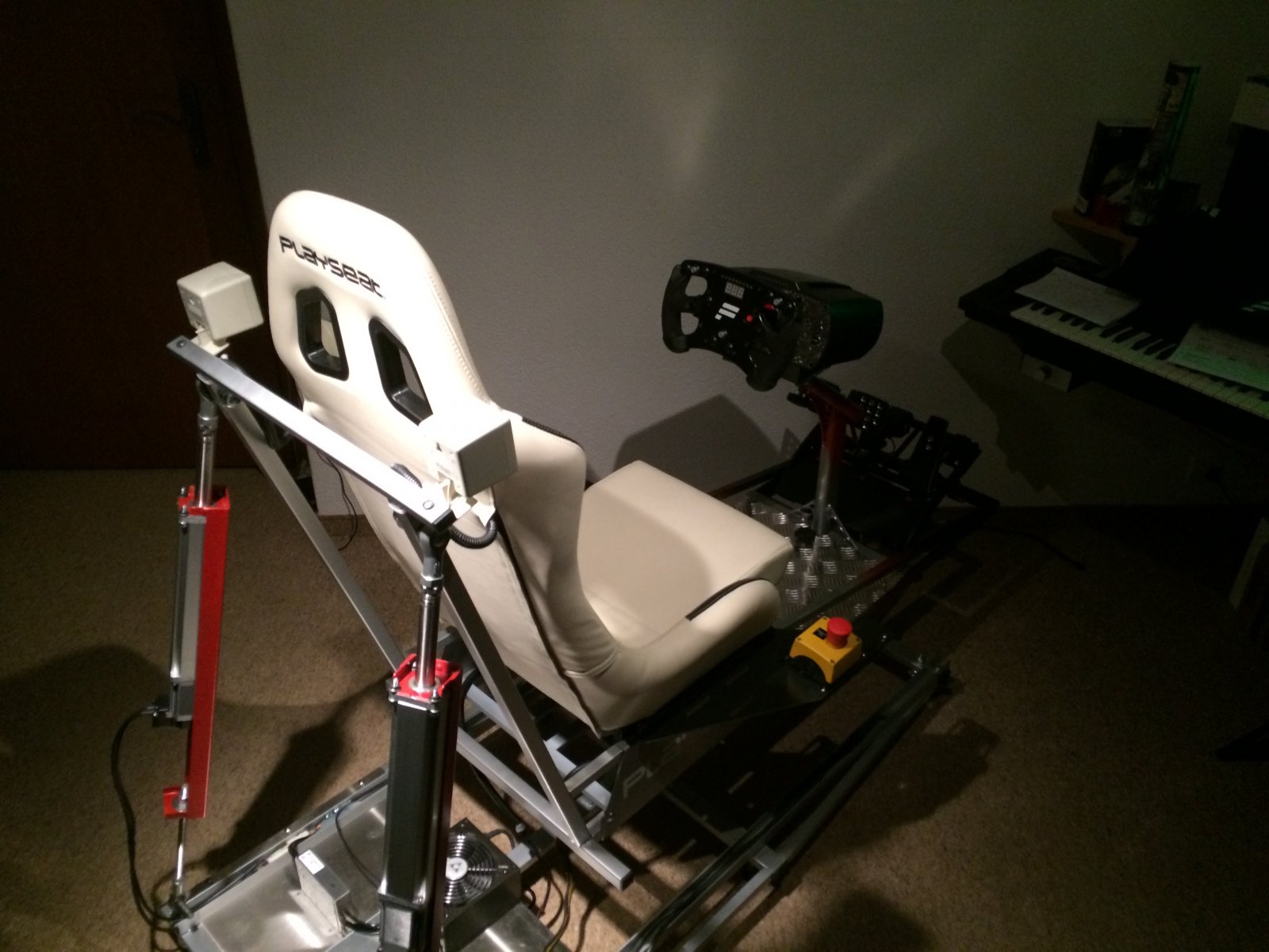

    My first project. I am using a Playseat and build my own Simseat…

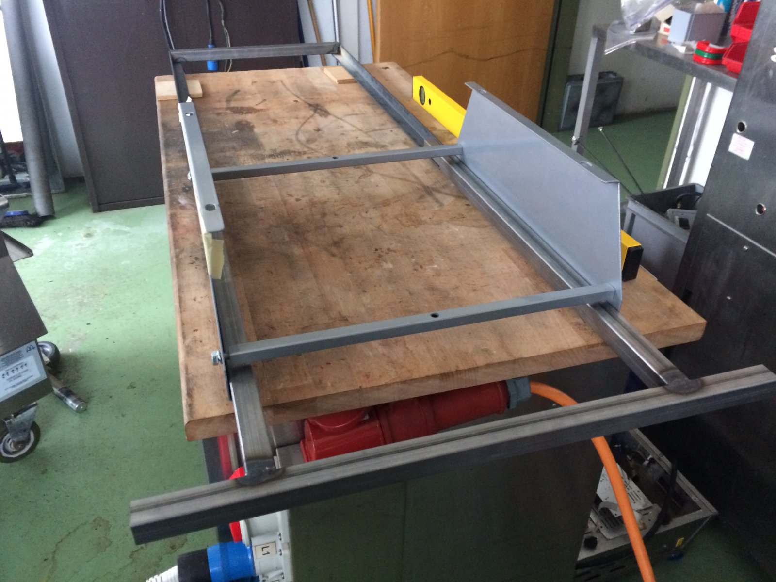

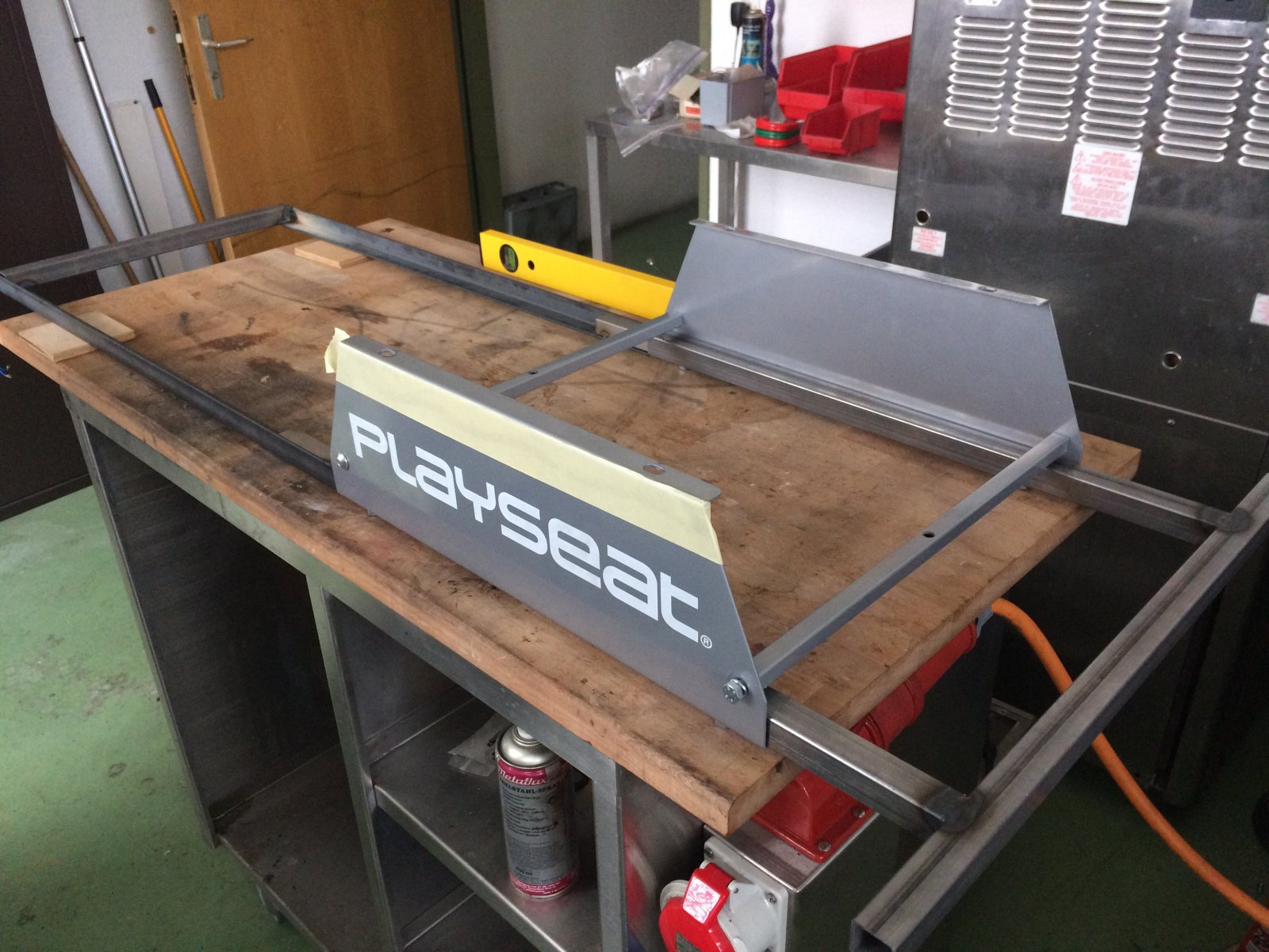

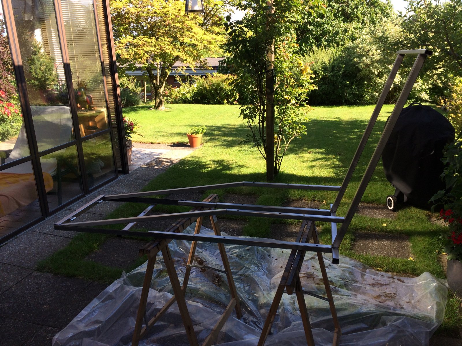

    Painting the frame

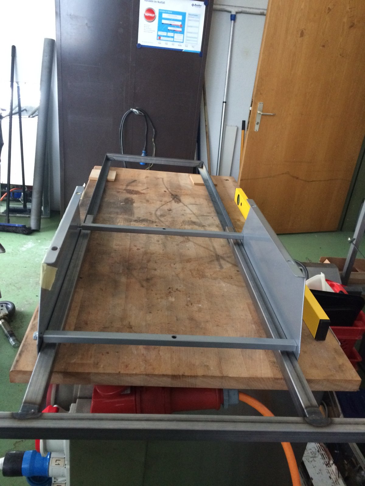

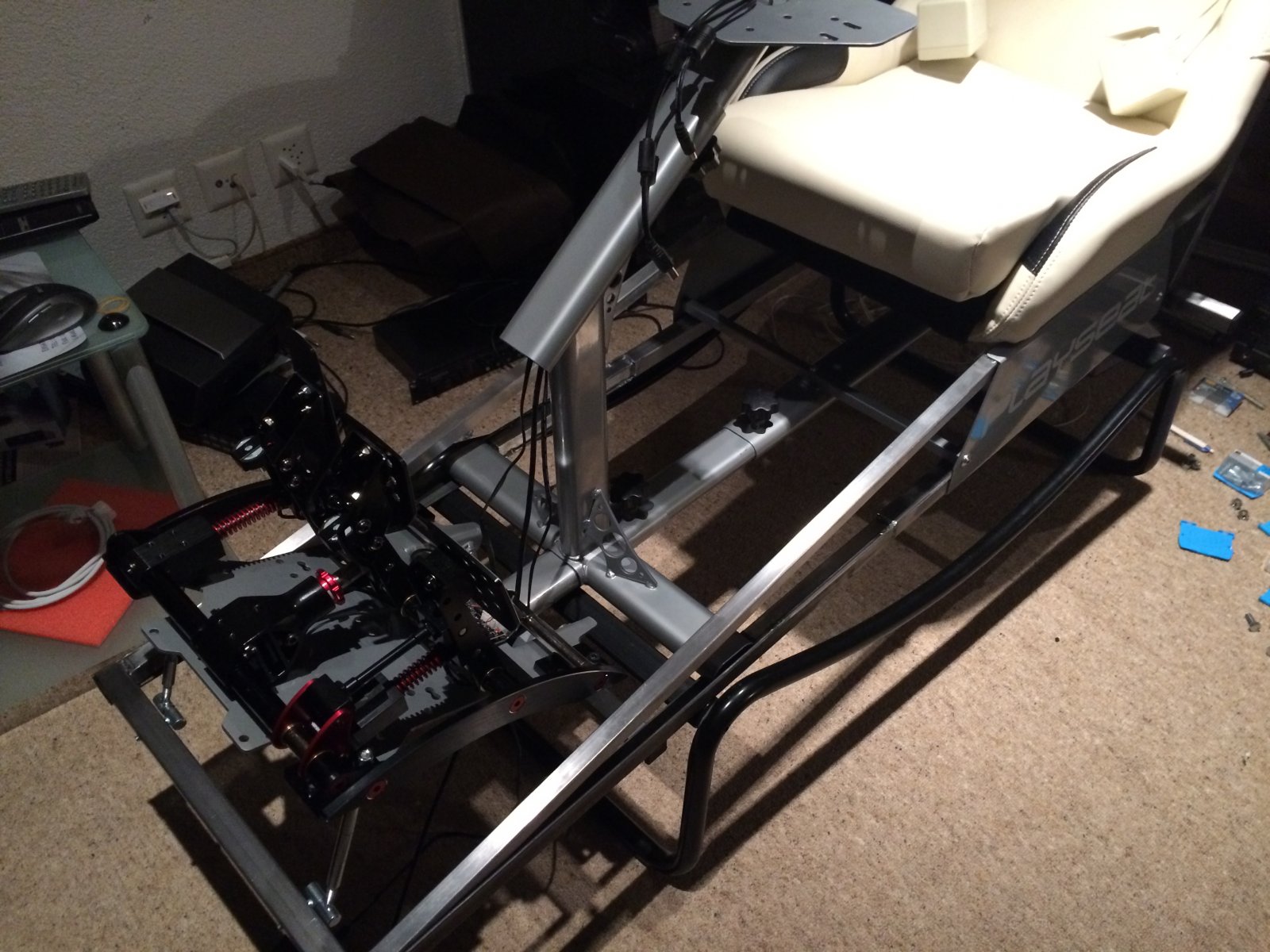

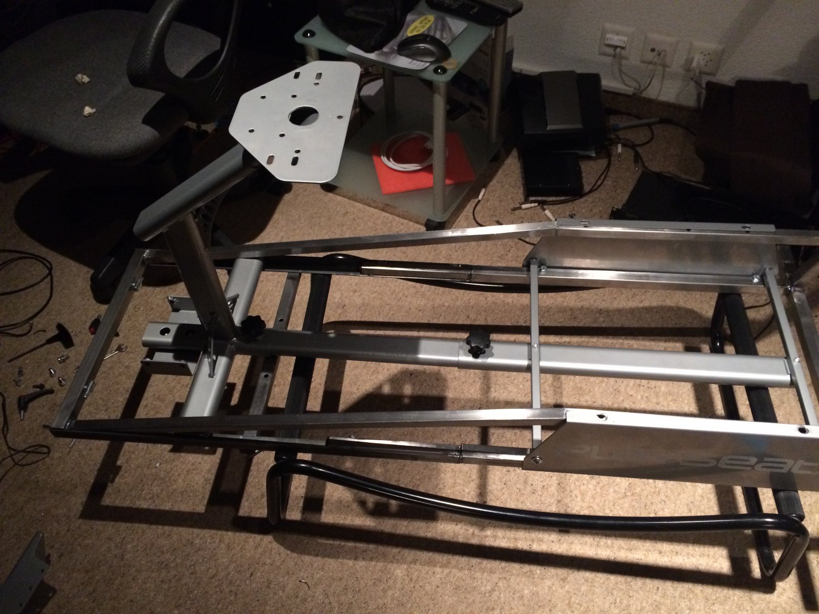

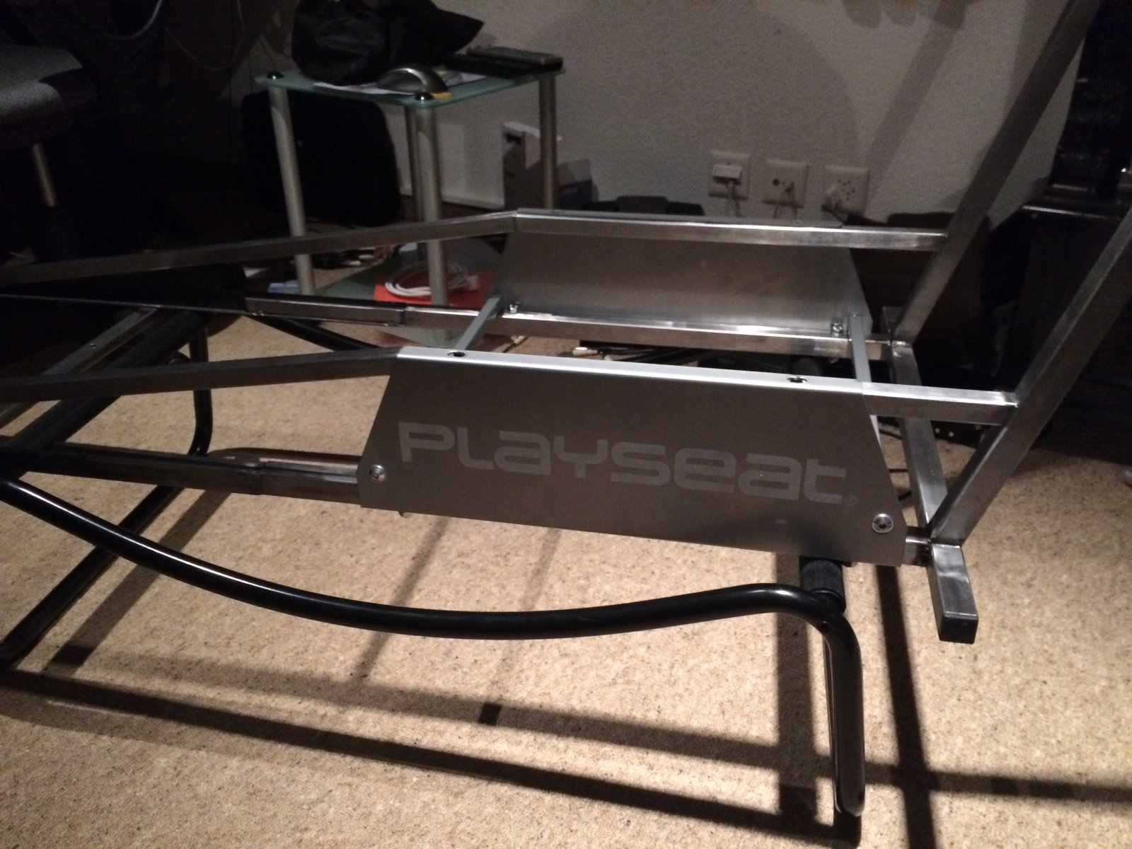

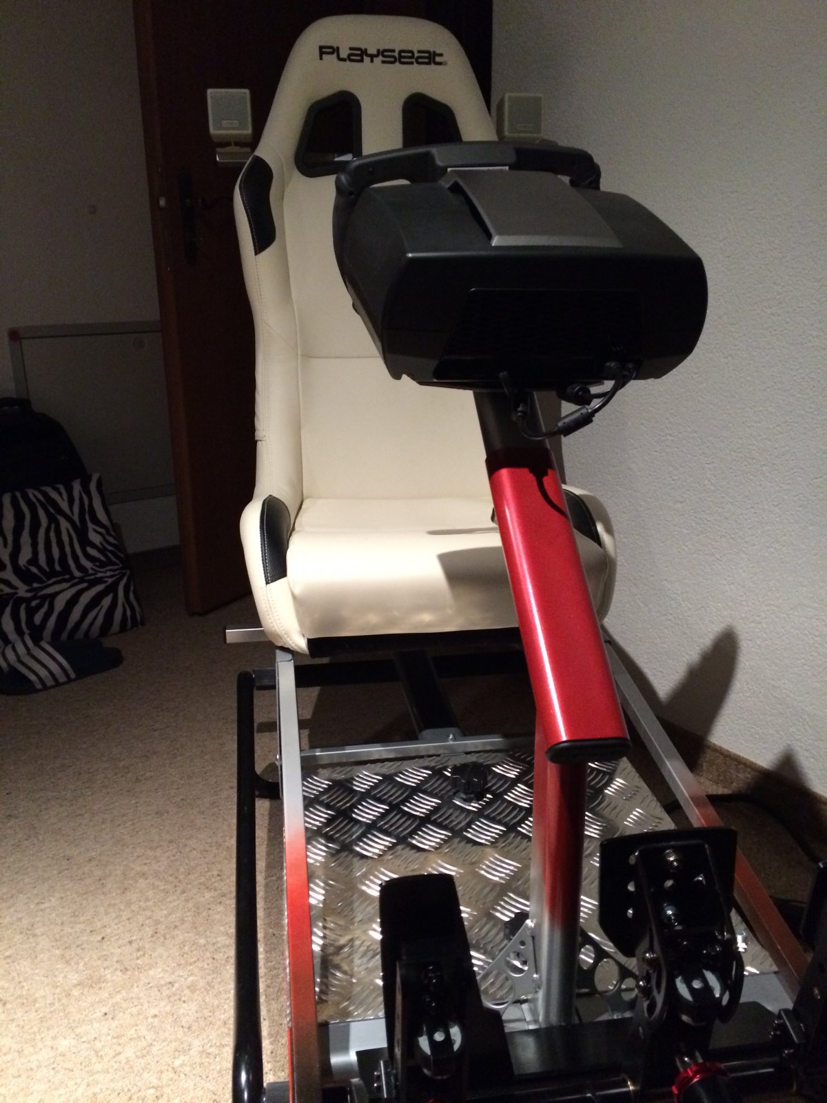

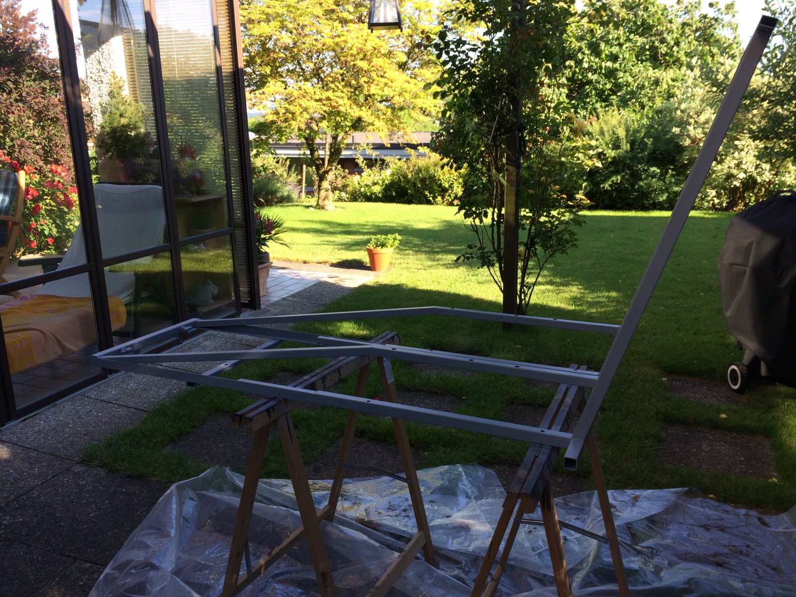

    I finished the first step. The frame for the Playseat and the pedals.

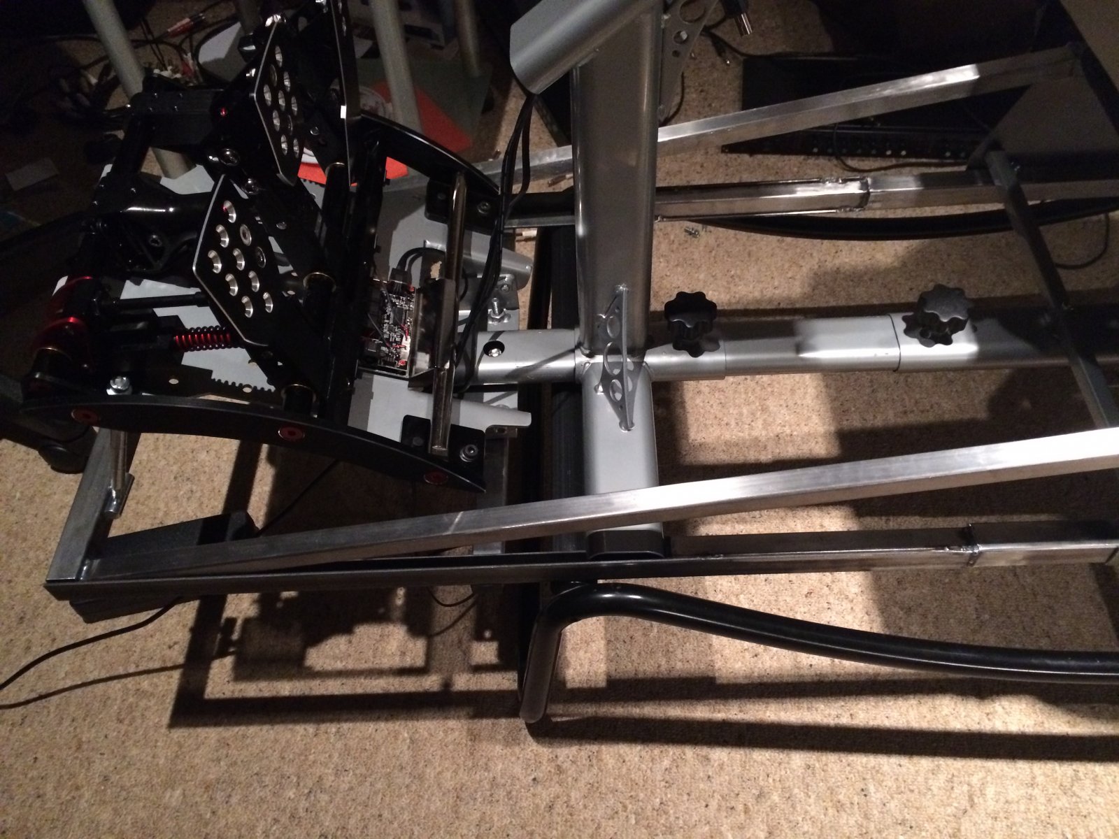

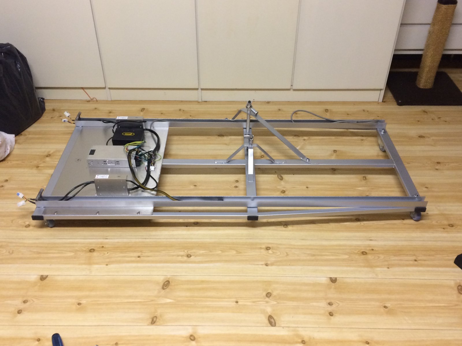

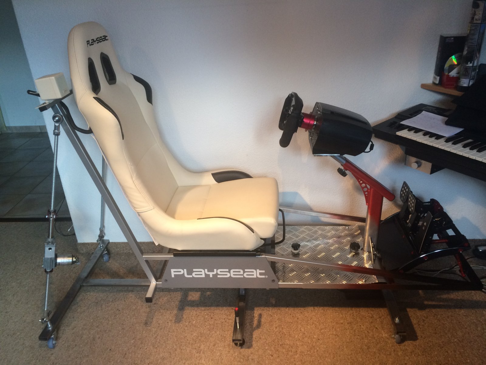

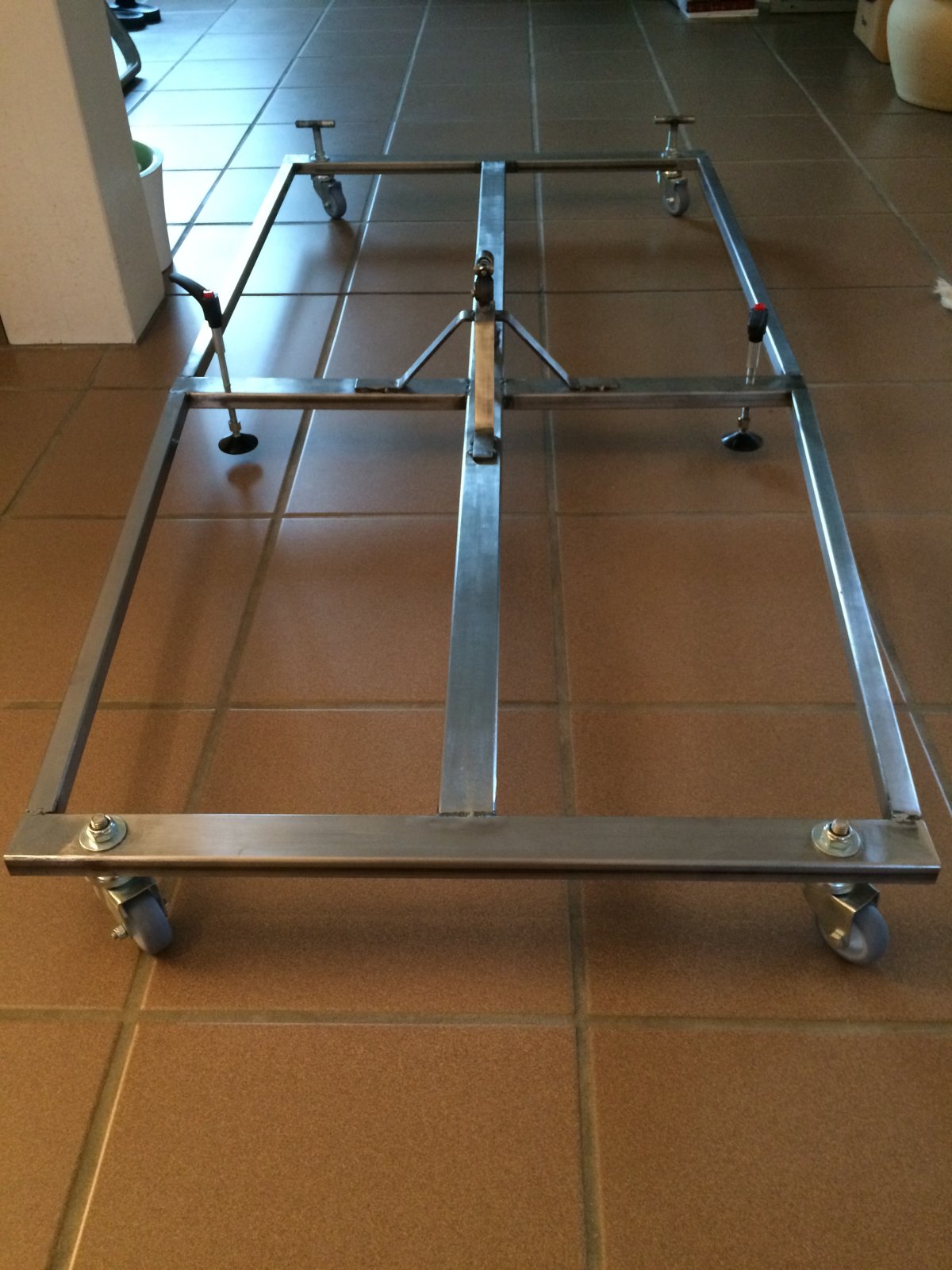

    The first base frame was too unstable
    The second was a little better

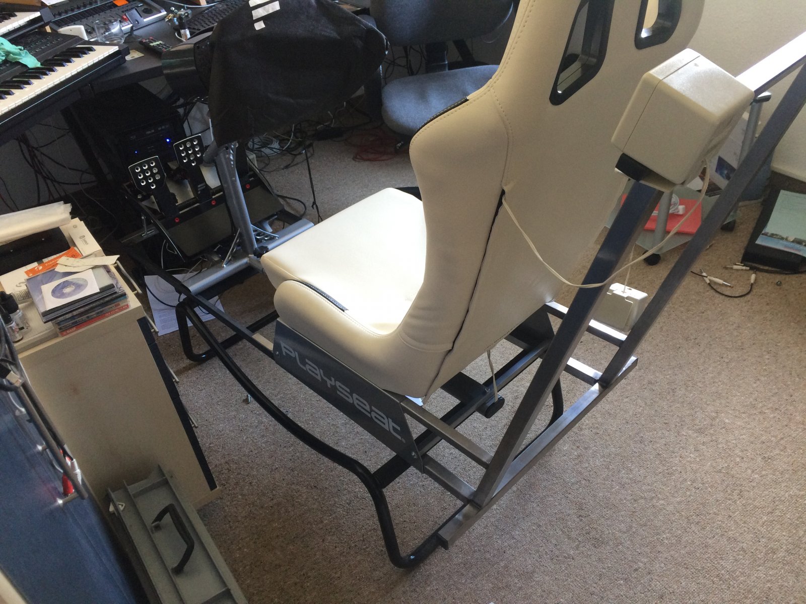

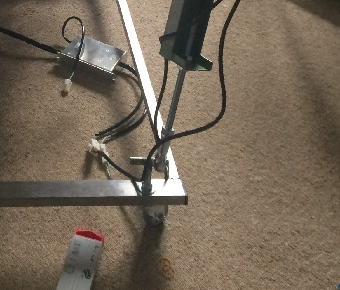

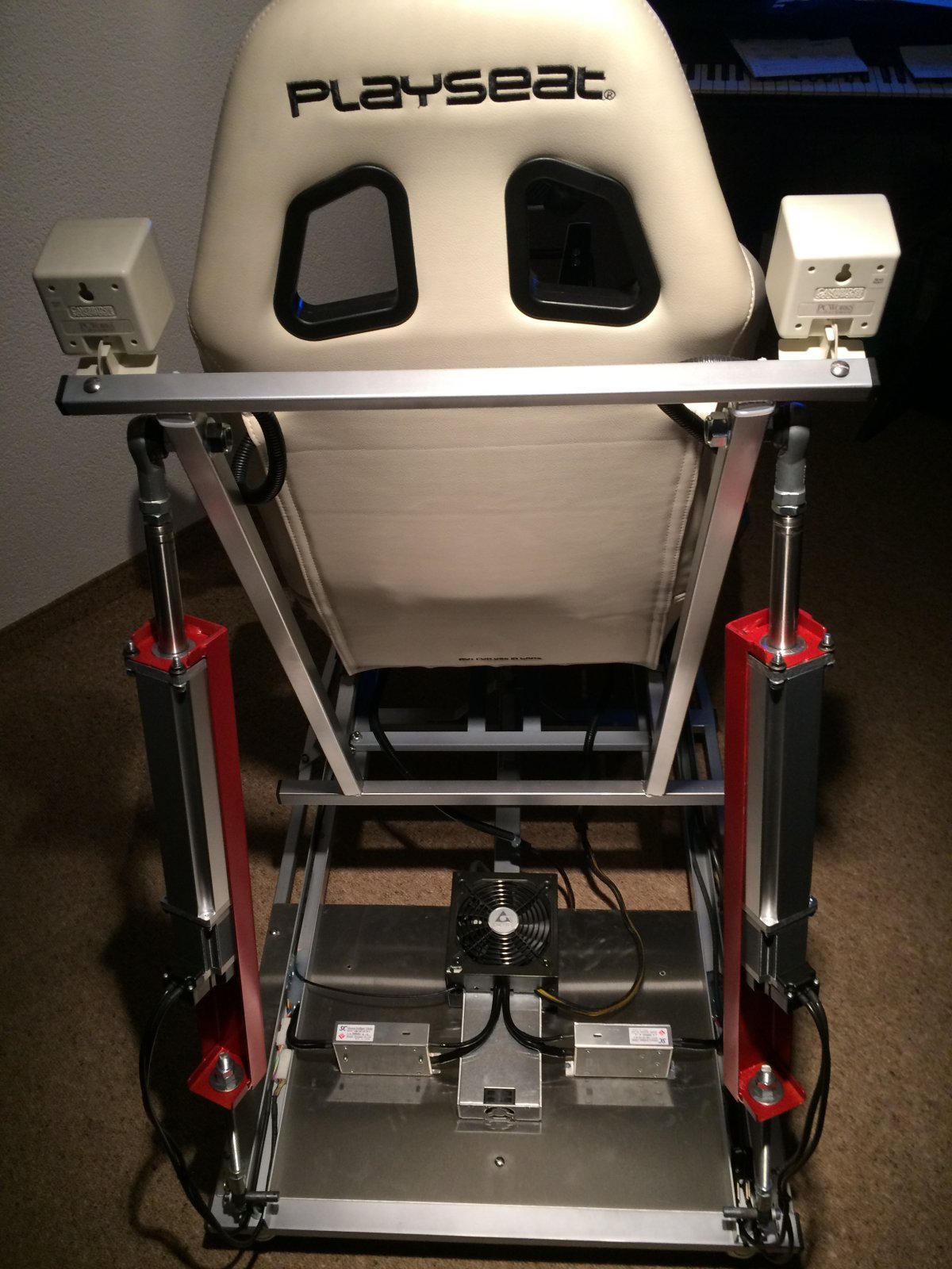

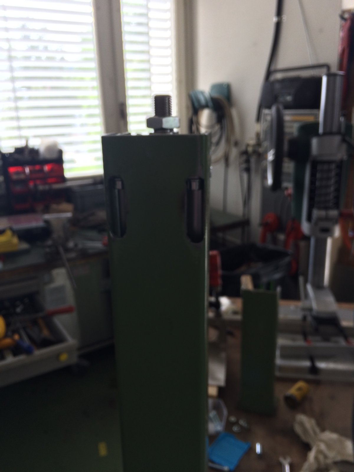

    The SCN 6 (040-200) have arrived. Now, a bracket must be constructed. A table leg for a workbench had exactly the right size. Cut a bit and drill. And the holders were finished.
    The first signs of life:)

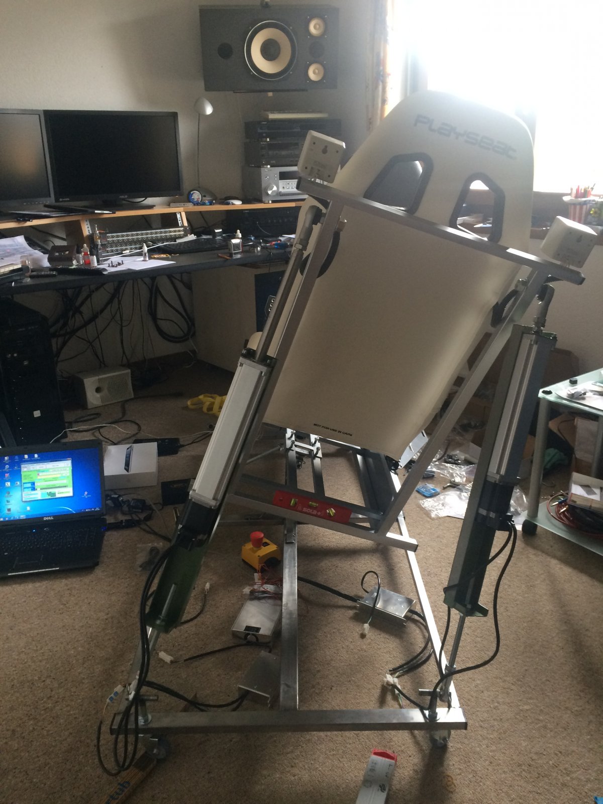

    Simrig ready to test

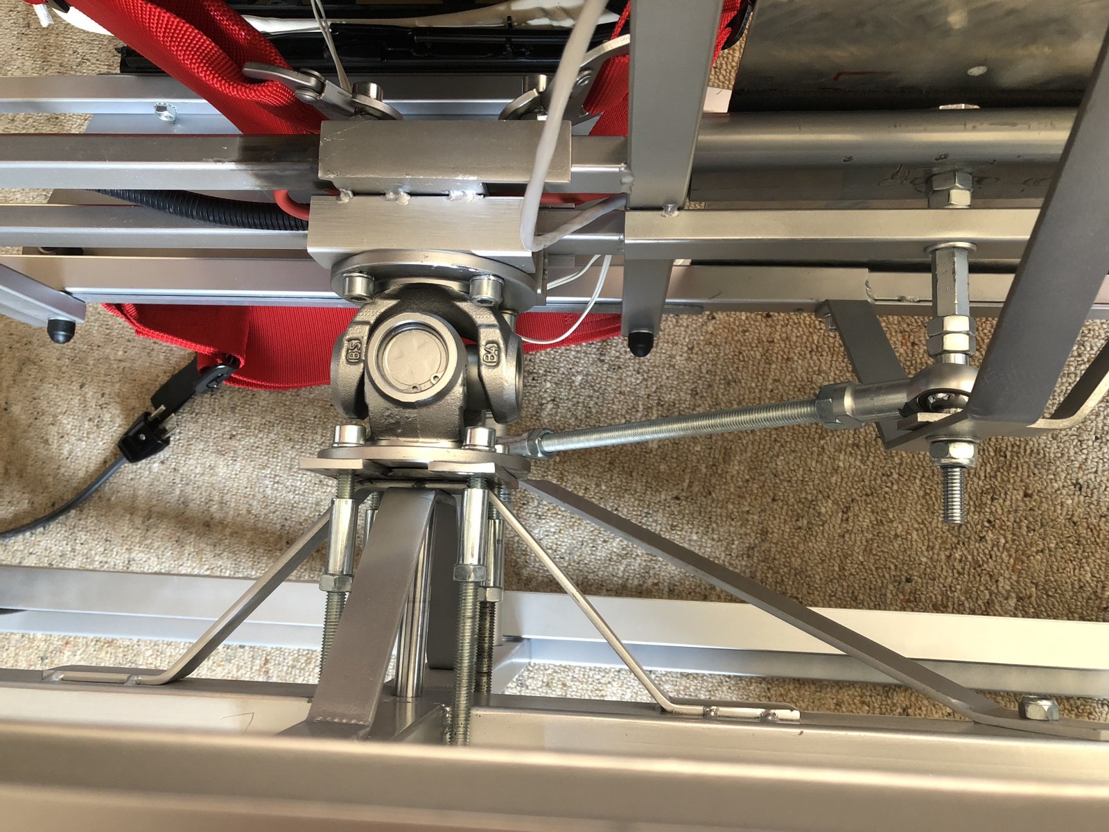

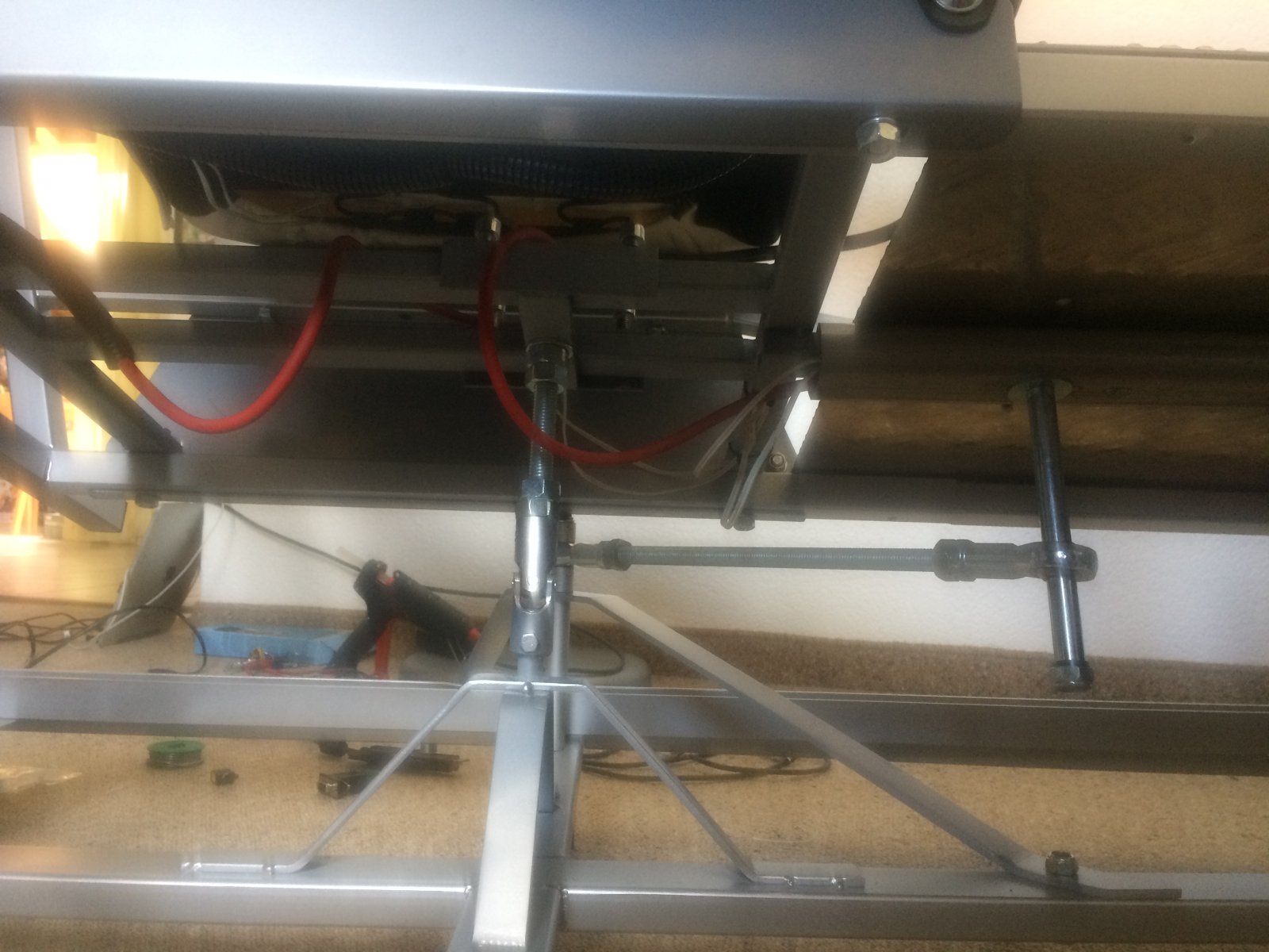

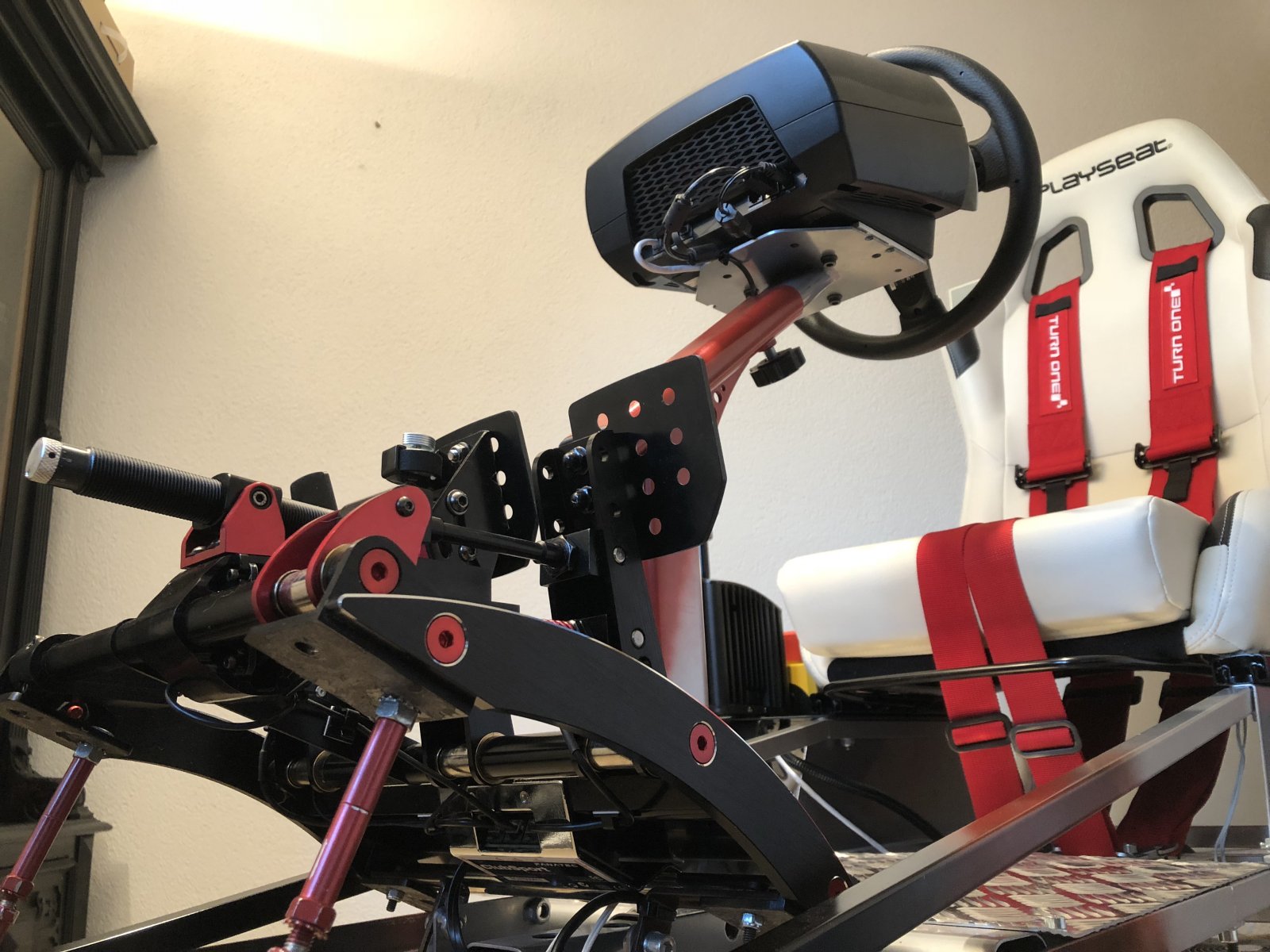

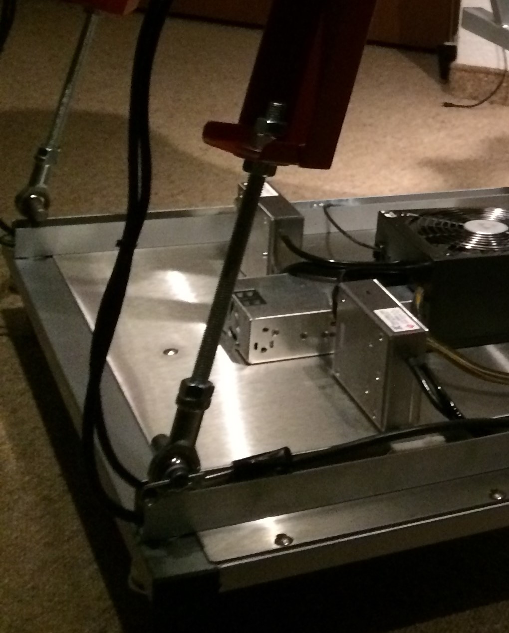

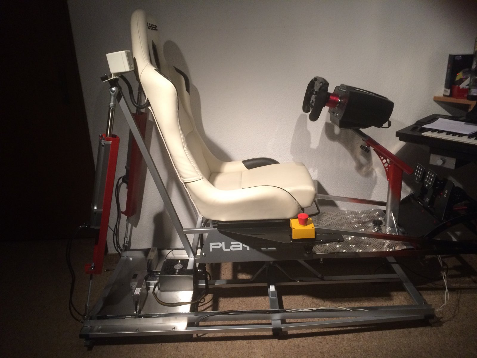

    After the first hundred kilometers of testing some errors came to light:
    The universal joint was much too small, was wobbly and made noise.
    That meant taking again money in hand and buy a decently universal joint:(
    It was worth it: much quieter and stable:grin

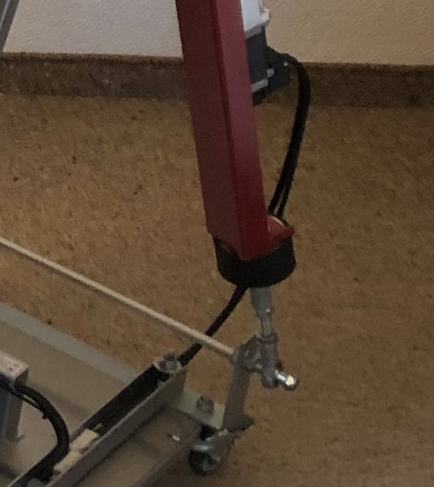

    The next weak point was the attachment of the lower rod ends and the lack of damping
    The new design

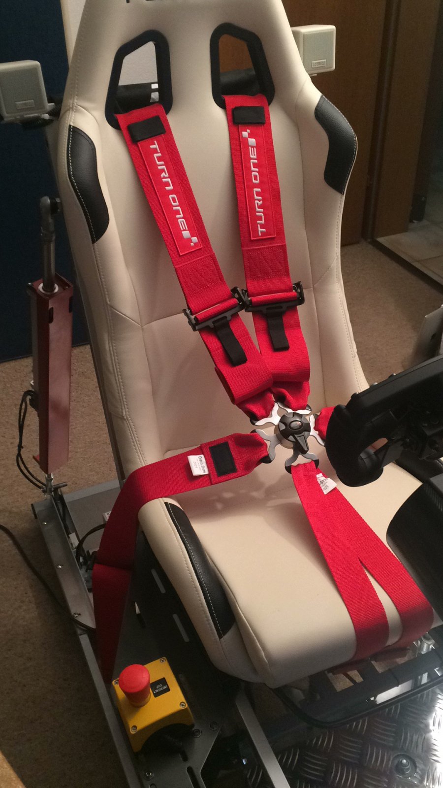

    Seat belts mounted for more grip and reality
    21,592
    151,215Coins
    The belts and refinements are all really good upgrades that will greatly enhance the motion experience and longevity of your rig.

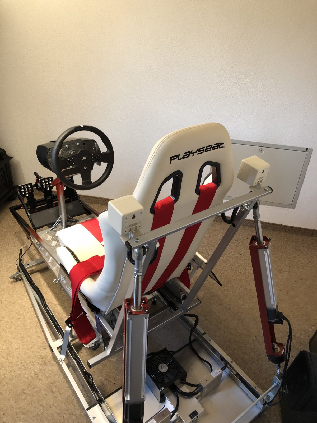

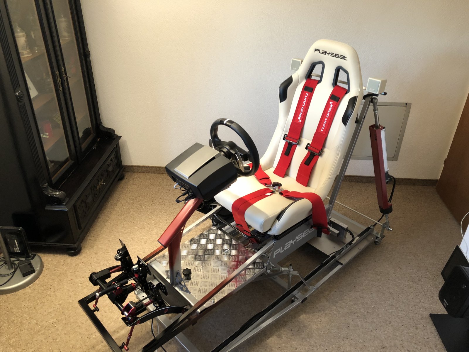

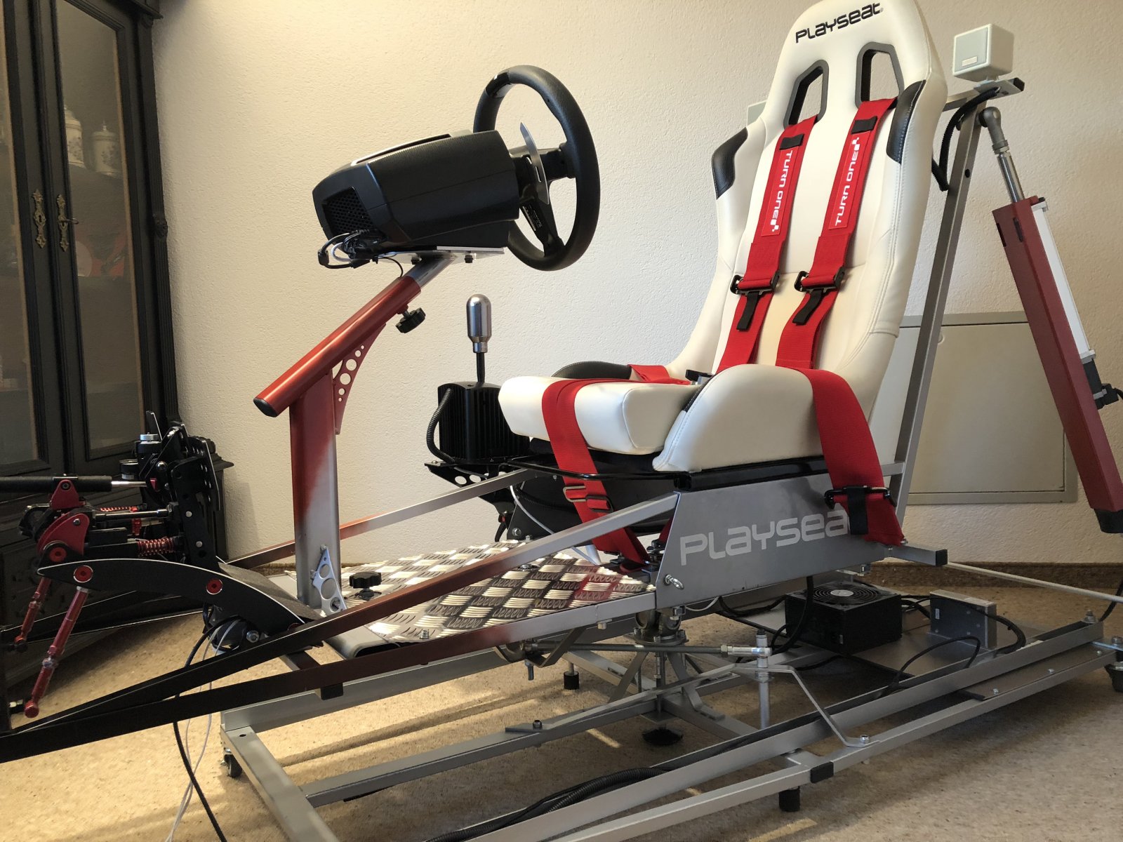

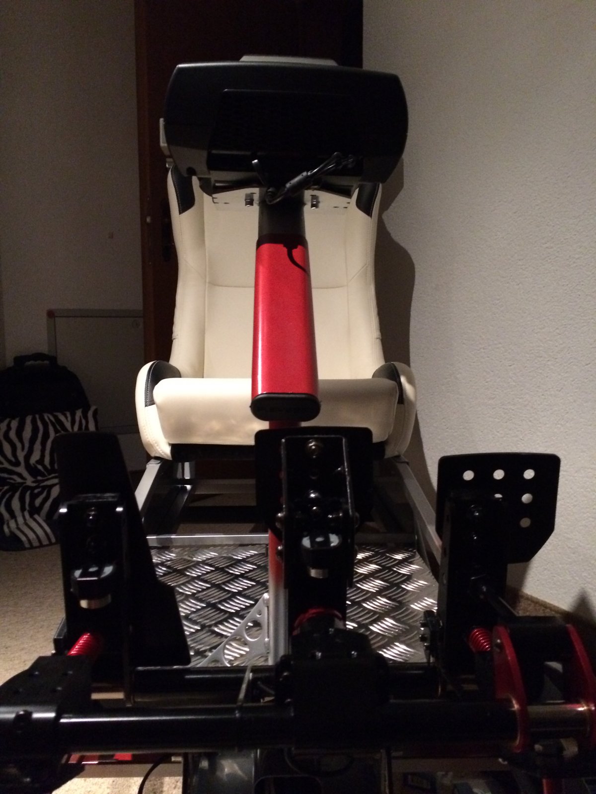

    The last upgrades:
    Fanatec ClubSport Shifter SQ V 1.5
    ClubSport Pedals V3 Damper Kit
    Overview of the current design

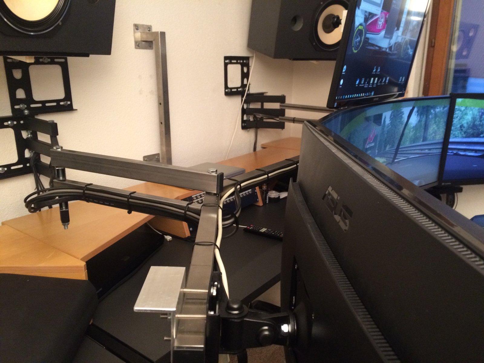

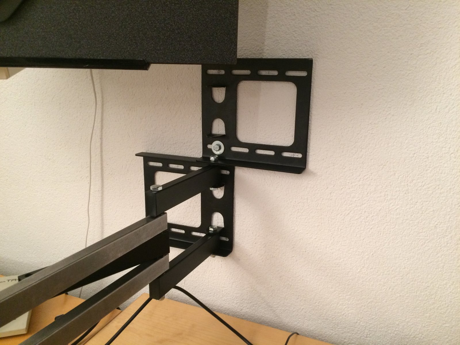

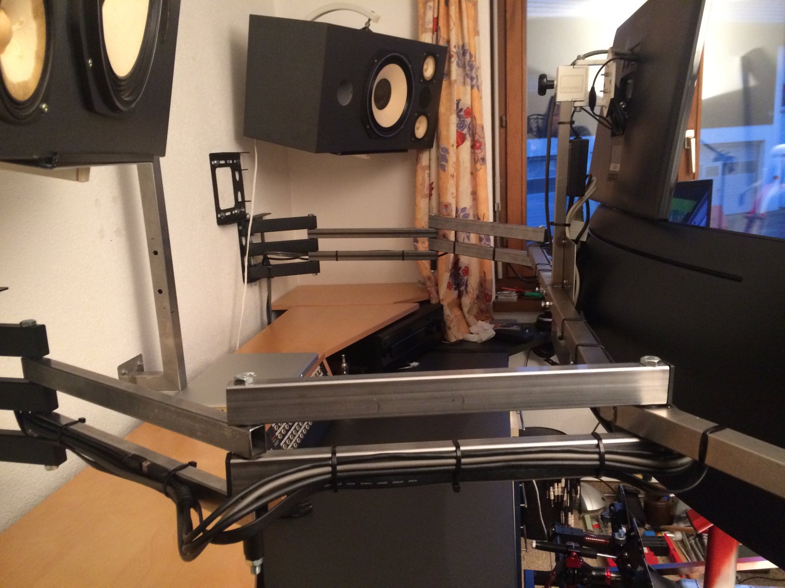

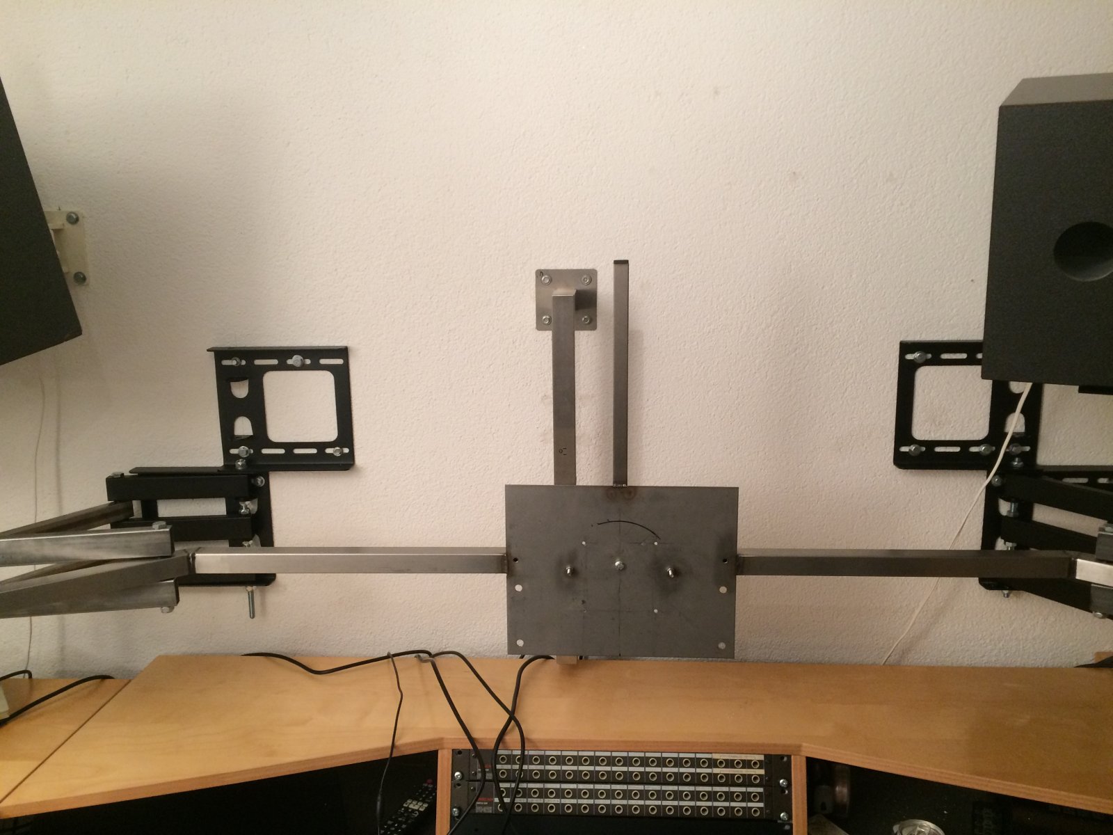

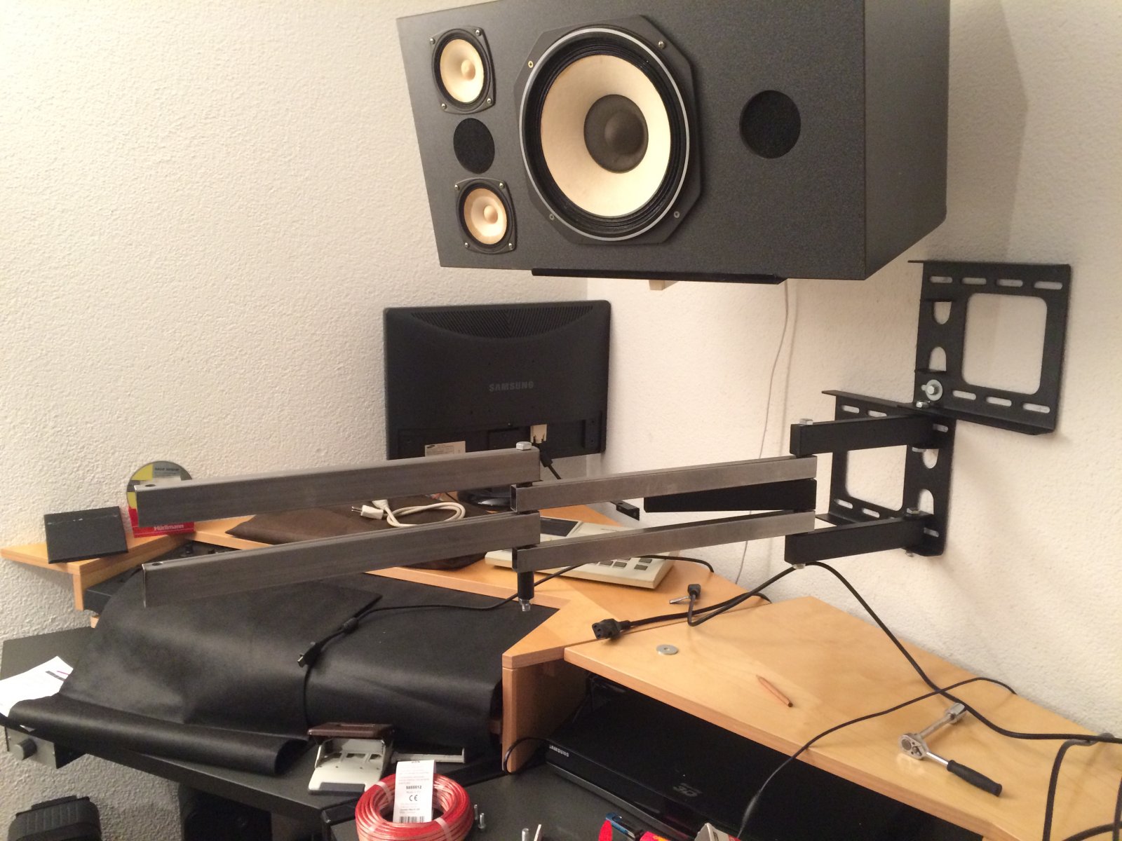

    Another project was the screen holder design

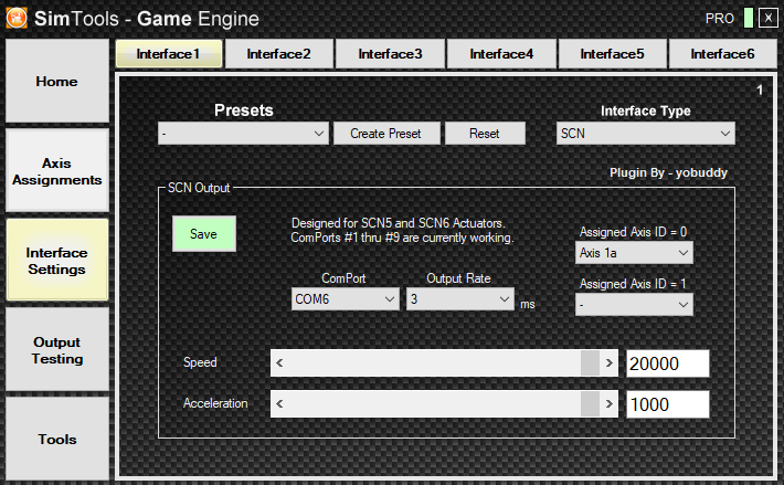

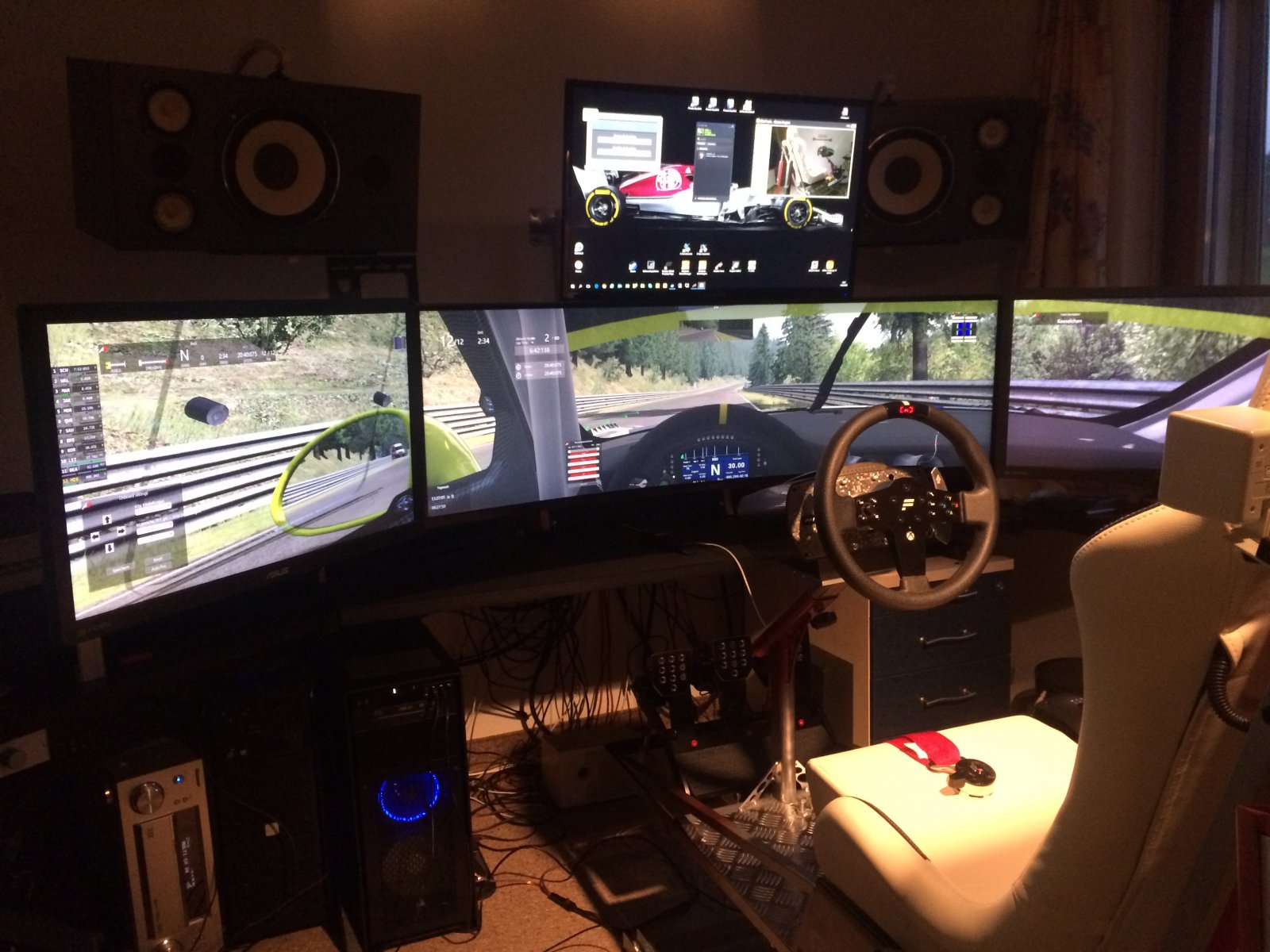

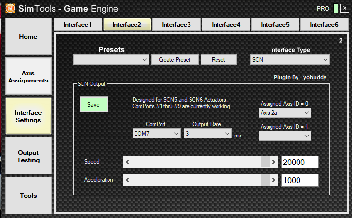

    I've added traction loss to my rig, but unfortunately it does not work properly.
    my setup: 2x SCN6 for sway, surge, pitch and roll. and new arduino uno with ibt2 and smc3 for traction loss (extra 1).
    The problem is that with increasing activity of the traction los effects suddenly the steering wheel rotates and most of the SCN engines stop. Does somebody has any idea?
  15. noorbeast
    21,592
    151,215Coins
    SimTools should not affect a steering wheel, so it sounds like it may be a USB/hardware related issue, but just to be sure can you please post pictures of all of your settings.
  16. prodigy
    prodigy Burning revs
    Oct 27, 2013
    459
    Croatia
    6,698Coins
    +399 / 4 / -0
    @highi Does this happens in all games or just one? Does the game or Simtools stop working / crashes to desktop?
  17. highi
    highi Highi Racing Simulator 17 Gold Contributor
    Jul 8, 2017
    31
    8162 Steinmaur, Switzerland
    133Coins
    +37 / 0 / -0
    Thanks for your tips. The problem occurs in all games. The games and Simtools continue without a hitch. I think it must be a USB / hardware error. As soon as I steer the Arduino over Simtools, the steering and pedals response is delayed. Likewise I have the feeling that the actuators react with a delay. The car is not navigable. I have tried other USB ports, only Traction Loss activates without actuators. The error always remained the same. Maybe the combination of SCN6 and Arduino is not possible? Or the SMC3 code incompatible with only one motor?

    Settings:
  19. noorbeast
    21,592
    151,215Coins
    Computers often share USB controllers between multiple ports, so you could try using a program like UsbTreeView to find what your controller your wheel and hardware are using, then separate them if needed: https://www.uwe-sieber.de/usbtreeview_e.html
