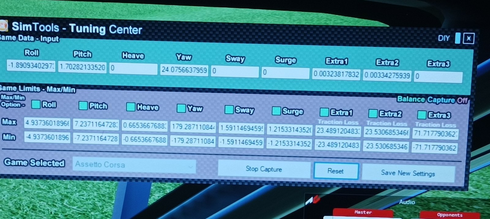

    using 180 degrees in extra1 with tuning center it works, however if I try to follow the capture procedure it detects yaw as traction lost (180 degrees) and for "extra1" 23 degrees.
    I don't understand why decreasing the values increases the the range of motion for example sway and surge are actually really 10 degrees on sim i thought to fully use i should use 10 degrees in tuning center but no i have to lower and besides if i lower too much it becomes too reactive

    There are whole range of related settings that affect the end movement, so grab a copy of the SimTools manual and keep it handy for reference: https://www.xsimulator.net/community/faq/rtfm-start-with-the-official-simtools-documentation.117/
    Axis Allocation allows for splitting an axis range between multiple axis, with traction loss it is a dedicated axis. The Tuning Center takes game data, represented in the top row, and determines the response of a given axis, the larger the number in the Tuning Center settings the gentler the response and the lower the number the more violent the response.
