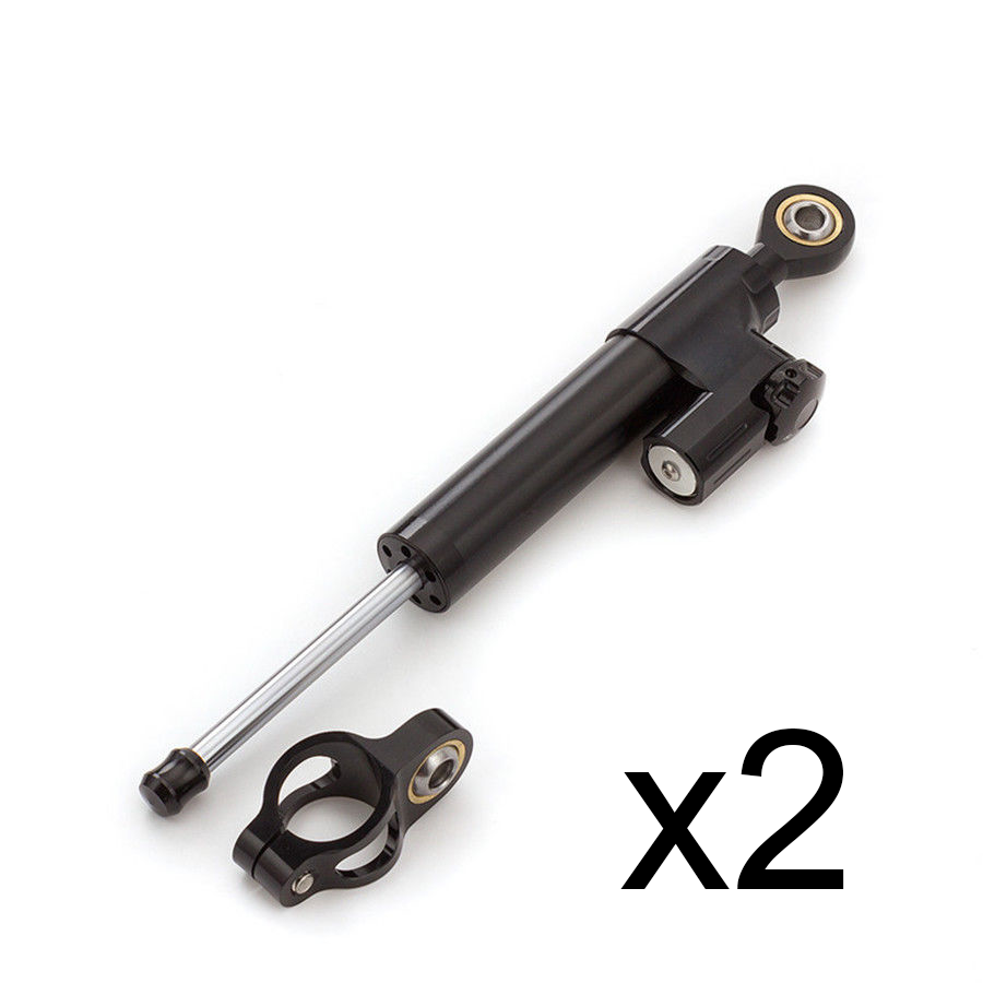

    i am starting a project inspired by "DOF Reality Motion Simulator H3"
    i am waiting for the delivery of a wheelchair motor 24v 220w which i hope have couple.
    for the electronic part i am thinking of starting with itb-2,Arduino Uno r3,smc3 and see if the project works and maybe deserves a sabertooh.
    this simulator is delivered with optional steering dumpers
    I do not quite understand the usefulness apart from adding a constraint, this type of shock absorber does not return to this position like a spring.

    I suspect the steering dampeners are for load compensation in circumstances where the motors are marginal specs for the rig design.

    The dampeners on the DOFReality H3 are to provide smoothing to mask the effects of backlash on the gears of the gearbox attached to the motor. The H3 uses a universal joint as a pivot point and there is a bit of freeplay when you move past the tipping point. Carefully balancing the weight on the rig apparently helps quite a bit to mitigate this. They have a new gearbox system now that uses a short ball screw moving the lever instead of the current arm on the gearbox design. It apparently works quite well and looks like a clever solution, though presumably you lose some fidelity compared to a more traditional linear actuator.
    As a side note, the mentioned freeplay in the gearing can be a considerable problem. It's not such a big deal for racing sims using small, fast movements as you often won't notice a bit of a wobble, but with flight simulations using a larger and slower motion, it can be very obvious and immersion breaking if the rig doesn't move correctly and smoothly through the whole motion.
    DOFReality also has a 6 DOF version that uses gas struts to provide smoothing and additional lift to help the motors push against gravity.
    Springs are often used for the same purposes - i.e. providing a bit of preload or assisting an underpowered motor.

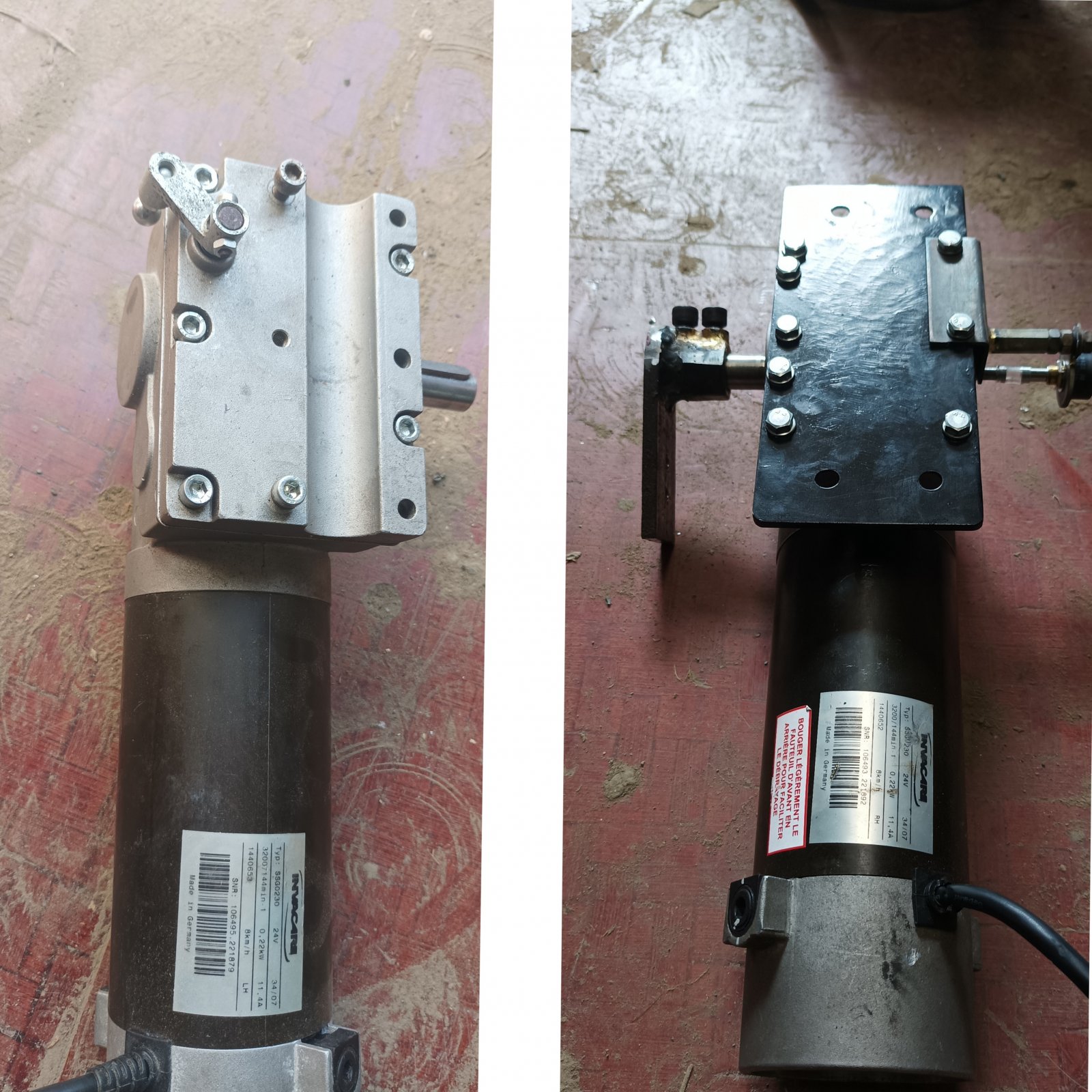

    hello
    I come back after having finished my first engine.
    (If you have any questions about the modification ask.)

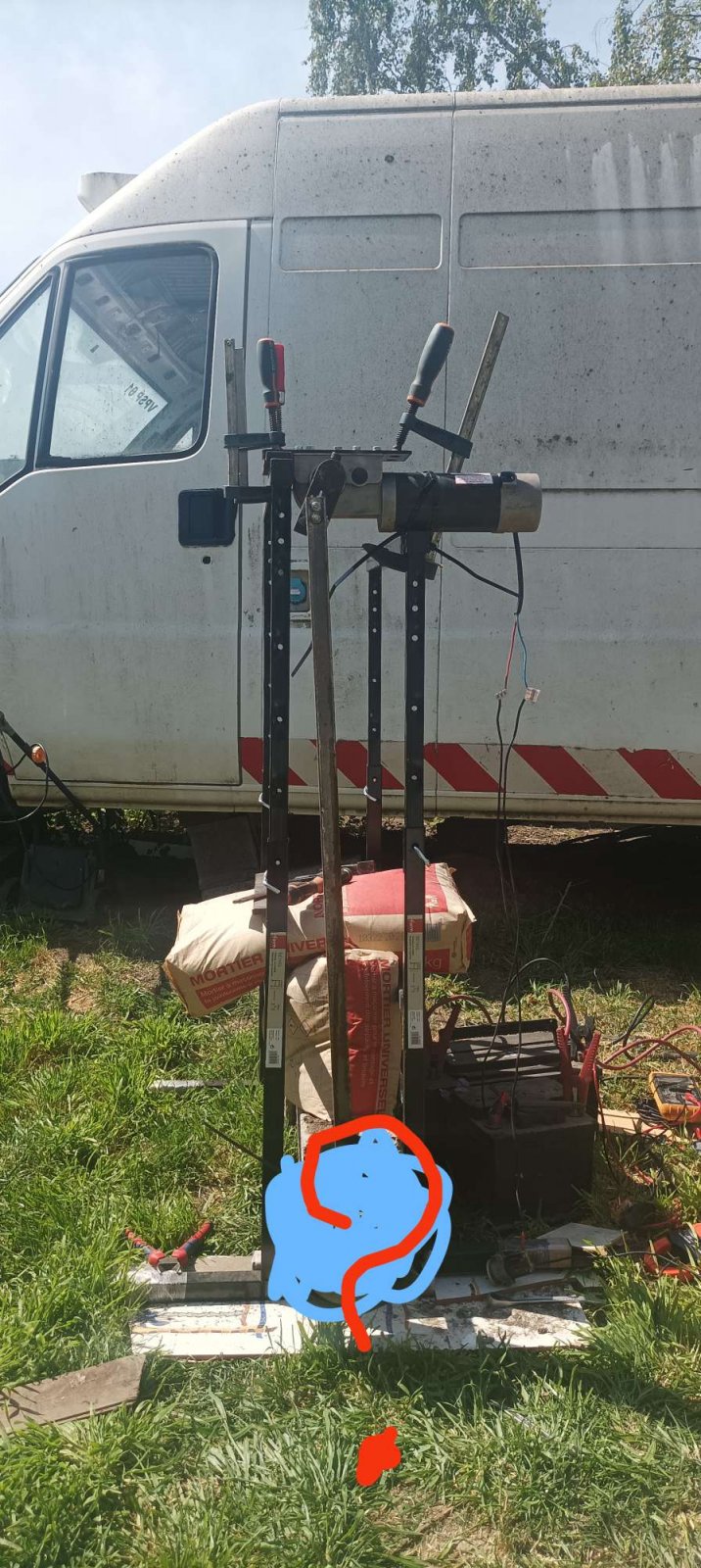

    I tested it with a weight after one meter and an ampermeter.
    Your predictions what is the torque of this engine? (24v 220w 150rpm)

    hello,
    I'll put an end to the suspense...
    I was very shocked at the weight that this motor lifted and so easily.
    I started the test at 12v, it lifted 5.5 kg at 75 rpm and 11 kg at 150 rpm at 24 v...
    before buy second-hand motors I looked at the motors sold for simulator from 35nm to 65nm and a speed around 50 rpm. (24v)
    Is it better to use it in 12v so that it is closer to the parameters of engines sold for simulator (75rpm 55nm) or the fact that it is very strong and fast is better?

    It is more a question of getting 24v controller and PSU, that takes full advantage of the motors you have, though you could use 12v if you wanted to. The rest comes down to suitable design choices..

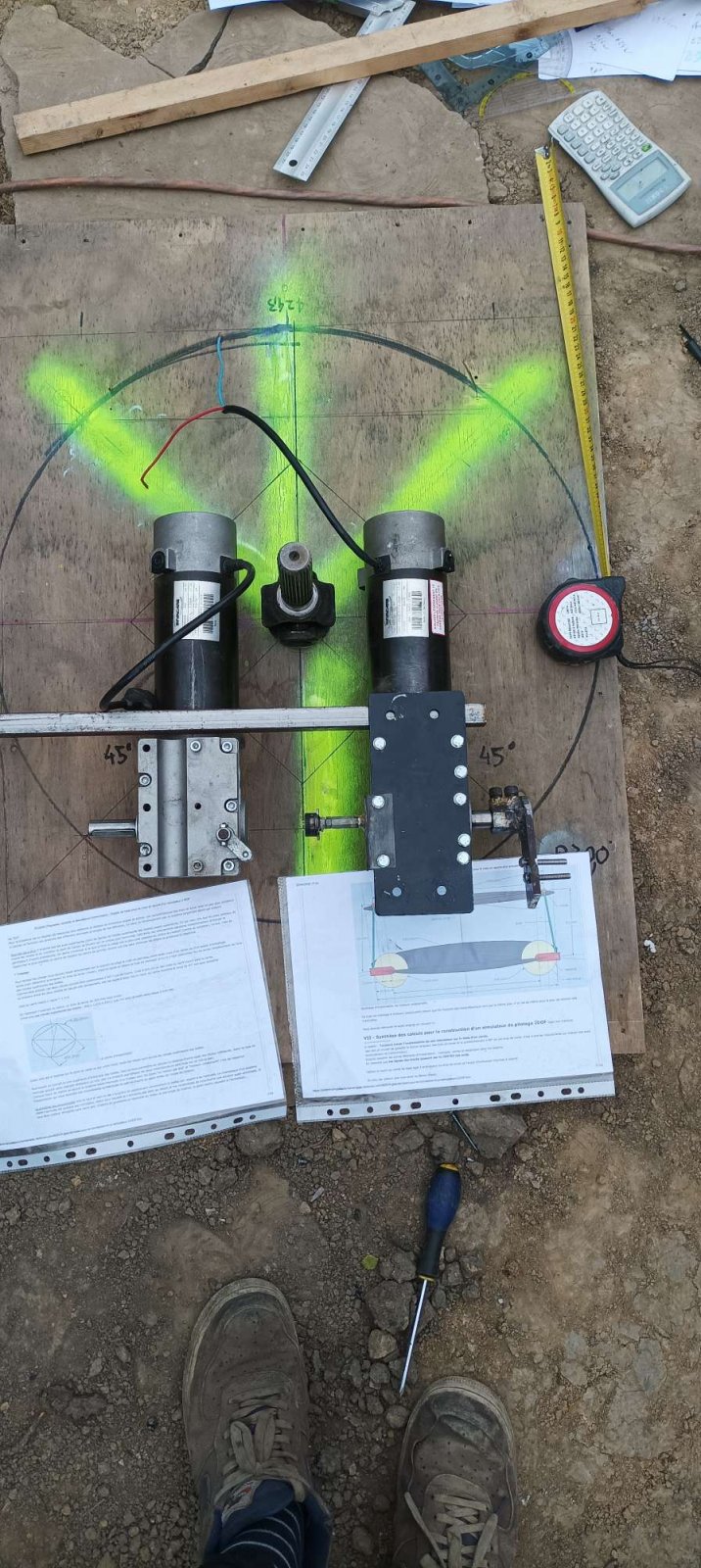

    I started to make a model of the 2dof part (cooperative engine) based on existing diagrams.
    The idea being to find the placement before welding the chassis.

    the radius of the circle is 30 cm and the middle between the motor shaft and the crank (between 4.5 cm and 6 cm) is placed at 45 degrees.
    the gimbal is at the center of the circle.
