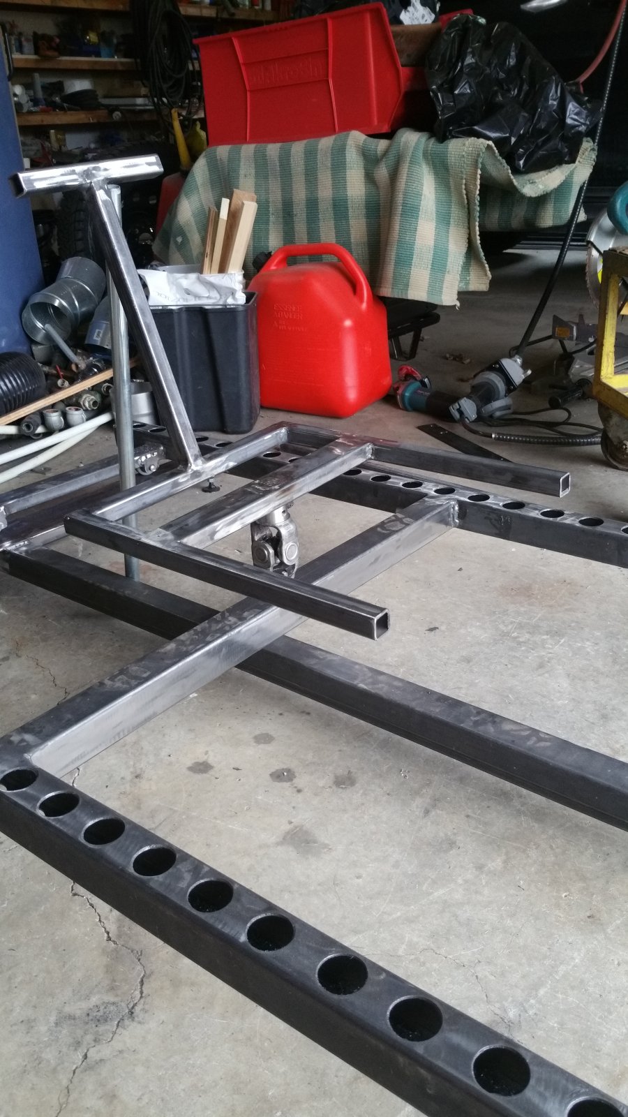

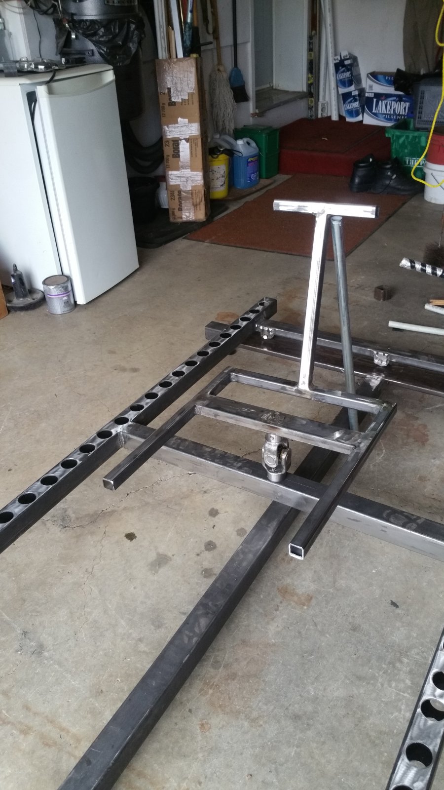

    Well today I got the seat frame welded together and the u-joint mounted in place on the frame. I took a couple of pics of it.
  9. Nick Moxley
    17,056Coins
    +2,506 / 30 / -2
    Wow you must have some Serious Man Cave space to play with, That base is a Monster.

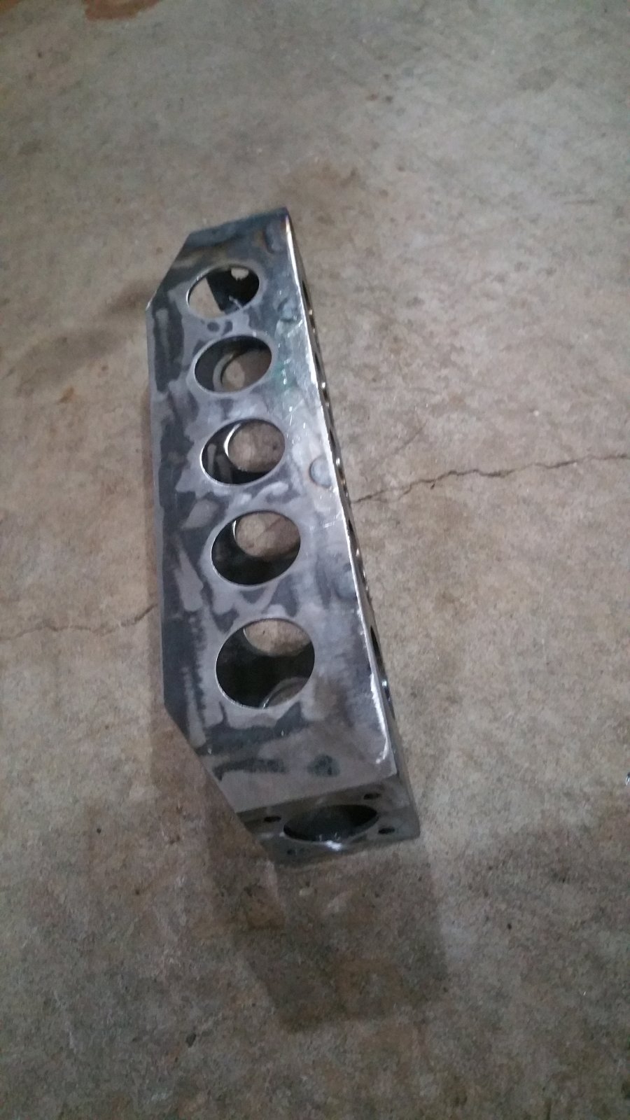

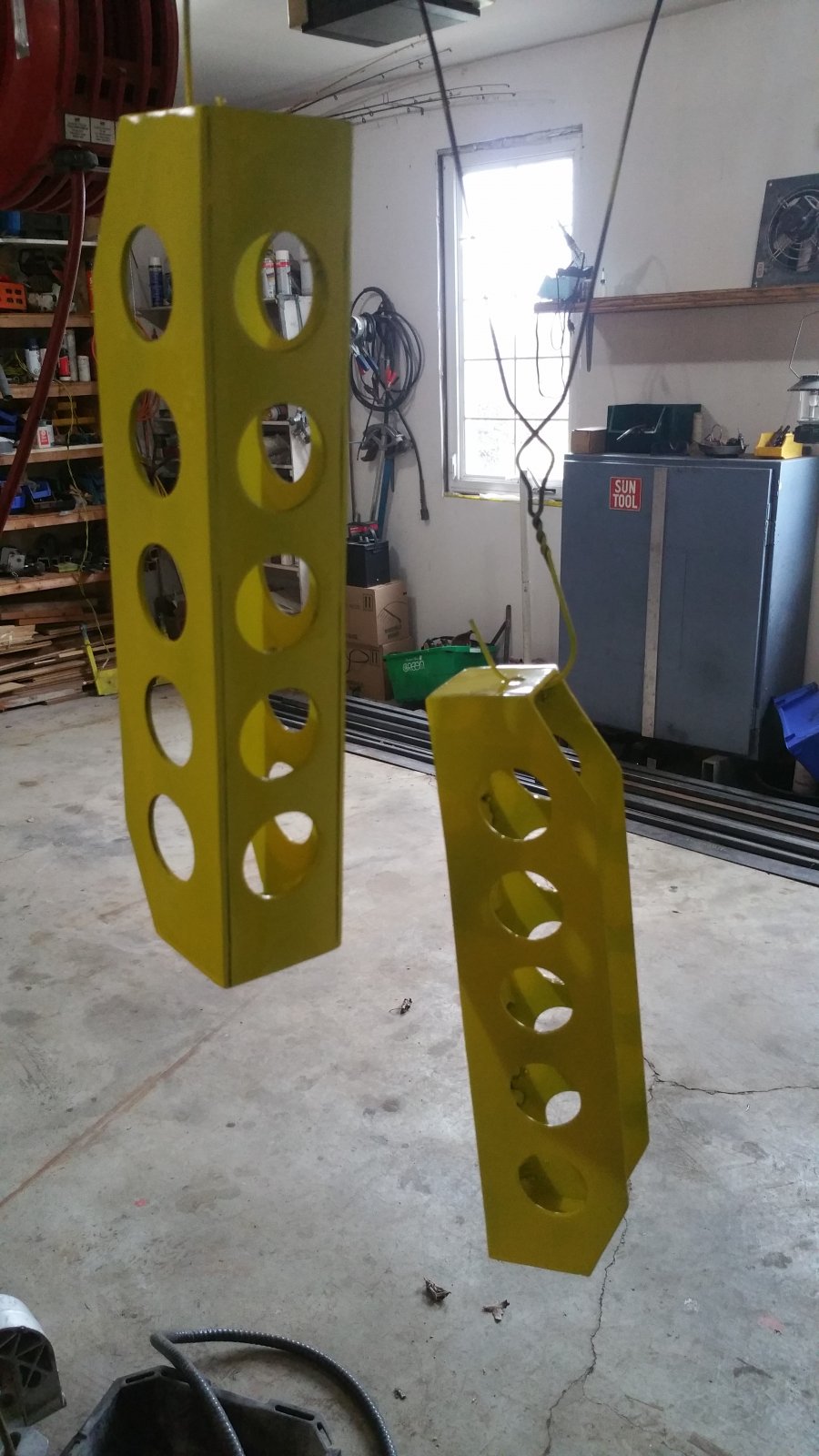

    Got a little more work done today. Fabricated motor mounts for the seat.

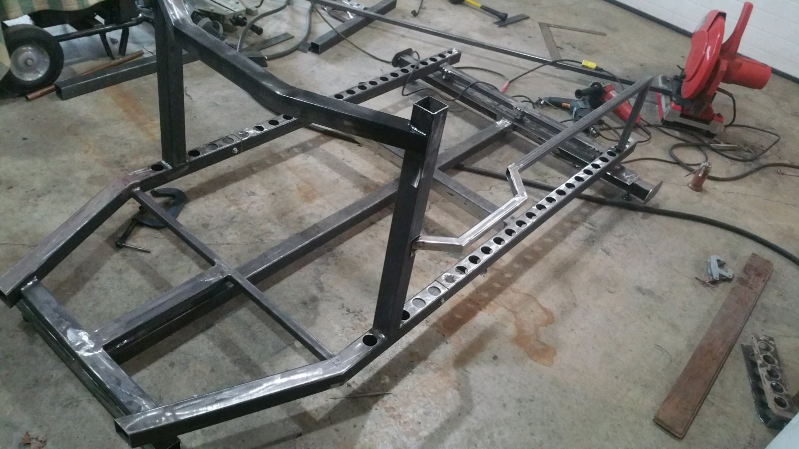

    Update: continuing to weld the frame pieces.

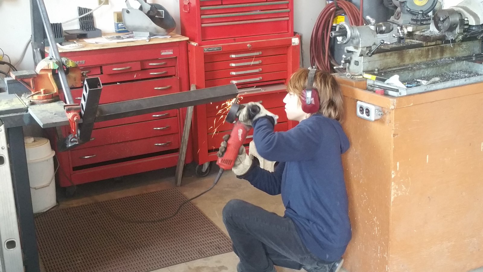

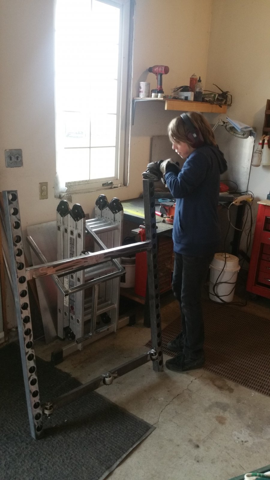

    Today I got my grandson to help with the frame. We decided to cut the frame in half and use joiners to put it back together. This will allow us to move the rig by disassembling it.
  17. insanegr
    insanegr !N$@n€
    Jan 14, 2014
    504
    Athens
    16,721Coins
    +499 / 1 / -0
    grandson is helping to get the rig done quicker but forgot to wear safety glasses:nerd
  18. haroldjames
    haroldjames Active Member Gold Contributor
    Dec 8, 2014
    115
    Electronic Tech
    Ontario Canada
    - 398Coins
    +54 / 2 / -0
    3DOF, SCN5, SCN6
    No, If you look real close you will see he as on a set of plastic goggles. they are hard to see unless you zoom in. lol, you were not the first person to say that. :)
  19. haroldjames
    Dec 8, 2014
    115
    Electronic Tech
    Ontario Canada
    - 398Coins
    +54 / 2 / -0
    3DOF, SCN5, SCN6
    I just looked at the posting myself and you cant see them there, but I swear he does have them on.

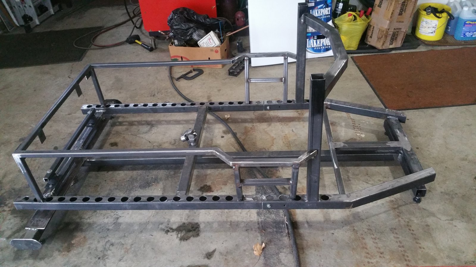

  20. haroldjames
    Dec 8, 2014
    115
    Electronic Tech
    Ontario Canada
    - 398Coins
    +54 / 2 / -0
    3DOF, SCN5, SCN6
    Side frame now complete and rear mount with anti-vibration isolators.
