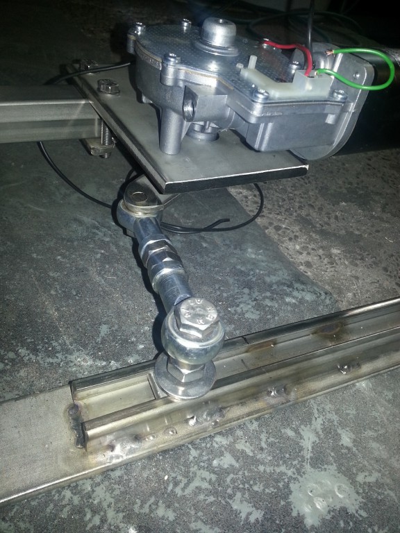

    For the mechanics, I had this idea with the possibility of regulation, I made that this after noon(south) after the work[​IMG]
    I have a travel(movement) max of 17 cms of every quoted(esteemed), what makes a travel(movement) of 10 ° to the right and 10 ° to the left.
    Wheels run(drive) great well and the axis also, practically no strength to move the whole
    I painted in matt black

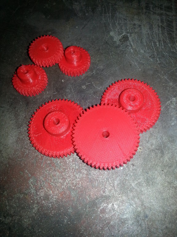

    I printed on my printer 3d home-made cogwheels
    I drew 3d and printed with my printer 2 support(medium) for sabertooth 2x32.
    I installed(settled) them in the new casket, because I began again everything to have more place(square) for connection the casket is in part and linked with different taken[​IMG]

    this is 24VDC truck wiper motors,
    because 12V car wiper motors aren't enough strong for supported a full motion simulator and they break easily.
    Now with 24V motors, it's work well, and for now they didn't break
