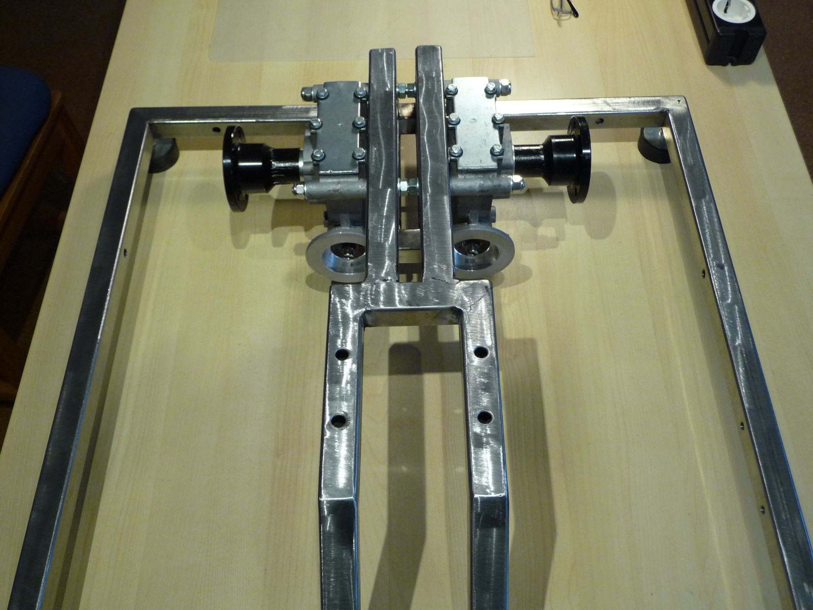

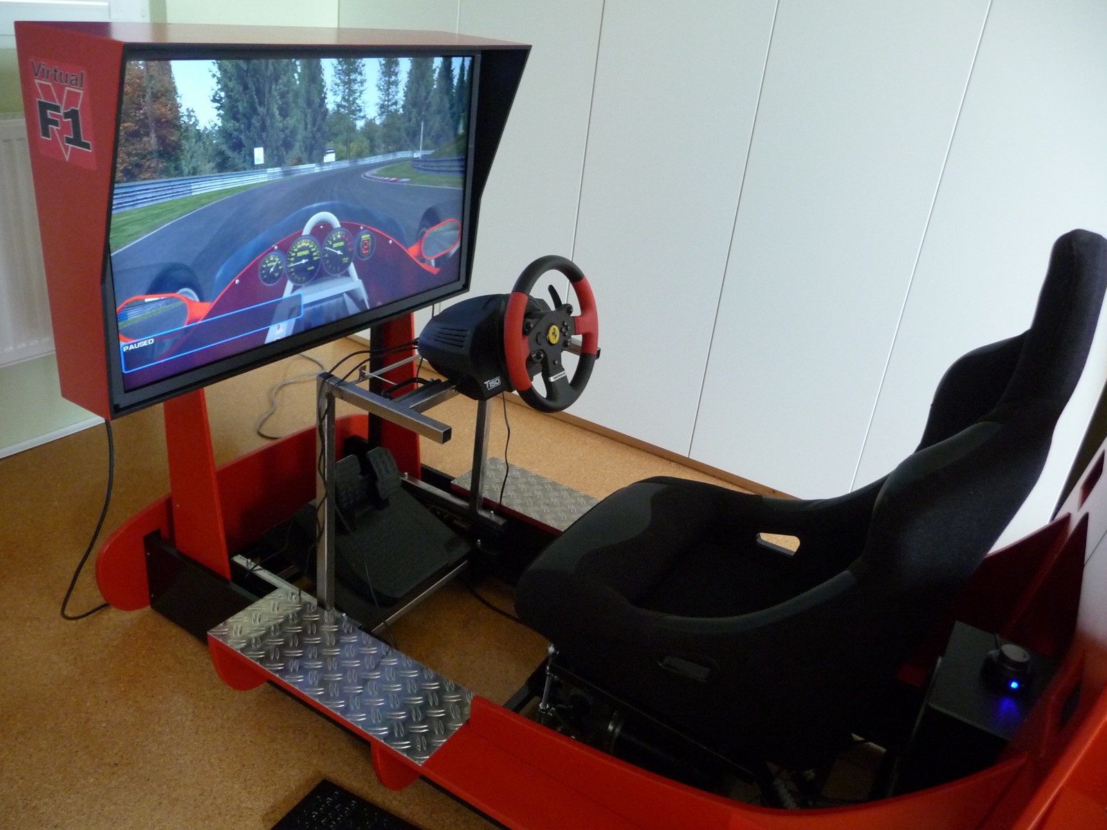

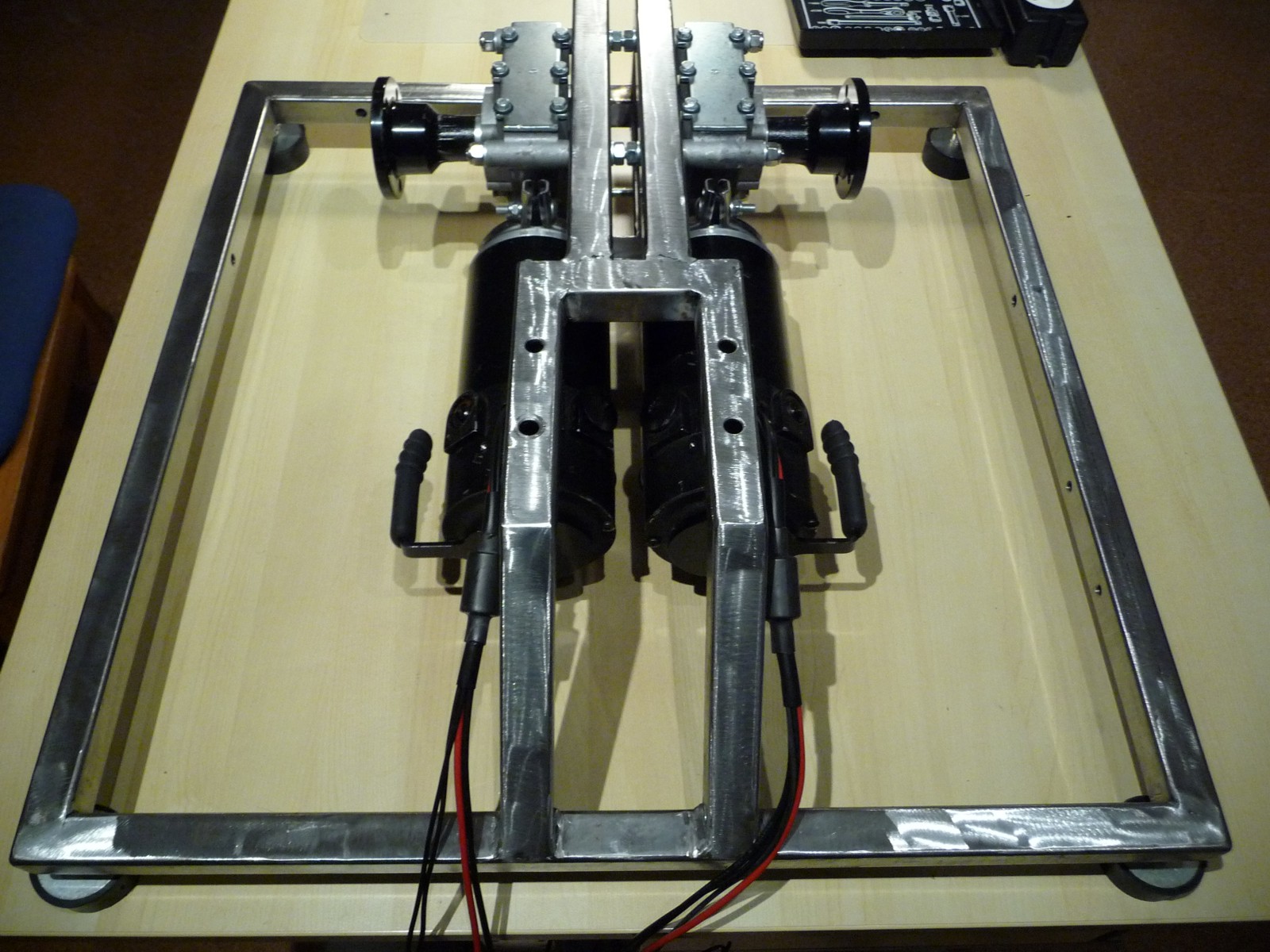

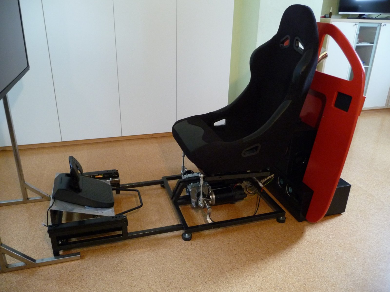

    Edited first post to show current state on 17.March.2017:
    _____________________________________________

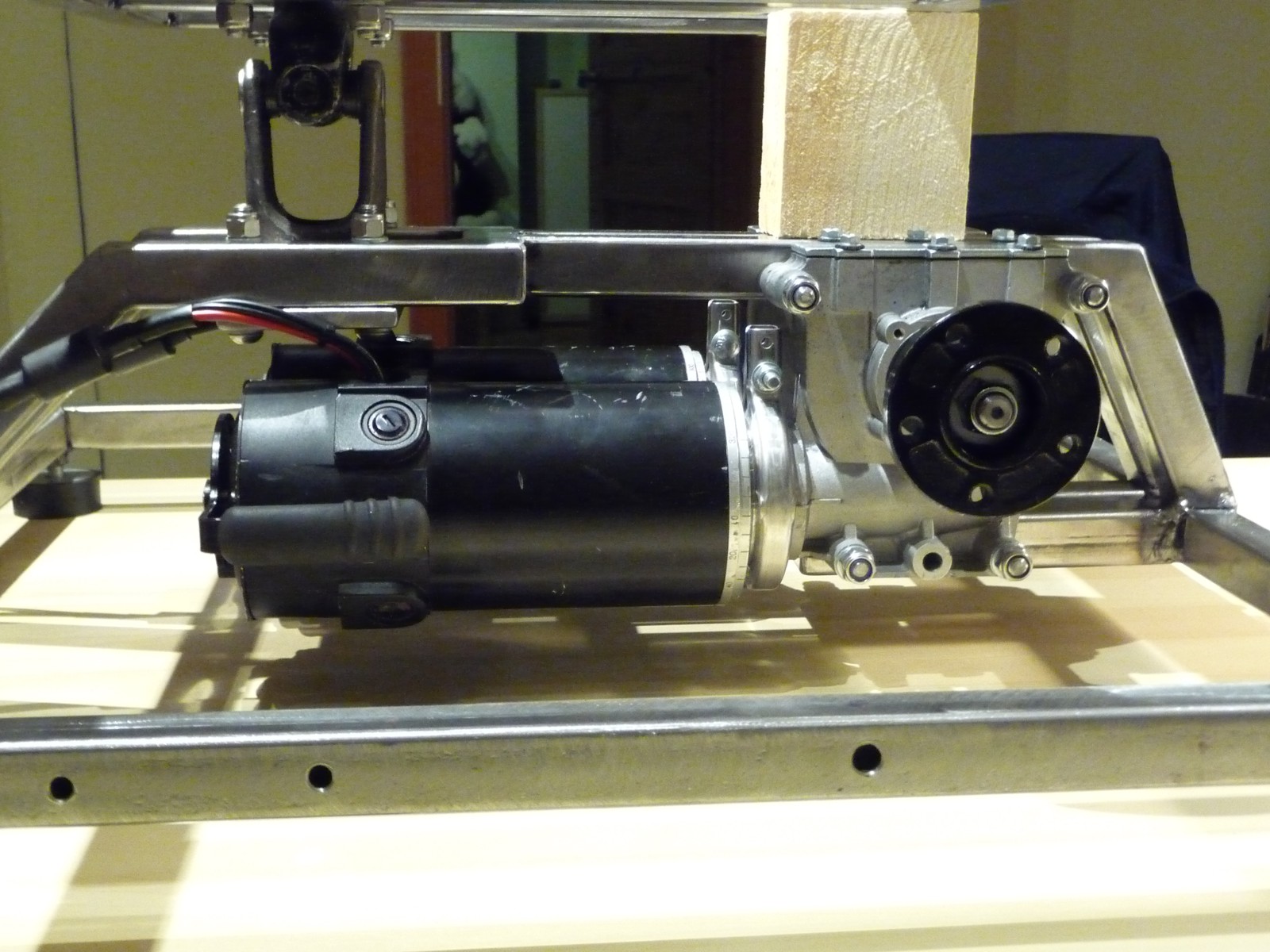

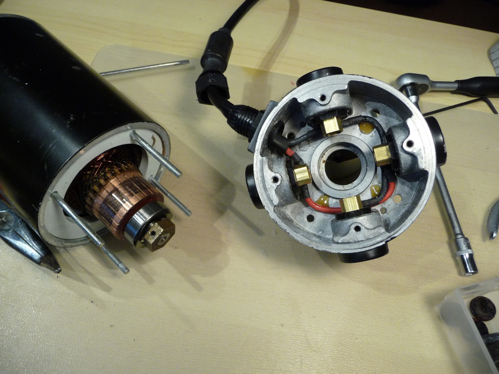

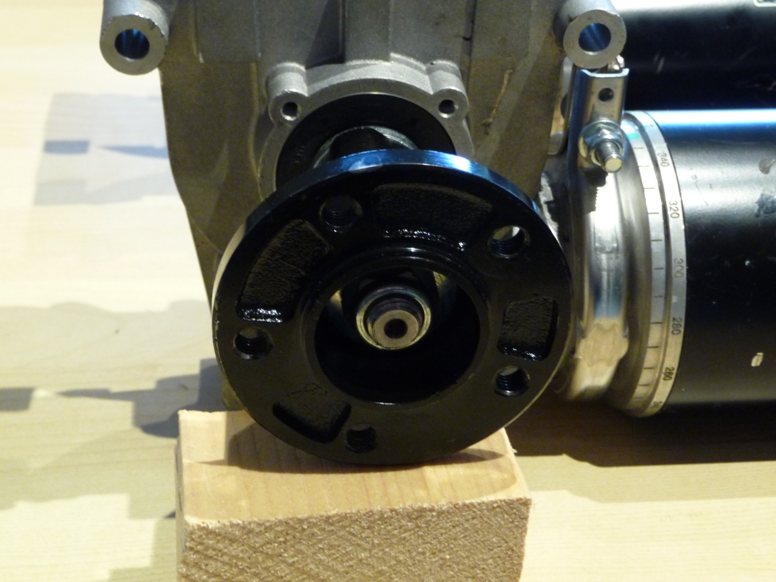

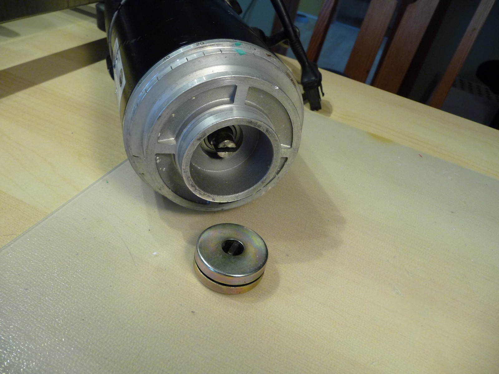

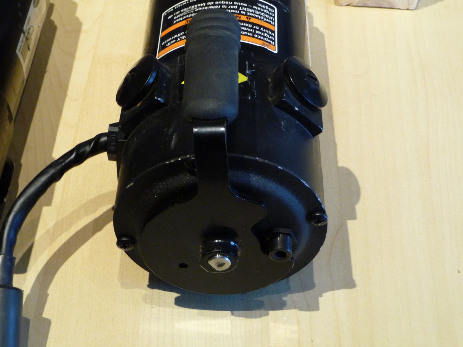

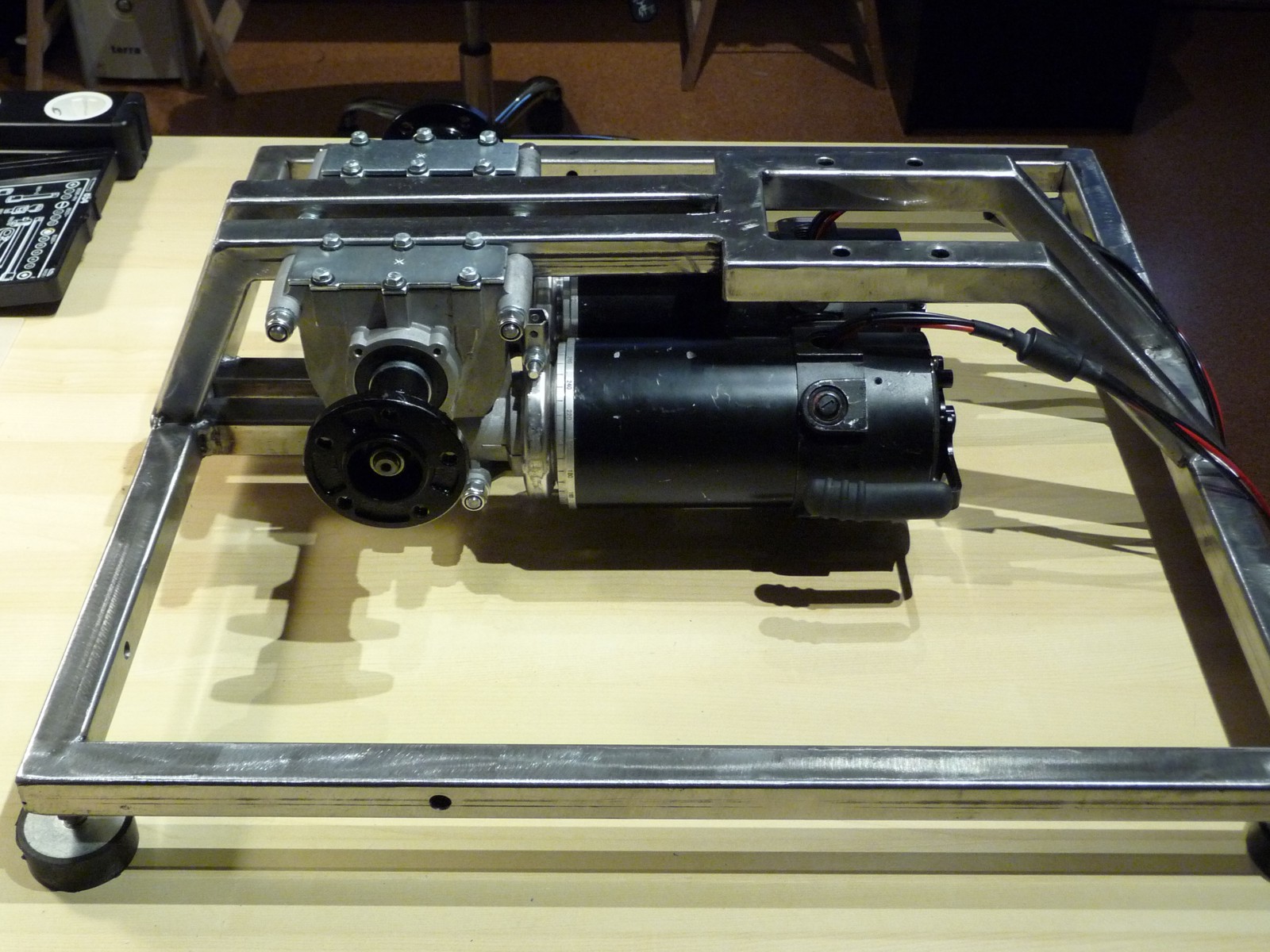

    Hello again,
    after many problems whith my wiper motors i've begun to rework my motion sim.
    I was lucky to get two rarely used wheelchair motors at eBay.

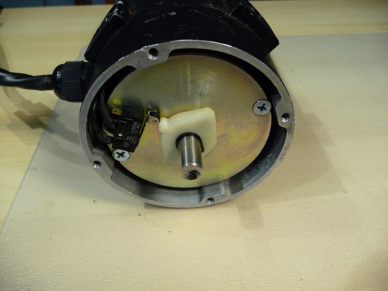

    The specs:
    24V, 250W, ratio 23:1, 3.5A unloaded current.
    Here are pics of the motors:
    The 3rd pic shows the rubber clutch between motor und gearbox.
    Pic 4 shows the lever to switch off the brake manually.

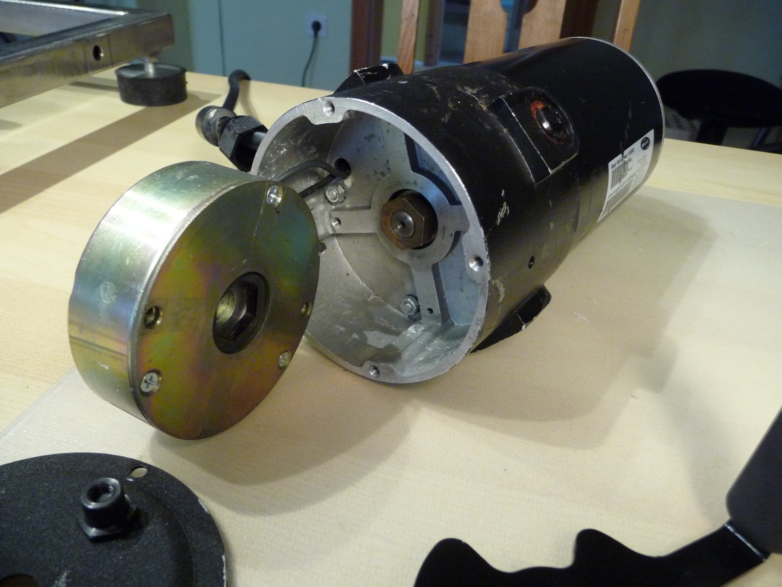

    Next pics show the opened motor:

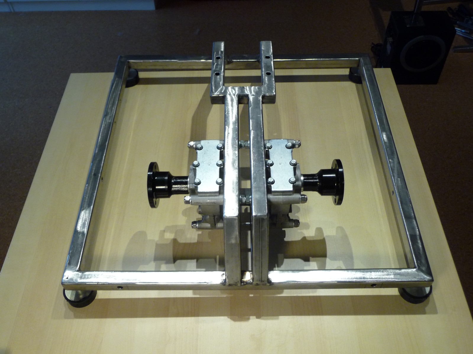

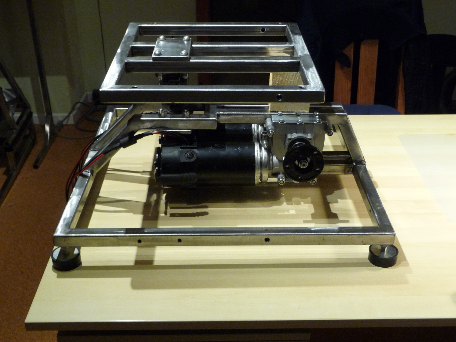

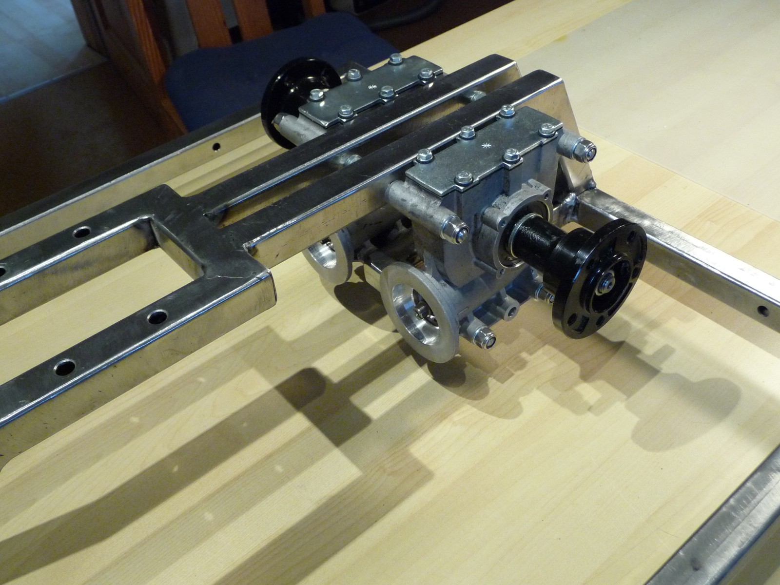

    Final pics show the motors mounted to the reworked rack.

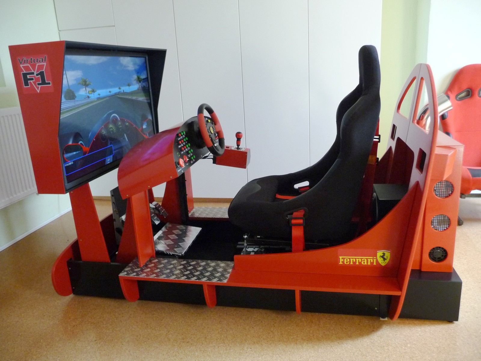

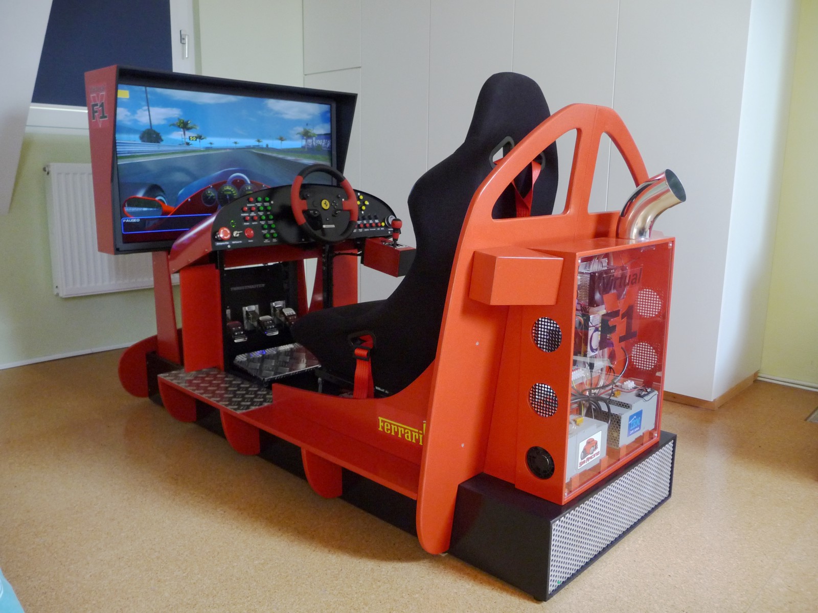

    Hello again,
    it's been a while since my last post, but i was too busy.
    Meanwhile i thought about the design of my sim.
    The first steps are already done, here are some pics:
    Next steps and detailed infos will follow soon.

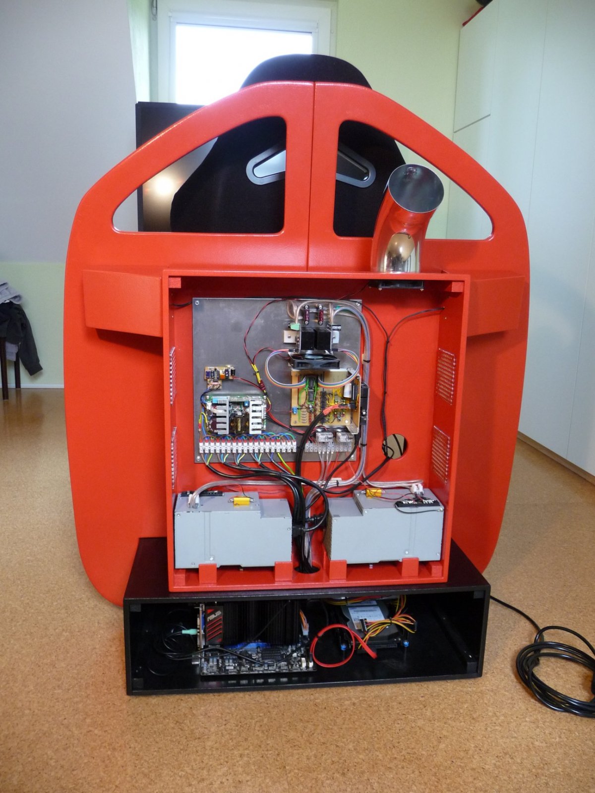

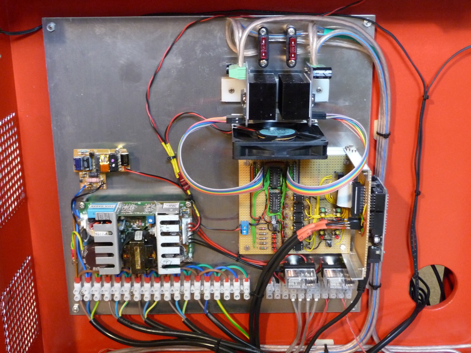

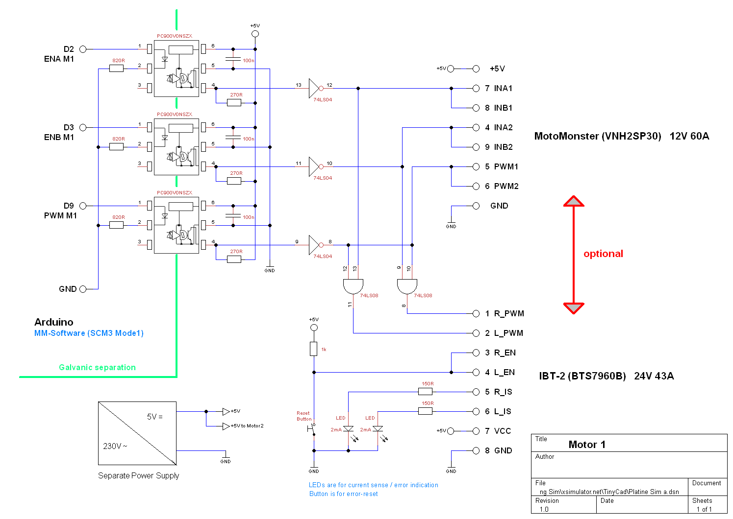

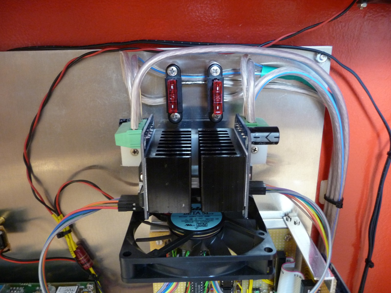

    Here are pics and circuit diagrams of the motor control:
    There are optocouplers between Arduino and motor-bridges to protect the Arduino and the USB-ports of the PC. If there is a bad wiring between the server-PSUs and the motors or a wrong ground connection this could happen (without protection):
    https://www.xsimulator.net/community/threads/cxc-simulator-racer-replica.7709/page-8#post-94022
    The TTL-gates give the possibility to use optional MotoMonster or IBT-2 bridges with only one Arduino-software (MM-software, in my case SMC3 Mode 1). I use two wheelchair motors 24V, so i've chosen IBT-2 bridges.

    Hey @Bernd Manger , nice project you got!
    The closer the monitor to the wheel, the better it is. I'd also put it a little lower

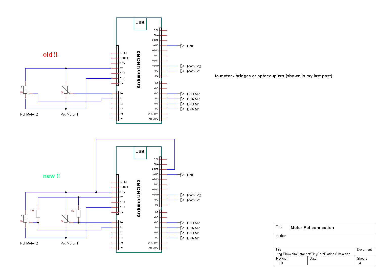

    I've noticed that the Arduino analog inputs have a bad behavior:
    An open input always shows the reading of the previous one.
    For example: If A0 is connected to motor pot 1 and reads 2.5V, an open A1 reads also 2.5V.
    The SMC3 software has a protection against motor pot breaks, but that works only on the +5V or GND wire. If the middle connection of the pot breaks, the software gets a wrong feedback (from the other motor) and the motor gets full power and perhaps destroys something at the sim.
    Here is a circuit diagram of a solution for this problem:
    Only one new line has to be added to the SMC3 software at the setup-routine:
    void setup()
    analogReference(EXTERNAL); // switch to AREF Input (3.3 V)
    There is another advantage of this new wiring:
    The 3.3V of the Arduino is stabilized better than the 5V, witch comes from the PCs USB-port.
    So if the 3.3V are used for the motor-pots, the motor feedback readings have less fluctuations.
    This helps to minimize the unwanted noises from the motors, witch are reported on some posts here.

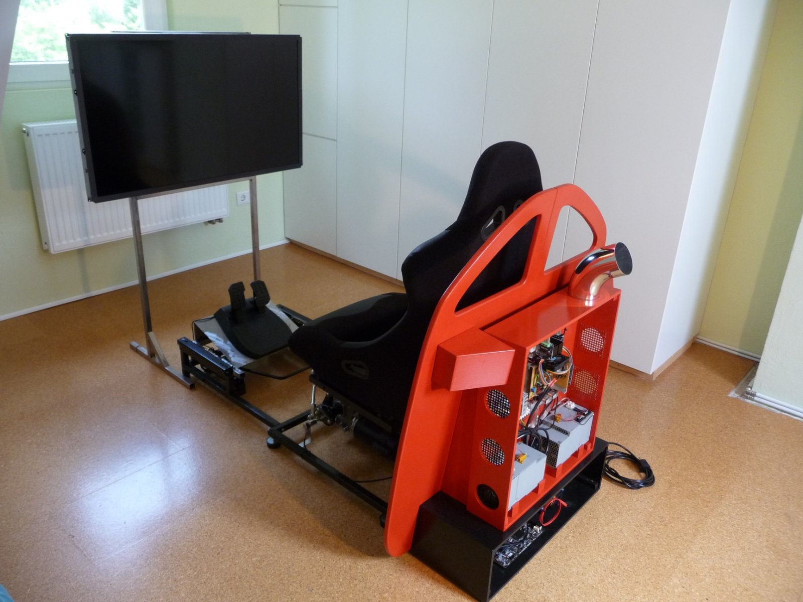

    High Blame73, thanks for your reply.
    I've already made the monitor lower for 15cm last days and put it closer to the wheel now(see new pics), but there must be a space for the adjustment possibility of the wheel.
    Another idea could be to move the monitor together with the wheel adjustment.
    Here is my new "point of view".

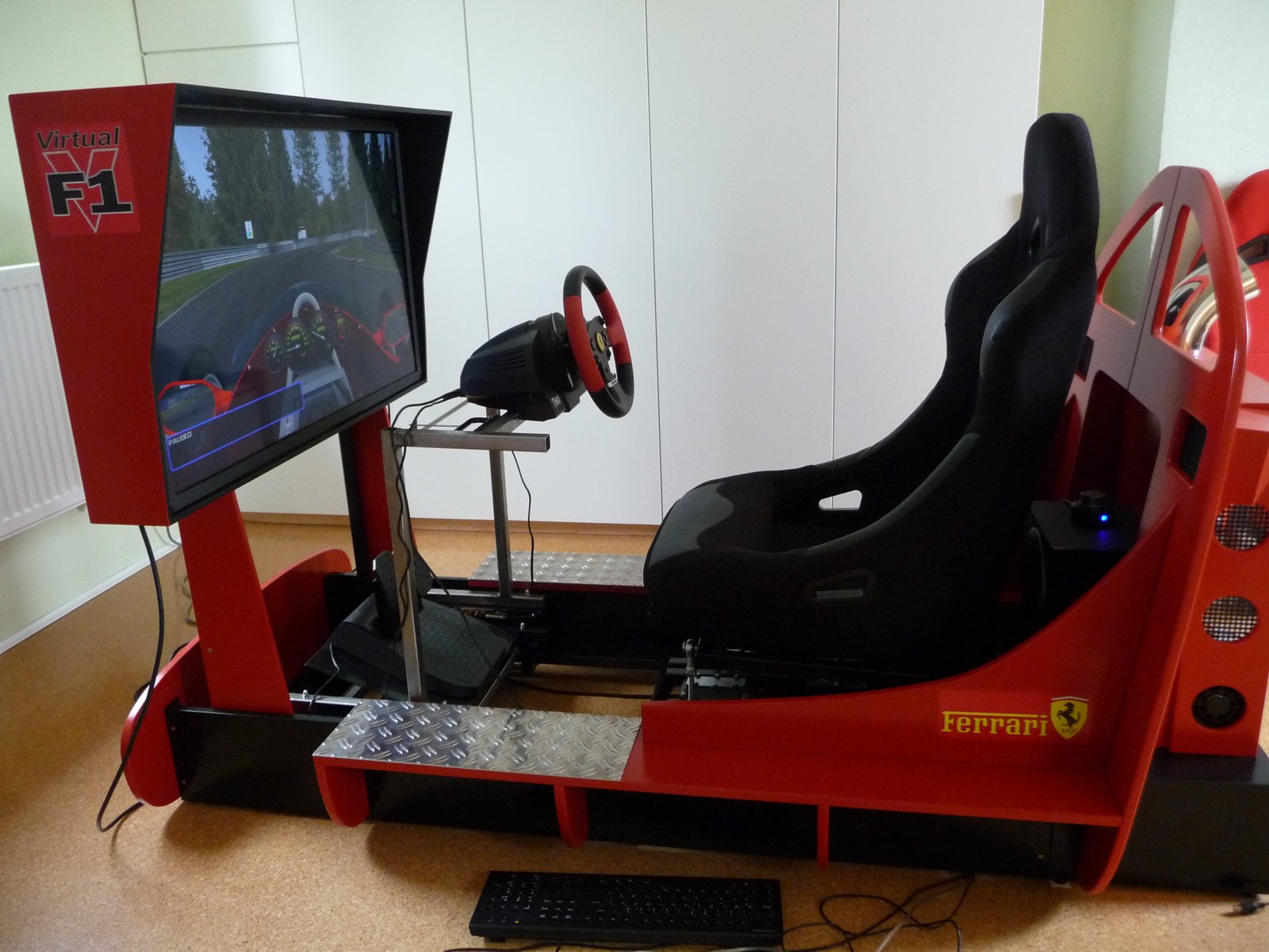

  9. Bernd Manger
    Bernd Manger Active Member
    Oct 6, 2015
    156
    1,055Coins
    +263 / 12 / -0

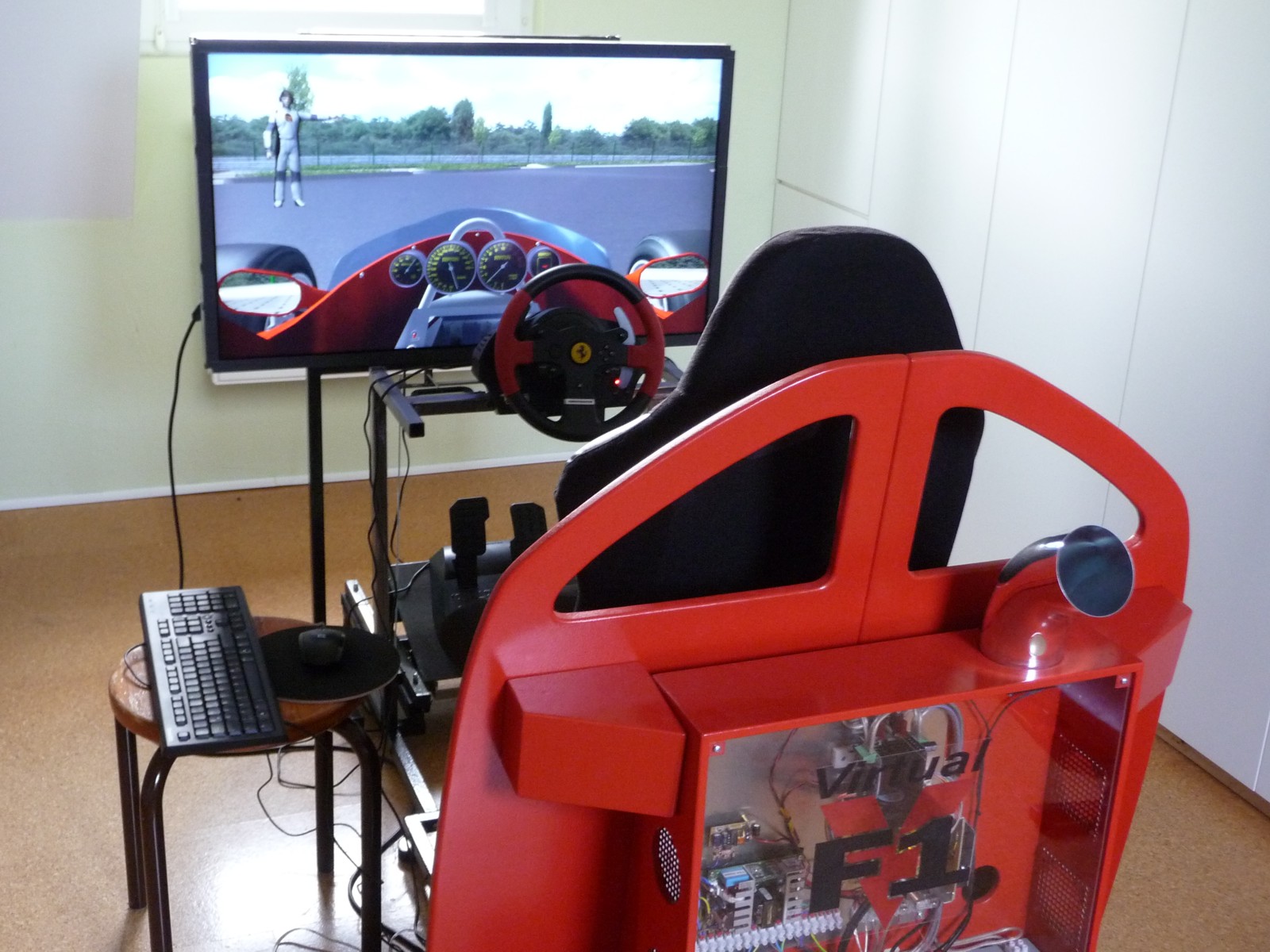

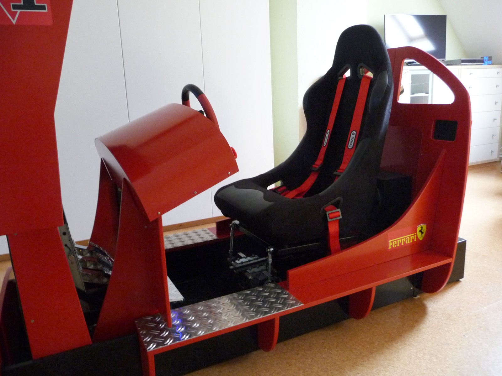

    Little update:
    I've made the side parts and the monitor housing.
    • Like Like x 6

    Very nice project you have there. I like how you build youre electronics.
    I am using arduino and MM's and would like to update the wiring as in the schematic you made.
    But I have a question about the 2 parts you added. Are they resistors or something else where it says 1M?
  16. Bernd Manger
    Oct 6, 2015
    156
    1,055Coins
    +263 / 12 / -0
    The two parts are resistors 1 MegaOhm = 1.000.000 Ohm. They have the task to push the open input to +5V. I tried first to use these resistors at the "old" wiring, but i've had to go down to 5 kiloOhm to reach the desired effect. But that affects the measurement result of the pot-feedback too much.
    Don't forget to add the new line to the SMC3 Software, otherwise you get a wrong feedback result.
    You can check the function with the SCM3 utility. Disconnect the middle pot connection (motors not connected). The green line (motor feedback) has to go over the higher red line (max Limits) and the motor has to be switched "Off" by the SCM3 software. I hope i've explained it understandable.

    Hi all,
    Well Bernd's pot fix works. I have modified my electronics. No more noise had all!!! It was very annoying.
    Thank you very much Bernd. Great job.
