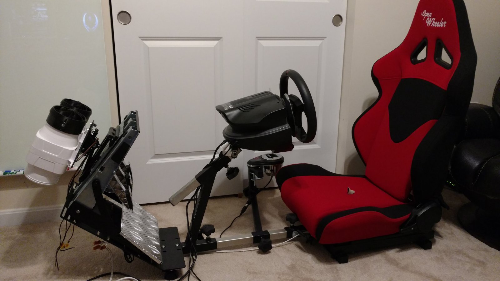

    Hello all,
    I just wanted to take a second and introduce myself. I've been browsing around on this site for several weeks now and have really picked up the bug. I previously built a virtual pinball machine with all the bells and whistles (lights, shakers, surround sound, etc...), and now I'm hoping for another challenge.
    I'd really like to start by simply adding fans to my basic rig. I'm using an Oculus Rift, and I think the air will help with feedback and nausea. I've reviewed the extensive postings put together by @SilentChill and @eXntrc and hope to leverage those. I have the fans hooked up and have purchased an Uno and some MMs. I think I just need to get my Sim Tools registered and hopefully get things connected.
    If all goes well there, I think a simple 2DOF should be in my wheel house.
    Here goes. Thanks to all for the great posts and the knowledge sharing. I hope to be able to contribute at some point.

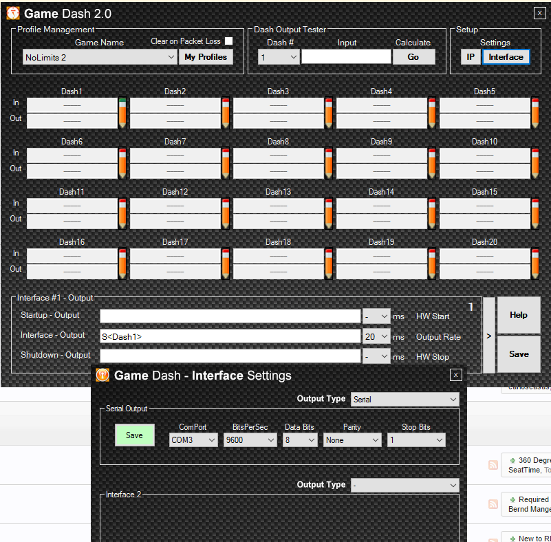

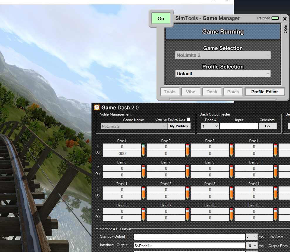

    I purchased the PRO version of Sim Tools and installed it along with Game Dash. I'm not having any luck getting my fans to work with No Limits 2 (Demo Version) or Project Cars. Any help would be greatly appreciated.
    I have Game Engine, Game Dash, and Game Manager are all running. I installed the plugins for both games via the plugin manager. I also patched both games from within Game Manager. I set up Game Dash as displayed in the screen shots below. It seems that when I'm running either game, Game Dash isn't picking up the output from either. The Text Field in Dash1 In remains at 0 (zero) and the Out remains at 000 (triple zero). I am able to go into the command editor and change the PAD value from PAD 3 0 to PAD 3 1 and force the fans to work as this places a 110 in the Out of Dash1, so I know that if I can get an output signal, I should be able to get some motion.
    Any thoughts on what I might be missing?

    I don't believe the demo version of NL2 is supported, only the full version.
    Check the Game section of the FAQs for configuration tips for both games.

    Thank you @noorbeast! I downloaded the full version of NoLimits 2 and also set the "--telemetry" option during start-up as instructed in the FAQs that you mentioned, and I'm now getting some wind. It's still not quite right (fan speed vs. coaster/output numbers), but I'll work on that over the next few days when I get some time and try to figure out what's going on. At least I have something to work with now.

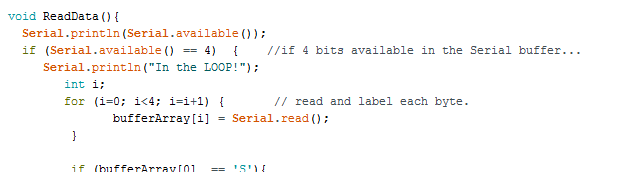

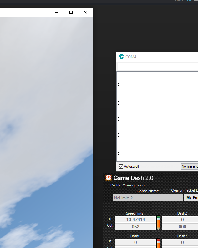

    I was away for a few weeks and have now come back to try to dial the fans in. For some reason however, I'm not having any luck with getting them to work as they were before. Now, I'm getting In/Out Speed in Game Dash, but I'm not getting any Serial Output to the Arduino. I don't recall having changed any settings from they way it was previously when it was working.
    I'm running No Limits 2, Full Version with the --telemetry switch enabled as described in the Game's FAQ section. I also have Game Manager and Game Engine running in the background.
    I am able to send signals to the Arduino and have the fans work using the basic program as provided by MonsterMoto, but when executing the updated code by @SilentChill, I'm having no luck. I've inserted two Print Lines in the ReadData method. One to show how many bits are currently in the serial buffer and another to print "In the LOOP!" if it ever gets to 4. Unfortunately, all I'm getting are zeros in teh serial monitor. My interface settings are still the same as they were in the pictures displayed previously.
    Below you can see a picture of the serial monitor blasting out zeros, as well as Game Dash displaying the speed. I've also included an image showing the two Serial.println calls I've added in the ReadData method.
    Any thoughts on what might be going on?

  10. yobuddy
    5,408
    50,691Coins
    +5,166 / 19 / -0
    Not sure on the ard side of things, but you could add a 'virtual' interface to the interface #2 slot.
    Send it the same thing as you do with Interface#1 but at 50ms.
    And you'll have a good idea of what is being sent from GameDash buddy.
    Hope it helps some.

    Thanks @yobuddy. In reading about the updates to 2.0, I saw that the VI was an option, but didn't know how to implement it. I was just able to get it working however, and the output that I see in the Virtual Interface is as expected (proper speed numbers). For some reason, I'm just not making a serial connection to the Arduino via Game Dash. I verified the port settings on the Arduino via the properties window and everything appears as expected (9600 Bps, 8 Data bits, Parity:None, Stop bits: 1).
    I'll have to keep digging.

    That's essentially what I'm doing by adding the two Print Line calls in the ReadData method. My serial output just continues to display zeros as the first print is showing that nothing is being received. The second print, inside the loop, never gets called because it never gets to 4 bits. I'm banging my head on the wall trying to figure out what could have happened. I've tried installing the software on another PC, switching out USB cables, and as previously mentioned, head banging!
    If you can think of anything else that I might try. Please let me know.

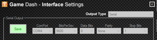

  16. yobuddy
    5,408
    50,691Coins
    +5,166 / 19 / -0
    What does the bottom settings of the GameDash window look like?
    The Interface Output settings that is.

    +7 / 0 / -0
    I have provided a screenshot. I went ahead and installed Live for Speed and I'm getting the same results. I get numbers for In and Out on Dash1 at the top, but nothing makes it to Serial Output.
    Thanks again.

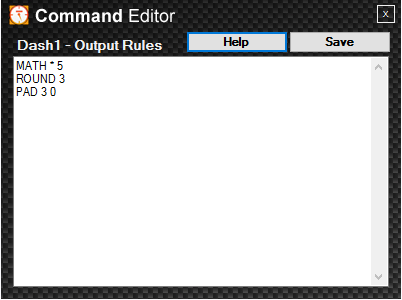

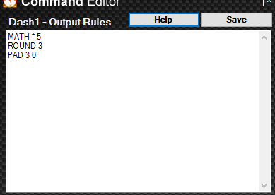

    May I see a pic of you edits for Dash1?

    I suggest adding a "virtual output" to interface #2.
    Then send it the same thing as you do for interface#1 (but at 50 ms).
    Then you can see what is being sent buddy.
