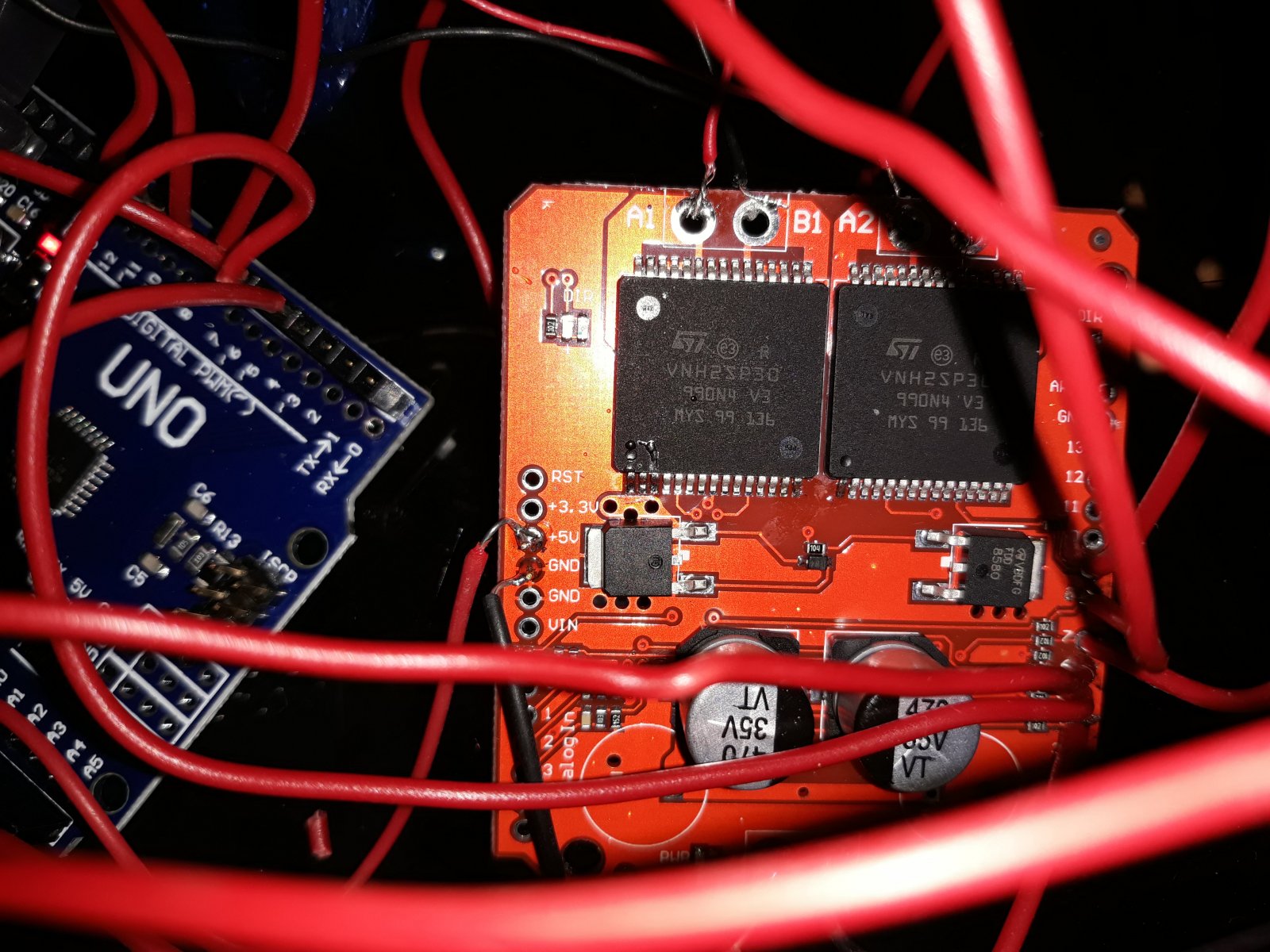

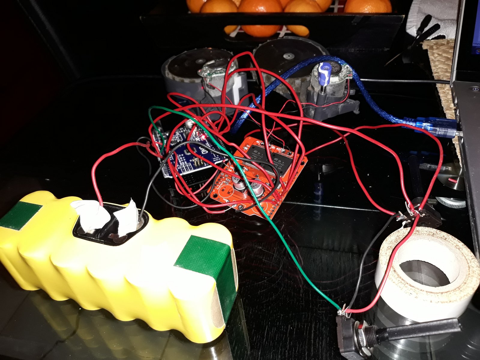

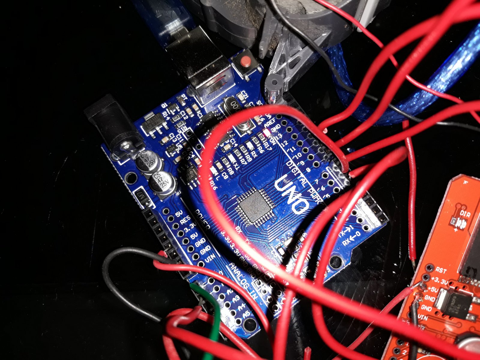

    Since 6 years ago I am trying to built a lowcost 2DOF seat using car wipers.
    In 2013 I discovered this web and I started taking all information that I needed but due to personal problems it was imposible. Also I tried first versions from Xsimulator.net.
    Now 5 years later I am trying again with positive results.
    I already have Arduino , Motomonster and 2 DC motors take it from a old vacum for testing purpose.
    Finally looks working , my next step is to try to have interconecction between Arduino and Live for Speed becasue still no coneectio nbetween them. Maybe because of setup the software. Let's see I will keep working on it.
    Please find attached some pics of my firsts test.

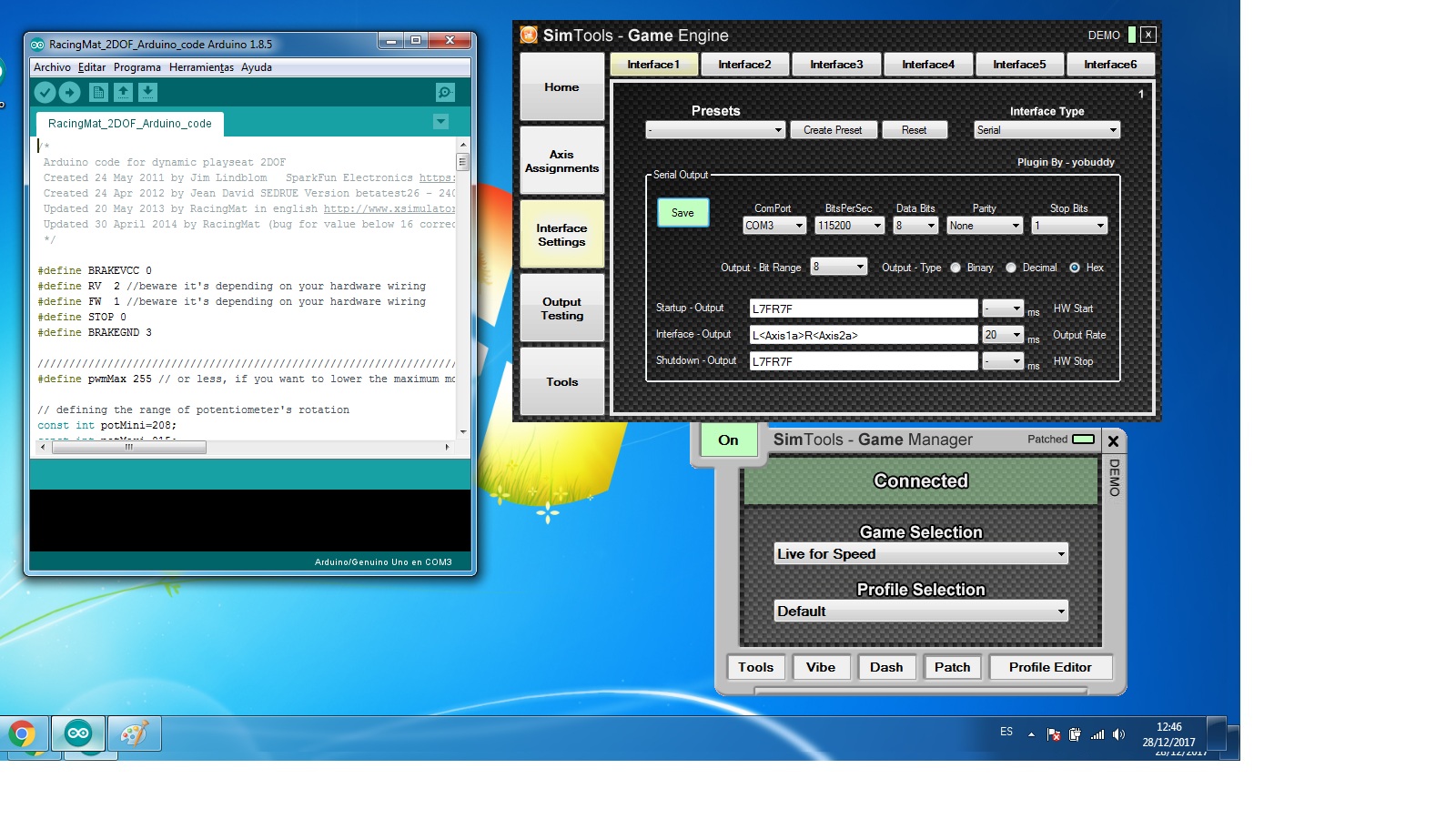

    Please find attached my software configuration.
    1.- Potenciometers are working properly. --- Moving potenciometers I can move both engines in both sides each one.
    2.- SimTools ENGINE OUTPUT Testing also looks working. --- Moving mouse I can move both engines in both sides each one.
    3.- But using Live For Speed game ... Arduino receiver LED comes on but no engines movement.
    Any idea appreaciate.

    Great noorbeast!
    Finally works.
    As you said I repatched the LFS and works.
    Now is time to learn how adjust Axis and %. Then I will start to build the seat with the wipers motors.

    In the first pictures you posted I see you were not using heatsinks.
    Did you then intall them? It's also better to use fans

    Hi Blame73, yes I will, just doing some tests. with 12v mini dc and small battery.
    Now I see is 100% working , second step will be to buy wipers and transformator.
    thanks a lot
