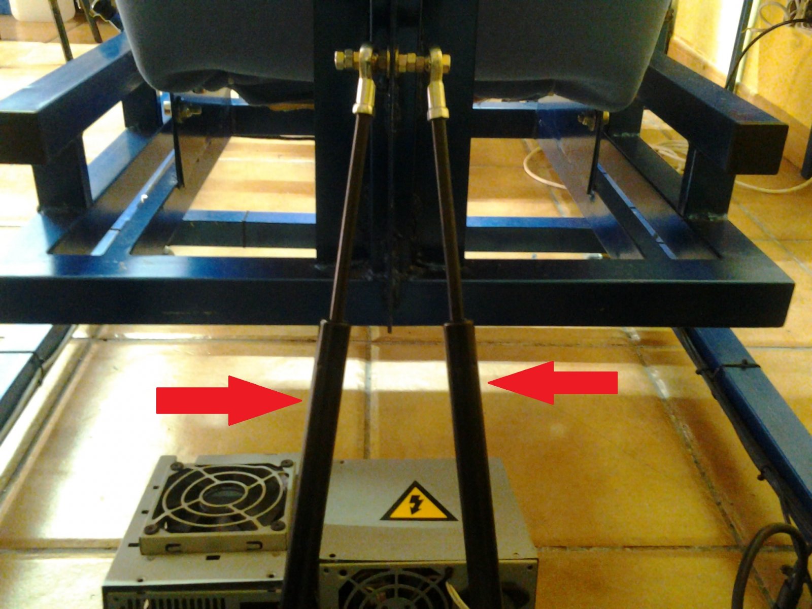

    Not sure what you mean by 150 laps.....
    yes thats normal for the motors to slump when not under electric power.
    You do realise you are restricting motion with the gas struts. They are designed to hold and also gas struts absorb shock, so finer motion may not be felt.
    Its like the springs to help maintain a level platform when its not under power. Its for looks mostly and comfort. Not for sim use.

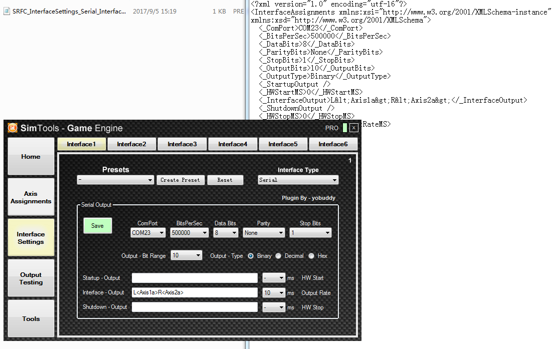

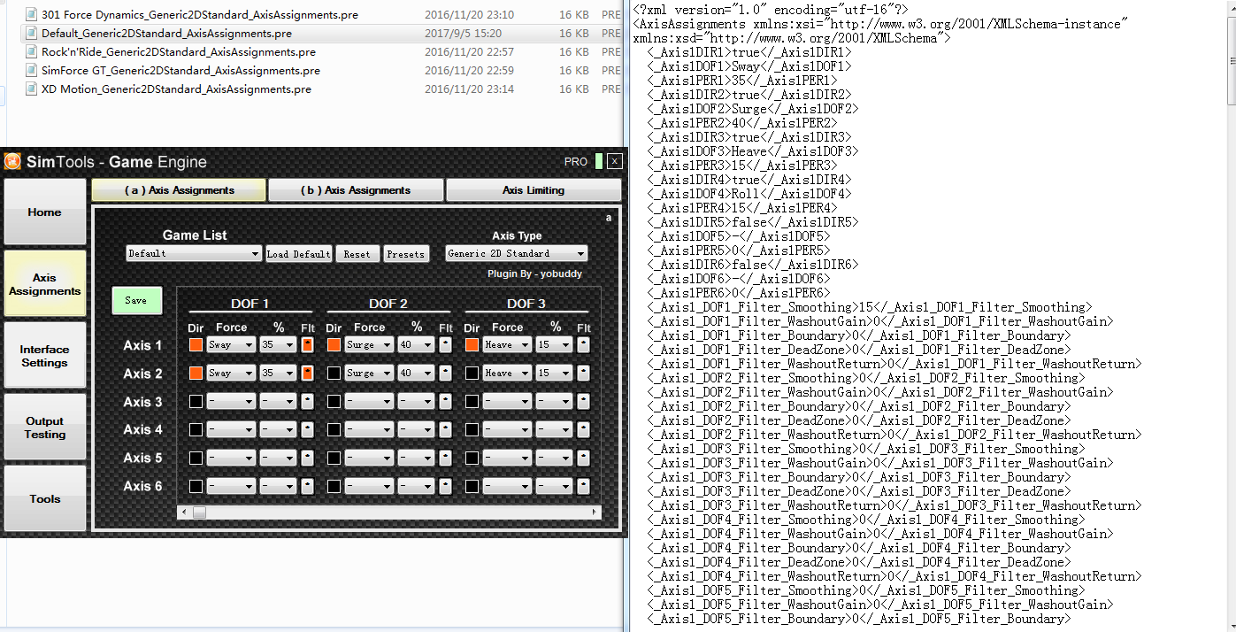

    I have a question: SimTools 2.0 Input Settings - using Serial, but my emulator isn't moving, what's wrong?If it is convenient, please give me an InterfaceAssignments configuration file, thank you!
  15. paulopsx2
    paulopsx2 Active Member
    Apr 2, 2016
    613
    brasil
    616Coins
    +163 / 2 / -0
    com port is ready/ conected?
