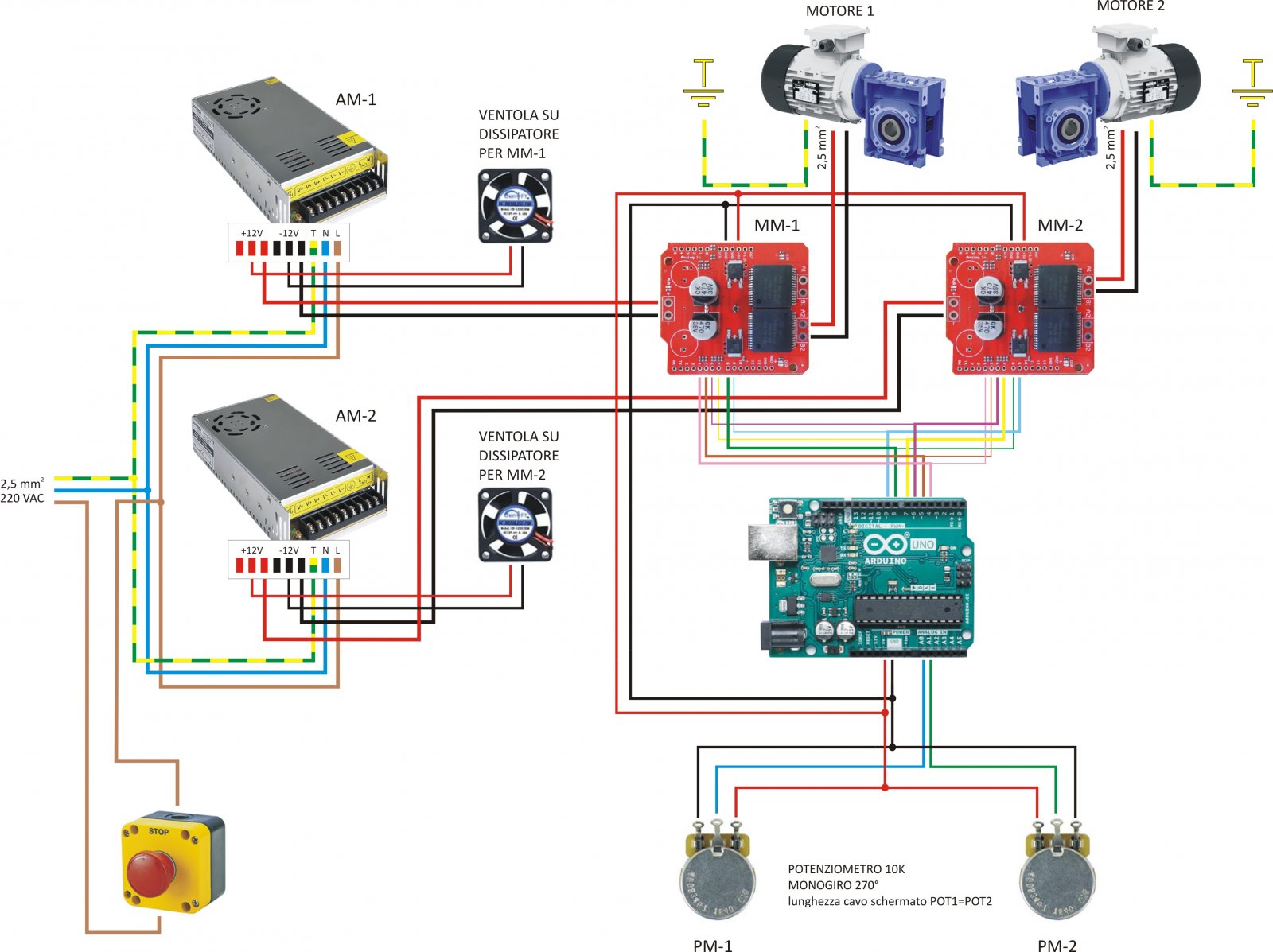

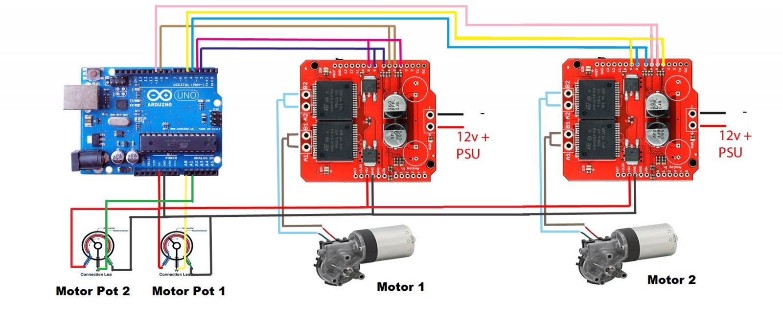

    Was wondering which of the following is the correct way to wire. I noticed differences between the monster Moto and Arduino.

    Ciao Andrew,
    the two ways of connecting MMS are different because in my case (drawing with all the components) I found a trick to make the two MMS work which had one of the two faulty channels. The draw must work with a single MMS for two electric motor. I had published that draw to document my problems.
    In my tests I burned several MMS and I decided to change the entire system with the SMC3 system that you find on the site.
    I advise you not to follow my pattern with the two MMS because as mentioned it is a trick that has not led me to positive results.
    The second scheme provides for the use of more powerful motors and therefore two MMS are used for two motors (requires a schetc for specific arduino).
    If I can afford it, I recommend following the SMC3 system

    yes, watch the Racing Mat tutorial, there is a lot to learn.
    I myself followed the RacingMat tutorial but I used 250 Watt 12V 25A electric motors, for this reason I burned the cards, (Not clones but bought at Sparkfun) I also cooled them with heatsinks and fans but it didn't help. MMS bear up to 30A per channel.
    If you intend to install electric motors up to 15A on your Simulator, I think MMS is fine otherwise you must use more suitable cards, or use an MMS for an engine. I personally have changed with the IBT2-7960-B and as per the suggestion of my post the problems are gone.
