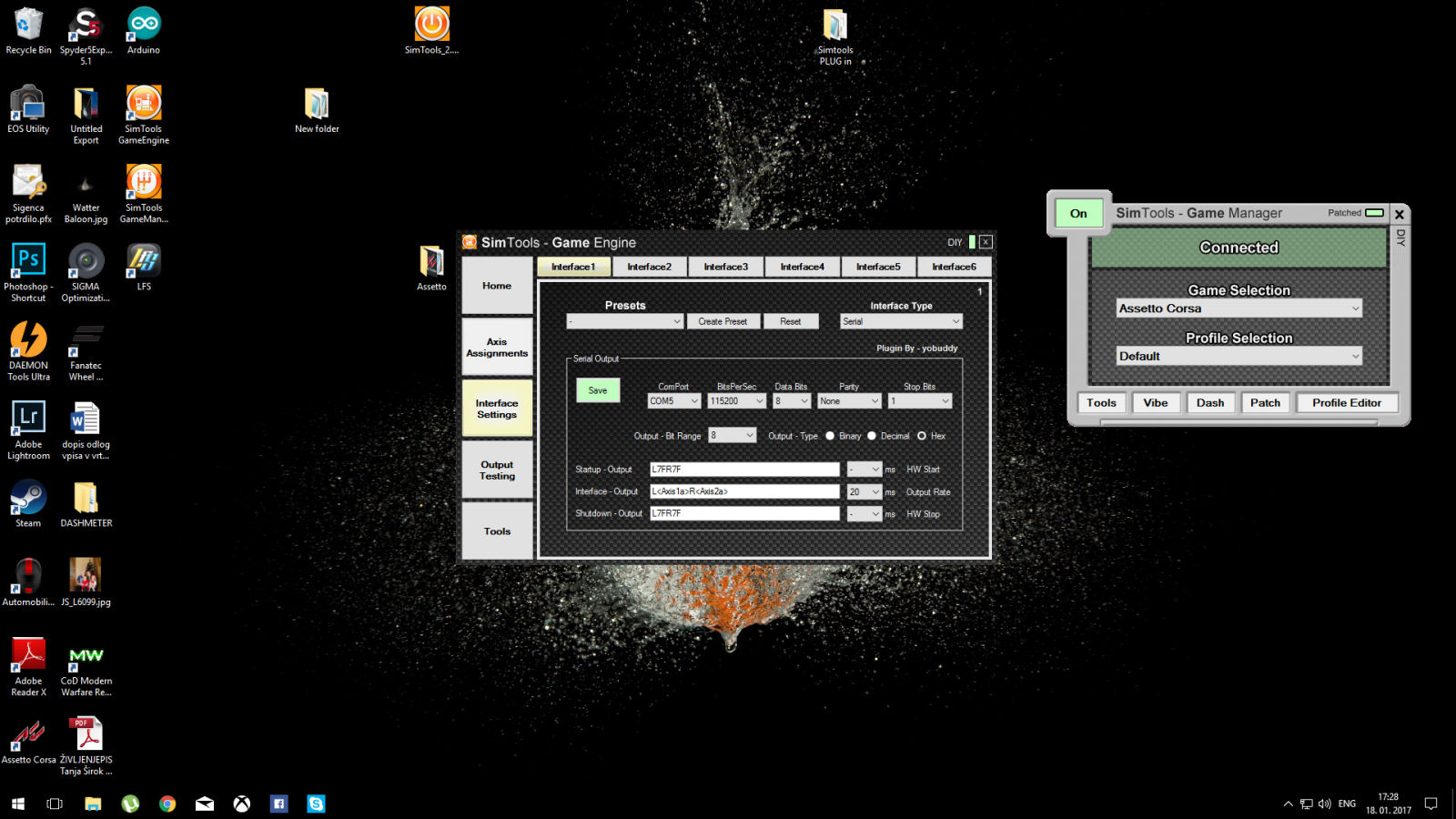

    Hi me again after 2 years ;) hug:
    I have a problem with my setup. After 1 year of sleeping in sim racing i decide to play again with motion. I install SimTools 2.0 and nothing work any more :(
    Ok download Arduino code from @RacingMat, put in to Arduino and motor just turn in one direction never stop. Then searching for code. Found here http://www.gamoover.net/Forums/index.php?topic=25907.0 But no work in SimTools 2.0 . I try in SimTools 1.3 there is working ( Output testing (manual)).
    If you have any idea what will be wrong.
    :sos:sos

    By default SimTools 2.0 is in demo mode, which includes the LFS plugin for testing purposes. It needs to be unlocked to access other plugins. See here to request a free DIY SimTools 2.0 license, conditions apply: https://www.xsimulator.net/request-diy-key-simtools/
    SimTools 2.0 also has a slight change needed for the Interface Settings, where you will need to specify the group, normally 'a', like this: <Axis1a>
    With respect to the code it sounds like the tolerance parameter is not properly set, carefully follow all the instructions here: https://www.xsimulator.net/community/marketplace/arduino-code-2dof-and-2-pins-direction-hbridge.67/

    Hi @noorbeast
    I follow all the instructions and now work in manual testing. I also try LFS but not work in game. Yes game is patched. What i am do wrong?

    Please post pictures of all of your settings, particularly your Interface Settings and Axis Assignments.
    Does Game Manager turn blue when LFS is running?
  16. Ramok
    Ramok Member SimAxe Beta Tester Gold Contributor
    Mar 6, 2013
    45
    Slovenia
    1,130Coins
    +11 / 0 / -0
    Here is my screenshots.
    In LFS game data output is "0" and AC show some numbers.
    2017-01-18 (1).png 2017-01-18 (2).png 2017-01-18 (3).png 2017-01-18 (4).png 2017-01-18 (5).png 2017-01-18 (6).png

    That was my guess. Your MaxMin settings in Tuning Centre are all ±32767. With such high numbers you will never get any movement.
    Click on
    Capture Max Min, then on Reset and drive a round (without crashing) and Save New Settings.
    You'll have movement!

    Ok thanks a lot @value1 AC works great. :thumbs
