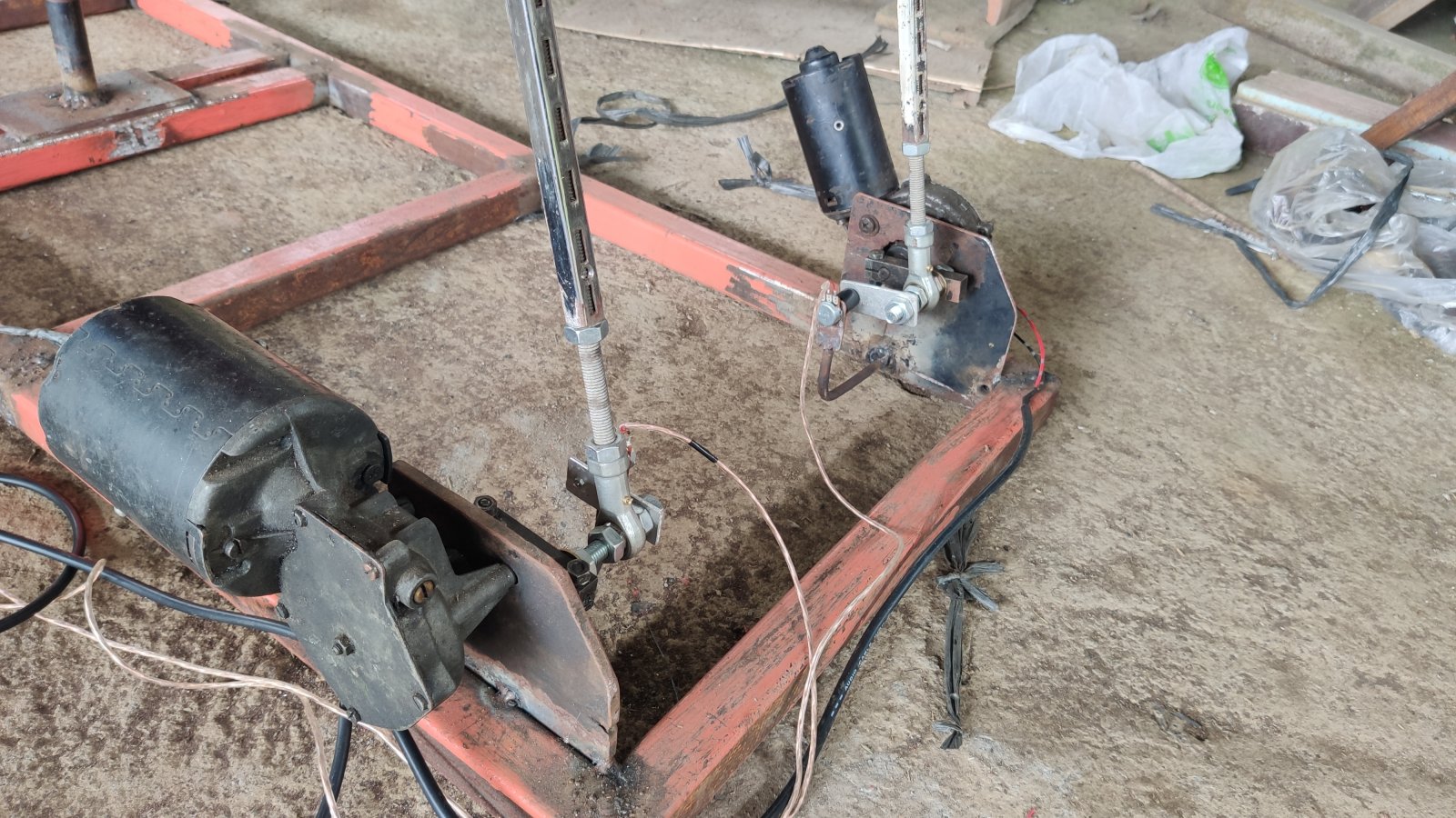

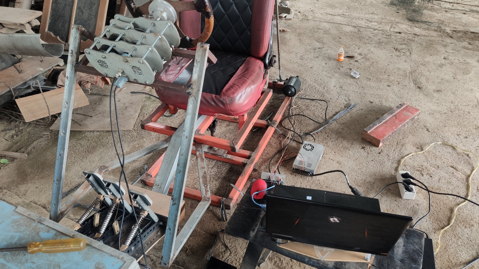

    Thank you to Mr. @noorbeast for guiding me, and I have succeeded in building a 2dof wiper motor, even with a different wiper motor, by the way, is it possible to balance the two wiper motors, sir ??

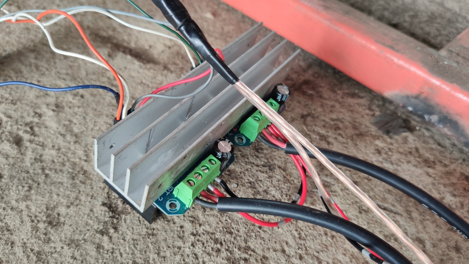

    and sometimes suddenly one of the wiper motors stops for no reason (sometimes stuck min sometimes stuck max then dies) I think bts7960, I tried to switch positions with the running motor, it turns out the bts7960 is normal, I think the pottensio is overturning, I try to turn it in the opposite direction from the stop there is no movement, the wiring is correct and everything is safe, I used a homemade jumper cable with the cable of choice. guess what the cause is, sir ??.
    this is the youtube link of my work and the guidance of Mr. @noorbeast. now I have to learn to perfect the settings before I can buy a more powerful and recommended dc motor. link:

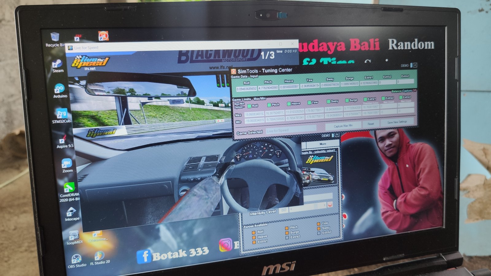

    I am not sure what you mean by balance different motors, you can set different parameters for each motor in SMC3 if you want to, it would likely take some experimentation to get about the same response from different moors.

    Alright sir, i will try, but I'm still confused about the motor that suddenly stopped by itself, even though the bts7960 wasn't damaged. Is it the potential that is starting to break down, sir?
    21,581
    151,100Coins
    A motor stopping can be a number of things, in SMC3 if the levers move past the designated range it will stop for safety reasons, which is why I have suggested trying to refine your settings.
    Another possibility is overloading and tripping a PSU, as our rigs generate big power spikes in fast reversals. A power cut is likely triggered by big movement events like a crash, where all axis try to move to their limits.
