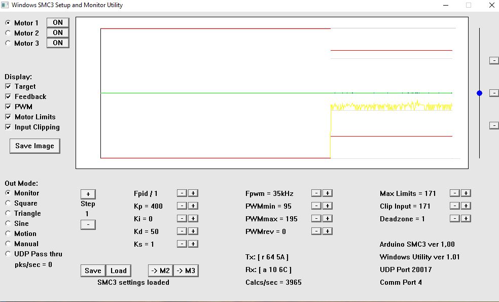

    Off couse. The problem is there even with only the SMCutil running, so a screenshot of those settings.
    The noice i mostly comming from 1 of the 2 motors. (both have the same settings).
    I already addes a .1uF cap (104) across the signal and gnd of the pod and added a ferrite coil around those wires.
    the connections between the arduino are cfr the SMC3 manual, except for the pots, they are connected to A4 and A5 (and off course this is changed in the arduino code, also the orignal thing that was linked to A5 was remapped to A1)

    Please set Fpwm to 25 and advise if that makes an audible difference.
    Are the motors ground isolated: https://www.xsimulator.net/community/faq/wiper-motor-mandatory-ground-isolation.25/

    I tried the Rpmw of 25 and there i no real difference (setting it to 5 or 10 generates an extra high pitch sound)
    The ground: Normally it should not be a problem (i think) since the construction is made of wood. So there is not metal connectorn betwoon the 2 motors (only possible connection is by the power cables). There is also no metal connection between the motor and the pot (plastic)
