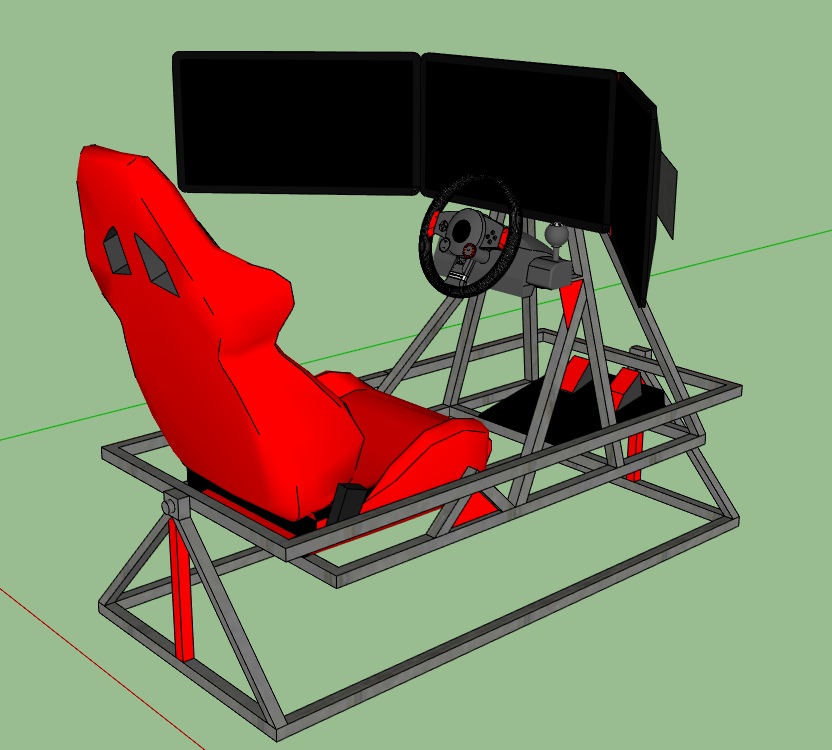

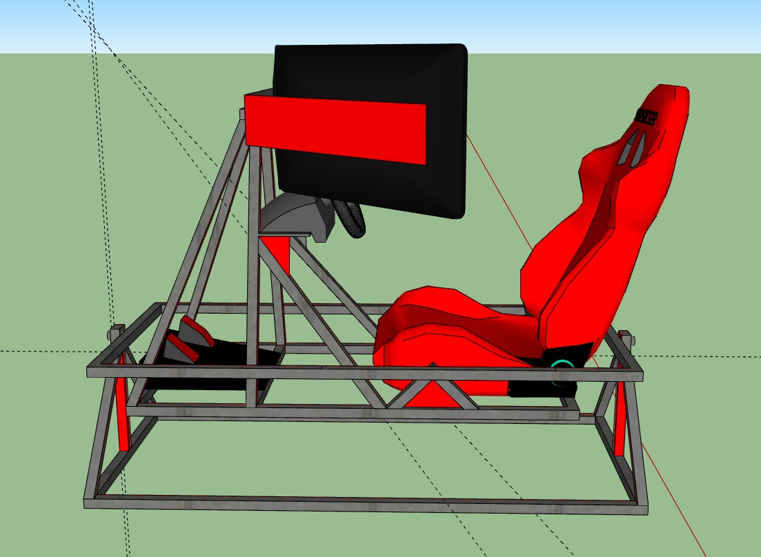

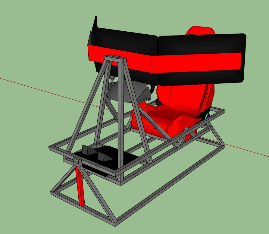

    Thanks for responding. Yes I would like to move the screens and everything. I will build the inner cockpit and then balance the mounting points perfectly to my weight left right and foward to backwards. Here are some pics of what I designed in Google Sketchup.
    So what do you guys think? I did not put in actual forward to backward pivot points they are guestimated to go right next to the seat where the triangle comes up from the inner frame but that is just a placeholder position. Also I realize it will be sitting a lot lower in the final design because of the weigth of the screens and framework.
    I am all ears for suggestions on what style controller and motors I should use. So far my head is still swimming, I haven't really got my bearings yet. I am considering just going with wiper motors the biggest I can find from a bus or truck or something. But I would really like suggestions on the more exotic options like the type of motor and controller. Like Winch motors of just big ac motors. If you give some suggestions please link or post pictures of the specifiic motor you or somebody else used.
    Oh and the frame right now is desinged on the basis of 1 inch square tubing as thick as I can find or I might go bigger is someone thinks it will flex with that size tubing. The designe is only 6 feet long at the longest point. I tried to keep it short

    I did state in my post that the mounting points for weight balance are not final and have not even been figured. Thanks for your input. The drawing is just for basic size and dimensions and relationship of the pedals to the seat to the screen. When I build it I will balance it perfectly in the latitud and longitude directions. Do you have any suggestions on what would be the most cost effective controller

    Re: Almost ready to start my project
    I'd suggest something more like this:

    I had the same issue with my old joyrider, until I lowered the centre seat frame. Mine did well despite being slightly off centre. I had a screen and speakers on it. Two smallish wipers still moved it well though. The outside roll frame should not be an issue, Just mount the motor on the outside edge of the frame. Make a longer lever if it does not swing enough for you.

    Wow guys thanks for all the feedback. It's so much easier to get started when people shove you in a direction. I have been browsing through the forums for 2 or 3 years now and have never gotten this far before but i'm committed now thats why I am asking all the questions and trying to get help. All criticism is welcome. Thanks egoexptress I will change my drawing to something along those lines and to bsft thank you as well.
