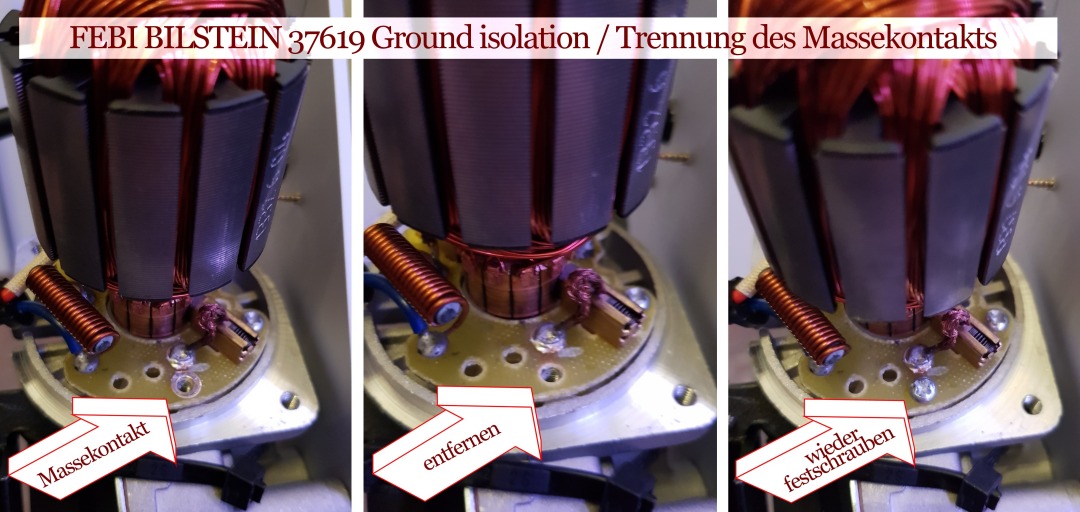

    As guide: pictures of the ground isolation - FEBI Bilstein 37619

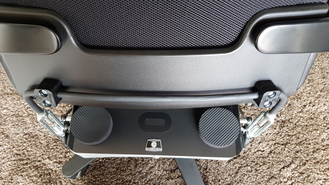

    Oh man you can't tease us like that!!! Everything looks put together and ready to move, what's left to make a video?
    Do you have any protection for runaway motors if the potentiometers fault? I'm guessing if that happens the motors will just stall against the mountings that hold the pots.
    Love all the small attention to detail, looks so good! Are those circles covered in vinyl or are there cooling fans or something there?
    Looking forward to the video!

    Thanks for feedback. :thumbs There is still a lot to do, but at least it works. So here is the first test. Still without finetuning.
    For the motor protection I still have to do something. Definitely a killswitch and a temperature monitoring with shutdown for the motors.
    Whether the Motors are too hot I can not say yet. If necessary, I will install coolingribs. Ventilation cooling without coolingribs is not efficient. We will see ;)
    The metal parts are covered with shrinksleeves ( in German: Schrumpfschlauch ) and do not rattle. How durable is this, I'll see ..
    The movements are not as high/big as with some other simulators, but it should also be a lightweight. To move it around und should not need a whole room :rolleyes:

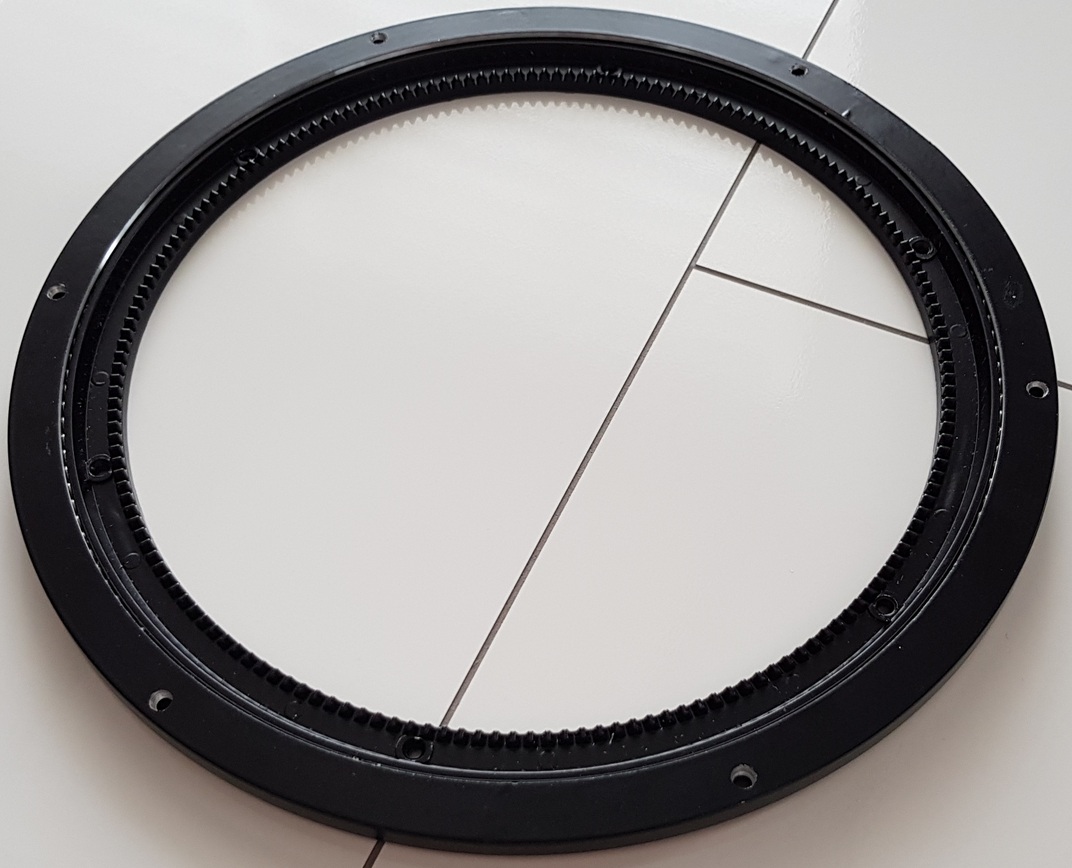

    So next to do is a fastening down to a rotationring, which then makes the turning/rotation-movement over a motor.

    Rotationring - We'll see what's going to happen ;)

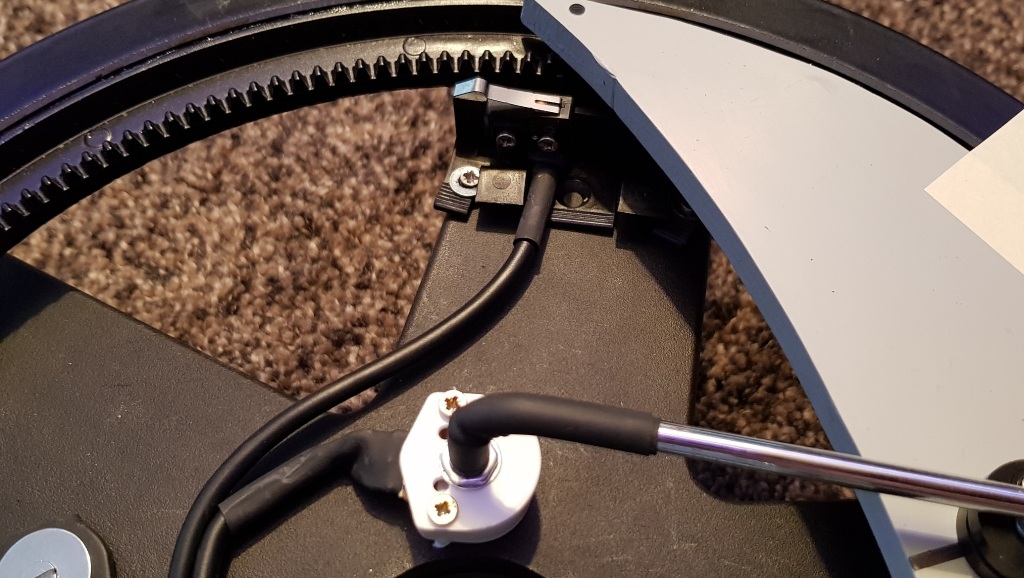

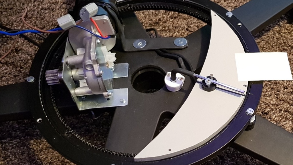

    Doing the rotationring mount and a wipermotor with a Module1.5-gear. A potentiometer and emergency stop. There is still a lot to do.

    next step.
    Now mounted the ring with the chair. Also done a connection-terminal for Power and USB.

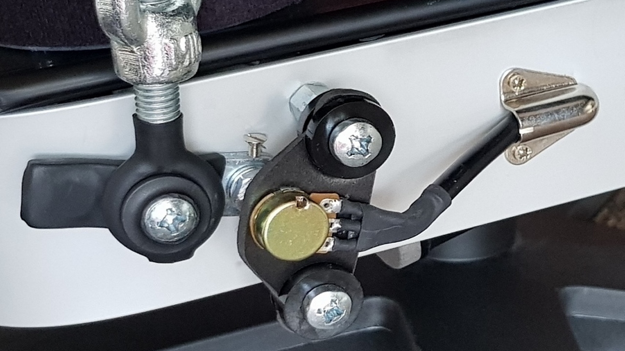

    The stick is mounted and is also stable. Have installed a potentiometer to set the rotary movement not only by software but also manually. Going well so far.
