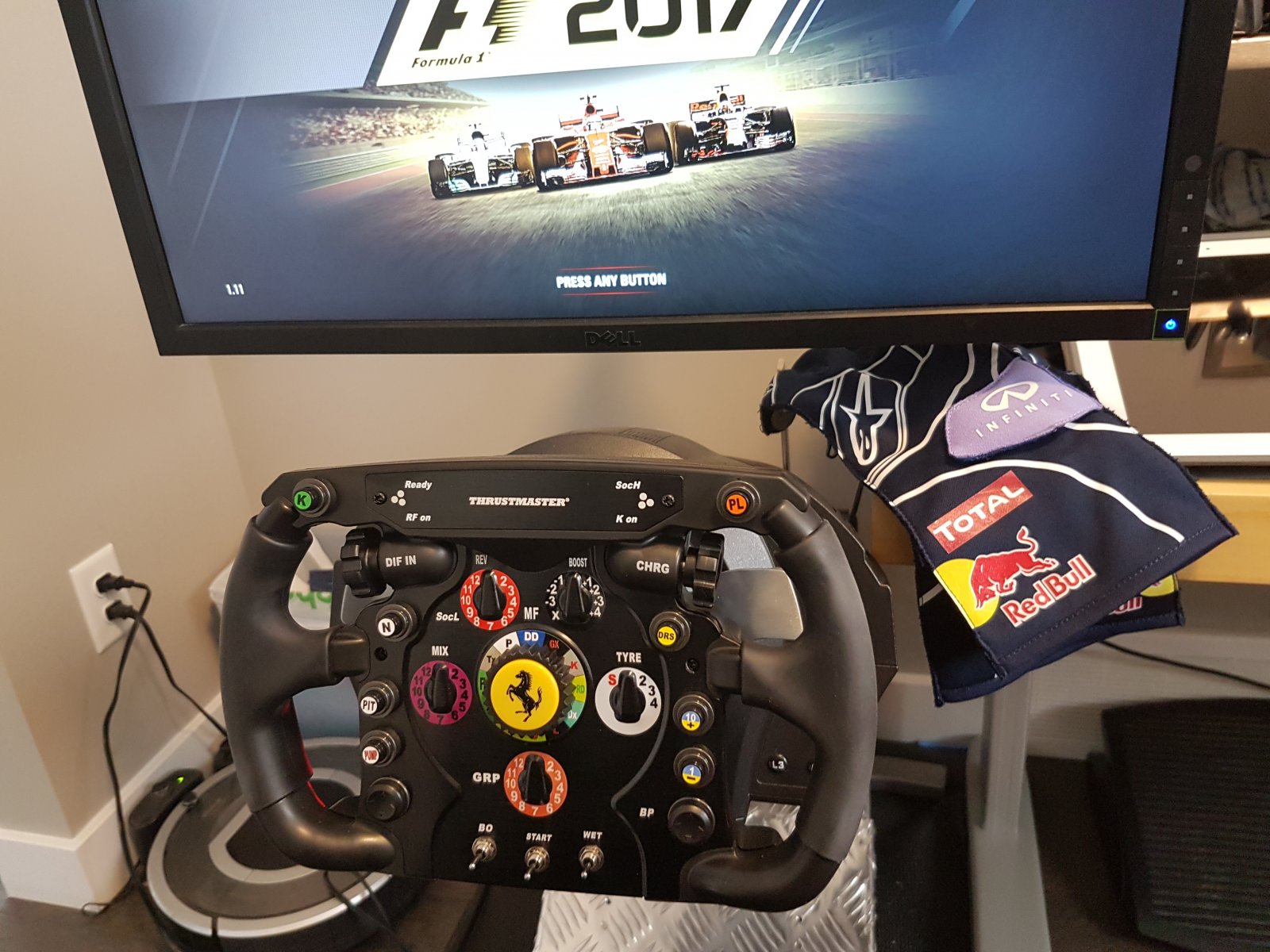

    Just came home from vacation and got my universal joint from Amazon and my power supply from Mouser in the mail.
    Not really part of my build, but I also got my Thrustmaster F1 wheel add-on :)

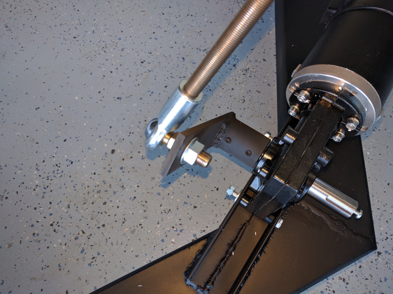

    Been banging my head against the wall trying to decide on the shaft specifications until I stumbled upon this picture uploaded by @CLEOPHUS .
    Since I had ordered the 12mmx6.35 couplers, I thought I had to stick with 12mm shaft diameter. But with a center hole I could screw a bolt/screw with 12mm head and have a beefier/stronger shaft of 20mm.
    So I messaged Kenny Deng and asked for 2omm diameter, 70mm length, keyed, with center whole. Hopefully it's not too late.

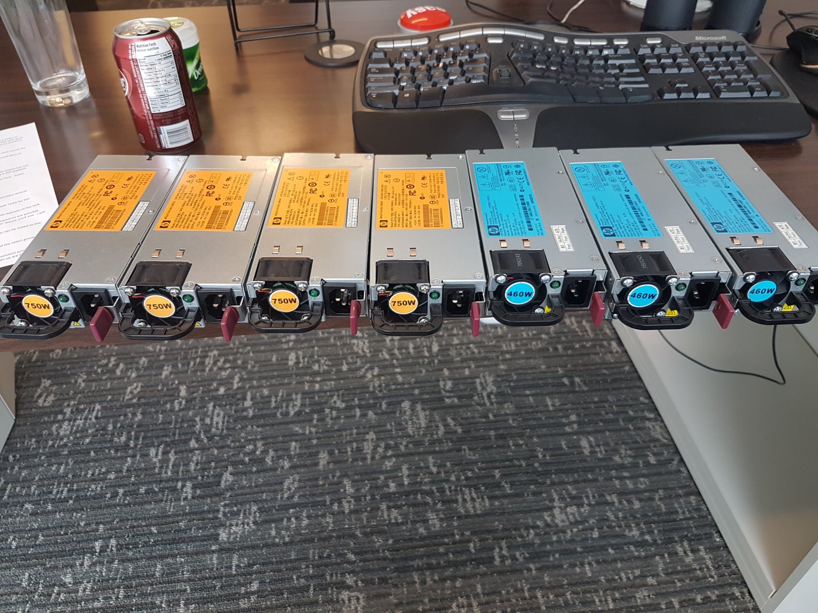

    Reaped the benefits of work decommissioning some old servers. I can run these in series to get 24V for my second rig.
    4x HPS-750RB A 12v 62.5A 750W
    3x HSTNS-PL14 12V 38.3A 460W
