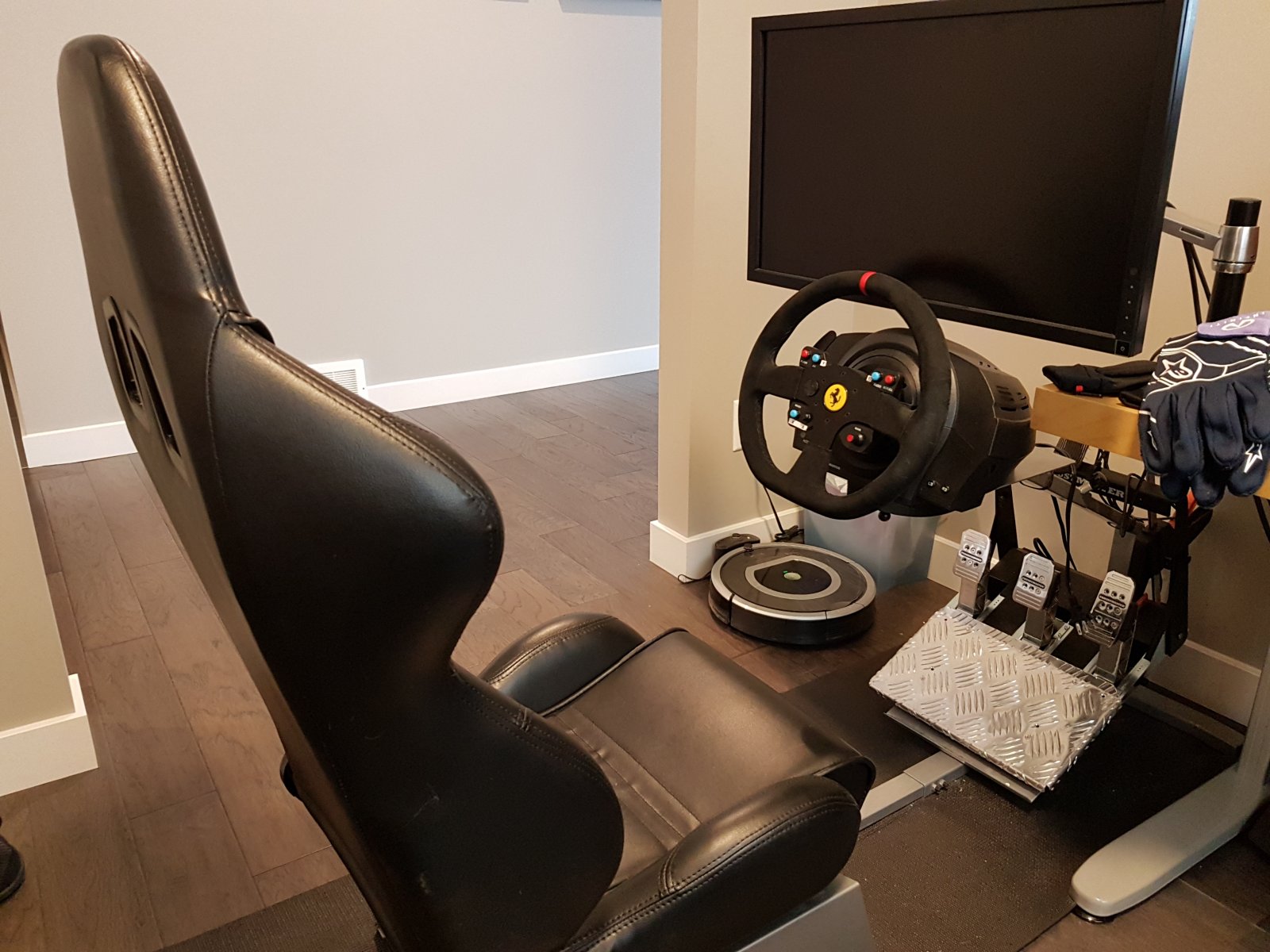

    Hello from Canada,
    First off, I'd like to thank everyone in this community for the wealth of information that has been posted. I have read a lot of threads and FAQs over the past 2 weeks. Without it, I would not have worked up the courage to tackle such a project with no experience. My hope is to make this thread a one stop shop for anyone looking to do this type of project.
    I mainly play F1 2017, Dirt Rally and Assetto Corsa and the goal is to re-purpose current seat for motion simulation and eventually VR later this year.

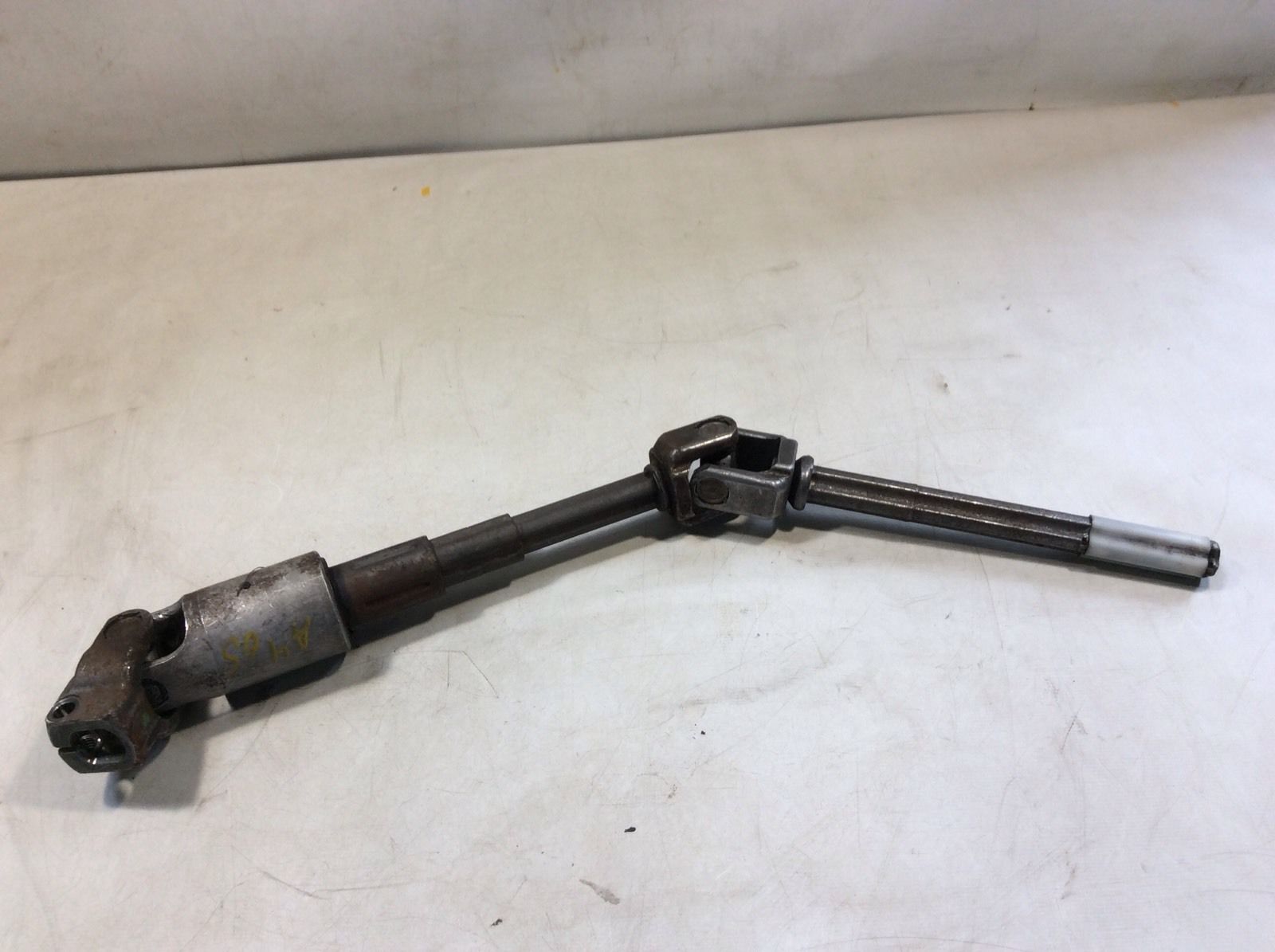

    U-Joint off eBay:
    The last thing to buy are the power supplies and steel tubing for the frame, but lots of time as some of the items I've ordered won't be in for 2 months.
