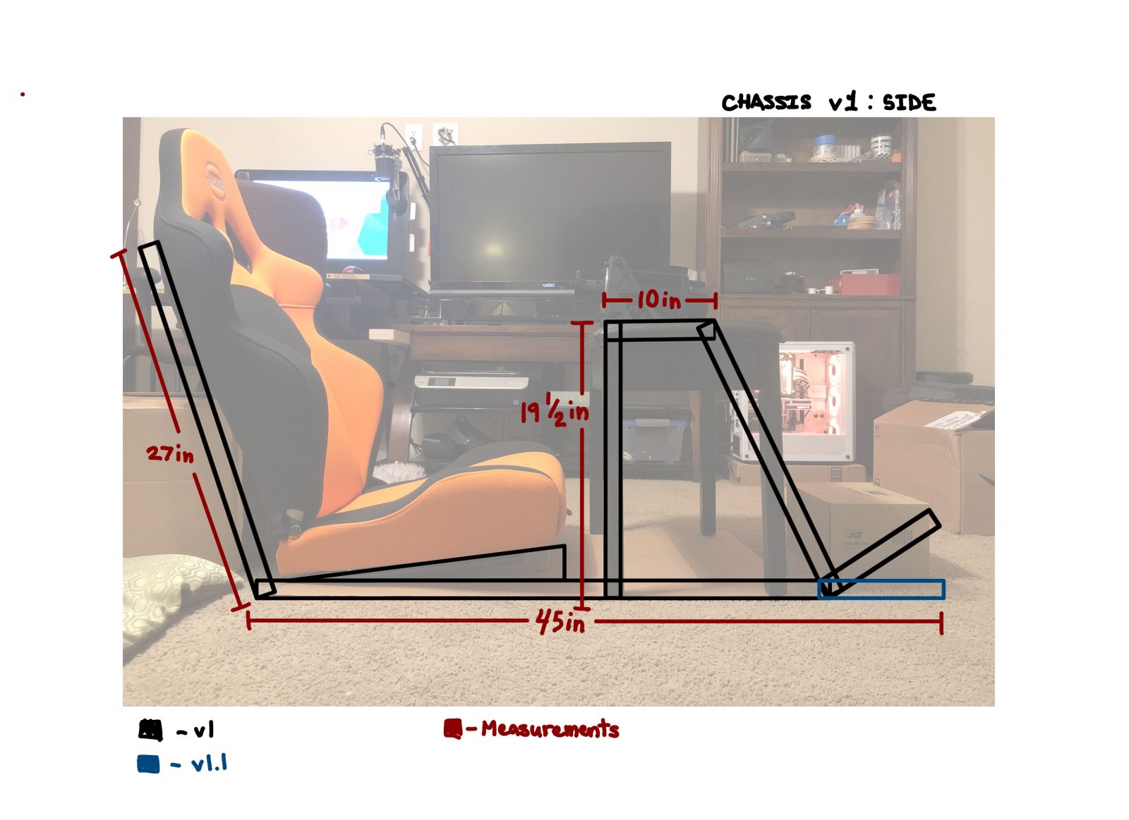

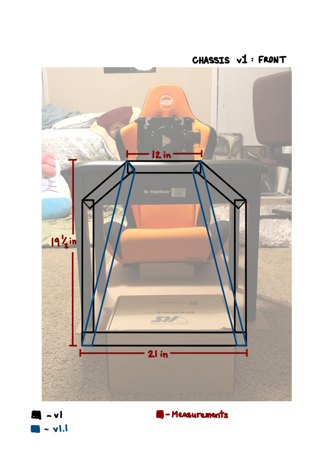

    Today I have been blessed by the "delivery gods". Just received my Sprints and Arduino Uno's in the mail today, despite me ordering them 2-5 days ago! Now I can gather the general measurements for my cockpit. Here are the mockups I did and my thought process behind them.
    Current Progress: Designing Cockpit
    Goal: Finding the "perfect" design
    My 2DOF+Traction Loss motion platform is heavily inspired by Halloween2go, you can also follow him by his YouTube channel, D Max. If you're following my design and decide that my progress is too slow, then you can go to his thread as he has already finished his rig. I find his build to be very easy to follow and "beginner friendly" enough to emulate which will explain the similarities between the two.
    The goal of my cockpit is to be sturdy, but lightweight. With the VRS and Sprint pedals being significantly heavier than I expected, I would need to reduce weight in other areas by simplifying the design to the bare essentials. I also want my cockpit to be slightly adjustable. I don't want to build an amazing rig just so I can race on my lonely throne. I want everyone to experience the world of motion. Luckily, everyone I know mostly fits within my body type and body mass so no need to put much thought into that. But, some adjustability will need to be incorporated so every one can be comfortable in the rig. With those two goals in mind, I managed to jerry rig a cockpit with boxes and furniture that conveniently fit into my general measurements.
    These are the general measurements so far. With this I can figure how much material I would need. The plan is to use 1 1/4in square tubing as I believe it will be sturdy enough to handle the VRS but light enough to keep my motors happy. I went with a mix between the Formula and GT style seating positions with a slight incline to my seat as that is what I find most comfortable. No fancy process, I just sat in my seat and moved things around till everything "felt" right. Also got some members of the family to try out the cockpit as well and they were quite happy with it.
    *Disclaimer: These are the measurements that work for me. My height is 5'4 so I'm able to get away with a smaller chassis and less material. It is designed this way to suit me and my racing equipment. If you're gonna follow this design, make sure to adjust the measurements to fit your needs. I know this is a "no-brainer" but I still feel like this should still be said.
    I will be buying the materials sometime next week. These are not the final measurements but a general guide to show me how much material I need to get. Final measurements will be documented when the chassis is complete. I will also order a mig welder and wait for its arrival as well. In the mean time, I will be thoroughly learning how to properly weld. Never welded anything before in my life but I am excited to give it a shot. Also, since my Arduino Uno's arrived 2 weeks early, I will be gathering the materials and equipment to get started on the electronics. Next week is going to be a busy week. Wish me luck.
