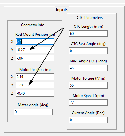

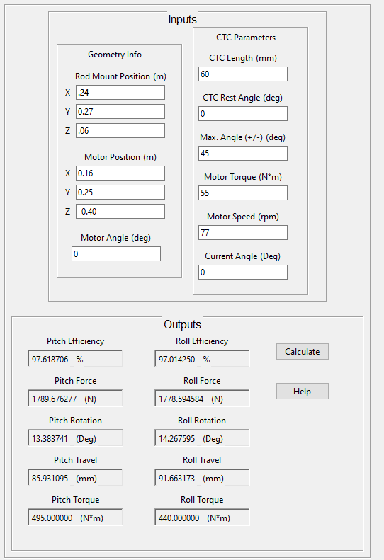

    I think your second option is a bit low for pitch torque and that the first is a better option and balance between pitch and roll torque:
  2. Ian Pace
    Ian Pace Member
    Dec 17, 2017
    72
    Gharghur - Malta
    39Coins
    +28 / 0 / -0
    in the coming week i will re weigh all rig with peripherals and myself again to confirm the exact weight as i am sure it is less than the quoted 160kg, but i feel more comfortable overshooting as i dont know what i might add to the rig in the future.
    Im gonna go with the assumption that with the above values,. i should be good with approx 160kg.... at worst i will have to change the CTC i guess.
  3. Michael_miass
    Michael_miass West
    Nov 16, 2019
    145
    Russia, Miass
    725Coins
    +175 / 0 / -0
    Why do you have meanings with different signs? The rod and motor, judging by the photo, are on the same side
  4. Ian Pace
    Ian Pace Member
    Dec 17, 2017
    72
    Gharghur - Malta
    39Coins
    +28 / 0 / -0
    Hi Michael,
    Yes i noticed that last night and in fact changed it. It gave me more degrees so i guess its a good thing as the torque figures remained the same :)
    Thanks for pointing it out!

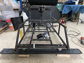

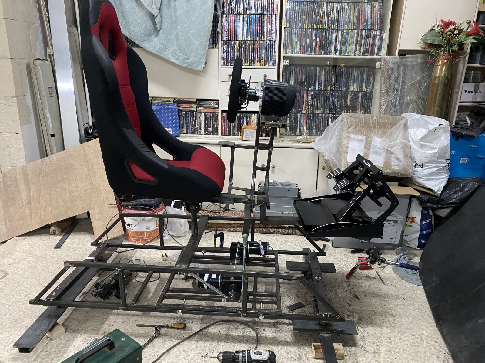

  5. Ian Pace
    Ian Pace Member
    Dec 17, 2017
    72
    Gharghur - Malta
    39Coins
    +28 / 0 / -0

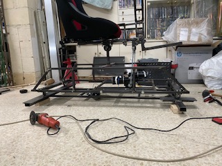

    Traction loss structure in place :)

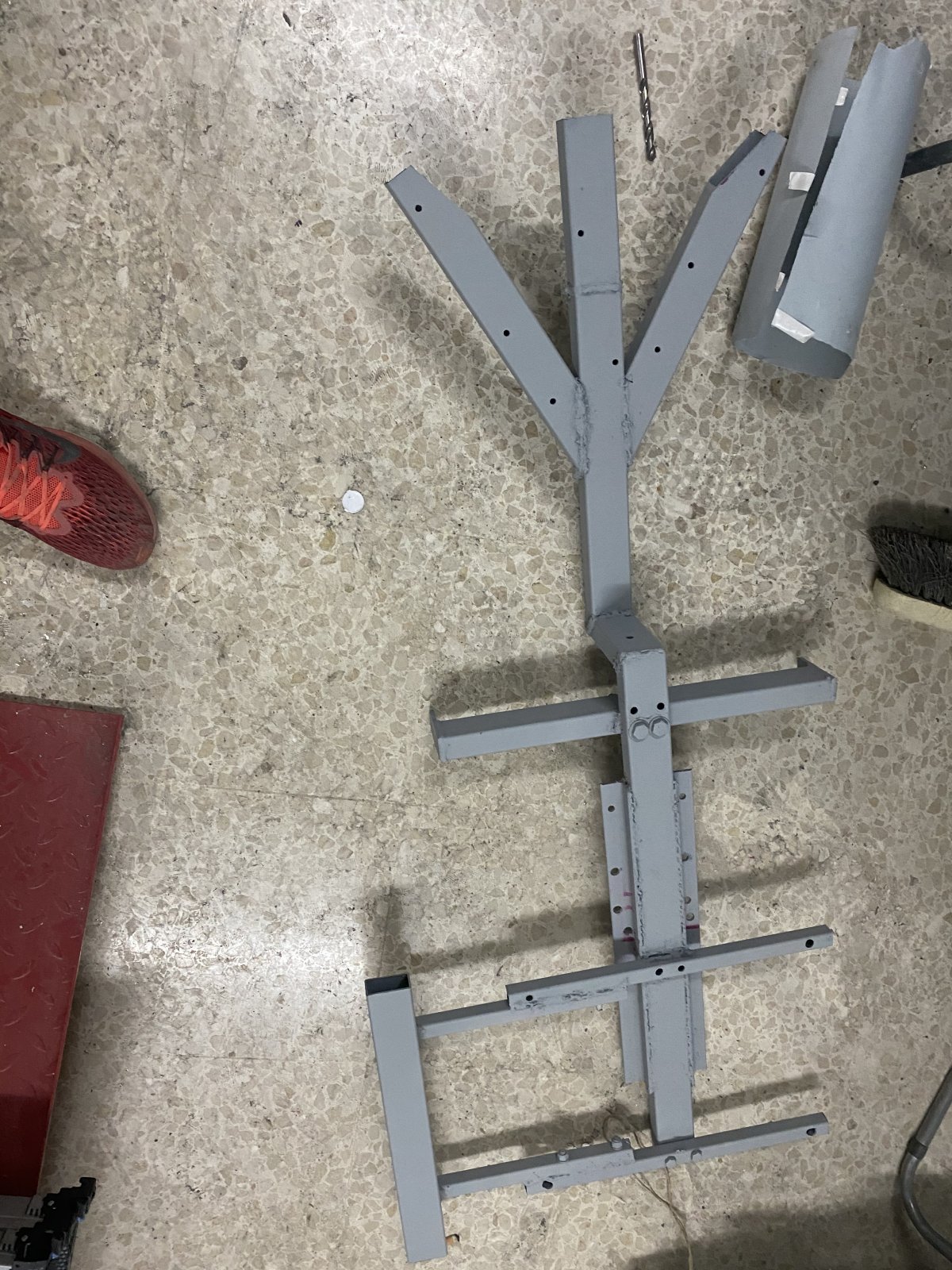

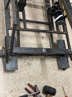

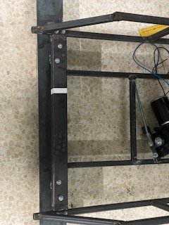

  7. Ian Pace
    Ian Pace Member
    Dec 17, 2017
    72
    Gharghur - Malta
    39Coins
    +28 / 0 / -0

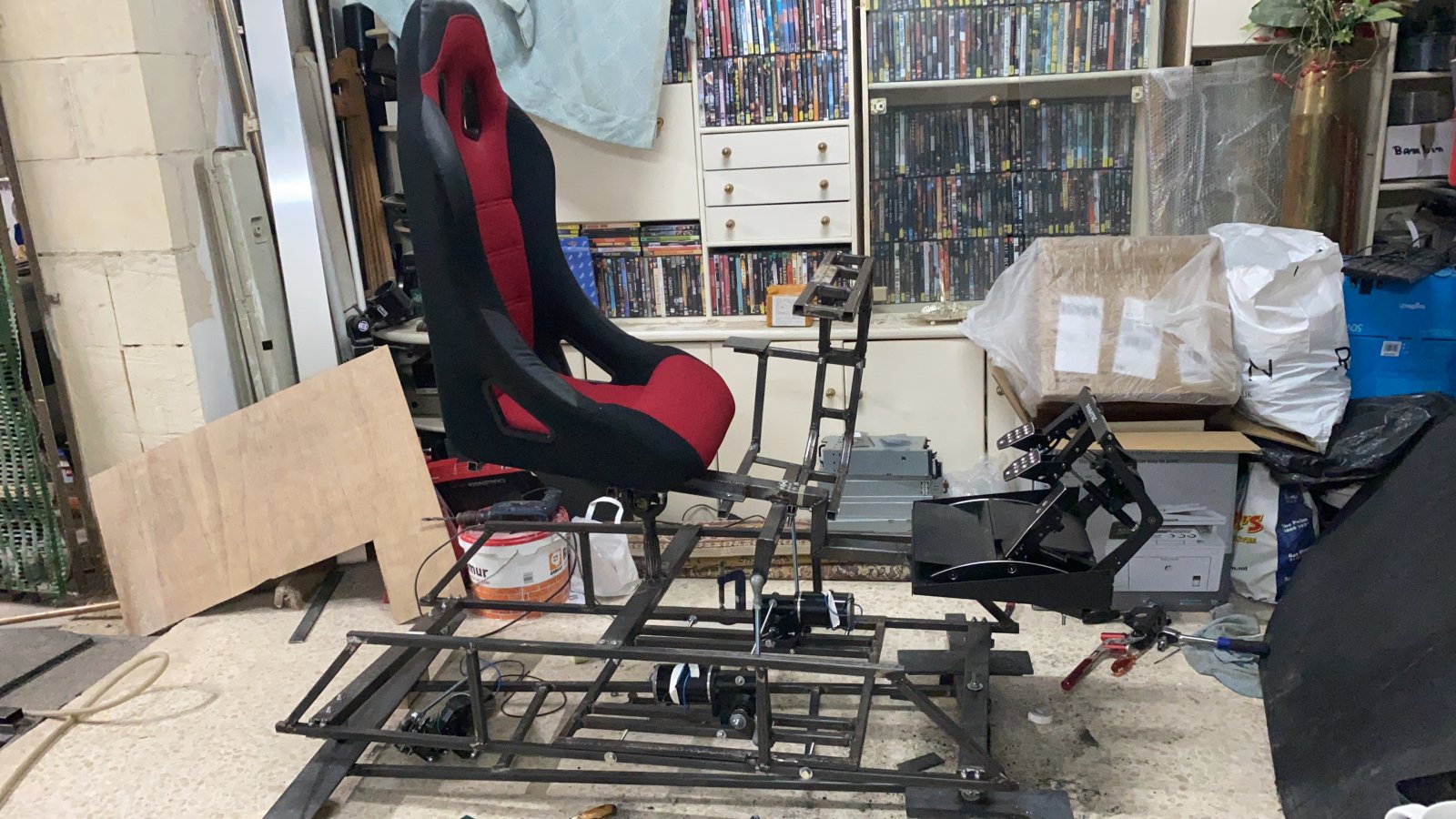

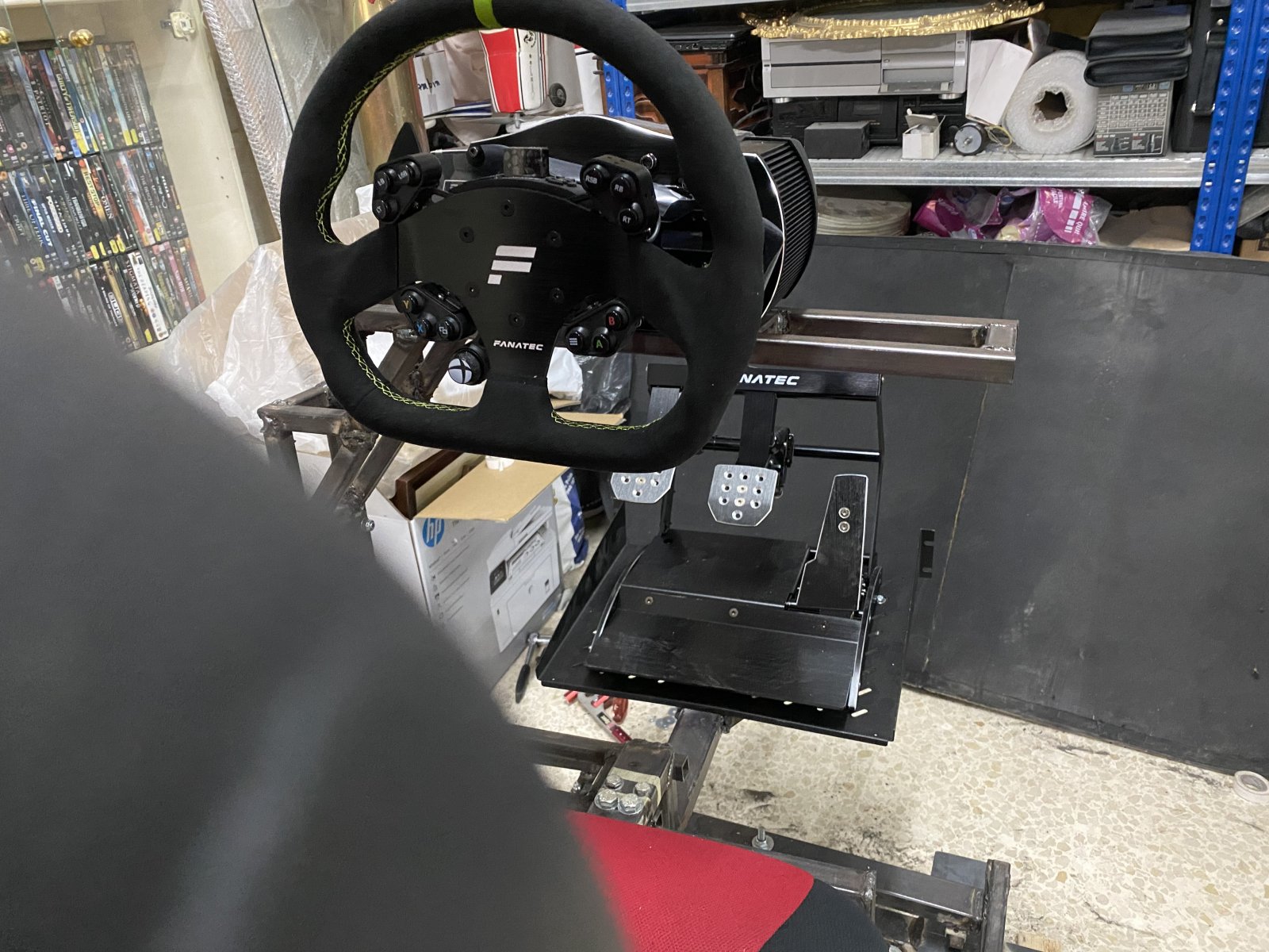

    Increased CTC from 30mm to 50mm, moved motors to still get a 90 degree angle, partially mounted traction loss motor.
    Structure is paractically complete from the metal work, i just need to relocate the gearbox plate as i got the Fanatec gearbox and its very high.
    I will soon start on the monitor stand and then sand and spray everything.
    Hopefully the above should be done by the end of month.... then its ready for wiring.
    The plan is that after i test everything and make sure everything works fine, i will close off the structure with some kind of lightweight panels, but still need to see what would be best to use.... IMG_1699.jpg IMG_1697.jpg

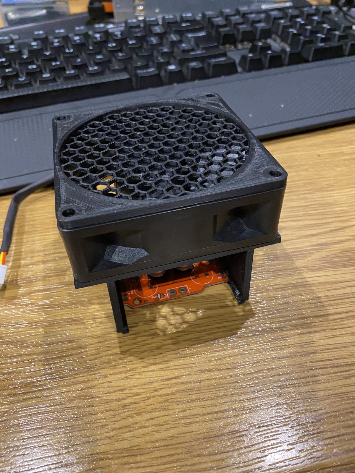

  8. Ian Pace
    Ian Pace Member
    Dec 17, 2017
    72
    Gharghur - Malta
    39Coins
    +28 / 0 / -0

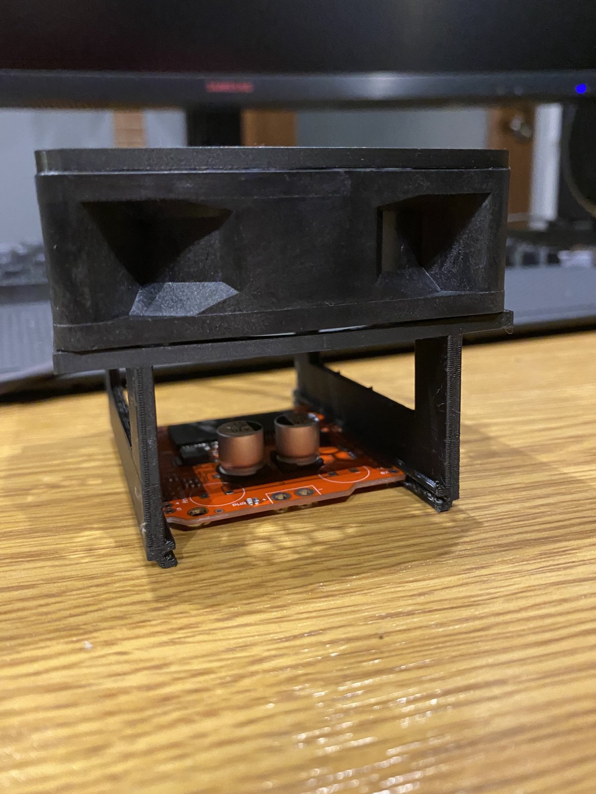

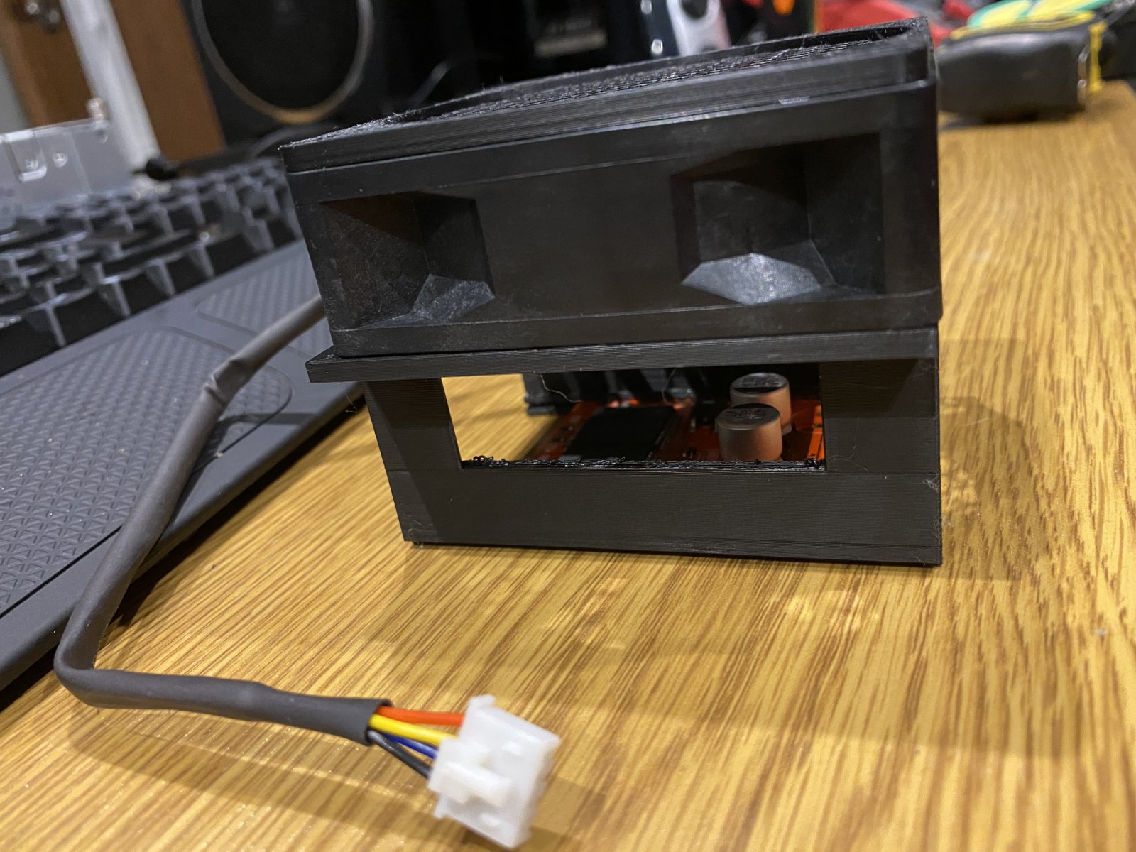

    MM cooling sorted.... just need to attach the heat sink.
    the fan is an 80mm 12v fan. Bit of an overkill :)

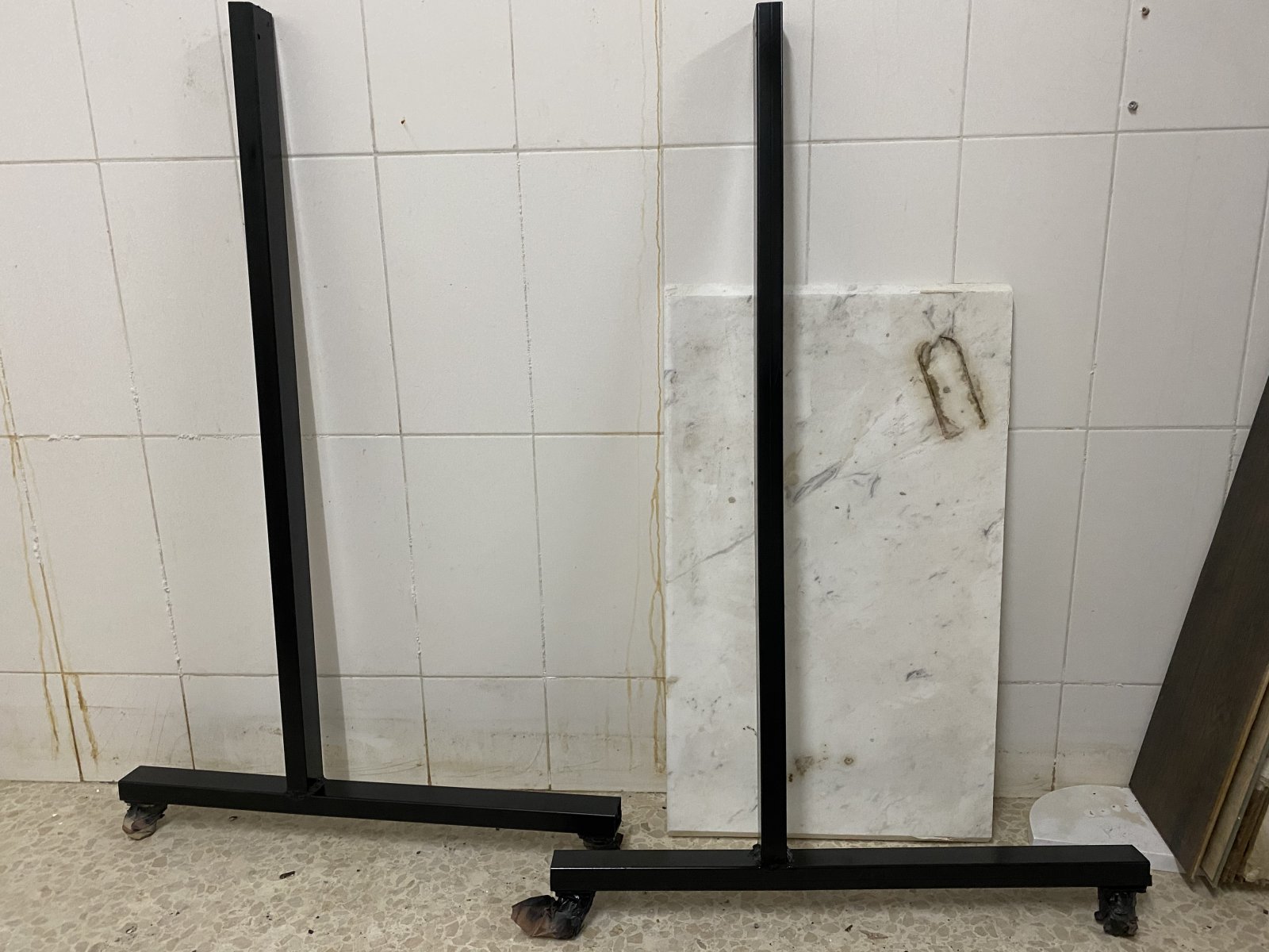

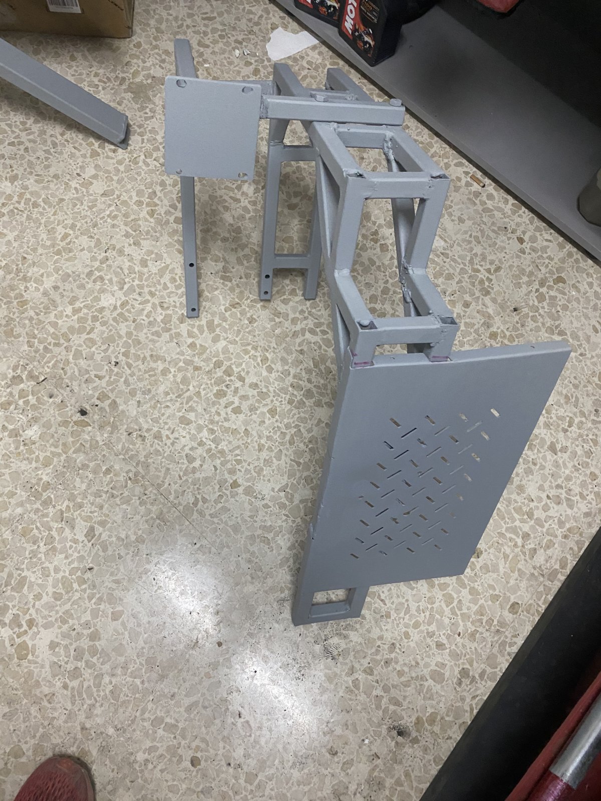

  9. Ian Pace
    Ian Pace Member
    Dec 17, 2017
    72
    Gharghur - Malta
    39Coins
    +28 / 0 / -0

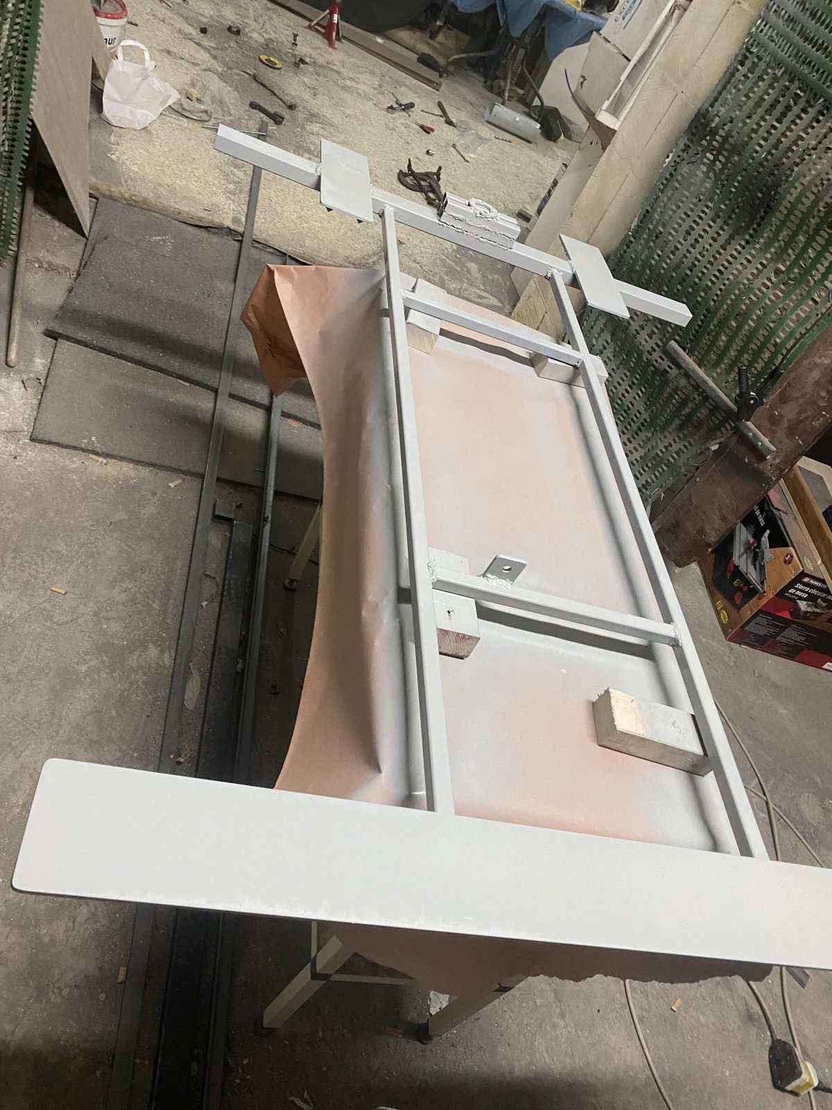

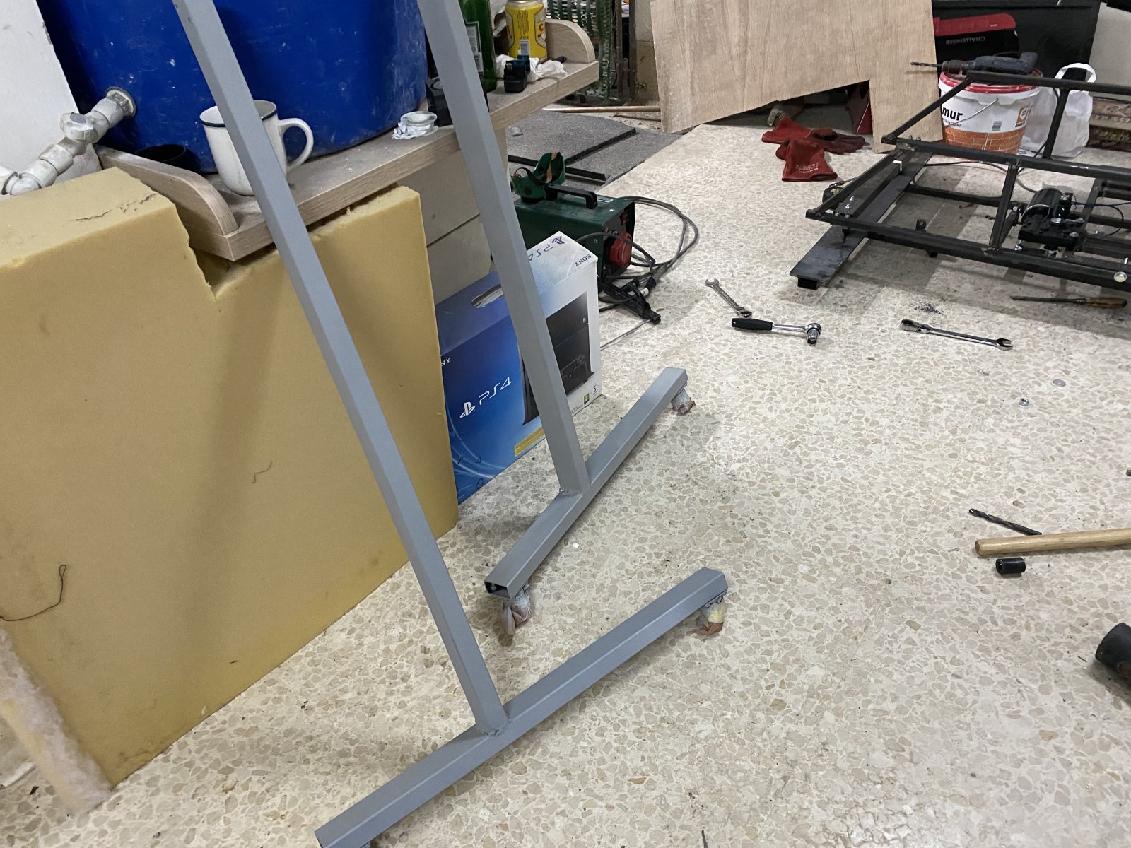

    Monitor stand ready - it’s a triple screen setup.... arms not mounted in that photo
    also staring with the first coat of primer on the stand.
  10. Ian Pace
    Ian Pace Member
    Dec 17, 2017
    72
    Gharghur - Malta
    39Coins
    +28 / 0 / -0
    Monitor stand pained and complete :)

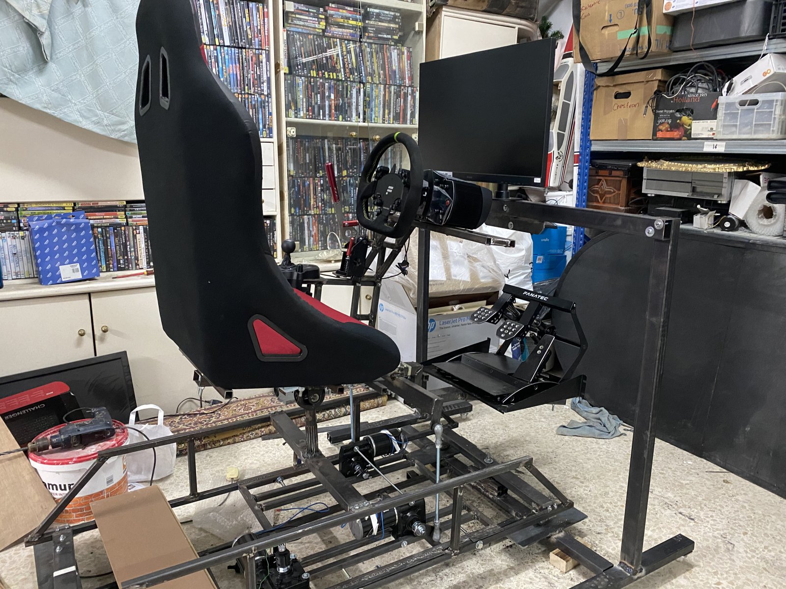

  11. Ian Pace
    Ian Pace Member
    Dec 17, 2017
    72
    Gharghur - Malta
    39Coins
    +28 / 0 / -0

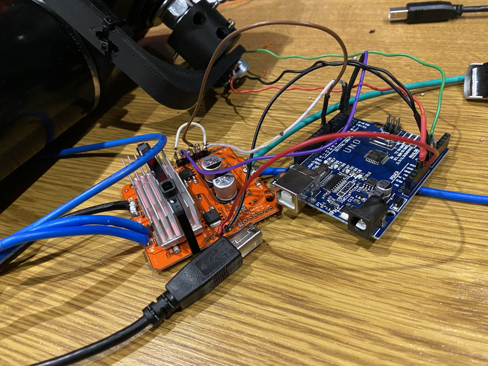

    Bench testing electronics and hopefully will get to install them over the weekend, once i spray the rig and take it upstairs.

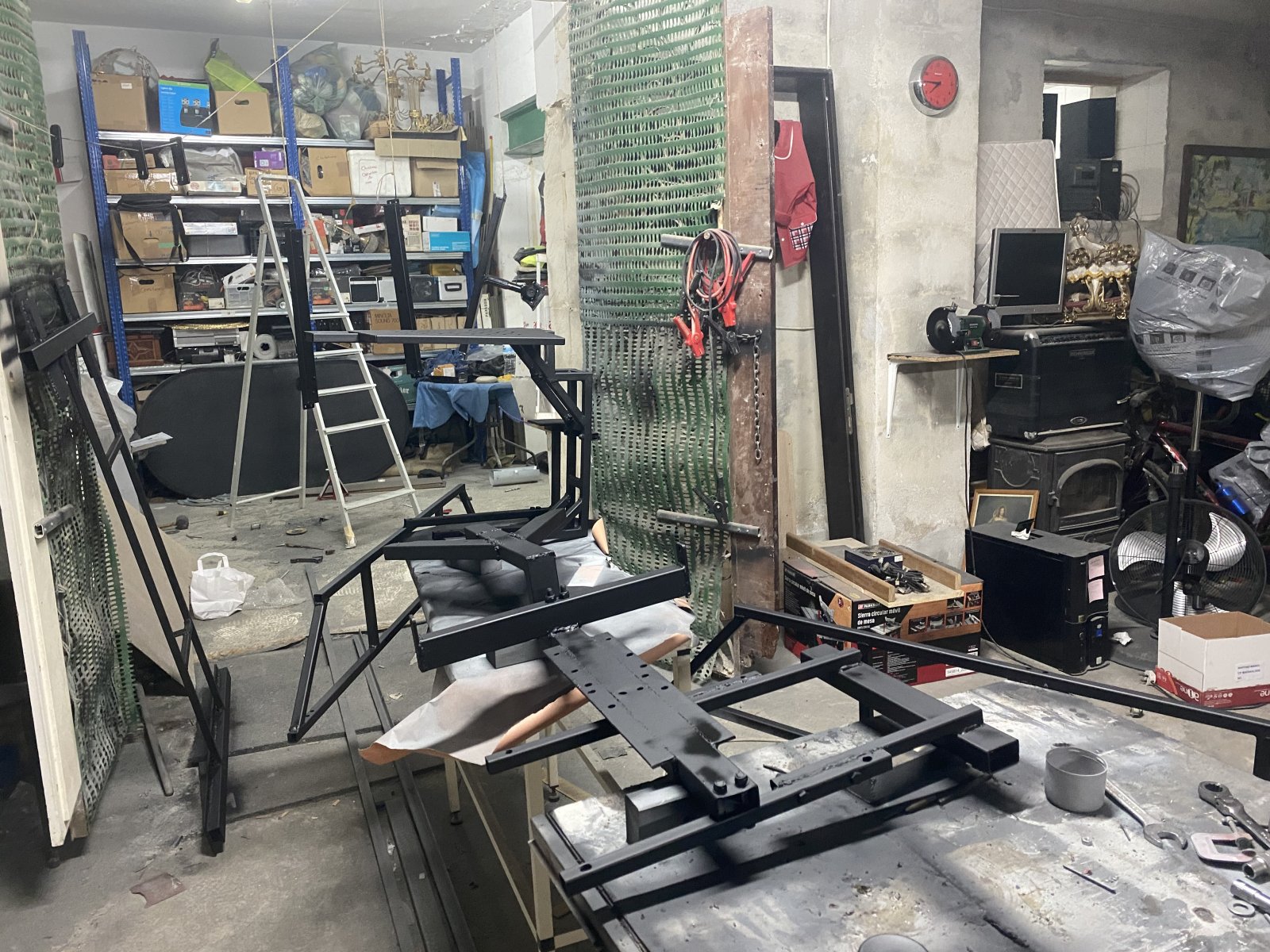

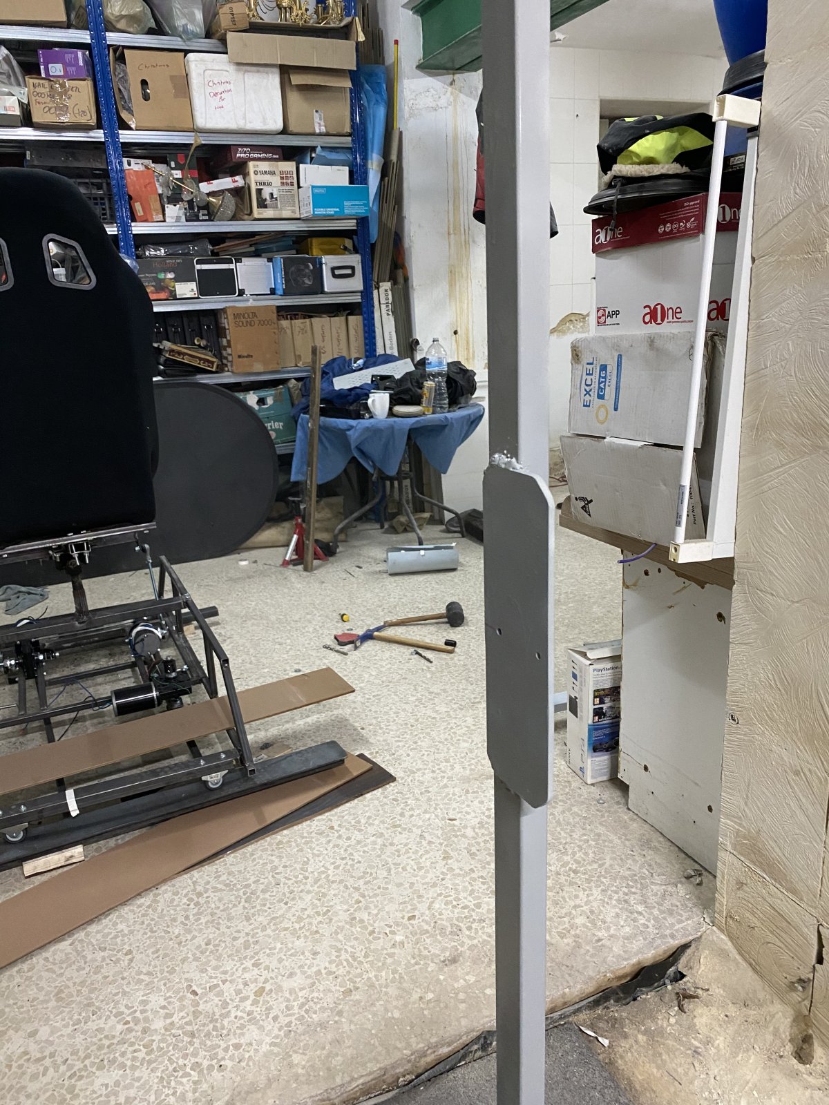

  17. Ian Pace
    Ian Pace Member
    Dec 17, 2017
    72
    Gharghur - Malta
    39Coins
    +28 / 0 / -0
    Today was a loooooonnnggg and productive day 8am-11:45pm! To say I’m knackered would be putting it lightly! But I am glad to say that it’s done and finally at home. Over the weekend I’ll put it back up together as I had to dismantle it to spray paint it and then start with the electronics.
