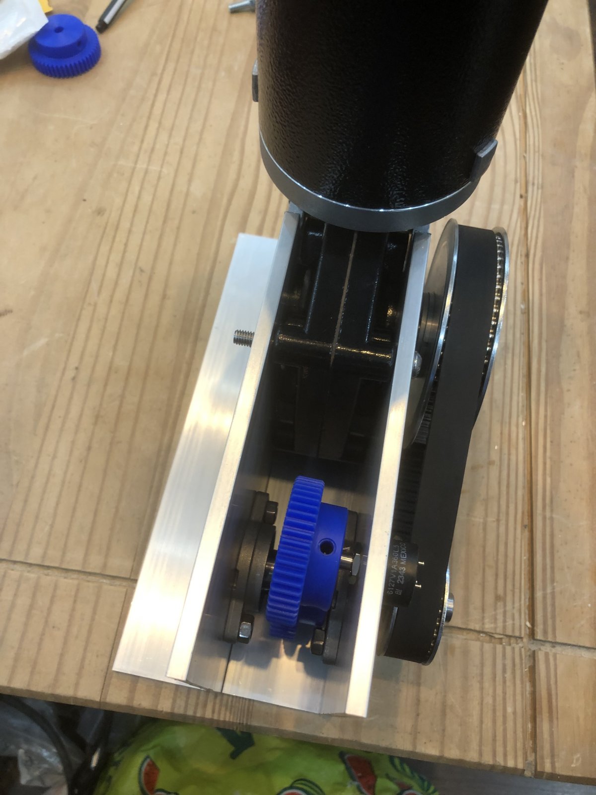

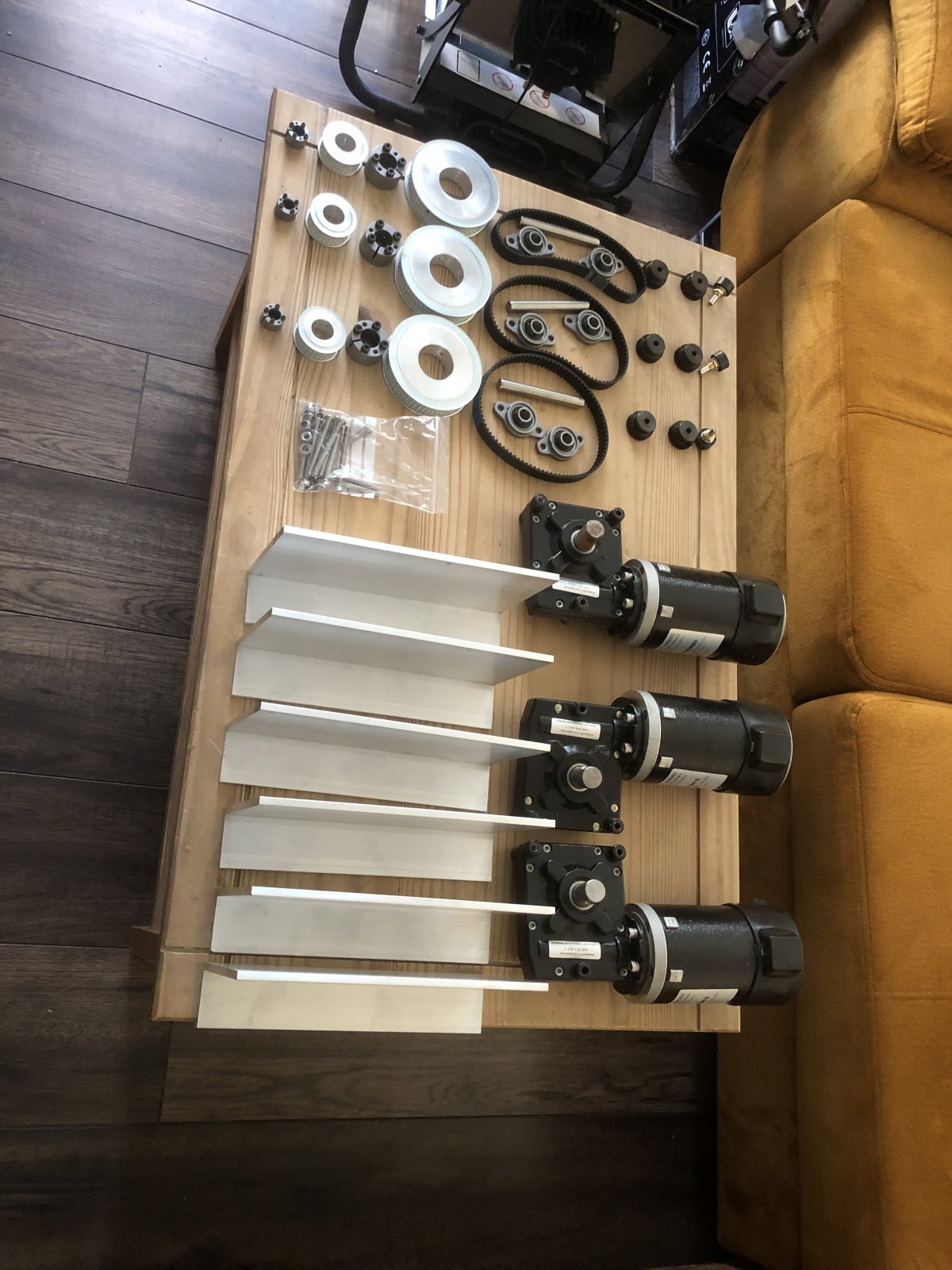

    This is my old plan redesign. The parts have arrived, the assembly will begin

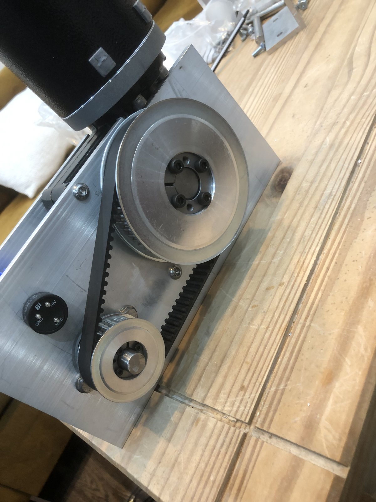

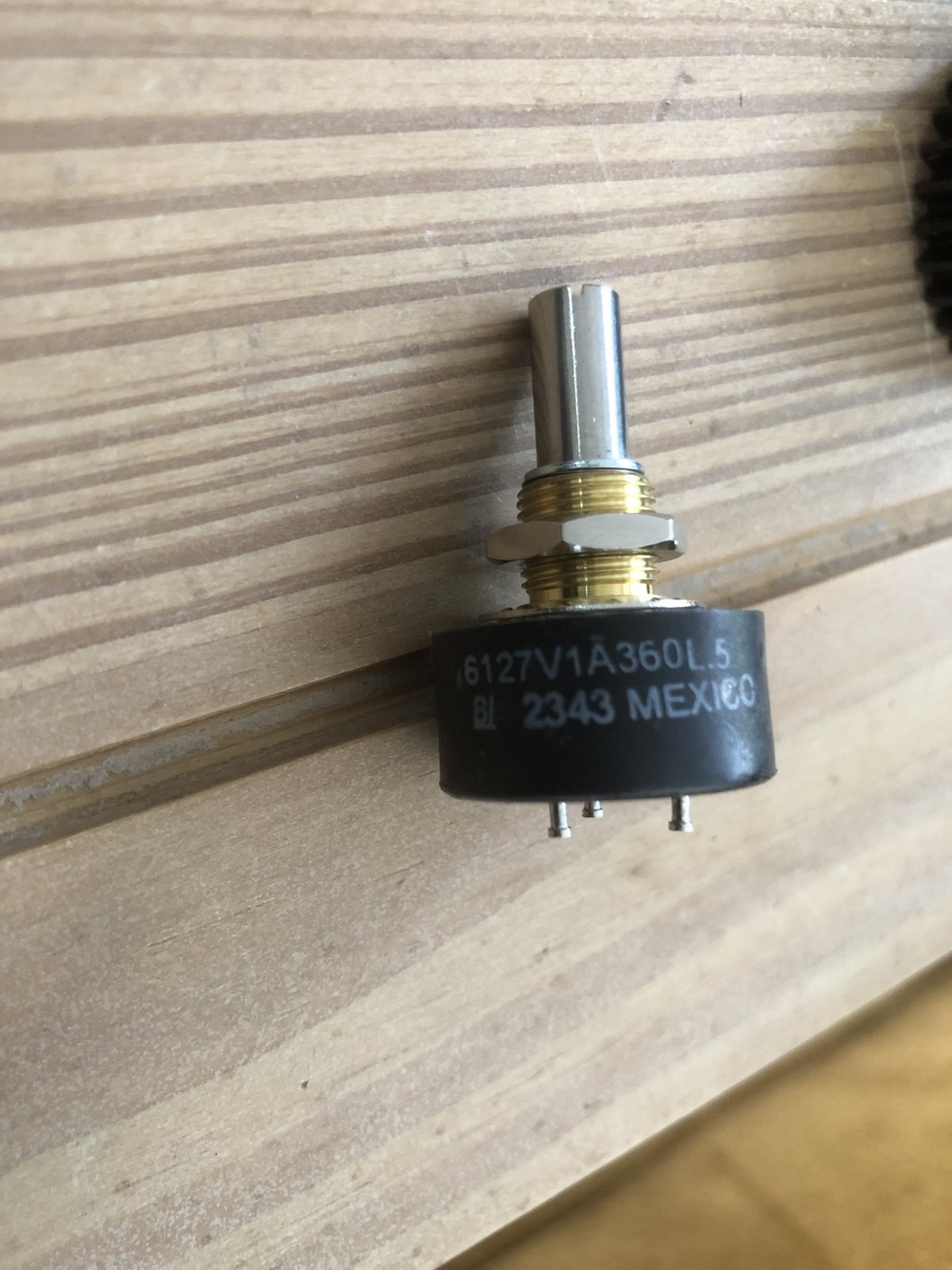

    The first motor with the sensor is finished

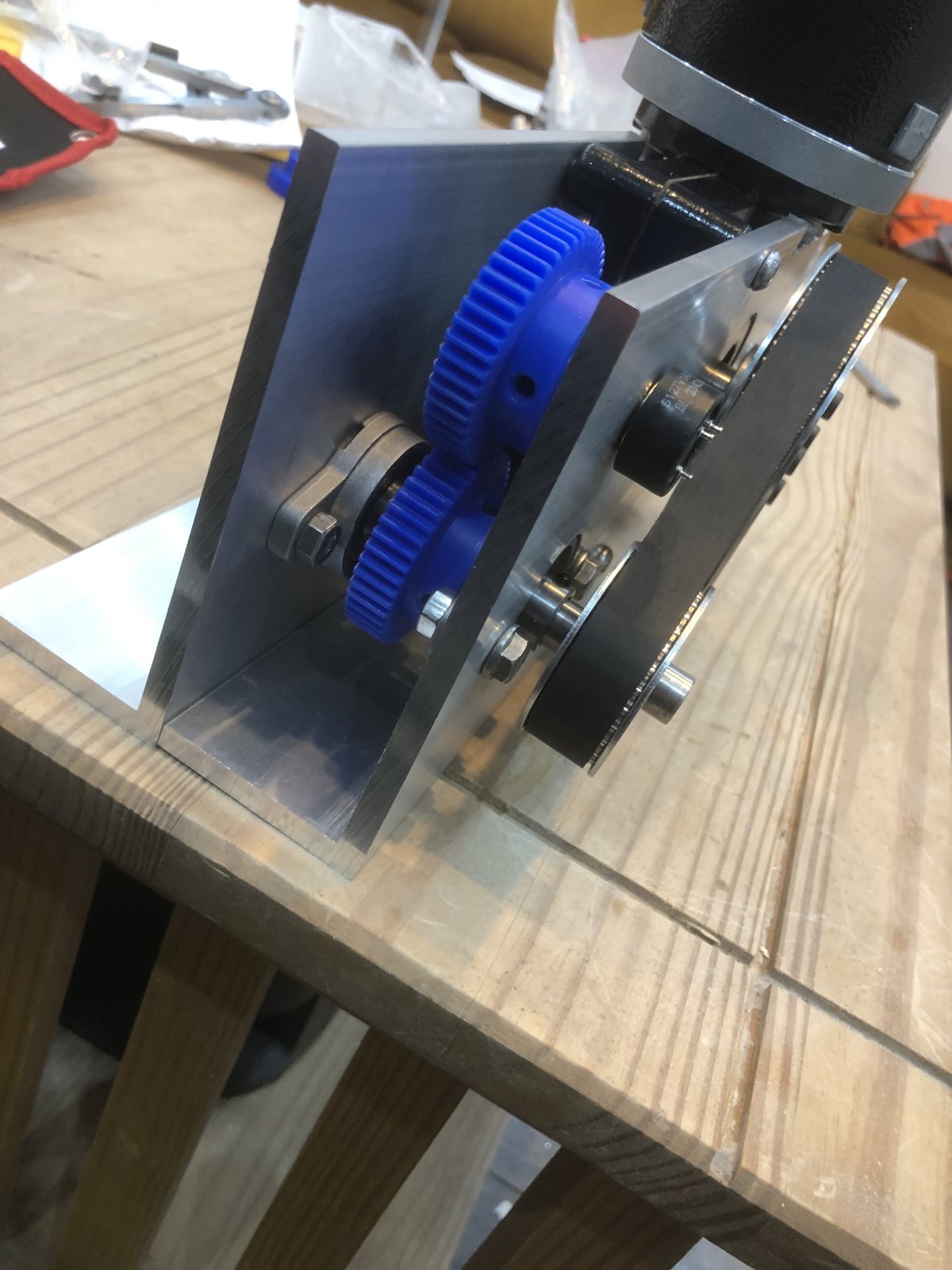

    The large timing belt will be connected to the rod end will move 70mm at 180 degrees, it can rotate in the event of a malfunction

    Mine is Seat Mover motion style, if the 70mm movement is not enough, I can make it bigger with an aluminum round plate
