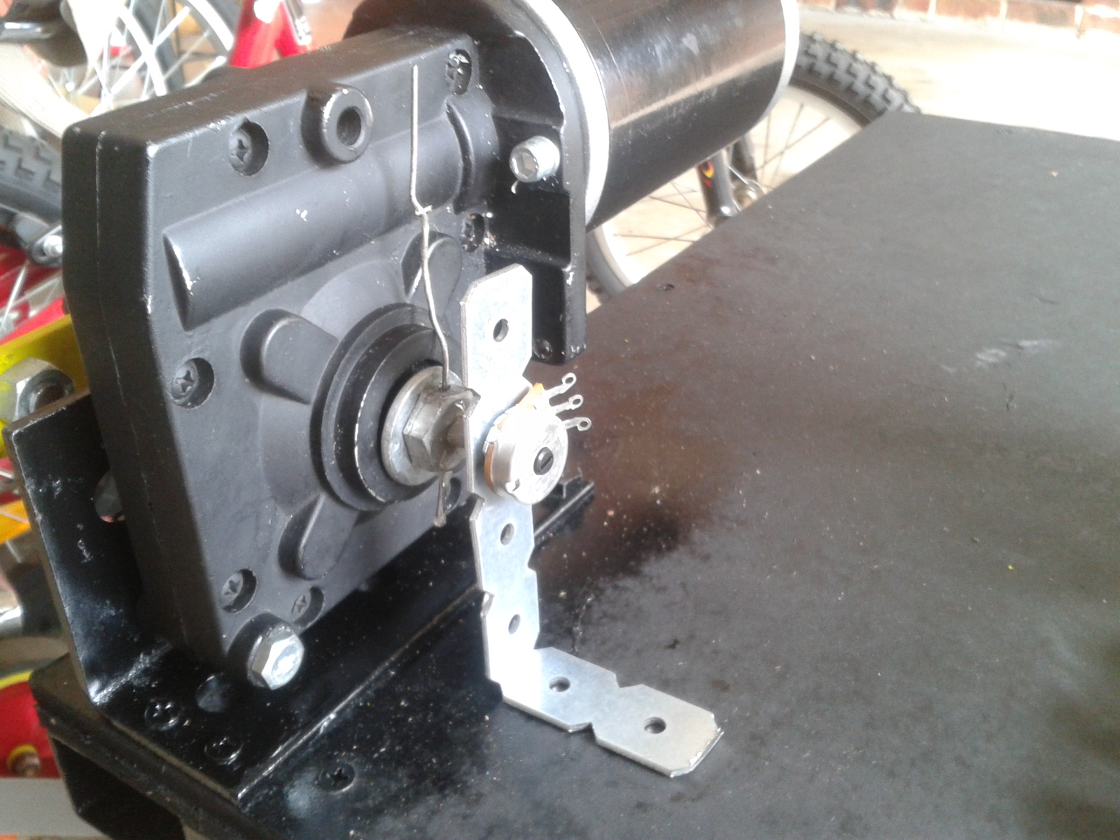

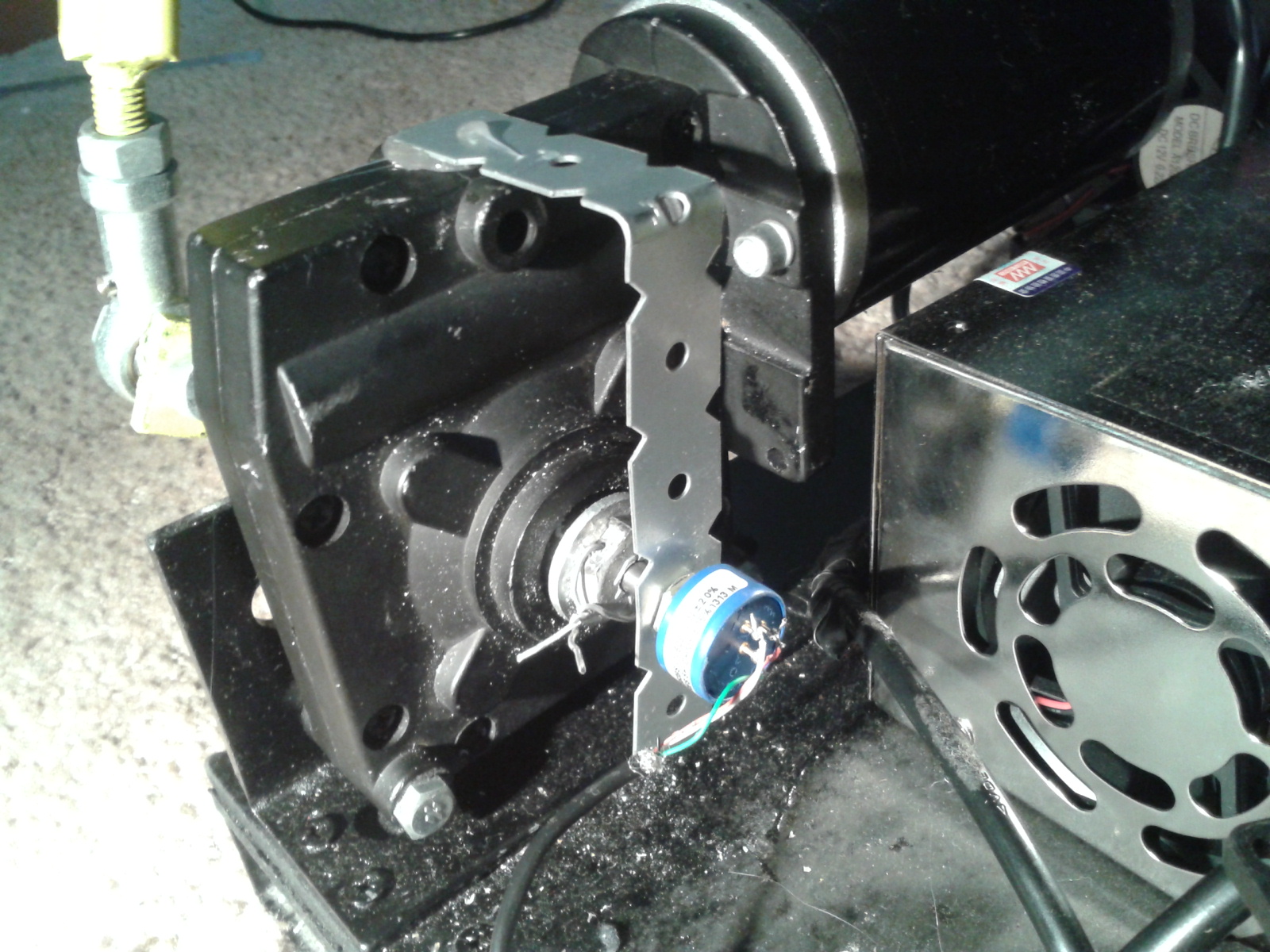

    hrmm well this sucks...., went for a few laps tonight and had a few funny feeling's from the right side and decided to stop and look, well the lever was beyond my MAX setting's somehow and now the Hall effect is Locked and no longer function's, What would cause this ? Almost thinking my old "flexy" pot mounts were hiding an issue.
  12. Nick Moxley
    17,057Coins
    +2,506 / 30 / -2
    Ok so i Took the little C clip off and managed to wiggle the pot free, Its not Silky smooth as it was new but its back up and running when testing in the JRK utility, Upon further inspection it appears on of my motor's has a LOT of side lash in the main gear to the box. I might look into finding a proper size shim and taking that play away as this was technically pulling/pushing on the pot each time it changed direction. Im also going to contact the seller of the motor to see what he has to say, Maybe get a replacement.
    Have any of you guys experienced the gear lash ? if so how does it affect your pots ?

    What does it mean your Hall effect pot is Locked and no longer functions? Mechanicaly locked, can't move?
    EDIT: Nevermind, I see what you mean from next post.
    You should try to mount the pot directly on the motor if it's possible, then when the motor moves/play the pot will move with it, it will not damage the pot like in your case if it's mounted independently.
  14. SeatTime
    2,572
    One of the good things about the Hall Effect pots is that they have no end stop, so they are pretty hard to destroy if things go astray. Cannot see how gear lash would hurt the pots (makes for poor response of the sim though), or are you saying that the bearings for the gear box drive shaft are shot?- from the photos it looks like the pot is direct drive and mounted to the the motor mount.

    What happens when the pot is not mounted on the motor and mounted on the base, is that on hard and fast direction changes can cause the motor to flex from its mounts and this will place bad strain on the pot shaft and its bush, causing the pot to lock up. I know of one other who's pot locked up from bad placement, funny thing was cheap pot worked fine in the same location once mounted to the gearbox he hasn't had an issue. I would be hitting the supplier for warranty of pot worth a go.
  16. bsft
    yep, depends on mounting bracket for pots as I found out
    Like this the pot shaft was getting pulled and pushed and broke a pot in no time, good thing they were $3 jobs
    Now I mounted them like this and the pot bracket moves with the flex of teh motor, no more broken pots. And as they are 360 deg turn, they cannot break from overshoot at all.
  17. SeatTime
    2,572
    My motor mounts are welded to the steel frame, basically zero flex. His looks like they are mounted to the same steel mount as the motor (see attached image below), so flex between them should be also zero. I think the flex/movement he is talking about is to do with the actual gear box drive shaft.

    YES the gear box itself, There's ZERO flex in my mount to the motor. And its only one motor that has the lateral play. I asked Pgsaw if there's anything that can be done, Im 1/2 tempted to pull the box and try and shim it first. Workin on it as i type.
    Ill also send element a email and see if there willing to help out.
    Pgsaw just replied, Ill be opening the box and inspecting and taking pics for him....Ill let you guys know.
  19. Nick Moxley
    17,057Coins
    +2,506 / 30 / -2
    Gear box appears to be up to spec, but the main gear still has an abnormal amount of play between the gear box and the main gear bearings. Pics and explanation send to pgsaw, so lets see what he has to say about it. Strange as the other motor has just a Slight Slight tick of play, So I'm assuming something's genuinely up with the right side gearbox.
    Re motor Flex, the 4x4 Angle Iron i used is RIDICULOUSLY heavy duty. the Motor's will RIP the 7 - 3 1/2" Screws from the 2x4 base before the angle ever deflects or tweeks to the motors.
  20. Nick Moxley
    17,057Coins
    +2,506 / 30 / -2
    Ok so i shimmed the gear box and eliminated 99% of the play and still spun super freely, So i guess problem solved for now ? Ill remount the pot and give it a whirl.
