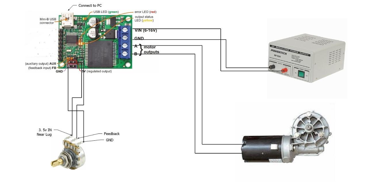

    Yep agree I would use the lathe to bore a hole in for the pot attachment and I use 1.6 ali to hold my pots to the motor, it flexes if it needs too.
    On connection pots dont short the 5V and GND together , you will not like the result.
    Using the same pot (hall effect) as picture above (same as Daves and mine) connect 5v from jrk to +5v on pot and GND on Jrk to GND on pot and the FB on the Jrk to the Vout on the pot. In total the pot has 3 wire going from it to the jrk with none shorting together. Leave all the other pins on the Jrks disconnected.
    In total you should only have 7 wires connected to each Jrk.
    And yes the connecting of the fan is correct , just run it off the powersupply most only draw 50mAmps which is nothing to worry about and yes the leds in the fan normally are internally connected to the 12v lines in the fan body, as they have advised above.

    for the OCD , ADHD in us, heres a clearer pic of jrk wire up

    when i said short the 2 wires, I dont mean 5v to Ground, I mean there's 2 wires on a JST connector. 2 pins on the 5v and ground.......following ? lol
    so Dont use both pins on the 5v and ground on the JRK ? Just one pin ?

    Sorry my misunderstanding, read short and went ahh no!!! , lol.
    That is correct should only have 3 wires connected to 3 pins only.
    Any way just use the three pins labeled FB, +5v, GND for attaching the pot to.

    No problem Robbie im sure with the PS pin shorting question's and what not it was a bit confusing. :blush
    Talked to Pololu today and the tech was Very pleasant to deal with and explained what i needed to know in detail. No problem with using Both Ground and 5v pins together......like this

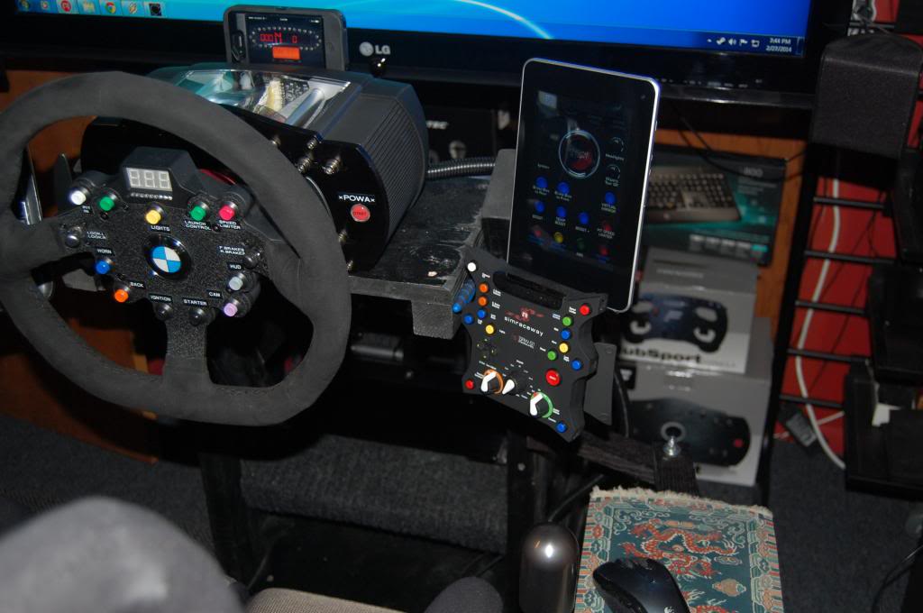

    I would like to try the more SQ style mounting but have a button box and tablet on the right hand side already along with the mouse tray, running out of room on the RHS. lol

    Can you share your button box layout with us? I have been thinking about fabricating one for a while. Especially a "sorry" button ;)
  18. Nick Moxley
    17,057Coins
    +2,506 / 30 / -2
    I didn't built it myself. that's still a future project for me to dive into. Before the Fana gear i was into the G27 with SRW S1 attached. Over the years i acquired a few more S1's and was able to salvage one of the busted circuit boards and use it as a Basic button box. Also having the 12 way rotary is pretty handy when playing SRW. I also left the throttle paddle on to act as a Handbrake depending on what game.

    I guess what I was asking was what inputs to you think are needed the most in racing? A button for "woops" which sends a macro apologizing for bumping that guy off the track and into the guard rail further eroding his confidence resulting in his quitting iRacing becoming addicted to jelly donuts with his wife leaving him for the dentist whom she met while taking him in to have his teeth pulled when they rotted away. You know, things like that :D
    I am new to online racing and wonder what inputs should I be setting up to use during races?

  20. RacingMat
    2,233
    21,082Coins
    Hi David,
    For rFactor, the strict minimum is "pit stop" and "speed limitor".
    It would be a good idea to share the answer to your good question: I'm also curious about this :)
