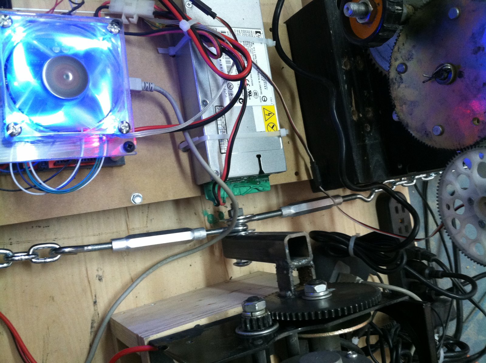

    Gear box swapped and considering different mounting positions. Unfortunately got a call from Element14 where i ordered the pots from and despite the web shop showing them as IN Stock, I assumed they were....well....In stock. Apparently not and they are expediting them from the UK due to the screw up. So at least a good week's delay on those.

    Motor mounts made with bolts and levers basically done, Screwed up and drilled the Rod end hole too big on the levers so ill just have to remake them. I also Need to get the axle bolt drilled out at the machine shop to ensure it stays true for the Pot mounting.
    I went with 10-24 set screws to Key into the axle and also used 1/2 threaded rod vs 12mm bolts. I couldn't find Long enough 12mm bolts that were All thread, so a 3' length of threaded rod was all i had to choose. Yes it was Tight tight to the gearbox, but after pushing its way through a couple times its Super snug but can easily be removed.

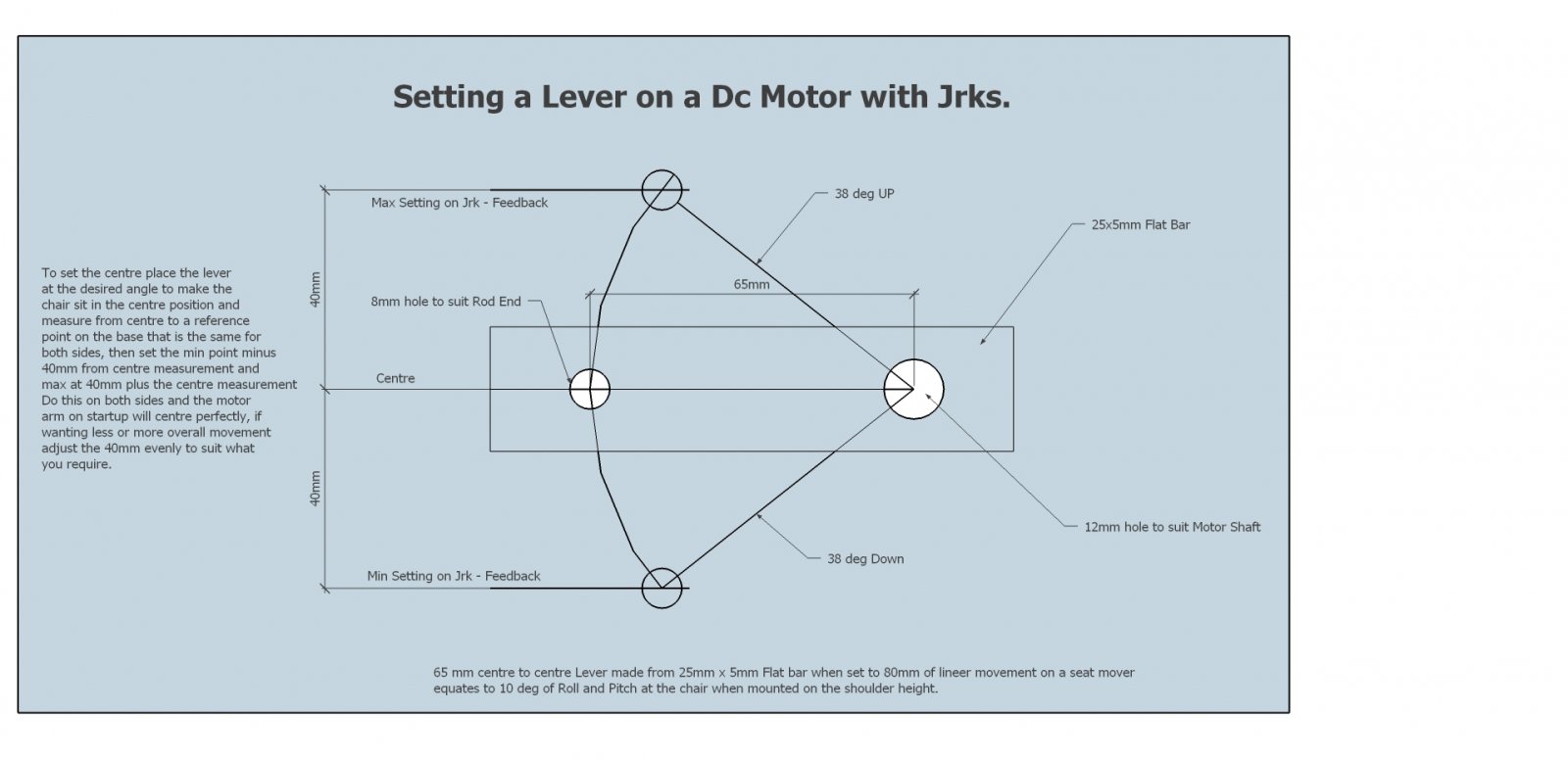

    looks good, but how long is the centre to centre on the levers? looks a bit long there. recommended overall is 60 mm CTC on 25:1 gearboxes. Any longer and you start to loose torque in return for speed.
    I have put 80mm CTC on motors but thats with 60:1 boxes and its now too much throw for the owner, well, thats what he asked for.
    I think 45mm CTC calculates to 500mm per second.

    that lever in the pic is 65mm, Remembering i want speed Vs torq, what length should i use ?

    Here is a handy picture to understand how to setup the Jrk with a lever.
    It only uses 76 deg of the pot travel when pot is connected directly to shaft, no issue as the Jrk will create a scaled feedback value and makes min equal to 0 and max equal to 4096 which returns the overal scaleback values to high resolution so no mater the angle you retain the resolution of the motion. Bonus. And being a 150-180 rpm motor you can achieve very fast movements and 80mm at the lever relates to 10 deg of movement in chair.

    I stand corrected , Rob uses a 65mm CTC lever so stay with that and follow what he says about setting the feedback range.

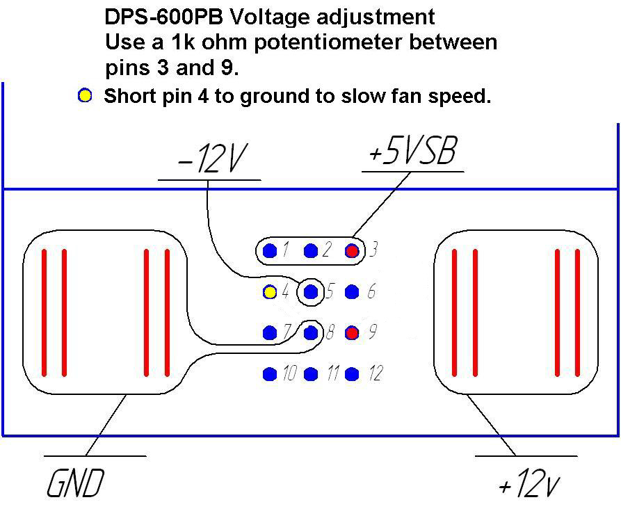

    So question guys, Had a buddy come over with a Fine tip soldering gun and got my JRK's all wired up. Question tho, the Read out for the JRK wiring basically lists the pot wiring as Ground on the bottom, 5v regulated in the middle and Aux Output and Feedback input for the top 2 pins, Now for ground and 5v, Am i shorting both pins together or can you use just one pin, Also the top 2 pins are listed as an input and output, Are those also being shorted together and connected to the Feedback pin on the Pot ? Just trying to understand how a input and output being shorted works exactly.
    Next, When referring to this page and the part about the Pot for adjusting voltage, What wire is what ? there's only 2 wires im working with, Pots have 3 pins.
    https://sites.google.com/site/tjinguytech/my-projects/HP47A
    here's something i have from all the pics i saved SO.....Knowing pin 3 is 5v but what is pin 9 and what do i hook that up to ? Feedback, If so do i need to run a ground for the pot ?

    Ok with the power supply you only need to set them up to produce 12v's and as per the picture on the hook up the 12v+ goes to the VIN on the Jrk and the Gnd from the powersupply needs to got to the GND of the Jrk.
