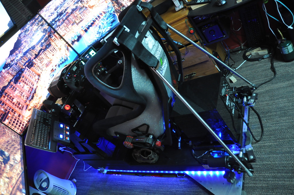

    So Recently ive been discussing with some of the member's about the Traction loss frame requiring a little more support rather than just a lazy susan/bearing up front and a pair of Caster's out back. I noticed on my rig as well there was some "rocking" of the top frame at the front end on either side of the lazy susan. So without getting crazy technical with Caster's and plates to roll on, I fashioned this up with a pair of these roller balls, I had always wanted to play with them and actually found this pair in my shop so went to work with some Steel and aluminum angle.
    I used a "wedge" to slightly lift the top frame so when i pulled the wedge, the balls have some tension on them.

    Nice. How does it feel now? I will have two casters up front also. Hopefully in Jan.
  7. Nick Moxley
    17,057Coins
    +2,506 / 30 / -2
    No play No Mo. Lol at least from the rig's perspective. Still Just a little from the Double Cushion carpet and carpet sliders.

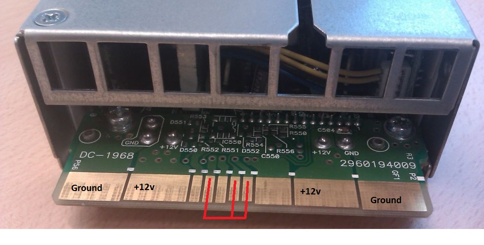

    only this option works on mine 700GB,s white other option it shutsdown after 10 sec :(? But now works ok!
  9. Nick Moxley
    17,057Coins
    +2,506 / 30 / -2
    So whats the problem exactly ? Sorry i never really spend much time with my 700's....they got wired up tested then put on the shelf. Was my Pin out different to what you just posted ?

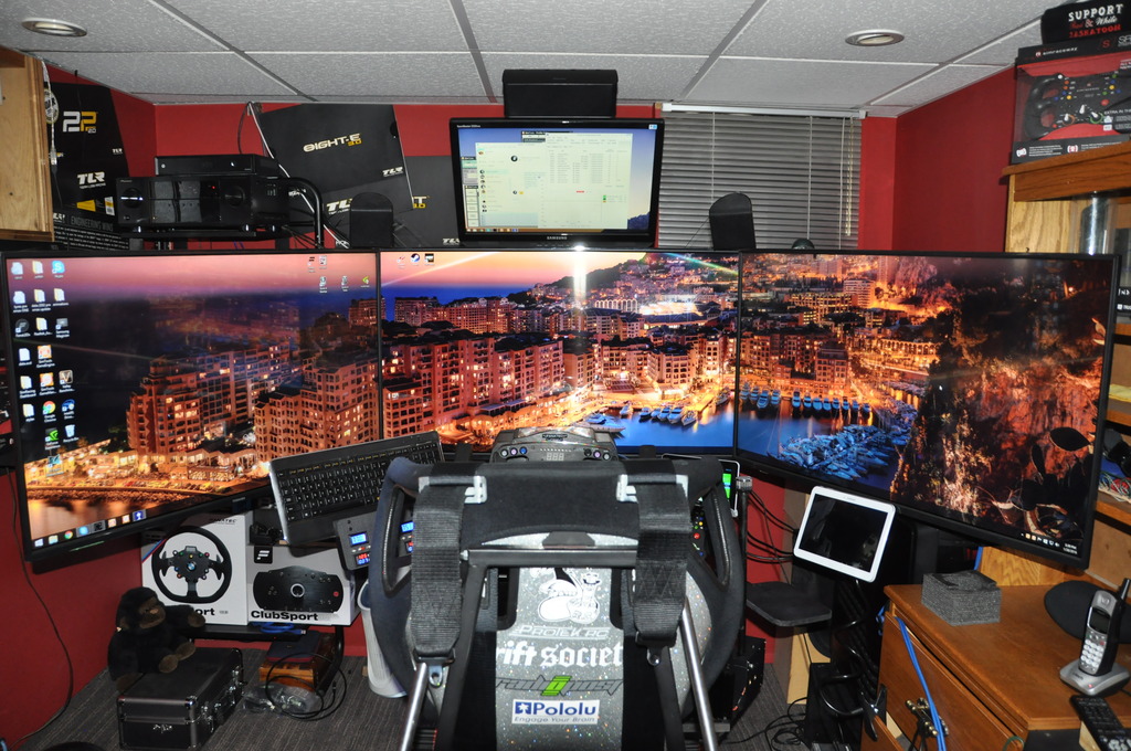

    Screen's were always something i wanted but never had the space to for them until i did a 180* on the room and made it possible, lol :excited:
    Next thing i always wanted was an adjustable wheel plate, so with a little help from @Steve spenceley and his 80-20 version, I came up with this.
    Back
    Forwards
    • Winner Winner x 6

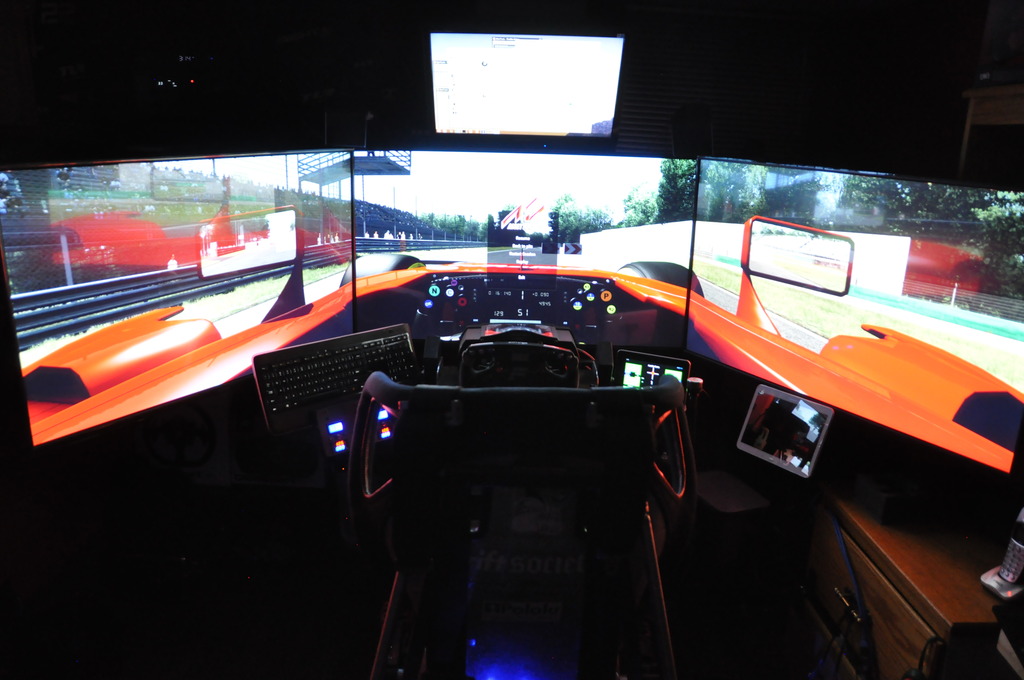

    I think with those screens you could also use a bigger angle, maybe another 10°/15°
    Edit: amazing setup!!
    Edit #2: I'm fought between triples like these and OR. It would cost me the same
  18. Nick Moxley
    17,057Coins
    +2,506 / 30 / -2
    Screen's are at 120deg....realizing AC's triple app as good as it is, Does lack a few particular features Iracing has.
    The Cost of the Rift was a large deciding point for me, Next was the screen resolution and FOV, Imo it will get better, rather quickly....so CV1 wont be around that long before we see CV2 with upgraded screens and what ever else they are working on....Add in the fact Not all Developer's have it setup....I can wait...these triples are a Whole new ball game, so currently more than happy.
