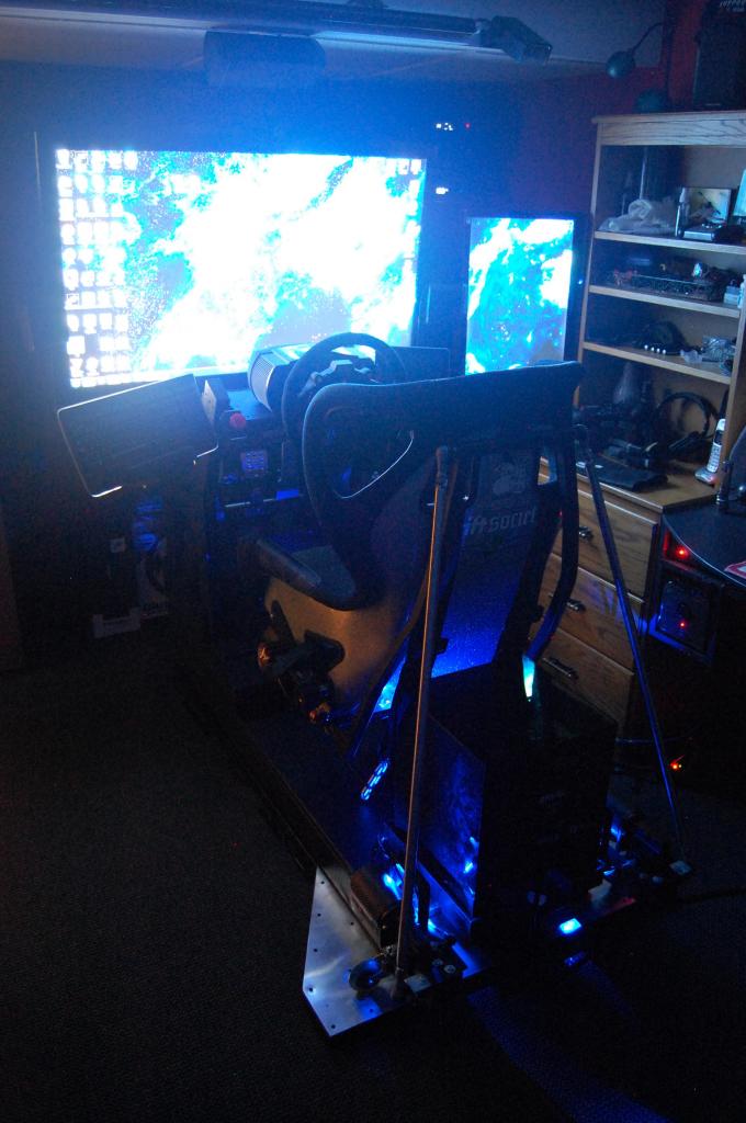

    I got a hold of a buddy who does Professional video stuff, so if he cant make the rig look good Im at a loss as to how to get some quality video from my dark poorly lit room.
    ive tried a few times with buddy's cameras, GoPro, Handheld HD cam and Nothing would come out clean and crisp enough for me.

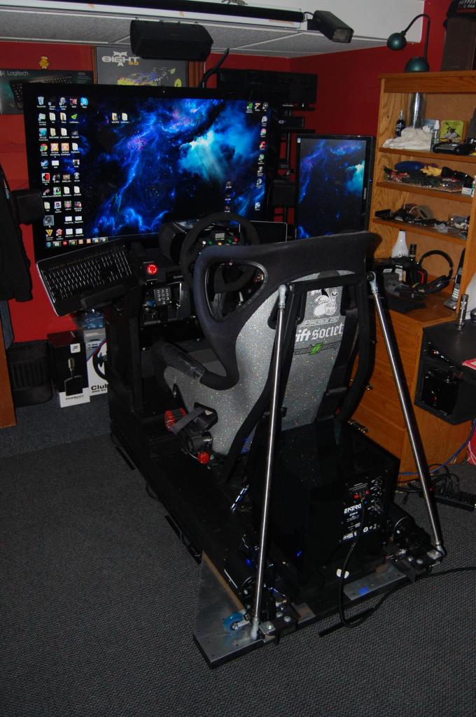

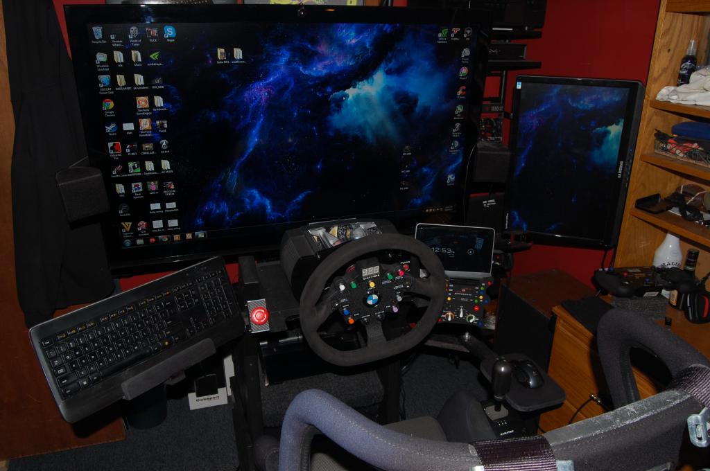

    So i wanted a 2nd monitor to adjust Simtools and Have a LARGE App diplay for telemetry and other stuff so After realizing i didn't want to run a 2nd 20'+ HDMI downstairs and effect my Overall Screen setup (mirror of my Desktop) I found this little guy on Ebay, http://www.ebay.com/itm/USB-3-0-to-...=US_Video_Cables_Adapters&hash=item233d480f3a
    Hooked it up and Whamo, Extended monitor. Didn't effect my Normal Mirrored screen and even allows me to use landscape or portrait mode and make a few more adjustments.
    Next issue came as to where/how to mount the screen. I Looked at my Articulating TV mount on my big screen and thought, Pssh I can build that.
    So here it is my own Custom Mount, Not Super pretty, but 99.9% of the time you dont see it at all.
    and what the final product looks like,

    Ok so Slight issue with one of my Power supplies, After much testing and screwing around ive determined One of the seat Supplies Isn't up to snuff and is Falling short on Big Impacts Causing Simtools to Crash, So to take advantage of a little RC racing trip im doing Down South next weekend, I ordered up a pair of these bad boys to replace my 600's, Greatest thing is Shipping is Free and they fall Well Within my "Duty Free Limit" So 20$ is a Drop in the bucket and lets hope its a Simple PS issue and nothing else.
    http://www.ebay.com/itm/HP-DL360-G5...01-/381001054632?ssPageName=ADME:L:OC:CA:3160
    EDIT Turns out the PSU's weren't at fault and it was something else yet to be Pin pointed. But have a firm workaround for the time being till V2.
