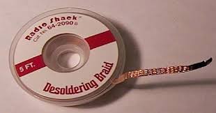

    Also Little Side Note. I took me 3 JRK's , 2 of which i Didn't solder myself to realize the little blue tabs have a V slot in them to "click" them together when soldering to the board. I really wish there was an easy way to remove them from the boards and re solder em. I do have a solder sucker but have never managed to get it to really work, Oh well, just thought i would mention it.

    Nick,
    I've always had better luck with braided solder wick than solder suckers, easier to use and cleaner from my experience.
    http://www.radioshack.com/product/index.jsp?productId=2062744
  16. Nick Moxley
    17,057Coins
    +2,506 / 30 / -2
    Thanks Roonster, ive often thought of picking up some while at the electronics shop. Guess i have a reason to now. :thumbs
