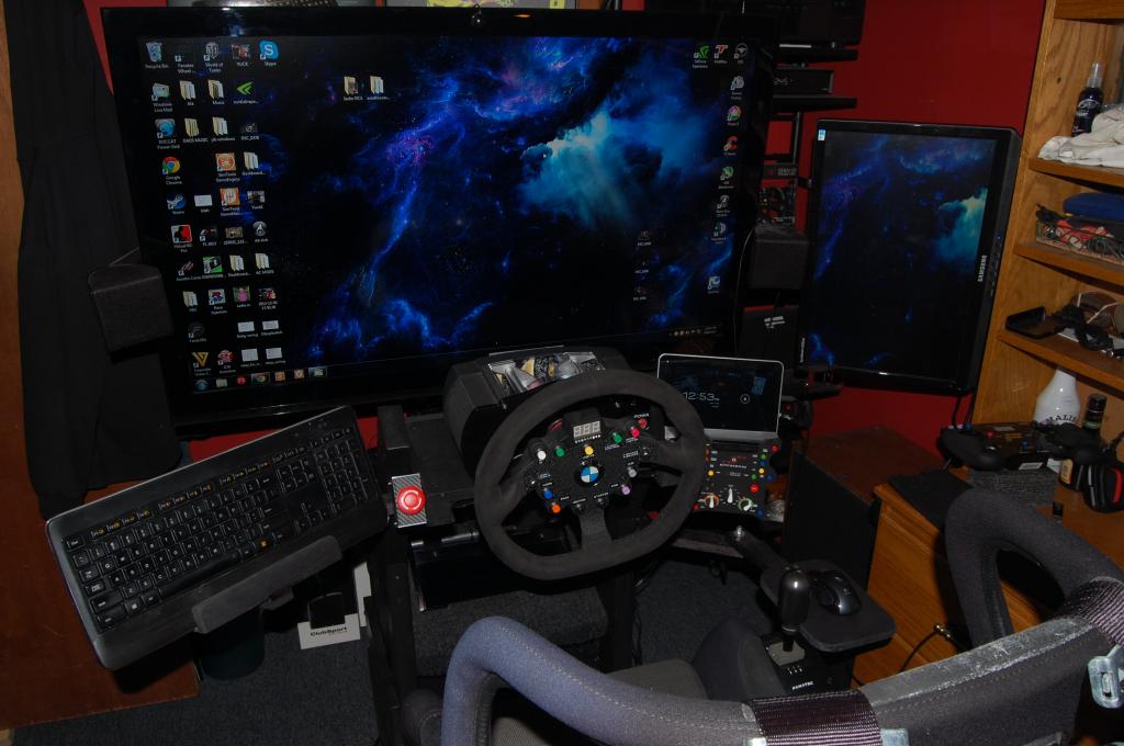

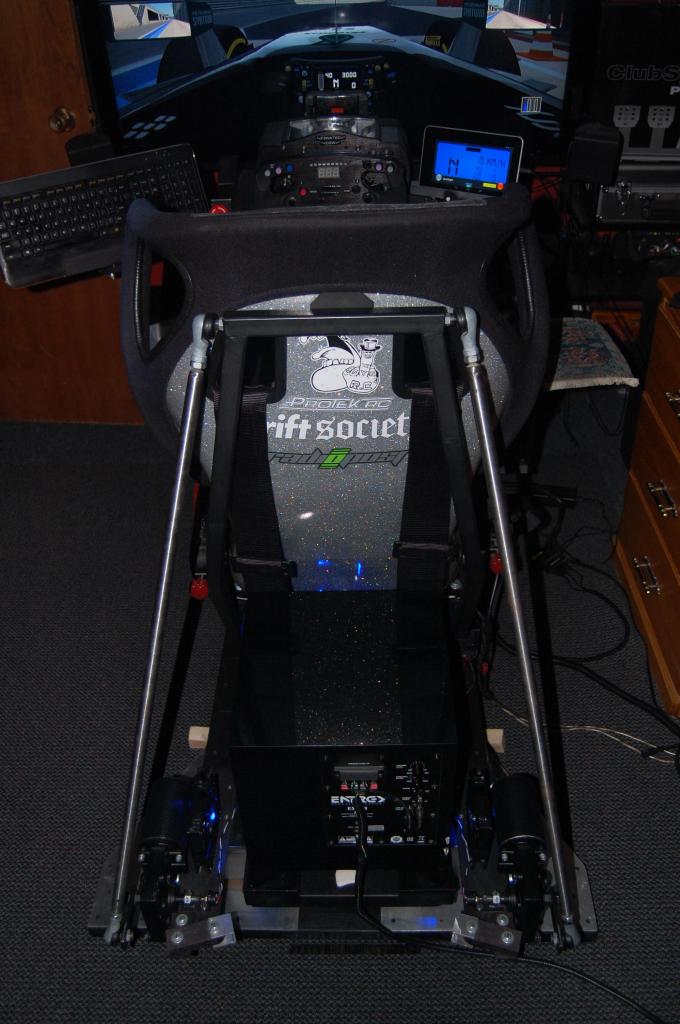

    My current Rig base is 21" wide, I would prefer to keep it that narrow if possible. Some of the Designs i see have a rather large angle on the arms, What am i loosing if i keep it narrow ? Can the lack of angle be made up for in the software tweaking ? Ive seen Seat movers with the motor's Directly UNDER the seat So that would lead me to believe I would be fine in keeping the width i currently have.

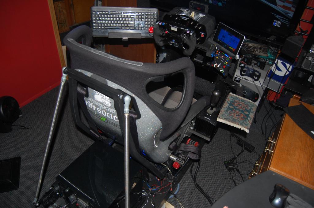

    here's the back of my rig, Sub normally sits right in the middle and it looks like it could be sqweezed in between the 2 motor's on either back corner, extra 2x4 jet out if to catch the legs of the sub so thats the subs width/debth. Obviously with the seat moving for/aft/side to side I will have to extend the base to provide enough space for the seat to move and not hit the sub.

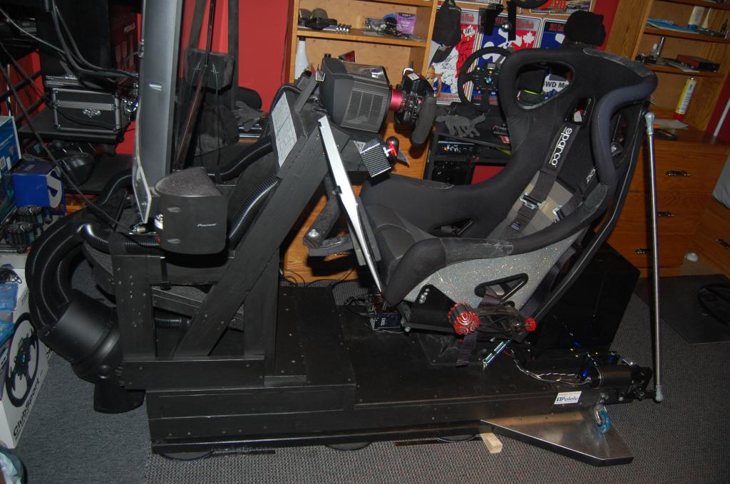

    Finished product,

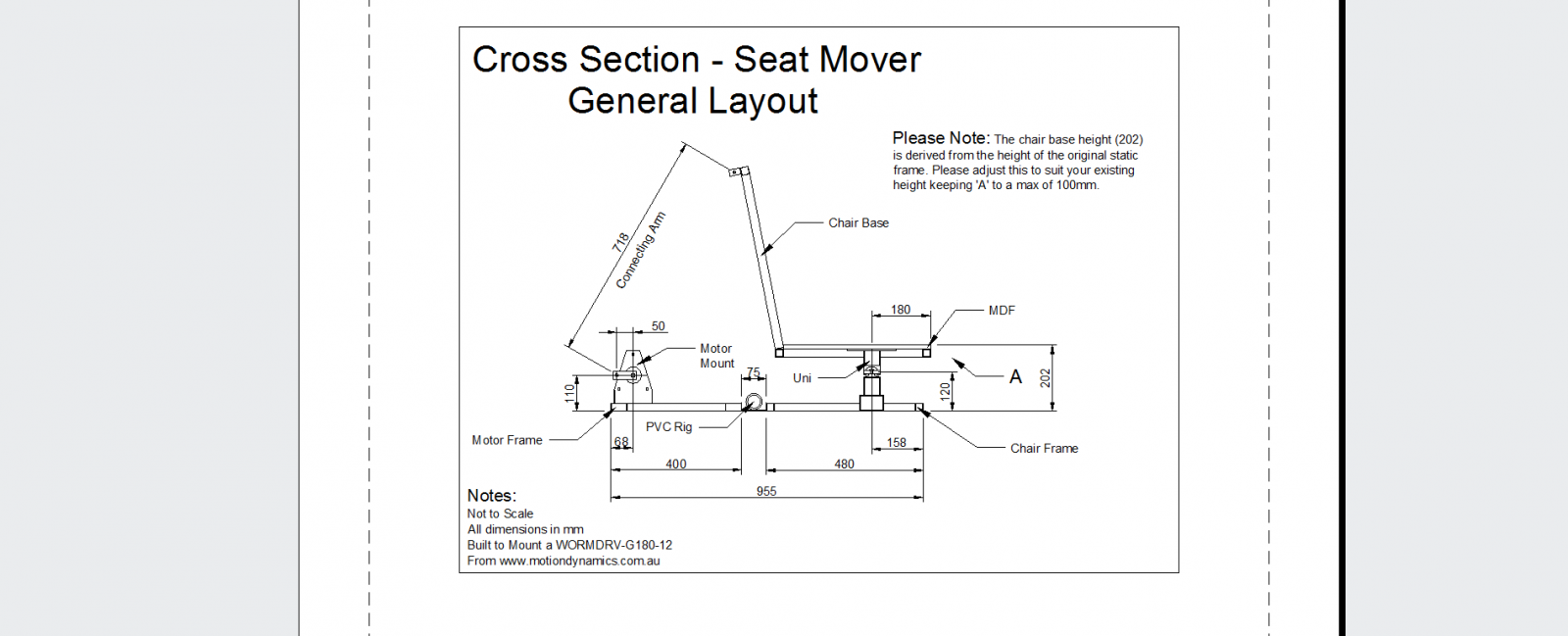

    Take a gander at this mate. If you require can pm more of the plans to you. Welcome to copy it or redesign it to suit your needs, complete with motor mount for the listed motors.

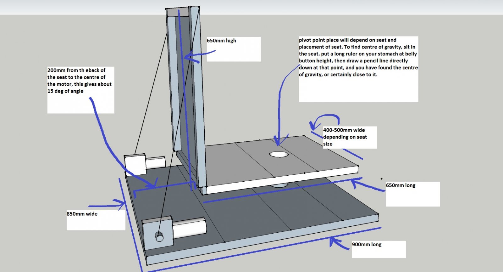

  10. bsft
    motors under the seat dont look like they affect movement, and I know from experience now that yes, motors can be run under seat. But shoulder mount does give really sharp motion. Motors under the seat can do the same if you really wind them up.
    Angle from back looks good, maybe spread it out a bit at the rear though. Can you allow 15 deg angle going out to the side?
  11. bsft
    This worked for me

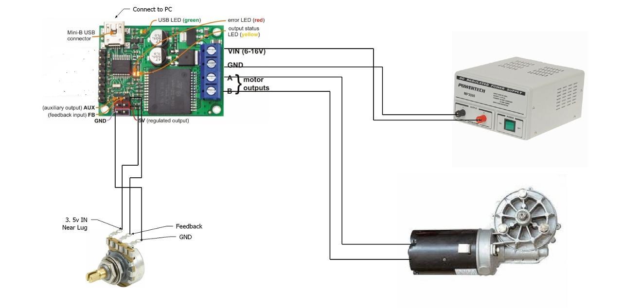

    So power supplies, this is what im looking at, but if there's any better deals out there you guys know about. Also what inputs do the JKS boards require, I see some of the power supplies have a Bunch of different connectors. I know the JKS need 7 wires, which might those be exactly
    http://www.ebay.com.au/itm/500W-Uni...cal_Test_Equipment&hash=item256fb4a8bf&_uhb=1
    http://www.ebay.com/itm/500W-12V-41...165?pt=LH_DefaultDomain_0&hash=item2c7bf9c7a5
    Is it as simple as 2 wires for PS, 2 wires to Motor, and 3 wires for the POT ? What are all the other inputs on the left hand side of the JRK
