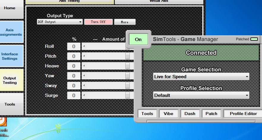

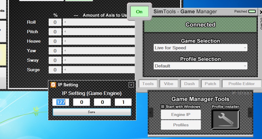

    Started playing with a laptop, now for the desktop, the new win7 system, the other are normal, that is, into the game seat does not move, not into the game test, the seat can move. Looks like the two software is not connected .. Game Engine / Game Manager. NET4.0 are loaded

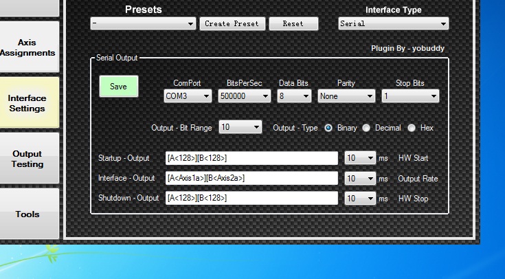

    ip address is also set.

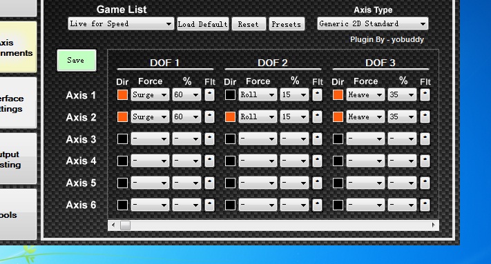

    Please post pictures of all of your settings, including your Interface Settings

    Hello there. noorbeast
    This is setting

    No problem testing
    Seat dynamic,
    Into the game will not move.

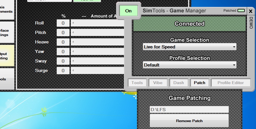

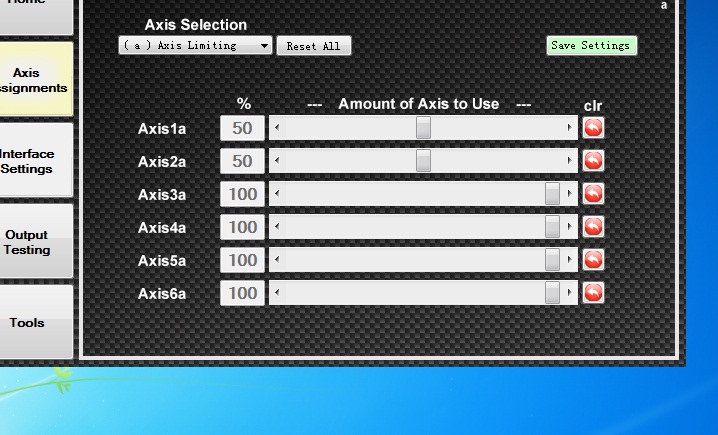

    Did you run LFS for a a lap or two before patching, as that generates some needed files. If not unpatch LFS, shutdown SimTools, run a couple of laps in LFS, restart SimTools and repatch LFS.
    Does Game Manager turn blue when LFS is running?

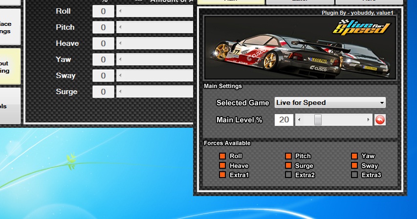

    Your Main Level at 20% is way too low, for now put it back to 100%.
    Why the Axis Limiting, are you using SCNs?

    In this case, the seat can move.
    When playing in a notebook is 20%. After changing the computer is also set at 20%.
    Not SCN5. The original DIY seat.
    I will try now.

    Great, a success. It feels good moving up. Thank you very much, thank you!
    In addition, I would like to ask, I use a worm motor, the shaft without restrictions?

    Hello .noorbeast
    Now I put 20% transferred to 100% into the game moment very fierce, almost throw me out, can not play, do not understand why.

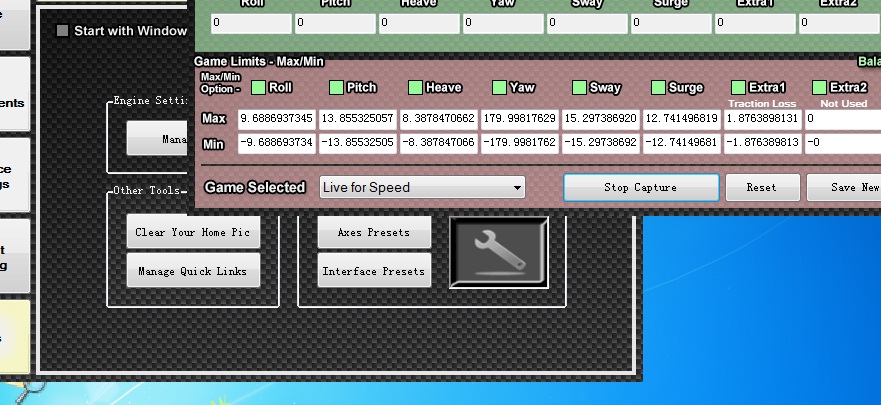

    You need to learn how to refine a motion profile for your rig and the game you are playing, see the steps here: https://www.xsimulator.net/community/faq/steps-to-create-a-motion-profile.228/
    Capturing the Max and Min in the Tuning Center will make a big difference, but you also have to get the Axis Allocations right and tweak the Tuning Center Values, once you have a good generic profile you can refine it further with different profiles in Game Manager.
    It takes a bit of time and patients but gets easy with practice.
    With worm DC motors you don't need axis limiting.

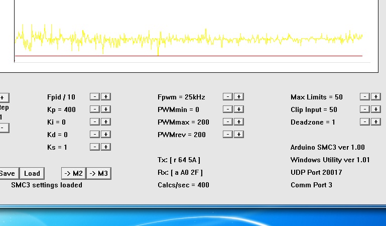

    I have opened the shaft limit to 100%. Level 60%. Action is fierce.
    I think it is not SMC3Utils settings are not good?

    This is my collection of data,
    Manually adjusted.
