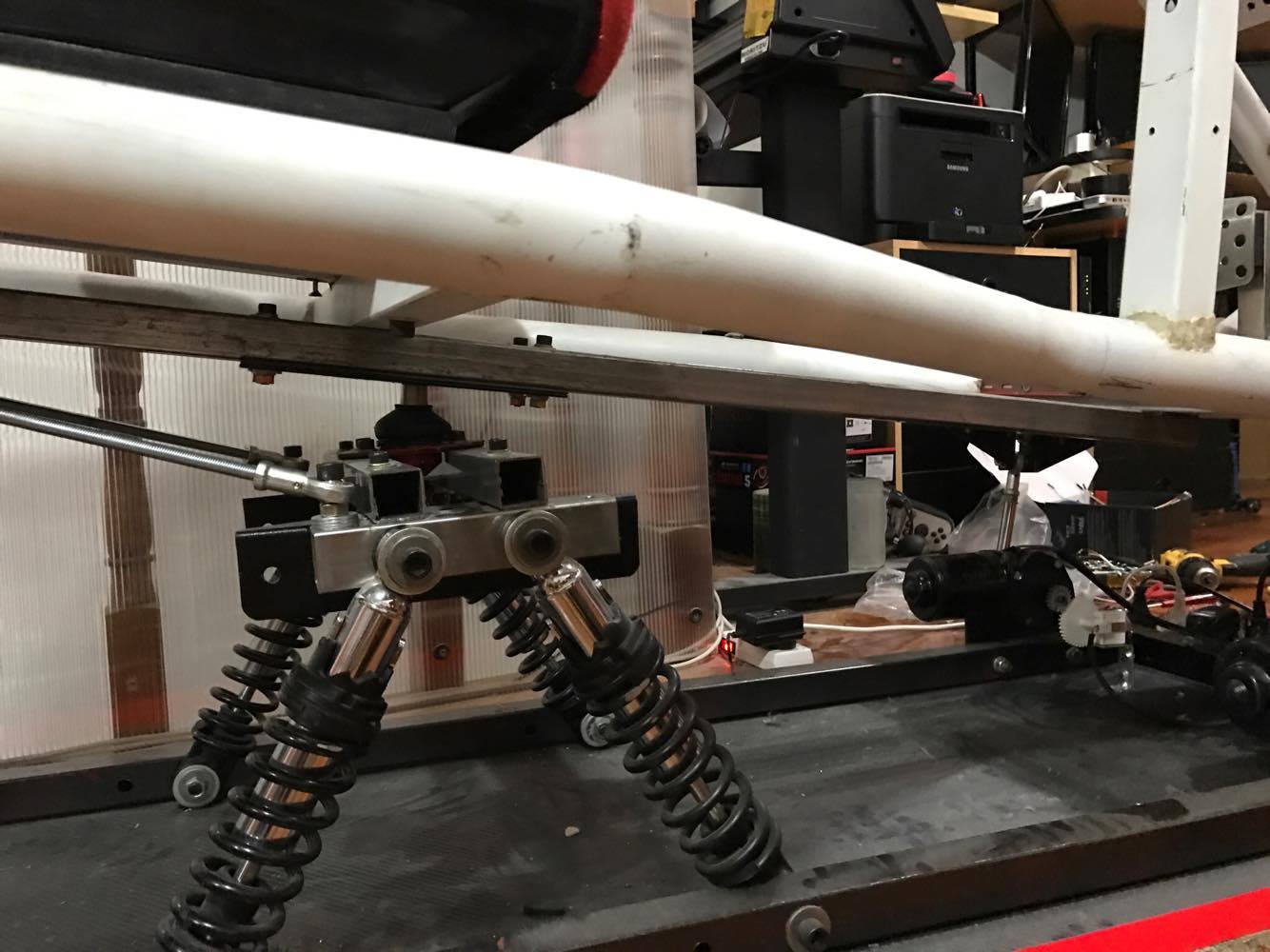

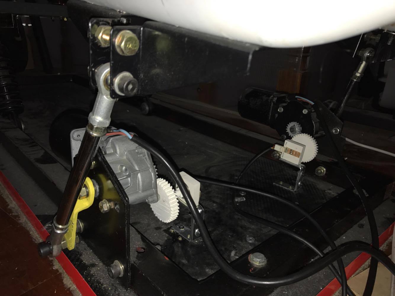

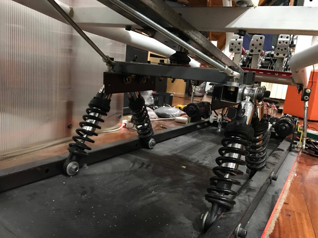

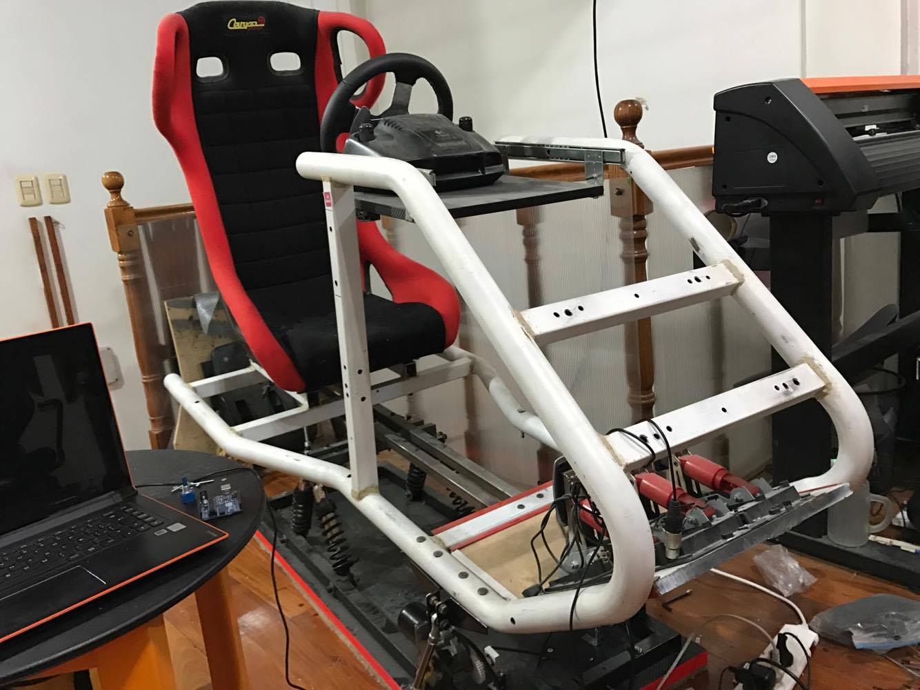

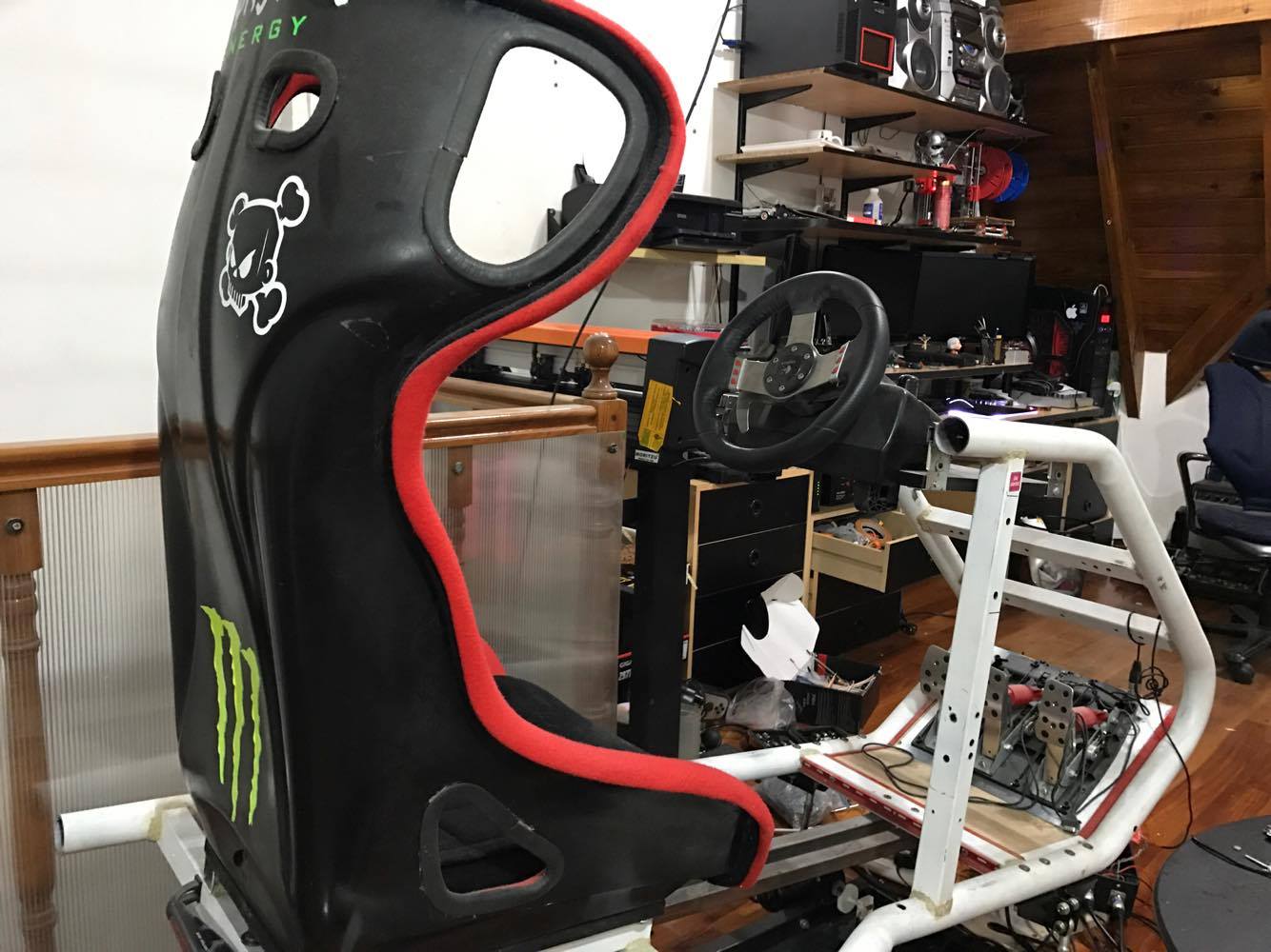

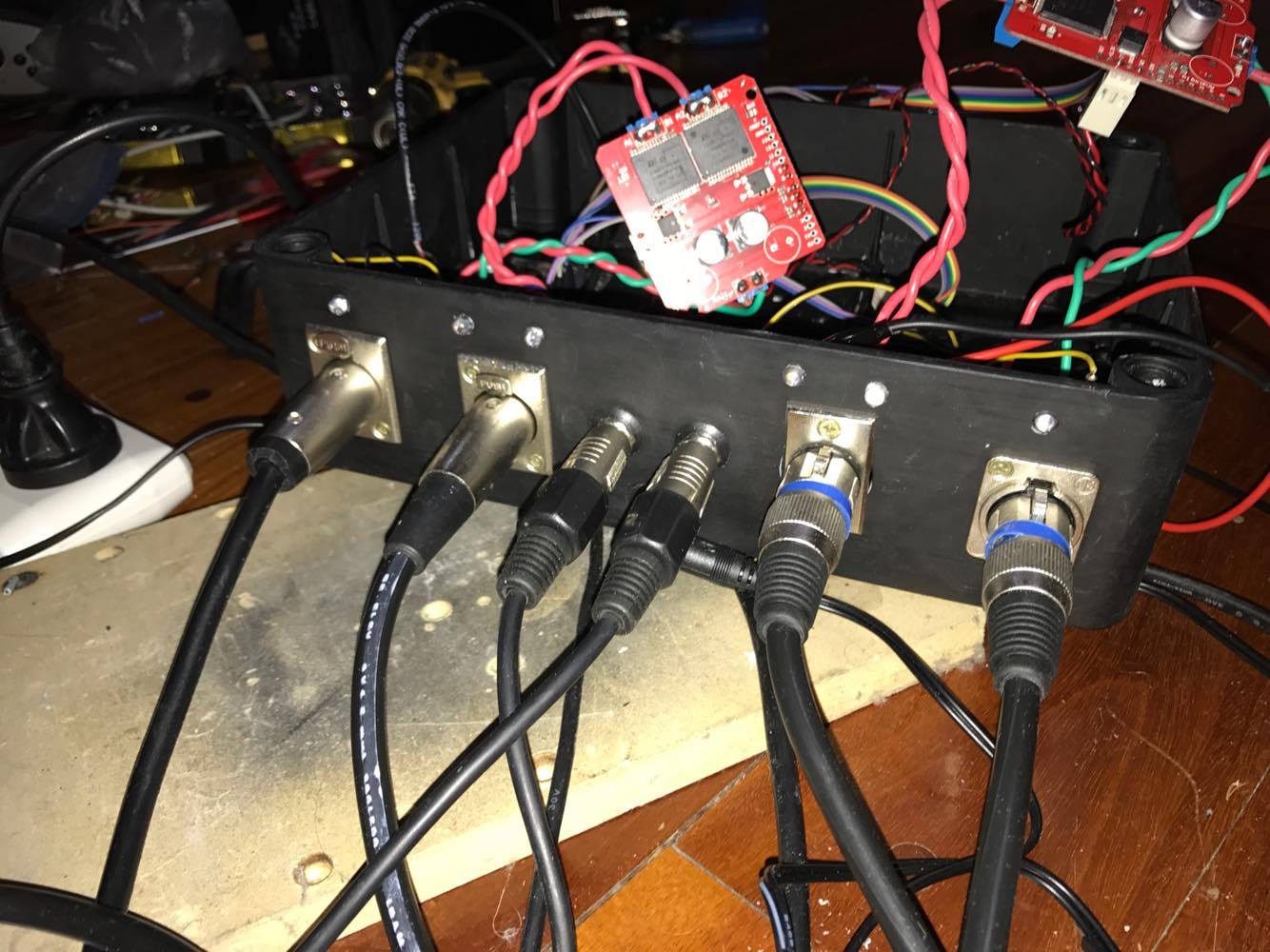

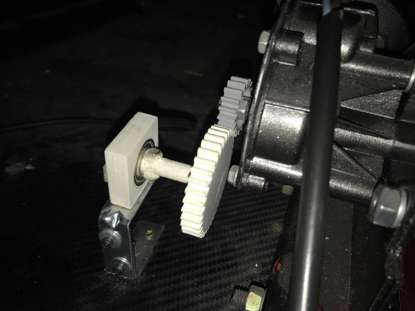

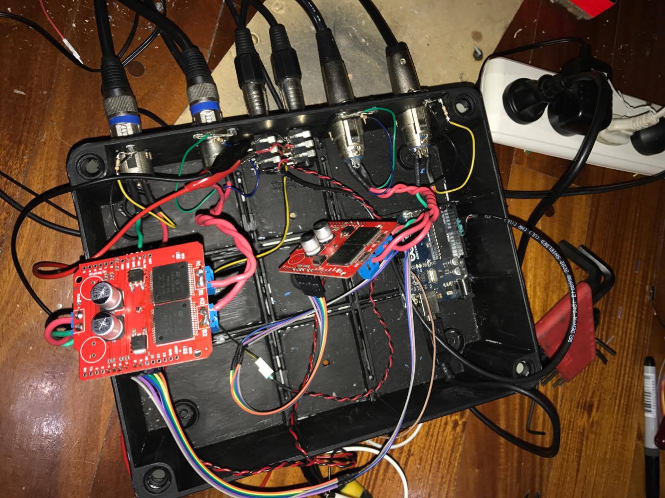

    Hi, I just started about 8 years ago in the old xsim.de forum, I was built the famous thanos AMC.
    Now, I´m returning with the great SimTools! and a new redesign for my sim.
    Arduino Uno + 2 x Motomosters + DIY Hall Effect pots + 2 x 12v 30A PSU
    This is my sim:
    16880547_10211777432461916_295736751_o.jpg 16880802_10211777431381889_2080130827_o.jpg 16931269_10211777431701897_1438810554_o.jpg 16930748_10211777431941903_745657701_o.jpg 16880250_10211777432301912_1418516336_o.jpg 16880137_10211777432021905_1433097770_o.jpg 16880215_10211777432141908_1883935615_o.jpg 16910974_10211777432661921_176721525_o.jpg

    Muy bueno! Me gustan mucho las fichas que utilizaste para la caja de control, tengo que comprar algo por el estilo.
    Nice! I like the control box connectors! I have to get something like that for my next sim.

    Hi, I'm consulting you which engines you used and where did you get them?
    Hola te consulto que motores has usado y donde los adquiriste.?

    Yeah they are Audio connectors, CANON is the name

    Hola uso motores de limpiaparabrisas de camion de 24v, ls compre nuevos.
