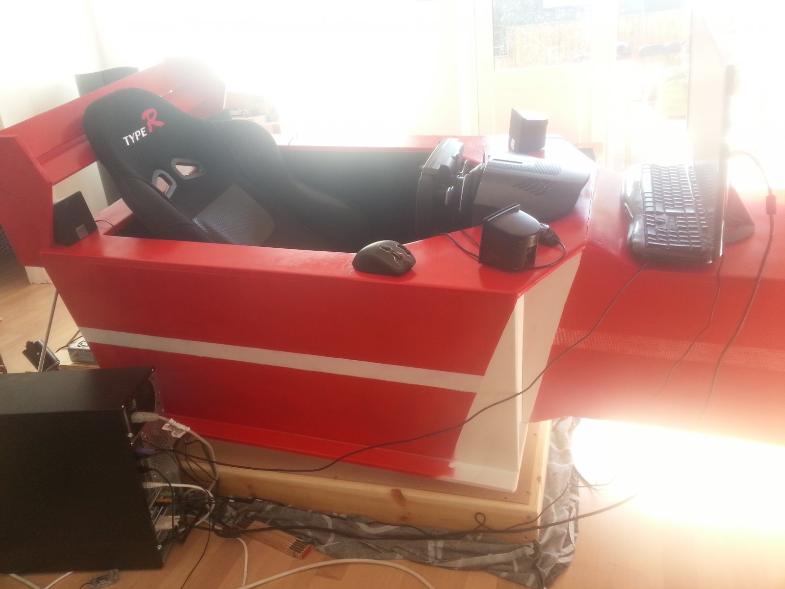

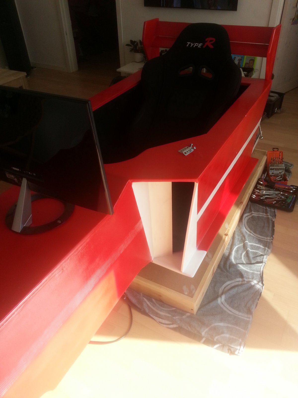

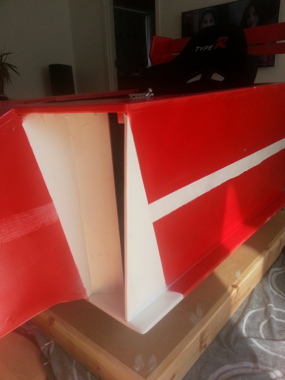

    A little teaser, more 2 come later.
  13. bsft
    Looks good man. I will say though is that the motor brackets need reinforcing, like steel angle welded along the edges to keep it steady. That will help the motors run better as well.
