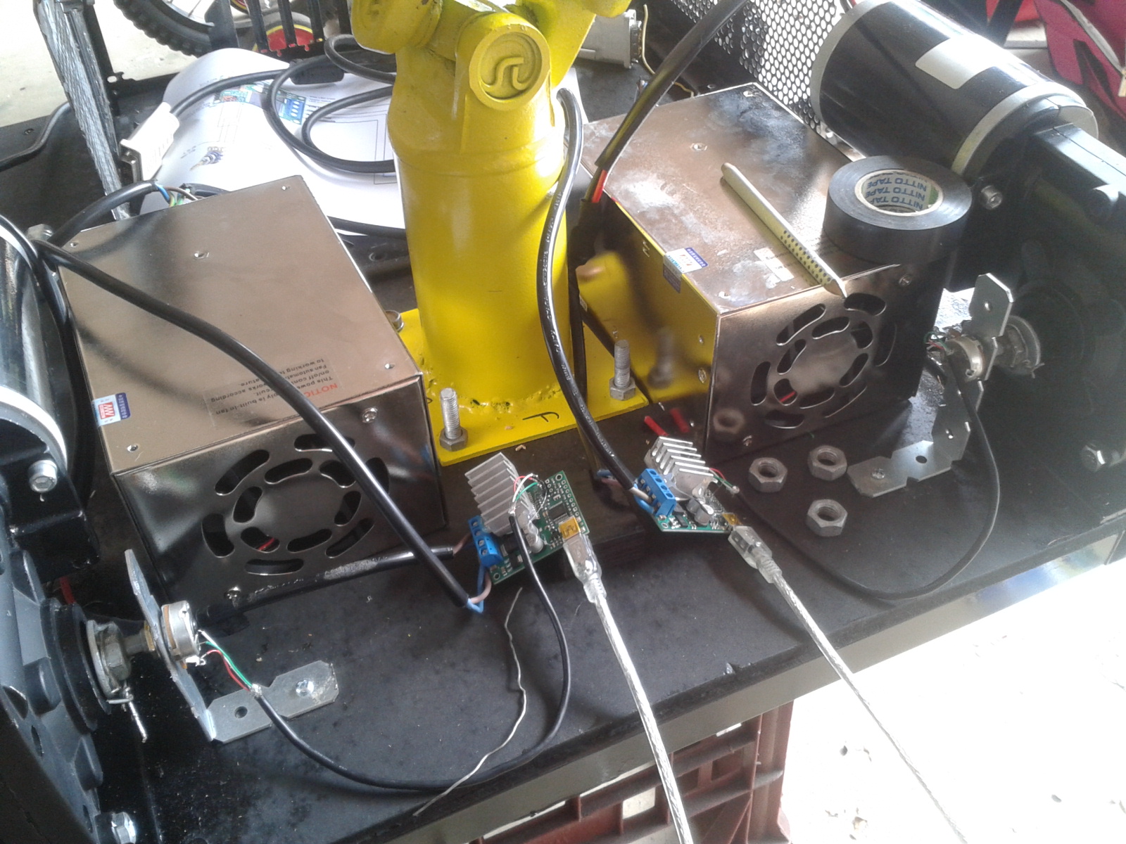

  2. bsft

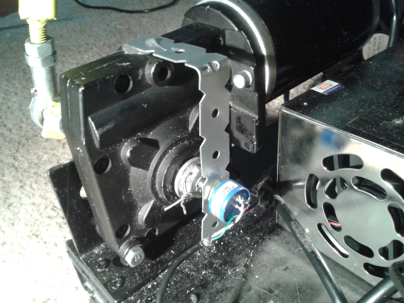

    I found out quickly that the pot brackets needs to be fixed to the motor itself so they both move together.
    I this shot, the brackets are mounted like yours, but motor twists on its own brackets and pulls and pushes against pot shaft, breaking them.
    I should have known after 11 builds.
    This is better,
    pot moves with motor, no more breakages.

    Thank you all, Will du a remake pot mounting. :thumbs

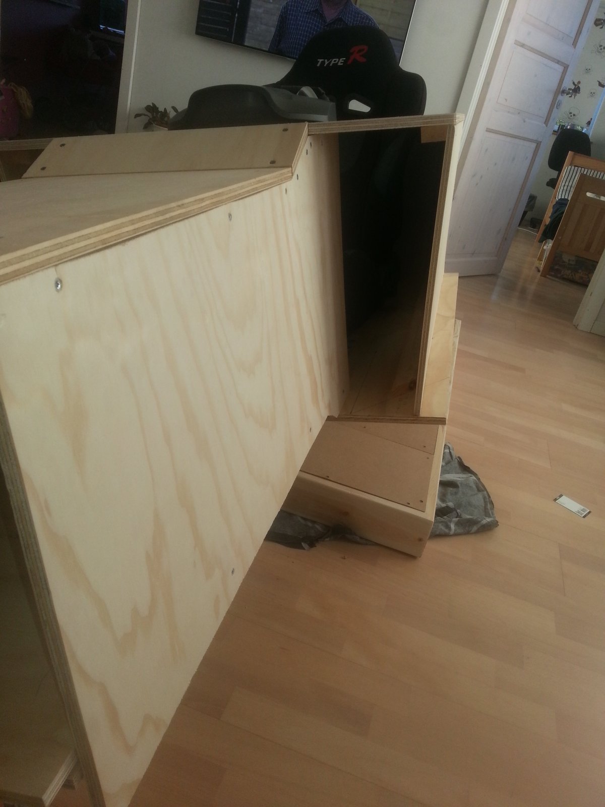

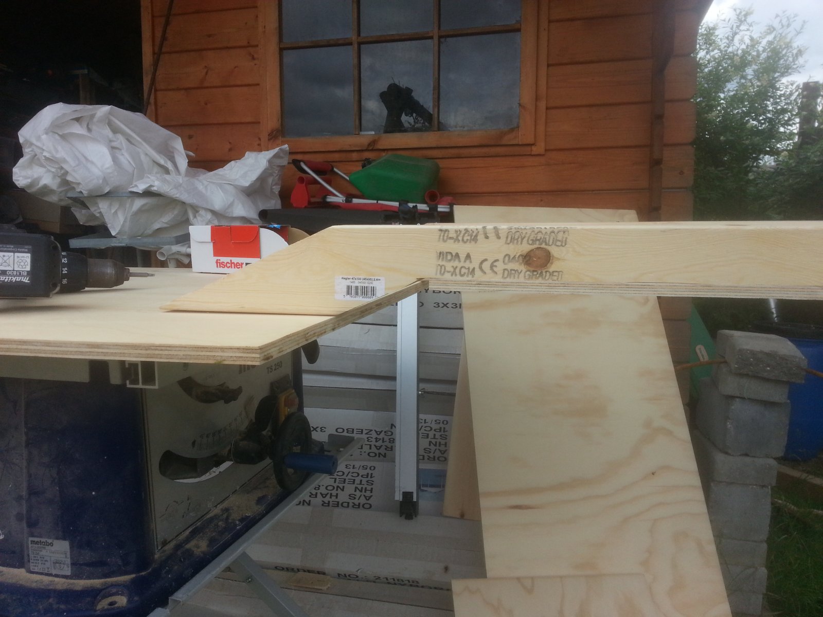

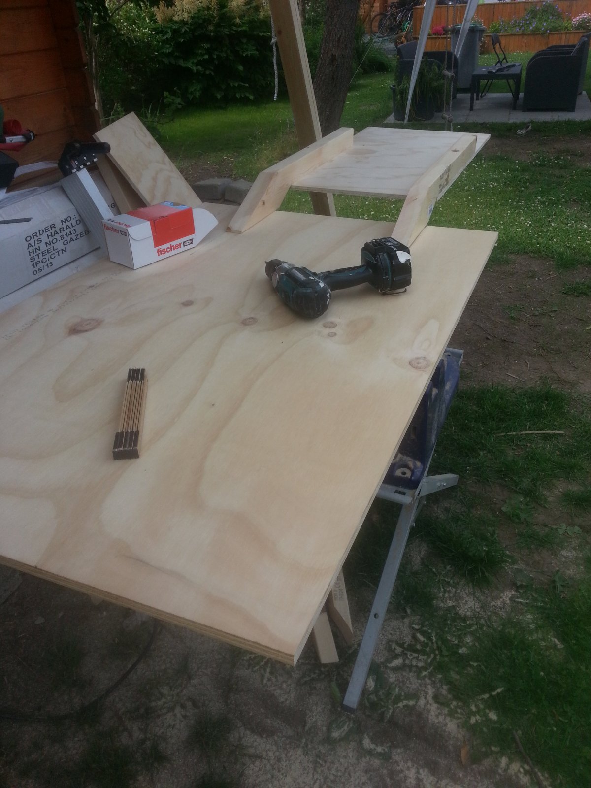

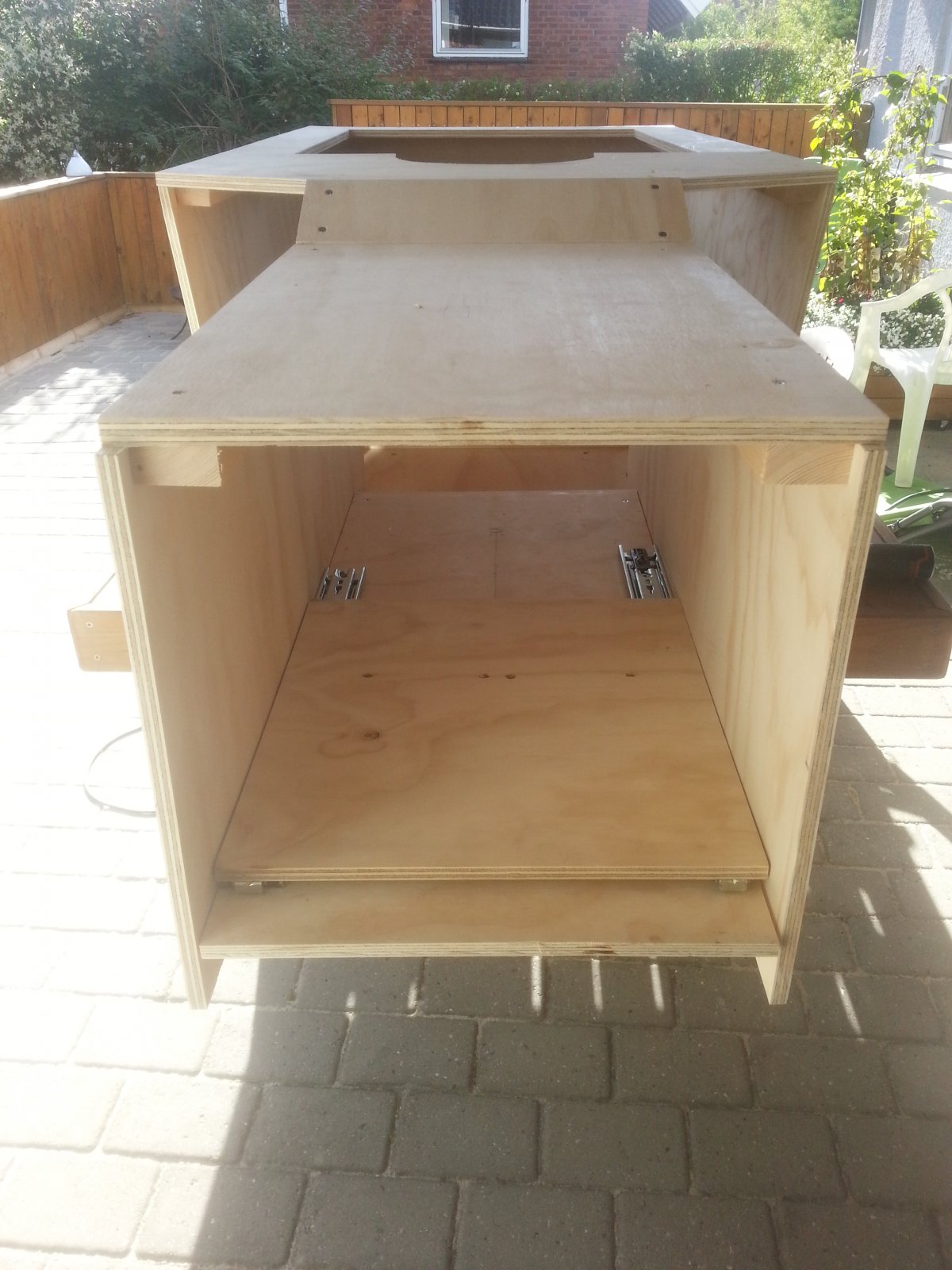

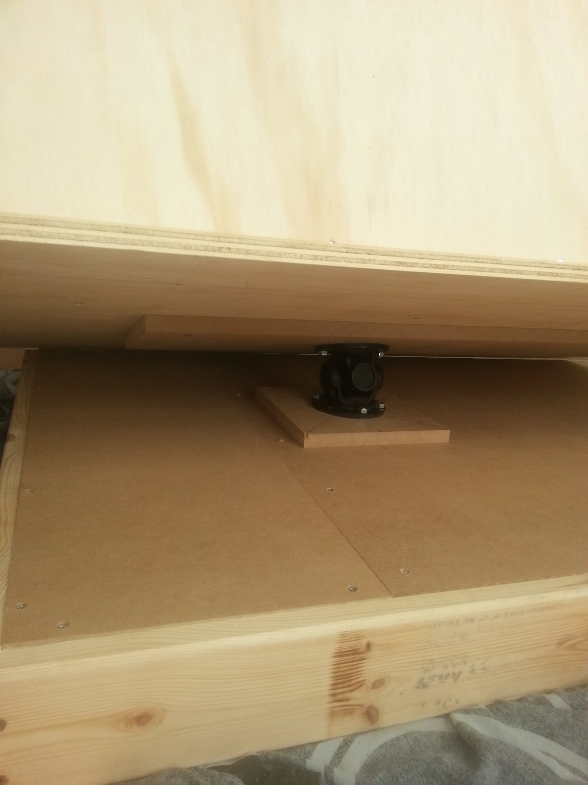

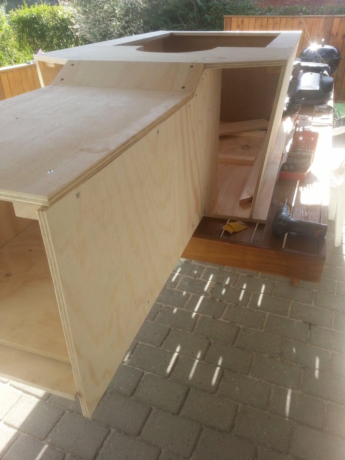

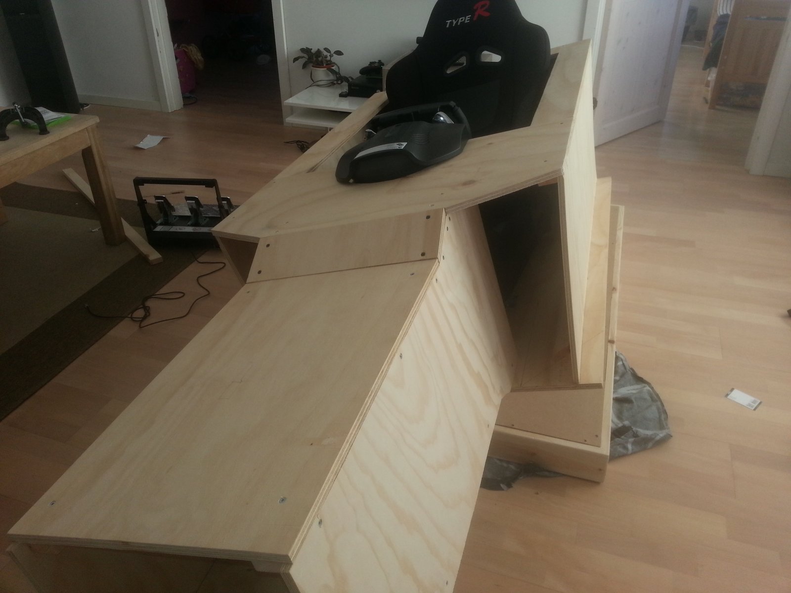

    Made the cabinet this weekend, Well it turned out quite larger than i expected. :think
    Will do a remake of this, Think i can cut off at least 20cm in length of cockpit.
    20140621_151849.jpg 20140621_151910.jpg 20140622_180751.jpg 20140622_180812.jpg 20140622_200633.jpg 20140622_200648.jpg
    Also got the joint shaft mounted, i think the cabinet is still quite heavy. I have my doubts the the motors can handle it.
    Will test when i get home from work.

    If they can handle can it, but there are more doubts about the stability of the moving parts. In a F1 car you expect hard turns and not a wobbly jelly, so IMO if using wiper motors they will be rather overcharged. Just my thoughts :)

    Going back a few steps, the frame looks heavy, wipers would struggle. You need to look at winches for that thing for sure.

    In theory your wiper motors can still move it but you'll need to pivot it quite far away from the balance point.
    Just an idea: why not get rid of the wood on the top and replace it with a fibreglass shell to reduce weight?

    Well i did cut 15cm from cabinet in lenght. and mounted it again on platform. Did a little test just connected the motor direct to PSU and it ran well. So far im not worried about weight. the motors did really well.
    I can lift the cabinet by my self "Without seat and steering whell offcourse".
    Next time i dismount the cabinet i will try to measure the weight.
    I will thou look for other motors, i can see there are many advantage with larger motors. :)
