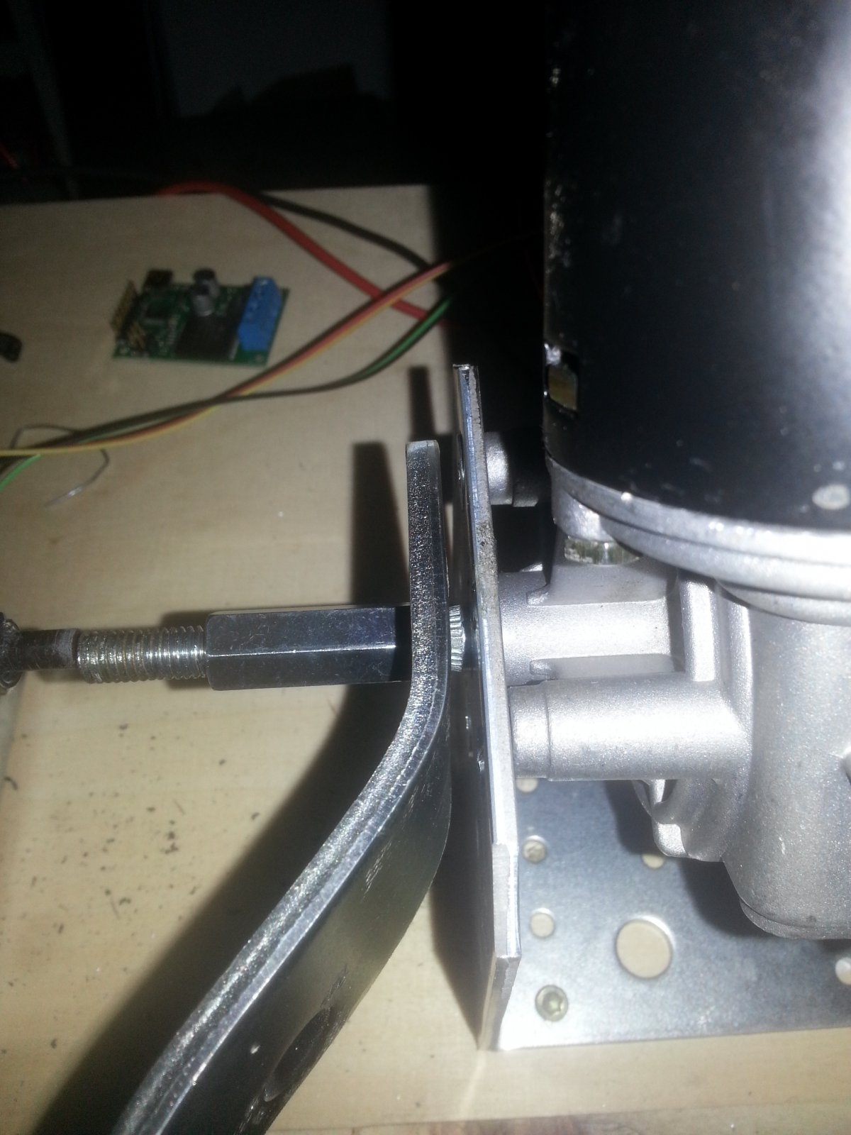

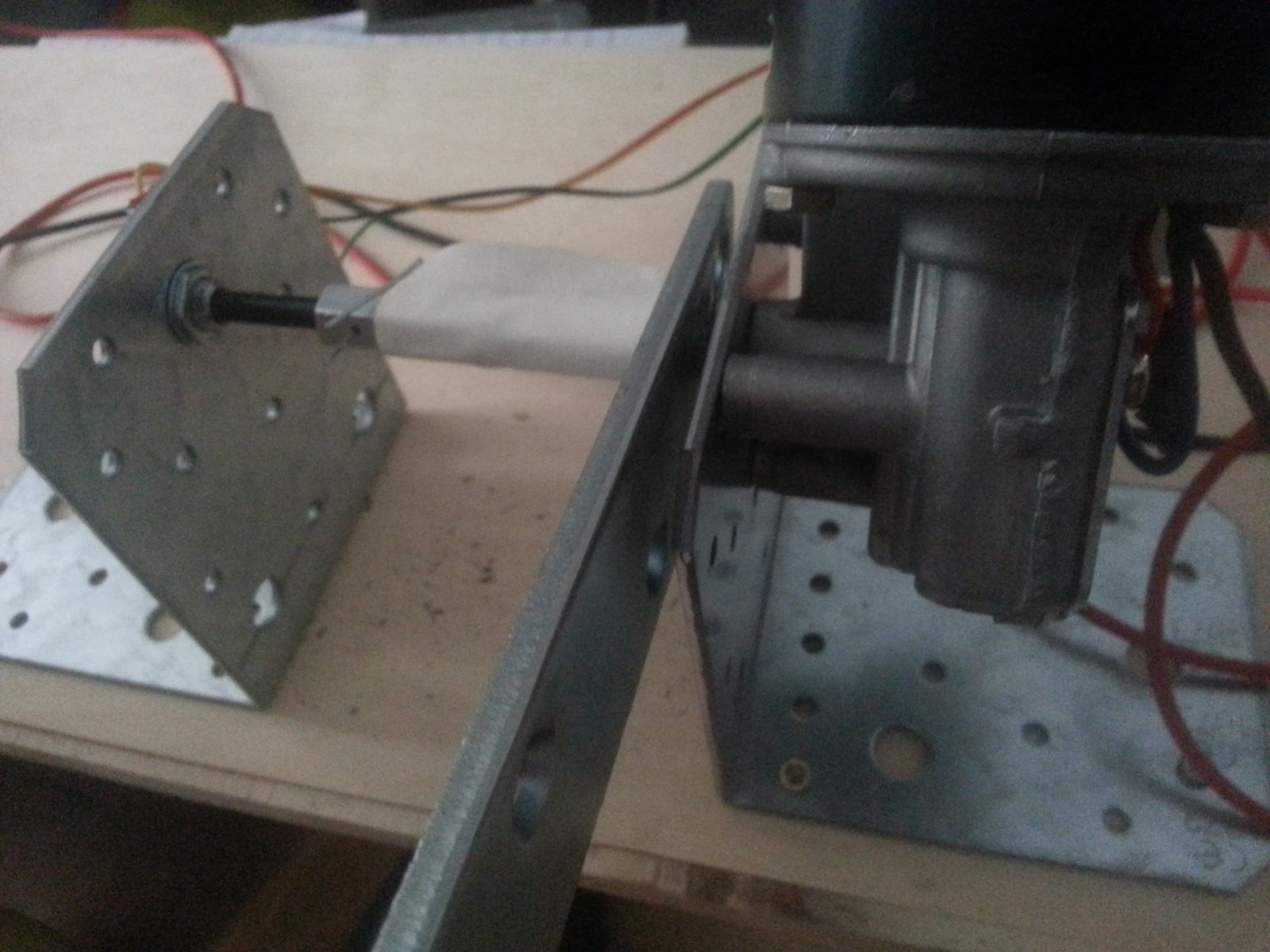

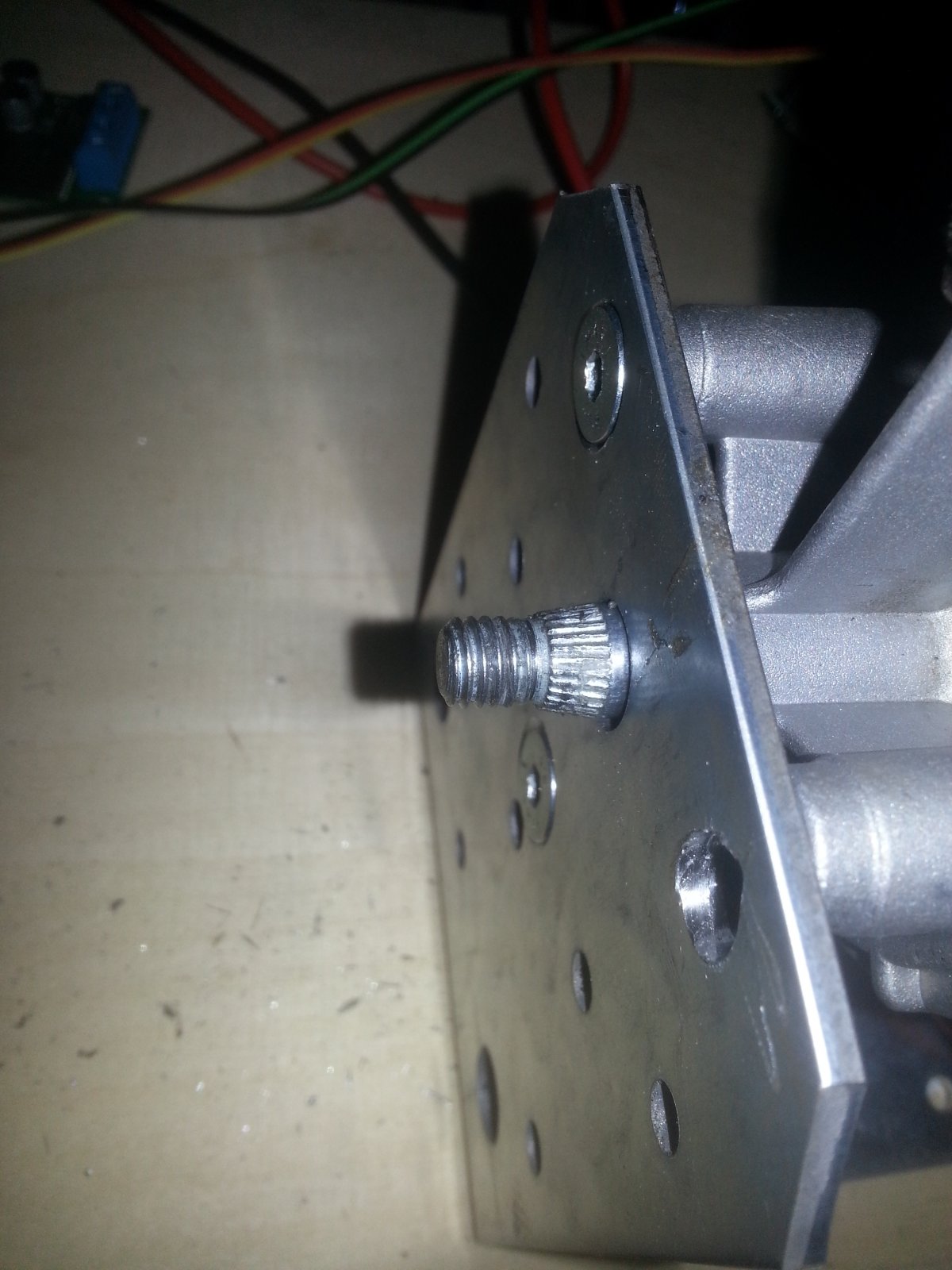

    Still trying to figure out this puzle. Ideas are welcome, how do you guys mount the lever to Wipermotor are welding the solution or can loctite do it.

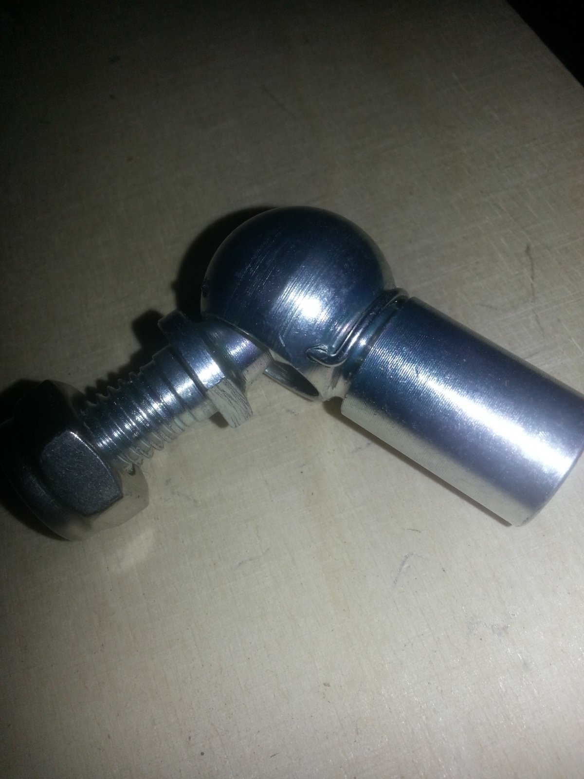

  4. mugge66
    mugge66 Member
    Jun 11, 2014
    80
    Denmark near Copenhagen
    167Coins
    +26 / 1 / -0
    2DOF, JRK
    Just 4 pcs of these today. From lever to seat.

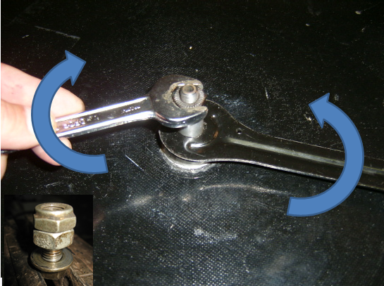

  11. RacingMat
    2,233
    21,066Coins
    +2,092 / 21 / -2
    You can also :
    - do a conical hole in the lever
    - use a nylstop nut to press the lever against the teeth
    it works fine for my 2DOF.
    Or you can weld a nut on your lever + add a second nut to lock it
  12. mugge66
    mugge66 Member
    Jun 11, 2014
    80
    167Coins
    +26 / 1 / -0
    2DOF, JRK
    Thank you racingmat. I just wasnt sure it could hold. but will run with that solution ;)

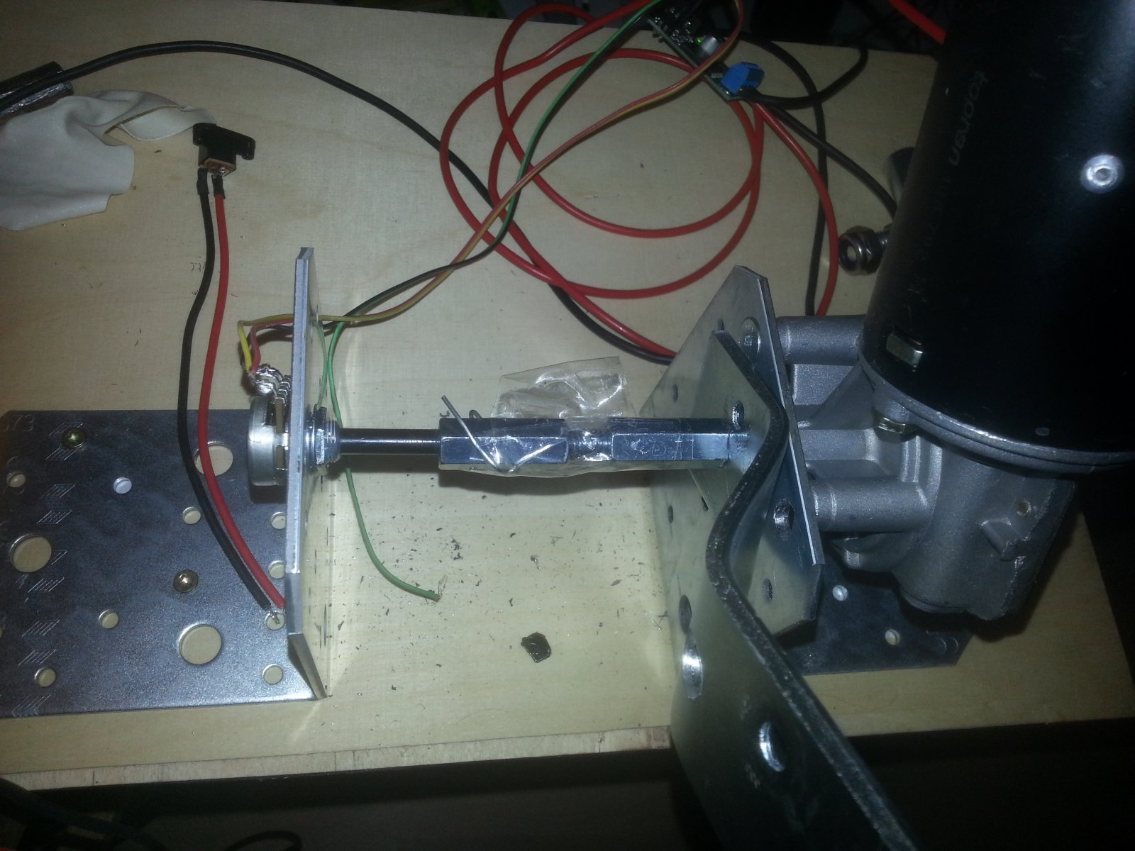

  14. bsft
    Sounds like you are setting the feedback.
    I take it the pots are connected to the motors are they?
  15. bsft

  16. mugge66
    mugge66 Member
    Jun 11, 2014
    80
    167Coins
    +26 / 1 / -0
    2DOF, JRK

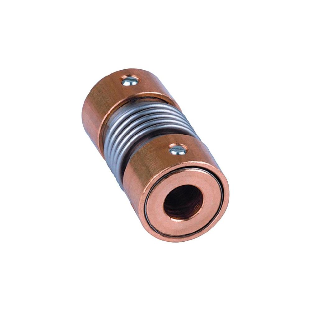

    You can get those on eBay for about 8.00 US - Great product.
