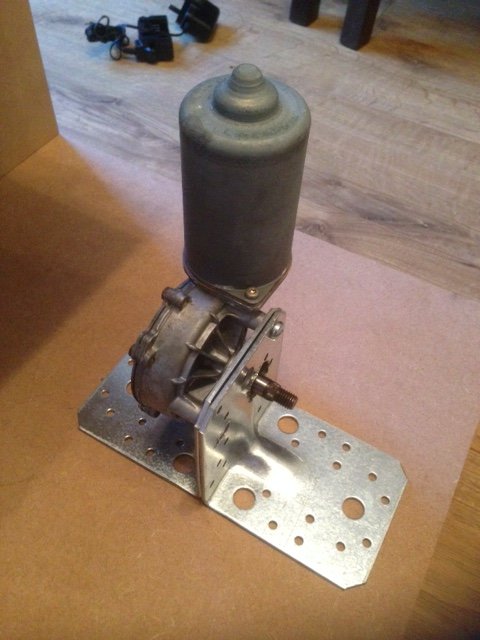

    In my thread, I mentioned the biggest improvement for me, was to have a brace welded on the bracket (45degrees) so there was no flexing of the bracket.
    I look forward to the photos and video! ;)

    I had a different take on it too, using two brackets on each motor also removed the flexing and didn't need a welder :)

    Another question: My grandfather has some concerns about the "grippyness" of the cams when mounted on the motorshafts.
    He thinks that when mounted on the shaft and fastened with one nut the cam will loose grip over time and will slip eventually.
    He asked me to look after some sort of mounting specifically for these motors to make a more secure connection.
    Before i look into this i want to know if the concerns of my grandfather are valid. I've seen a couple of video's of previous projects and it looks to me that the conically drilled cams are more than secure to do the job.
    Can you guys give me some advice on this?

    I know your concerns, but I found the softer metal of the cams, and the harder metal of the gear head created a natural 'bite' once the nut and washer are applied, that is has good grip. The teeth of the gear head creates it's own notches that hold well for my rig.

    It's not the best practice, but it works and I never loose grip. If you find a better solution, use it.

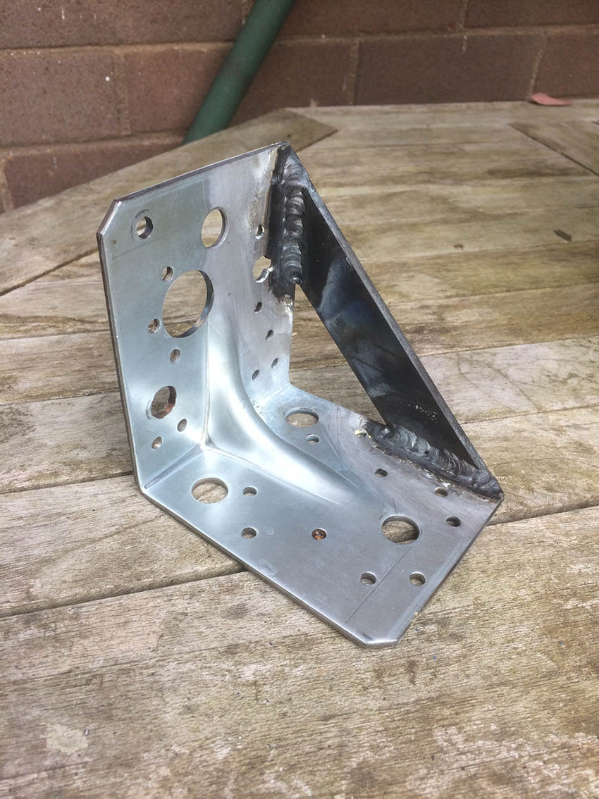

    Little update on the progress:
    Yesterday my grandfather finished the brackets for the motors with welded braces and made the cams (with notches integrated!)
    He called me to pick it up and i immediately noticed that he mounted the motors on the brackets the other way around (with the motors mounted on the "outside" of the brackets) and therefore the braces as well.
    The result of this is that the cams can not rotate the fully 360 degrees with the cams touching the braces at some point.
    For the motion of the seat it is not a problem because i don't need the 360 degrees, but i have some doubts what the motors will do when a hardware/software failure (pc, game, arduino, pots, etc) occurs.
    Are there scenario's where the motors will keep turning when such a failure occurs? In other words will this be a big problem for now or in the future?
    I will post some photo's this evening to make things clear.

    You absolutely need to let the lever do 360° ! Because it will happen, maybe the first time you'll try...

    The brace only needs to be on one side of the bracket, as the motor goes over the edge. It still works fine though.

    i know @Leo Burton . Thanks. That's exactly what my grandfather did, but because he mounted the motors on the outside he placed the brace for the left motor on the right side and vice versa. Therefore it was impossible to mount the motors on the inside of the bracket. I visited him yesterday and we now go for the solution @Paul Shortland suggested.

    Hi guys,
    My grandfather finished the motor brackets and the cams!
    Excellent work i must say
