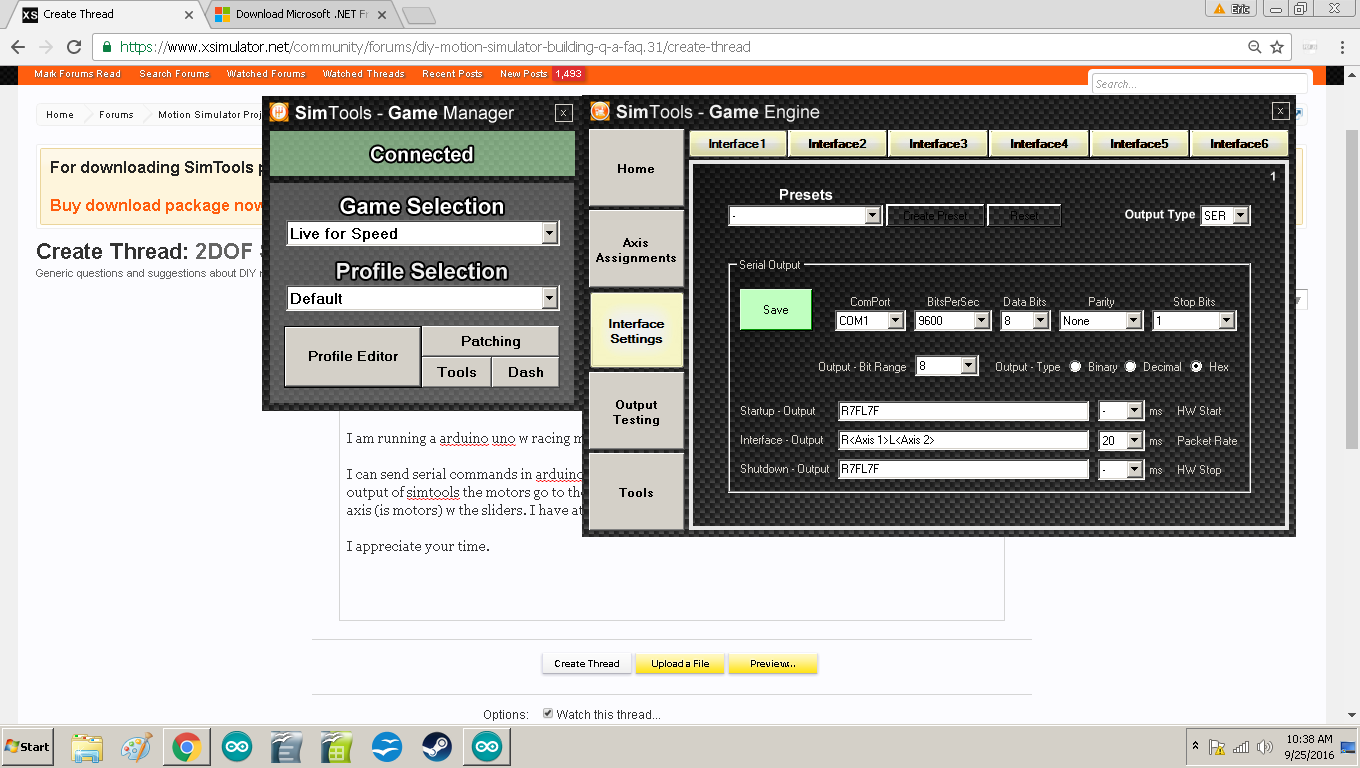

    I am running a arduino uno w racing mat sketch. Two VNH3sp30's and two 12v Bosch wiper motors.

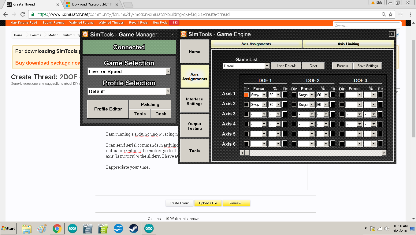

    I can send serial commands in arduino serial monitor and motors move as expected. When I go to test output of simtools the motors go to the "home" position and then nothing happens. I cannot control the axis (is motors) w the sliders. I have attached screenshots of my settings:

    With the Default Profile set in Axis Assignment do you get movement when in Output Testing you Turn On the DOF Output and move the sliders?

    I cannot control the motors with either axis or dof sliders.

    Check your baud rate in xsim setup. 9600bps is incorrect and 115200bps is correct.
    edit.. you may need to change your com port aswell to match the ardinio, in the ardinio ide go to serial monitor and look at the comms settings that are set in the bottom right box if serial monitor and set xsim to be the same

    tried 115200, 57600, 9600. I switched the code, arduino serial monitor pull-down menu and the interface setting in Simtools. Why would it move when I click Start Output Testing, then move back to home position (I assume HW start??) when I stop the testing but not move when I move the sliders?

    Well if when you start testing and it goes to home position you have comms correct.
    Do you have axis limiting < 100% ? other than that I can't think of why your output isn't working.
    I also assume that you have the ardinio ide serial monitor closed when testing simtools.

    Ive tried it many ways from 0 to 100 for limiting. They are set to all use 100% of the axis.

    Another weird one is how does it move when HW Start and HW End positions are the same? I supposedly cannot send commands, or I am but the command is jarbled/incorrect in the serial data from simtools to the arduino??

    ***SOLVED***
    I am a complete bafoon. My variables were typed wrong in the interface settings. Per my formal training I thought a variable with a space in it is improper formatting. Followed what my teach told me years ago... <Axis 1> was incorrect, should have been <Axis1> lol. Thatnks for the ideas guys!! You proved I am still sane :)
