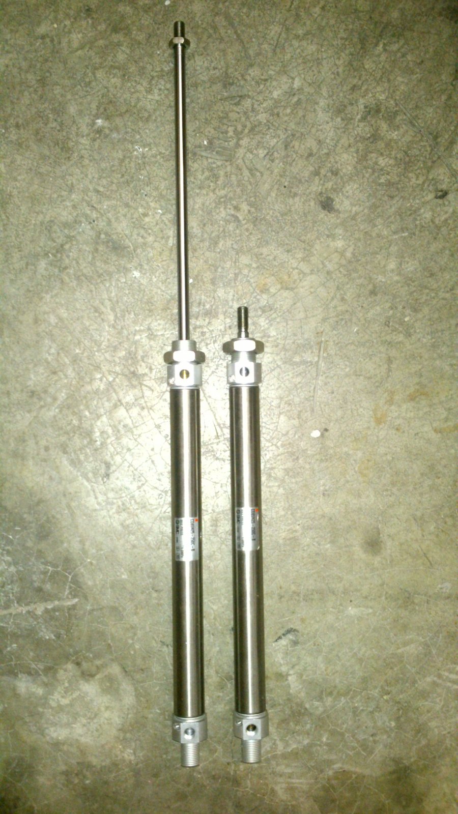

    Pneumatic cylinders:

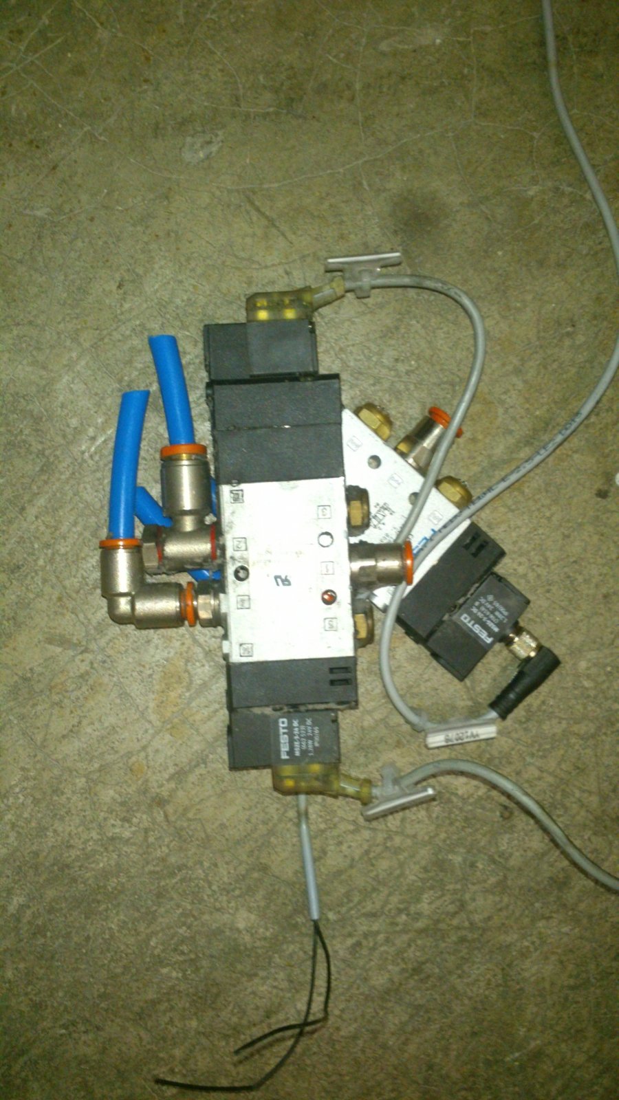

    valve actuator:

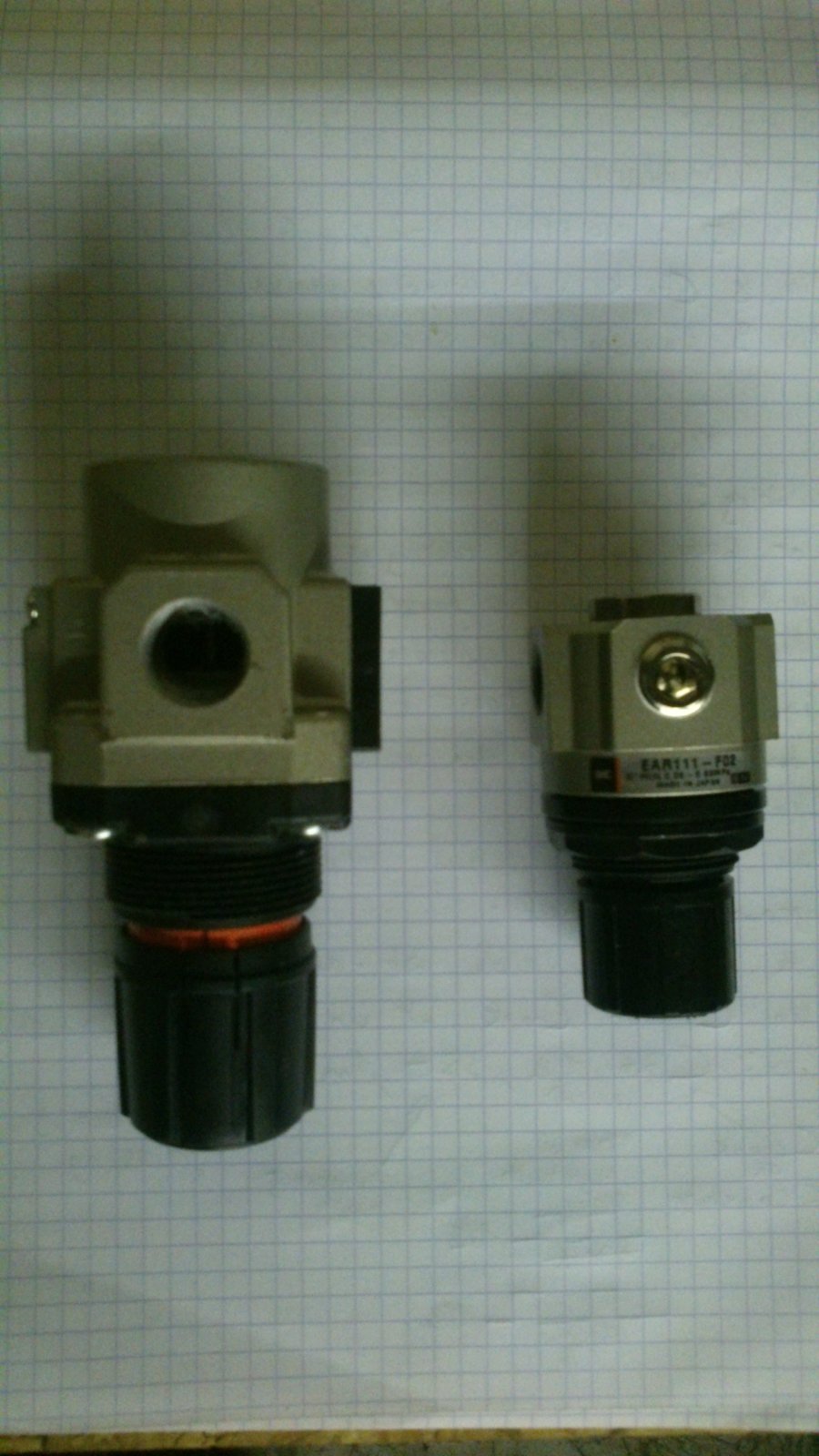

    Pressure regulator:

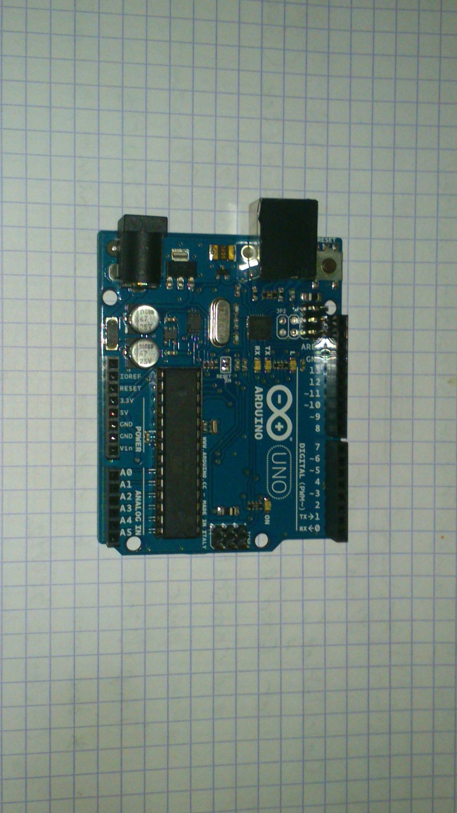

    and Arduino Board:

    For beginning, Just need to find the right transistor or MOSFET between the Arduino and the valve actuator ???
    maybe a thing in this sort:
    But what is the better transistor for my application ?(fast actuating of coil)
    Somebody can help me with this issue ?
    I think to tried with Tip122 with wiring same as in the joined schematic. Good ? Not good ?
    For info:
    The coil on actuator is rated @ 1.28W and 24V DC.
    I ask me if a IRZ44 will be not better for my use ???
    Somebody have most knowledge than me in transistor to oriented me toward the best way? (I'm not an electronic conceiver, I'm lost in the wide range of electronic suitable.)

    I think add one or most pressure regulators and working about fast driving solenoid valve to varying the travel speed.
    Do you think that it's a good way to adjust the speed and movement of cylinders ?

    I originally planned on using pneumatic actuators for my flight sim. I got tons of speed and power out of cheap cylinders - way beyond what a SCN6 or a 1/4 hp gear motor could manage. But I quickly abandoned the idea once I figured out how expensive and complicated it was going to be to control the cylinders.
    Pneumatics are generally used for full range of motion, or for constant speed over a controlled range. Once you add trying to vary the speed, with the controlled acceleration and deceleration you need for an effective simulator, you need to use servo valves and a servo valve controller/amplifier. I'm sure an Arduino could be made to work as a servo valve controller/amplifier with some external electronics. But the servo valves themselves aren't cheap. I forget the details, but the price of the valves and controllers was going to cost me well over $1,000 USD, and I had no luck finding what I needed used or in surplus at a price that would work for me.
    I think having real-time control over the speed of the movements is important for the simulator to have the feel you want. I don't believe you can simply run a PWM signal into a solenoid valve and vary the speed. While I didn't try it, my local pneumatic supply shop told me that even if I got it to work (they didn't think it was possible) the rapid cycling of the solenoid valve would cause it to reach the life of the valve (maybe 100,000 cycles) within a few minutes.
    I can't tell from your picture if you have a normal 5/2 solenoid valves or servo valves. If they are servo valves then great!

    The transistor (or a relay) is necessary since you can't run a 24VDC coil directly off the Arduino. But yes - the need for a transistor isn't related to whether a fast acting or standard valve is used.
    With the coil taking 1.28W at 24VDC, that means you are pulling 53 mA. That is a pretty low current level. All relays will handle it, and even a small transistor in a TO-92 package should be fine. A generic 2N2222 should be plenty. The IRZ44 or TIP122 you were considering are bigger than you need, but would be fine and give you plenty of safety margin.

    No, it's a 5/3 solenoid valves (same speed as the one on the video but with 5 Port and 3 positions!)

    Thanks for infos about transistor able to interfacing arduino with solenoid. I have some 2N2222 in stock.
    I will go try it soon. I need some diodes to protect arduino of surge peak before fried it.

    But my question was rather: What is the appropriate transistor that allow me to actuating a coil in hard condition without thermal dissipation issue ?

    You don't need a heat sink at all. If my calculations are correct (I'm no expert) even with a 2N2222 transistor in a tiny TO-92 package you will only end up with an 8 degree C temperature rise at the junction (inside of the transistor) with no heat sink. That is way to low to be a problem. If you use the IRZ44 or TIP122 you could run the thing all day long with no heat sink, and it wouldn't feel even a little warm to the touch.
