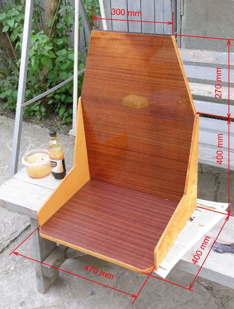

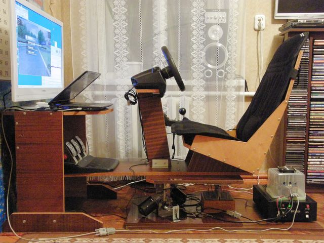

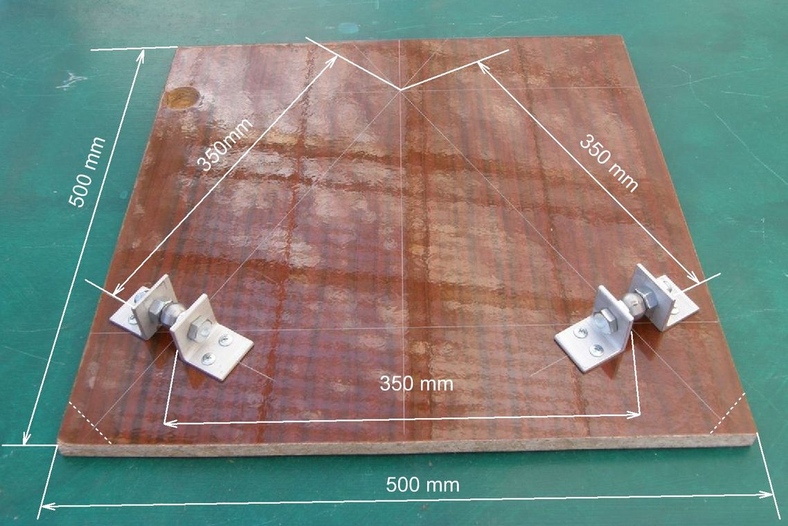

    Welcome all enthusiasts!
    I would like to submit my design of a simple simulation based on the idea DERIY.
    Several videos.
    http://www.youtube.com/watch?v=GugCts33zt0
    http://www.youtube.com/watch?v=z6IdoibudRo
    http://www.youtube.com/watch?v=IdeB29UTcXQ

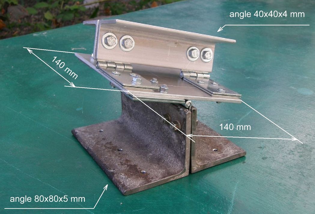

    Homemade joint:
    Lower platform:
    upper:
    assembly:
    chair:
    more:
    Many thanks to:
    sirnoname (software)
    Thanos (AMS and H-bridge)
    DERIY (layout)
    and all other enthusiasts!

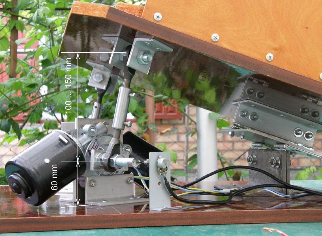

    Btw, you could take a lot of stress from the actuators by placing the pivot under your butt.
    As it is now, your weight is splitted between the pivot and the actuators, which is suboptimal Imho.

    Have to say wow wow wow , another great project and again you guys have shown a level of innovation and ways to make it simple , love the way you made your own universal joint and revesre thinking about actuator location -- creative thinking at its best :) every day you guys show waht can be done without spending a lot of money .. personal thanks for posting your work . i have all the bits to make my sim but always on the lookout for easier ways to make bits with limited tools. your work and Deriys show a lot of useful details love it love it lovie it ----greta work guys

    No, no. In the middle position a chair with my body balanced. This balance is easily obtained by moving the chair along the upper platform. In the video, visibly as bouncing the front edge of the lower platform. This suggests that the center of gravity is located exactly over the hinge.

    This simulator was built from scrap materials except vipermotors.

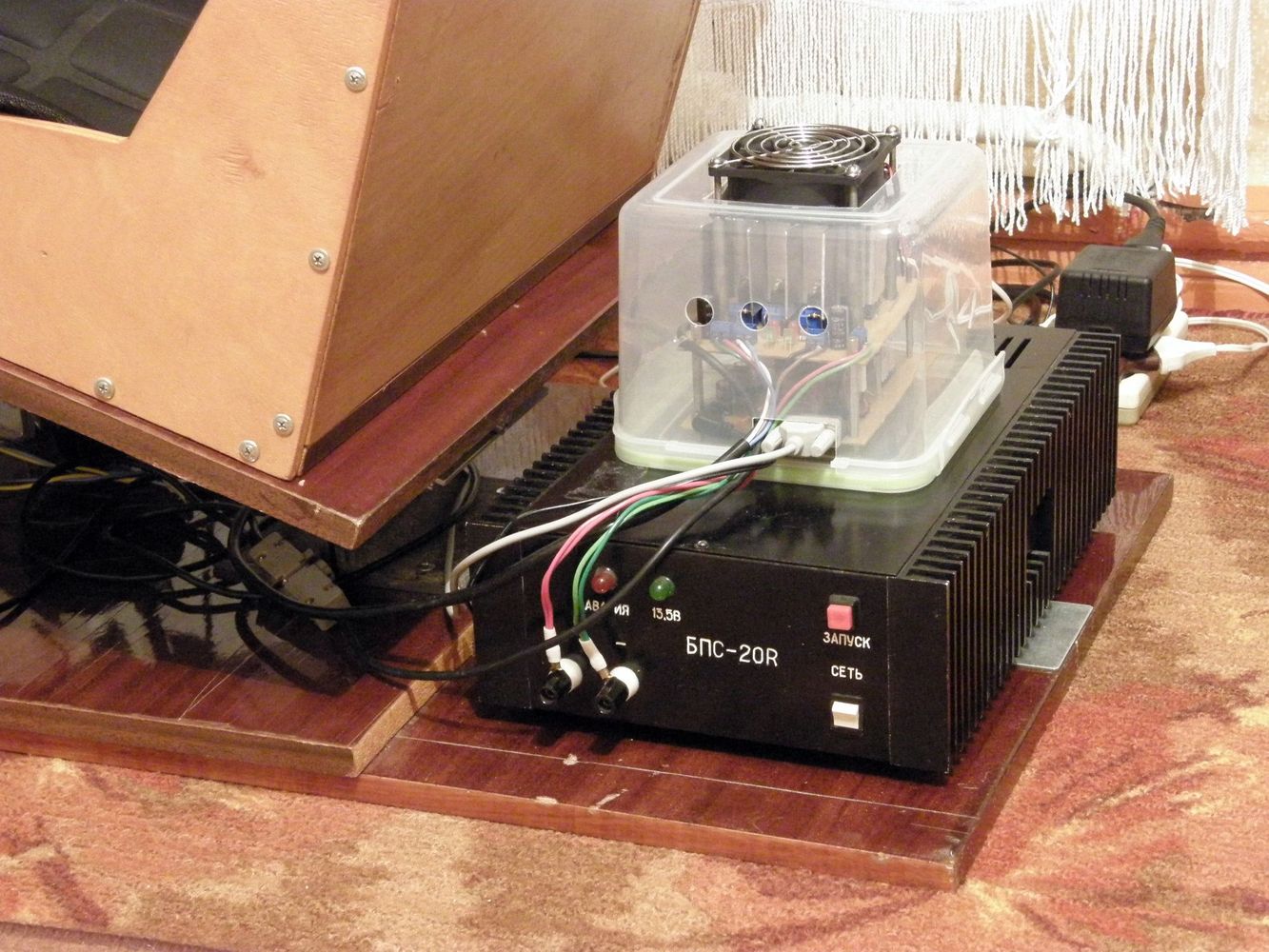

    To control the motors used Tronic's AMC motor motion-controller and Tronic's DIY dual Mosfet H-bridge (DSMhb).
    Power supply is 20A 13,8V.
    Basic dimensions:
    -bottom platform
    -upper platform
    -hinge
    -crank
    -chair
  13. fredspeed

    418Coins
    Hello ua6aak. I really like yours and Deriys sim, and I am building something thats a combination between them. Have you thought about making steering wheel and pedal move with the seat, as Deriy`s? What kind of powe supply do you use? show a picture of it! I see Deriy use 16v and you 13,6v. I guess you both have 12v motors.

    Hi, Fred. I use a power supply designed to power the radio amateur transceivers. It is 20 amps 13.8 volts. About making steering wheel and pedal move with the seat - I think it is quite possible. Perhaps'll do this in wintertime.

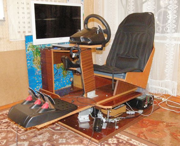

    Hi everyone!
    A slight modification of my Sim. Now fullmotion.
    http://www.youtube.com/watch?v=0C4lKZl5d2U
    http://www.youtube.com/watch?v=DzjzkT5nyBk
