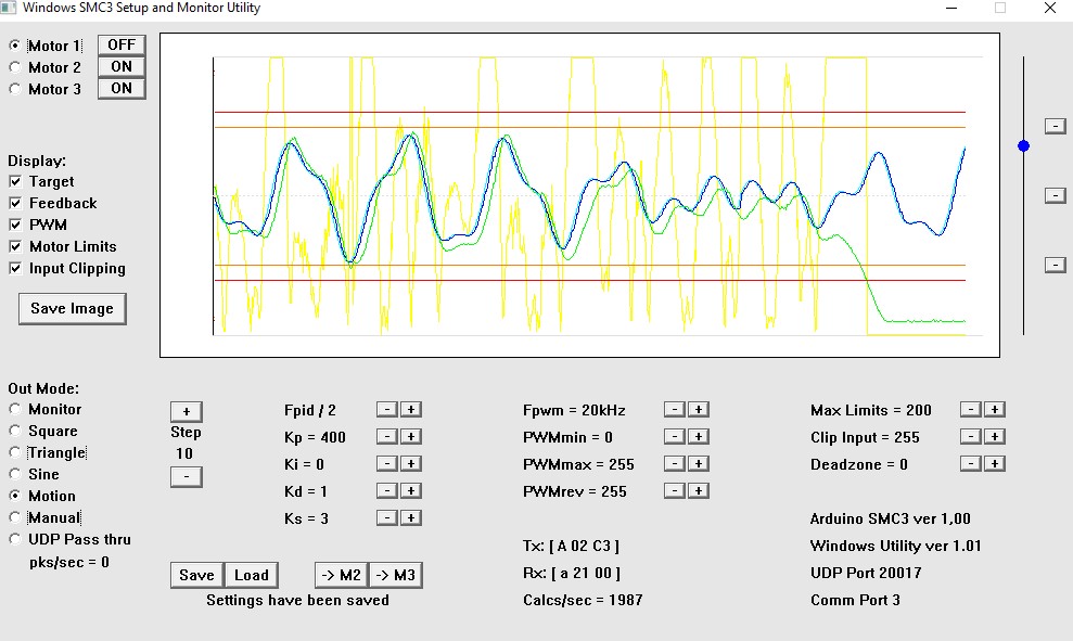

    I just finished building my own 2DOF race simulator with Wipermotors, Arduino Uno and Monstor Motor Board.
    I'll send a new thread about this build soon.

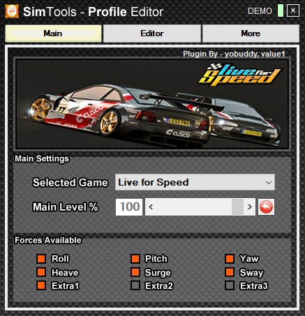

    Communication and testing work well but as soon as a start with "Life for Speed" I'm getting overshoots.
    Mainly on the left side and the overshoot goes to the top (see picture).
    So my simulator leans to the right.

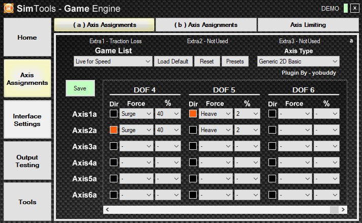

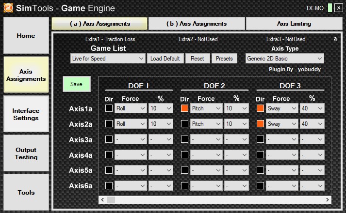

    I have added pictures of my settings.
    I hope someone can give me some advice and or suggestions.

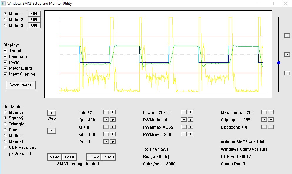

    Your Kd is very high. Not sure if there is the trick for not overshooting?
    Maybe @noorbeast can take a look at it and put you in the right direction.

    I agree with @JonBakhol your SMC3 settings need refinement as there looks to be overshoots.

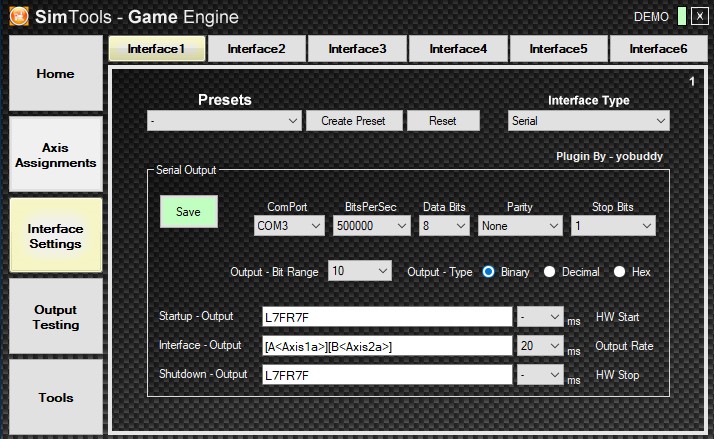

    To simplify matters while being it sorted I would suggest clearing the Startup and Shutdown fields in the interface settings.

    Just for comparison my Kd is set to 1 with wiper motors and give no overshoot

    Thanks all for the intput, but I'm afraid the overshoots still happen.
    What I found out is it looks like the motors aren't pulling down hard enough.
    So if the seat leans left it's really easy to push the right motor into a top overshoot.
    The same happens when the seat leans right , than it's really easy to push the left motor in a top overshoot.
    So the motors push up hard enough but they hardly pull down.

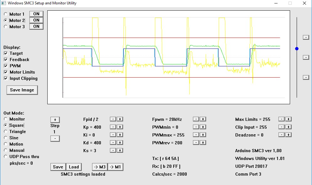

    I have attached a file where you can see it happening in SMC3.
    I hope my explanation makes sense, i tried a lot of settings but I couldn't find any improvements.

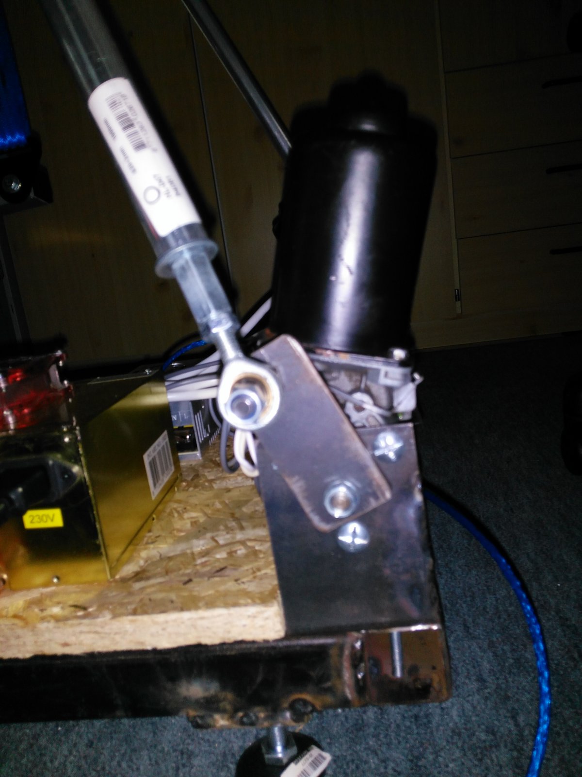

    Well, when the seat leans to the left, the weight of the seat helps the right motor to move upwards by pulling at the rod connected to the right motor. The larger the seat angle, the larger is the force that the seat applies to the motor, and the harder it is for the motor to move the seat back into its neutral position.
    So maybe your wiper motors are just too weak to move the seat back? Is it a shoulder mounted rig?

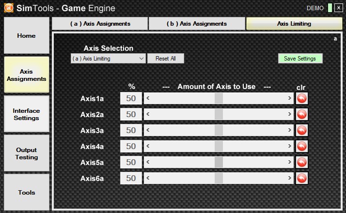

    You could try to decrease the Axis Limiting further, which will reduce the max angle of the motors.

    This would effect in this way I imagine if the rig wasn't balanced presumably it has been balanced ?

    It is indeed a shoulder mounted rig and I did my best to get my rig as balanced as possible.
    Also I tried to have the right angles on my push rods.

    I rewired the wiper motors, so I'm now using the opposing brushes and this made a mayor improvement.
    I also shortened the rods between the motor and the shoulder mounts and this also helped.
    And if I keep the axis limitations at 35 I'm no longer getting overshoots when playing Life for Speed.
